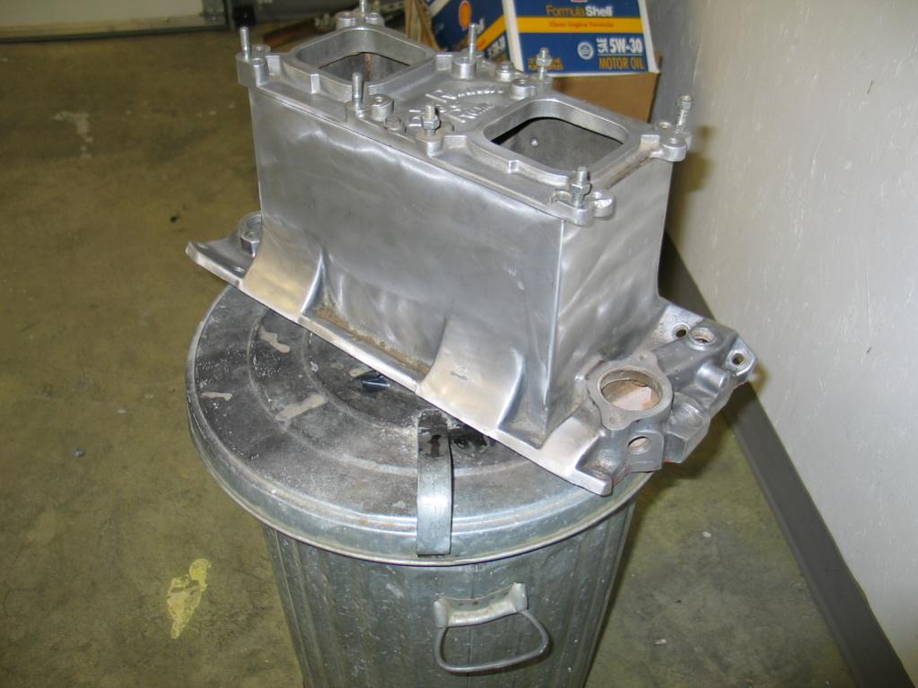

    Does anyone know the history of this Intake?

  3. I have a old magazine from 1964 with an ad for that thing. It makes some pretty outrageous claims. I have heard that intake has serious fuel puddling issues and a huge internal volume. Its a very poor design.

    Would be a fun project to smooth out some of the flow with some epoxy... get rid of some of the dead space.
    As long as it's not a huge dollar collectors item.

    By Ralph Ridgeway (also developed the SBC stud girdle), earliest non-fabricated tunnel ram (although they were used in the 1950s) that I've heard of, primitive compared to more modern designs, plenum volume too big for a street engine.

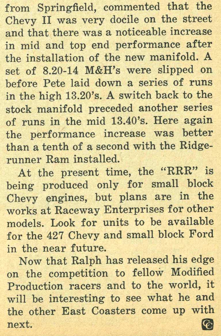

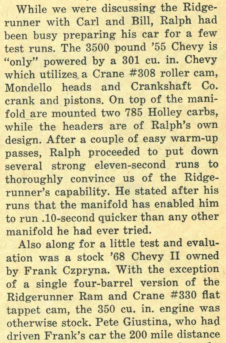

    Do you have an image of the ad? We just picked up a Big Block Ridge Runner Ram so now we have a SBC and a BBC and would love to have an ad.

    I can’t help much but I will share what I can.
