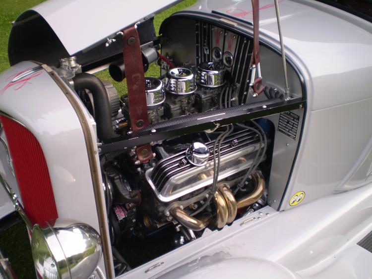

  16. Is this hot rod enough, total investment, complete rebuild included, is about $1900.00, including the carbs and intake. 92 roller cam engine, makes about 275 horse power. Works for me. I've been using SBCs for over 30 years. Best bang for the buck, always a SBC.
