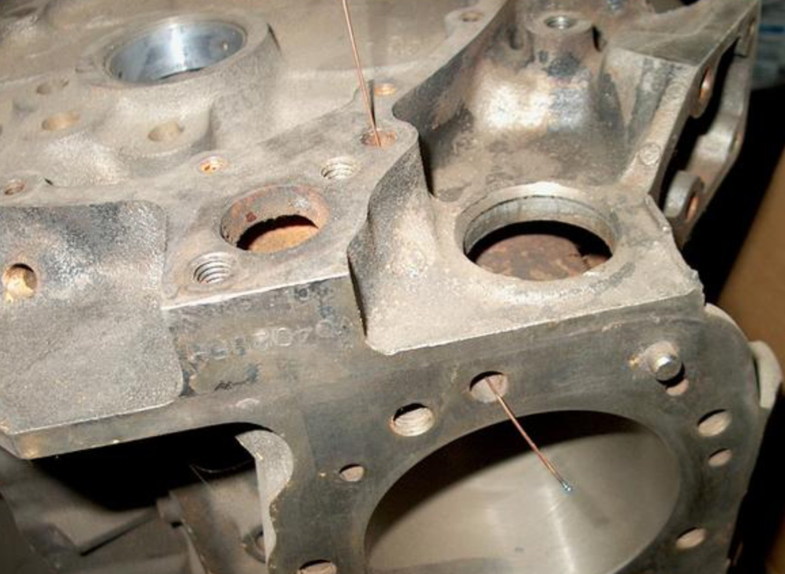

    Are you talking about this hole below the mounting bolt?

    It's not a heater hose connection. The hole is about 3/8" dia. and it's located just under the water pump mounting bolt holes on the pass side. There is a port on the water pump that matches up to this port. The hole on the block is a blind hole. It's not drilled into the water jacket.

    Yes Jim. It's the hole just under the mounting bolt holes.
