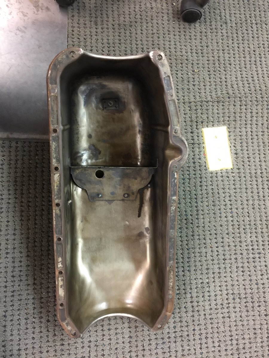

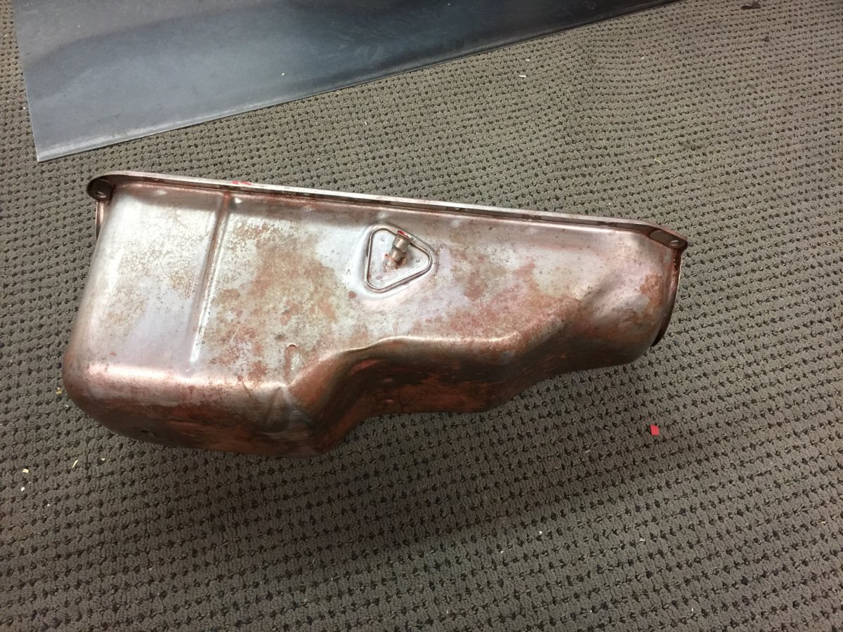

    I am the friend in question...
    Pan in question:
    So figured a standard gasket would fit, but still wondering the iden***y of this little beast.
    Updated images
  15. squirrel
    Joined: Sep 23, 2004
    Posts: 59,977
    squirrel
  16. Where the dipstick is going into the pan is too far forward of the sump? I don't think it would be viable? Possibly some kind of Photo shop?
  17. xnology
    Joined: Aug 21, 2010
    Posts: 44
    xnology
    from Idaho
    The dipstick lines up with the hole in the baffle - pokes right through into the sump.
    $600?
    Anybody want a slightly used oil pan cheap? $400...
    Didn't realize my pan was made of gold.

    Sorry to comment on an old thread..........but, did you ever figure out what engine this pan went to? I just picked up a 350, casting #3970010 and it has the exact same pan shape with the left side pan mounted dip stick. I'm having trouble figuring out what vehicle / year it came from. thanks,
  20. That is more like a 70s 305 pan. I have one from a 78 Buick Skylark. Dipstick slides in on the driver (left) side.

    K5ride, thats not the pan for that engine. Lippy
  24. Smooger409
    Joined: Jul 18, 2017
    Posts: 2
    Smooger409
    It is from an early 283/327 powered big truck 2 1/2 ton viking C50 C60 etc 6 quart capacity, the dip stick attaches to the block using the 1/4-20 hole on the side of the block normally used for the spark plug heat shields
