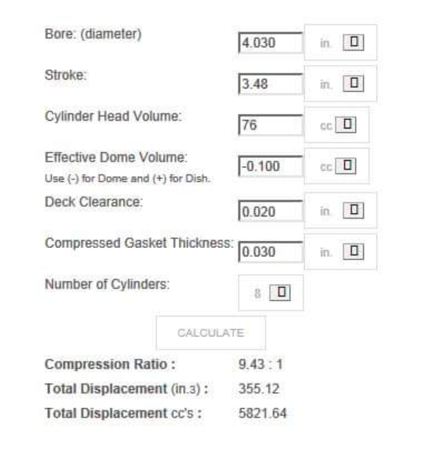

    Budget36

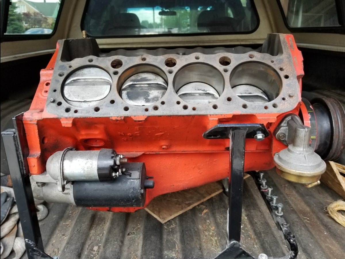

    Wow, seems like a decked block a a 3.25 crank?
    jimmy six, Deuces and loudbang like this.

    Yep, I agree with Budget36, if that is for sure a good measurement of true TDC, you need to check the crank stroke before blaming pistons.
    No rebuilder's 350 piston is ever that low. The difference between 350 and 327 is .115" of piston compression height....so .120" down is darn close to ballpark area for a good 1.560" 350 piston stuck on a 3.25" stroke large journal 327/307 crankshaft by mistake.
    I had one of these anomaly's once, from a local shop....put three cams, two intakes, two carbs and two different sets of heads on it before I discovered the .140"-ish down at TDC flat tops....still had toilet low compression with the flat tops and 76cc heads. I was 19 and didn't know to check it beforehand.

    Those look like L-2304 TRW pistons.... Or maybe speed-pro replacements.....

    Another possibility is 400 rods @ 5.565".

    Extremely low compression, an anemic camshaft, and so so heads. It's no surprise it's not a good performer. The fix is a set of heads with extremely small chambers, like the older SBC 59-62cc chamber heads. A much better cam also, and it will likely come to life and run much better.

    That combination of dished pistons, 76cc chambers, and the lower performance camshaft all sell a low performance engine build. I'm not surprised at all that it's all in at 4,000 rpm's. A switch to a smaller combustion chamber head, and a better camshaft will likely wake it up. Or since it's likely 8:1 compression, maybe time for a blower on top and a better cam?
  12. Wrong pistons for the crank used ? Saw this exact situation many years ago when a friend used a mixture of 350 & 327 parts which resulted in the pistons being way down in the hole at TDC. His response ? "I thought all 4" bore pistons were the same"
