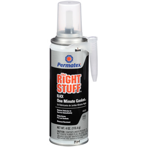

    As already stated, but I must confirm (after working for Fel Pro for 30 years) the cheezy-chrome-pans are not made to SAE standards in shape or metal thickness in most cases. Milodon have been made correctly.
    If your going to use it, you must take a sanding disc or red scotch brite disc and remove the chrome/shiney from all gasket and seal surfaces.
    Then use Permatex Right Stuff as your sealer
    Remember .... all of the old engines leaked, and still do. Using quality gaskets, properly preparing the sealing surfaces, do not over tighten fasteners, and use Right Stuff .... your odds are good.

    That's a quality tip right there! Thanks!
    As I mentioned early, I used that exact Black gasket maker on the front and rear of the Fel-Pro gasket as called for in the instructions and torqued to spec on my SBC350 and zero issues. That does have an aftermarket black steel oil pan from Speedway but seems to be working well.
    on the Chrome one - I could give a rats a$$ - because you can't see it. I'm not going to car shows a putting mirrors down. For now, I'll probably clean it up as you said and continue to use it, but should cir***stances change (like after I put a new gasket in it continues to leak) then I'll swap it.

  20. Thankfully Denny with the double Ds started it off but I was gonna recommend getting rid of the tinfoil chrome pan- they all leak. Clean and degrease the rail so the "right stuff" can adhere well. Shouldn't cost more than a few bucks to find a proper pan. As long as it's coming off you really should swap it.
