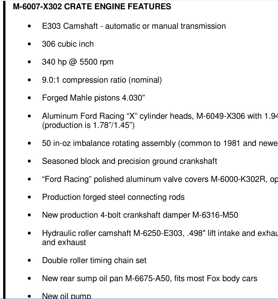

    I just Google M-6007-X302 and came up with all specs you should need.

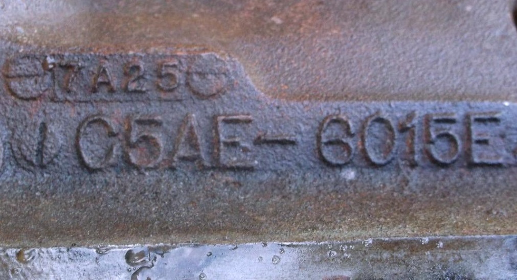

    ford casting dates are kind of hard to read, as are the casting numbers. And they don't always exist. And they changed over the years. But you might be able to find something useful.
    this is an example of what you might find on the block, near the starter (bottom rear p*** side)
    The casting number is the long one, it starts with C5 in this case, which means the block casting was first used in 1965. (C is 1960s, 5 is the 5th year of the decade)
    The casting date is above it, in this case 7 is the last digit of the year, 1967, A is the first month, January, and 25th is the day of the month. So this block was cast Jan 25th 1967
    If you find numbers like this, post a picture, we'll help you figure it out

    but...if it's a crate engine built from a core (used) engine block, then it could have a date code of the correct time to meet his needs.
    And reading the Ford Racing instruction sheet for the engine, it says "Seasoned block..." which means it is indeed an engine older than 2010.

  7. Thanks squirrel .
    I read the same thing from the summit website , ford website and the paper work I have at home .
    no where does it say “ new block “ ( pretty much everything else is new ) nor does it mention any kind of emissions compliance .
