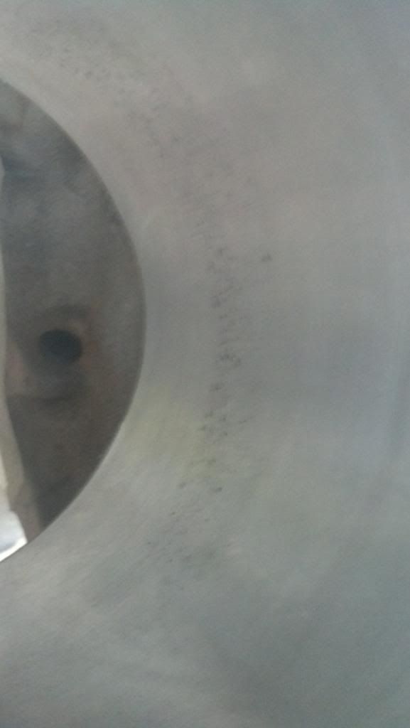

    Well I finally got my engine back today. Total ended up $850 rather then $500 including machine work to block installing springs and retainers and surfacing the heads. Not quite happy since they did not contact me before doing the work. Anyways I got the engine back here and I am getting the feeling that this was half ***ed. included is a pick of the number 6 cyl which still has a decent amount of pitting. All the other cylinders appear perfect though. In your opinion would you take it back (which i am going to do) or does it look runable? Also I am curious are the lifter bores supposed to be cleaned up? I will talk to them more tonight as to what their opinion is but I am not getting the feeling that this got their normal full attention and i would appreciate some of you guys input. anyways here are the pics.

    Those lifter bores should have been cleaned up. That cylinder doesn't look too good either. I hope that this isn't how engine builders operate these days. I need some work done to my engine, but finding a reputable engine shop will probably be a challenge. I would take the engine back and voice your concerns, especially since they didn't stick to the original bid.

    I am bringing it back tomorrow and telling them to hot tank the heads for sure and probably the block again because there is rust still in the water p***ages I will make sure they clean the lifter bores and I want to get another opinion on that pitted cylinder. Being a kid everyone thinks they can take advantage of you and I am getting really tired of taking it in the teeth.

    Well I got a second opinion on the machine work and I was told that it was done excellently and that the pitting was indeed not a problem like they had told me. I will clean up the lifter bores this evening and begin ***embling things

    Looking back at this thread entirely upon dis***embly the lifters appeared to have severe water damage. For the cylinder bores to finish as they did there must have been a lot of pitting before they were honed to size,with that you mentioned you got the word for 10-10 bearings and .020 pistons and rings. You ordered such.
    A ***umption on my part is the machine shop told you what you needed. Am I correct here ?
    While I can throw my hat into this ring because this is what I do for a living and will say before I order ANY piston on a questionable bore I either bore it or hone it to a few thou .005 to be exact to take any guess work out.
    A bore that pitted will eat rings period any other excuse is just that,a excuse.
    Someone got lazy and guessed before doing a little leg work to get the job done right.
    I may be a tad slower than some on getting jobs out but never would one leave like this at my shop.

    I agree with gary . . . the only time I've seen slight pitting like that is when the pistons have already been bought and the pitting was just too deep to be cleaned up to use with the customer's parts.
    If its any consolation, I've driven around some stuff with slight pitting like that. Isn't great for max HP but it will still run okay.
    The lifter bores will clean up with a *********** hone, a drill to run it, and some wd-40
