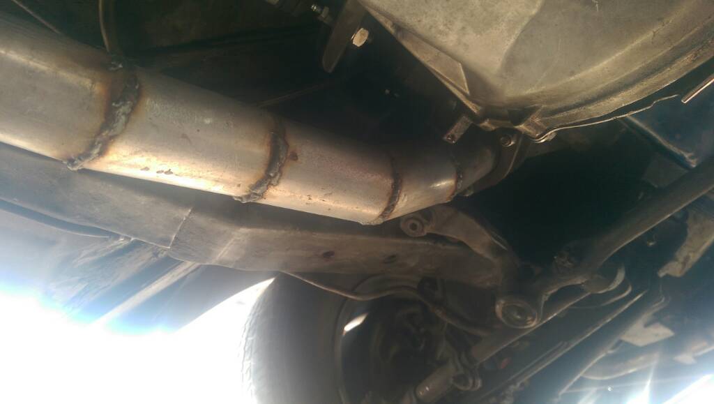

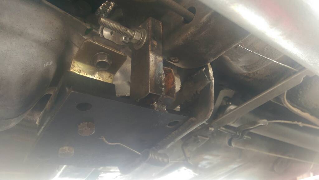

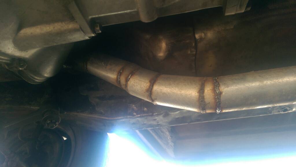

    Havent had much time to play with it or change too much because of school how ever this weekend I created a new transmission mount and weldeed in a 2.5" exhaust system. It is significantly more pleasant to drive now. The one thing I am noticing is the both tires on the rear axle are wearing on the p***enger side. This would lead to believe the rear axle may be bent? any thoughts here? I also have a vibration around 4k plus though I am not positive as to whether it is the rear axle or an imbalance of the flywheel or clutch ***embly.

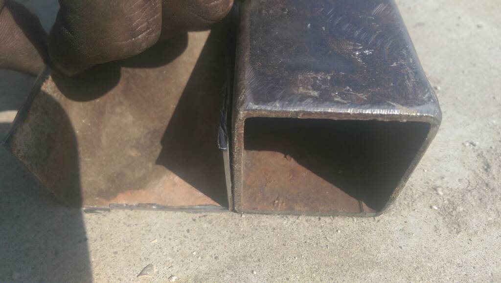

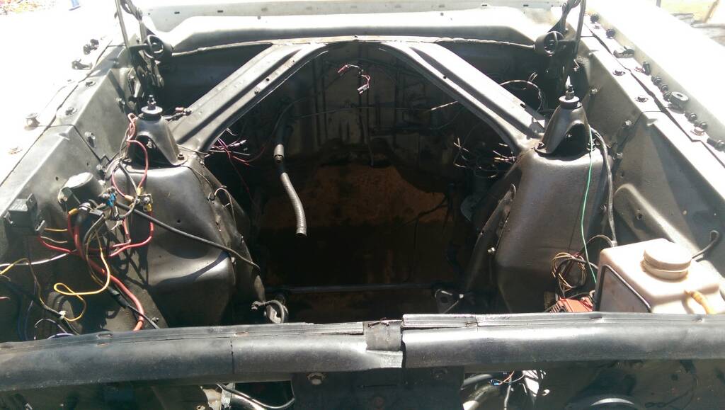

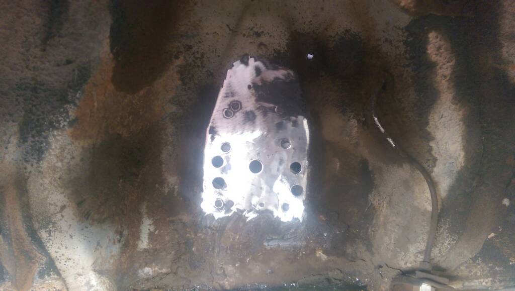

    Here are a few photos of the underside. The last pic is of the original sub frame compared against the 1/8 wall tubing I'm going to be using for the frame bracing. Kind of frightening how weak the original subframe is
