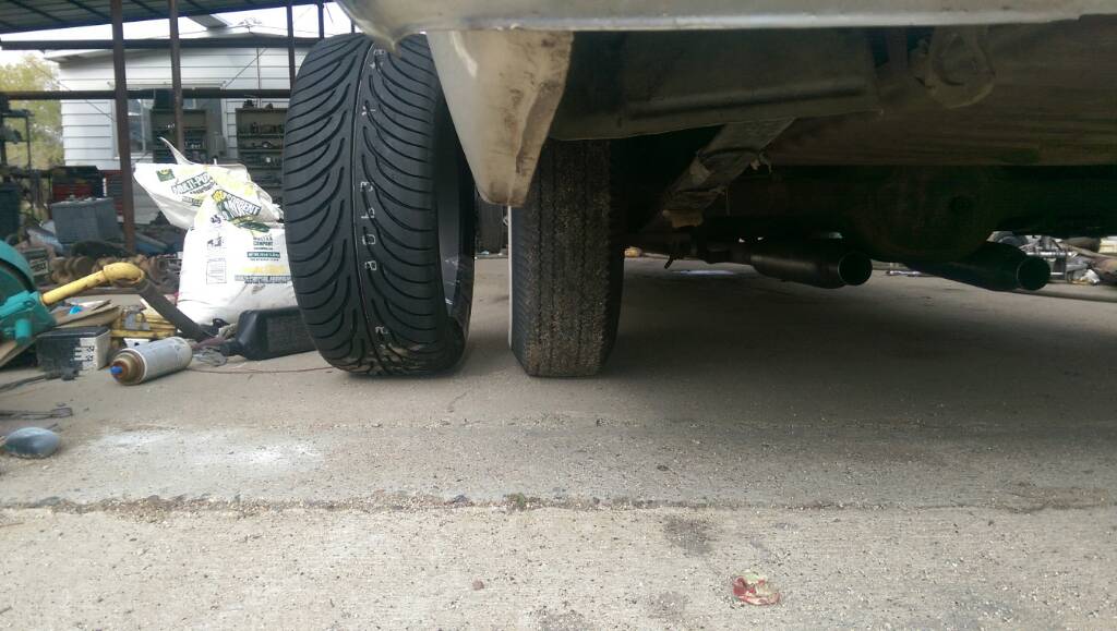

    That would make the car dogtrack but it shouldn't cause the tire wear you describe. Both tires wearing on the outside would indicate the housing has some toe-in. Wear on the inside indicates toe-out but both tires wearing on the right side is puzzling.

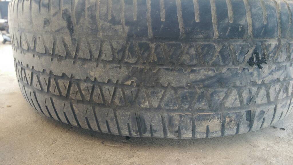

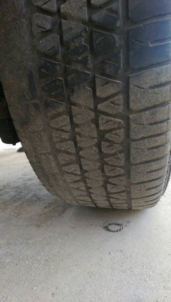

    Here are pictures of the two tires that were on the rear axle and as you can they were both wearing extensively on the p***enger side

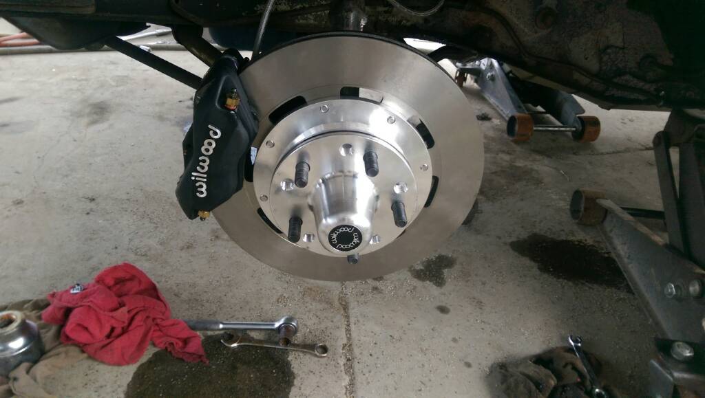

    Been having fun with the brakes recently. The master cylinder I installed was for drum brakes and it turns out it had 10 lb residual valves internally which was too much for the disc brakes up front. I then ordered a master cylinder for a 1974 maverick with disc brakes which I read was a good one for the disc swap. Turns out it does not have any residual pressure front or rear which allows for a bit more pedal travel than I care for. Looking at getting a 10 lb residual for the rear and a 2 lb residual for the front. Something I have looked into a bunch and found little to no information on it is the gm style universal combination valves which allow rear brakes to engage before fronts an keep pressure in check but as of yet I do not believe they have residual valves in them where you would only need to get that to fix the system. For what its worth the Wilwood brake set up is incredible for stopping and well worth the price tag. On another note on the drive home last night the rear axle started making very signigicant clunking sounds while going around corners and worse in right hand turns. I believe my carrier is toast so now I need to figure whether I go ahead and rebuild the 8" or step up to an 8.8"

    Not sure about the GM style, but Ford used OEM combination valves which is a proportioning and metering valve combo, but doesn't contain residual valves.
    ***uming you have Granada discs, the Maverick Master, plus the Ford combo valve, plus 10lb rear residual is what you want.

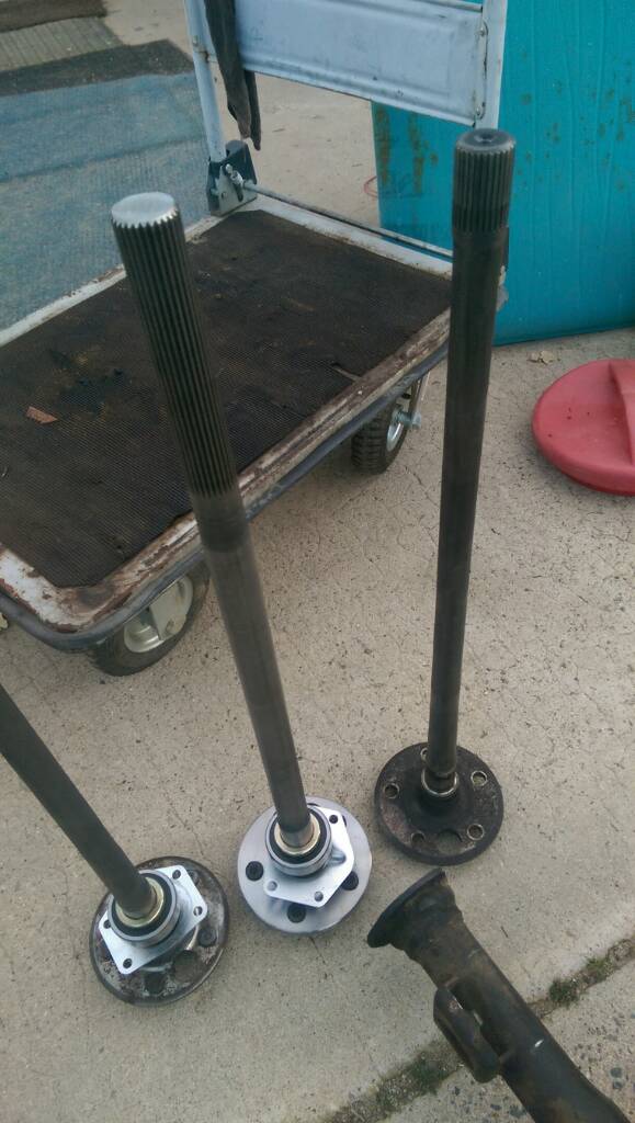

    So long story short bent housing bent axle shaft and toasted spider gears. Going back together now and everything looks good except the axle shaft seals don't fit my housing. Here you can see the difference between the 62 pumpkin versus the 67 pumpkin. Also displayed is the difference between the original axle shaft and Yukon aftermarket axle shaft

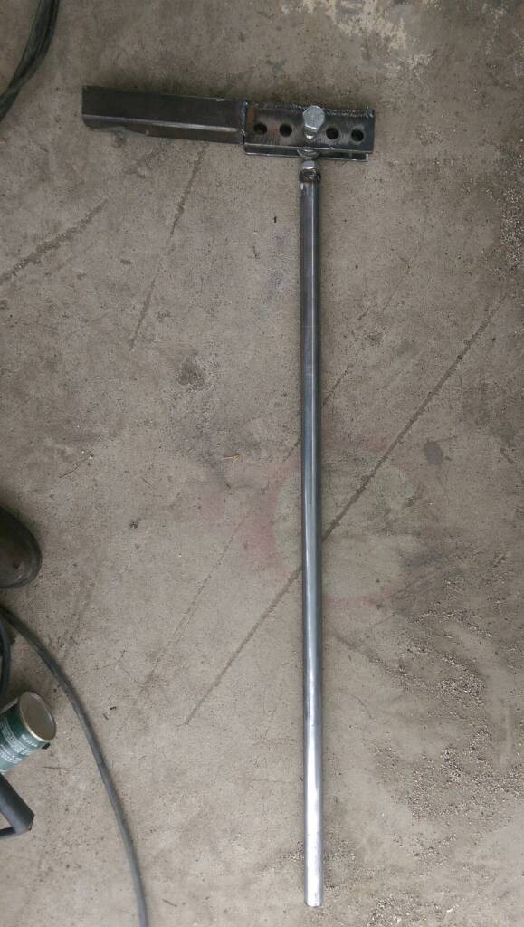

    Making a pan hard rod for the ranchero

    Panhard works great and I'll post more pics and info on that soon. In bad need of new Springs with much higher spring rate. Either going global West or maier racing. Any input on either would be appreciated. To throw some gas on the fire has anyone consider putting a miata irs in a Mustang? The track width is right and with a 8.8 inch pumpkin I know they can be bullet proof and they handle very well
