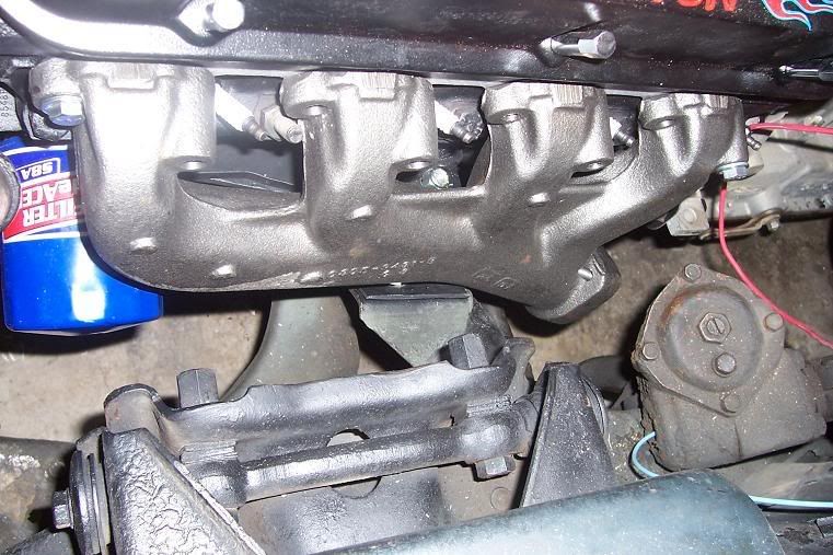

    Problem solved! I found some of the Ford Hi-Po upgrade stock exhaust manifolds (reproductions) from Dallas Mustang. They were an upgraded manifold with bigger ports than the small stock ones for the late 60's to early 70's Mustang. They fit like they were MADE for this application and have a pretty cool old look to them as well. I'm glad I got a mini starter because that probably would have caused some issues.

  23. Ford Fairlane
    Joined: Aug 22, 2004
    Posts: 178
    Ford Fairlane
    Wow nice fit. Those look like they where made for it.
  24. pistinbroke
    Joined: Jan 22, 2005
    Posts: 540
    pistinbroke
    Glad you found a set that fit. I was going to suggest you try pinto and mustang two 302/351 conversion headers. Those are built to fit really tight spots. Looks great by the way!!
