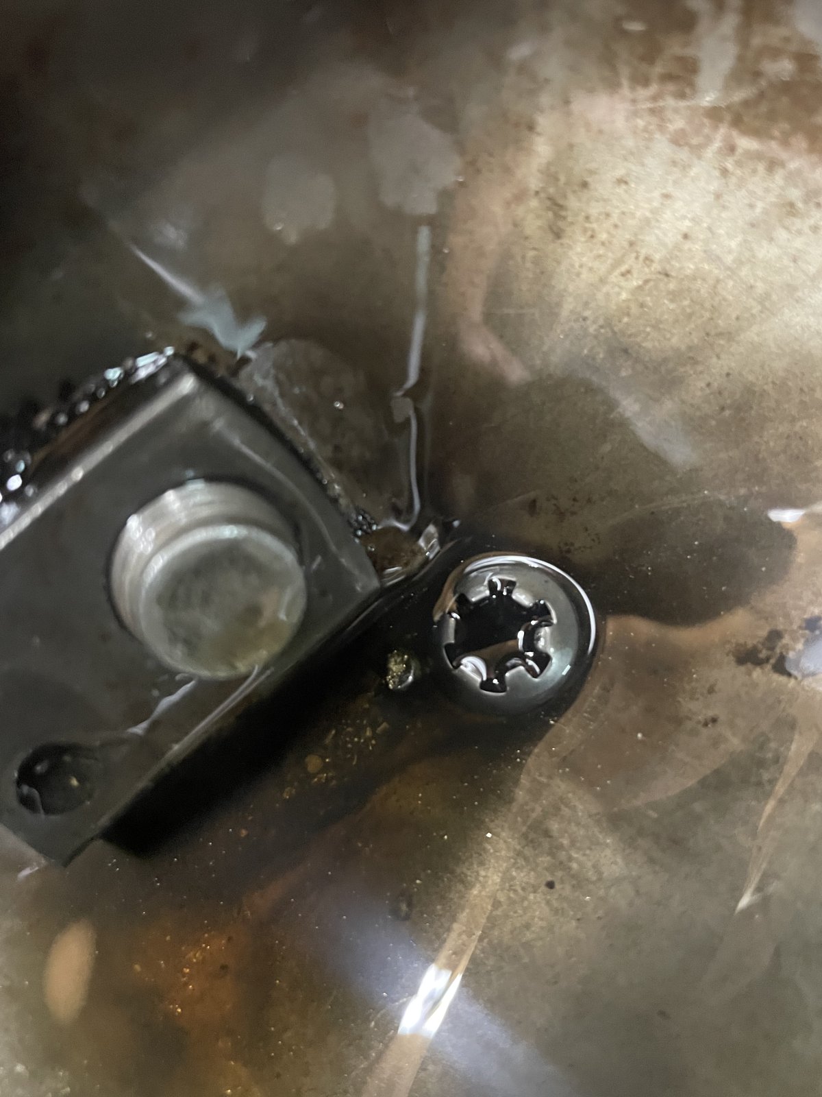

    Hey guys..was running the ‘64 Comet with a 289 to a show yesterday and hit a stretch of road with some serious woop de doo’s in it and looked down and seen NO oil pressure, (no low oil pressure warning light). I shut it down and got towed.
    Apparently The oil pump drive hex pulled out of the pump. Not being a Ford guy I didn’t know that there was supposed to be a clip on that drive hex to keep it from doing this. Found that clip in the bottom of the pan

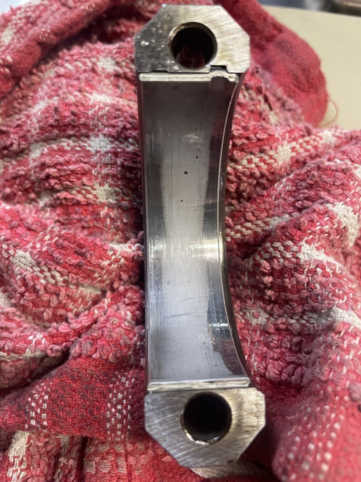

    Drained the oil and dropped the pan, oil seemed ok, some copperish color if stirred up but when I filtered through a paper towel and then paint filters I can’t see or fell anything that may be bearing material. Nothing shines if I hold a bright LED shop light up to the filters or paper towels.

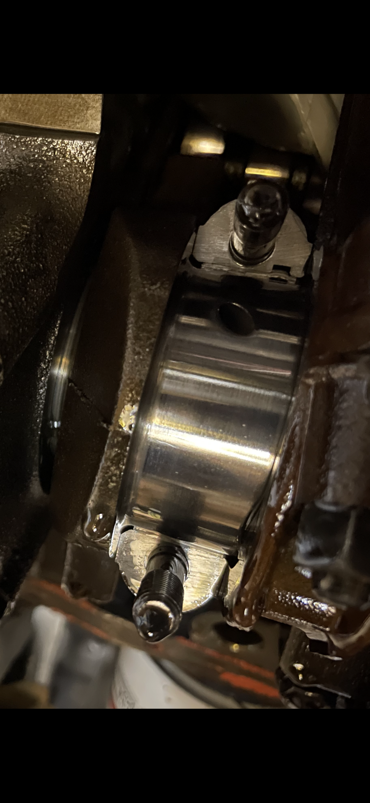

    I pulled a single connecting rod to check bearings but not sure if this is normal wear for a higher mileage 289 of if I have issues and should tear this thing down.

    Looks good to me, in fact if that’s high mileage it looks really good.
    Bolt it back together and away you go.
    Trundling along at normal speeds you’d be amazed at how long bearings last with no oil pressure. It’s why they fed the valve train first on a lot of pushrod motors.

    I'd tend to agree with Tim. Although the edge wear on that bearing isn't what I usually see, it speaks more of the way the crank was ground rather than the result of lack of oil. I'd have a look at the top half of the bearing though, before deciding since it gets more load at cruise. You may have gotten away ok!

    The light gray showing is still the flash-plated break-in coating that is put on new Clevite P-series bearings,
    Someone has been in there before, those aren't Ford issued bearings.
    Is there an undersize marked on the backside of the bearing shell??
    I'd check every rod, and the rear main as it is furthest from the pump....but if they all look similar to the one you've shown you'll be ok.

  6. I'd be way more concerned as to why the drive came out. That clip is only there so that if you pull the distributor, you won't pull the drive up out of the pump. I wonder if the drive has been shortened or if the pump is seized and you twisted it off....
    warbird1, Johnboy34, Malcolm and 11 others like this.
  7. I also agree with chicken and Tim, peek at the upper rod half and if good roll on. Also agree with Steve, that clip does not hold the shaft in.

    Thanks for the info! I’ll check each one and any the tops and see if everything is consistent with this first one.
    I didn’t know if I could pull just the rear main and retorque it without doing it in a new assembly sequence.

    The drive measured 7.450 I seen that’s what the stock length was. Before I dropped the pan I slid a straw over the drive that fit pretty tight and measured from the top of straw to the block and lifted it up until it was out of the pump and it was only around a 1/4 “ to get it to disengage.
    with the pan off looking where that drive key goes in the pump its flush with the casting, not sure if that’s right or if there should be more of that sticking above the casting.
    I was able to spin the pump with a drill before I tore it down and had oil to all the rockers

    Yes, you can check any main without it changing anything, just re-torque it back together

    no pics but I can grab some. one side has a slight chamber and the other side had more of a point. Seems there was a small notch in one side of the hex, when I slide that clip back on it stopped at that notch

    I would think it impossible for an oil pump shaft to fall out once it’s assembled. Check the rearmost connecting rod and main bearing. There last to get oil.

    Thanks for the link, very helpful! I reinstalled the driveshaft with the retainer ring and test fit the distributor.
    I’m running the HEI Chevy style distributor on the 289 which has the longer shaft from the gear down and also has a deeper hole up into the shaft. Even deeper than what the length difference between shafts is.
    I still think with that clip missing on the shaft along with that deeper hole in the distributor shaft allowed that driveshaft to move up just enough and disengage from the oil pump. Again.. not sure if that’s possible but it’s the only logical explanation I have to loose oil pressure after hitting a washboard section of road.

  26. Now it all makes sense if the hole is too deep in the end of the distributor shaft. As Steve says that clip is only there to hold the shaft in the pump when you pull the distributor. The shaft is held down by the end of the distributor hole while running. If the clip has any load on it, it will fail. Maybe a longer hex drive?

    Of course it's possible with a non correct distributor. This ill fitting aftermarket stuff needs so much checking and fiddling to prevent problems...count yourself lucky that big ugly distributor didn't cost you an engine.
    Of course the lack of retainer clip was a big contributor, but still....
