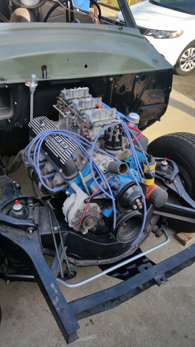

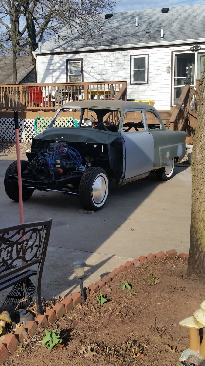

    My buddy put a 302 I gave him in his,I know he had to notch factory crossmember for oil pan clearence but otherwise pretty straight forward,plus he did the right thing keeping a ford in a ford!!! Check out these pics maybe they help you 20150406_171954.jpg 20150406_170920.jpg 20150406_170907.jpg

    Very cool is it a rear sump pan? and what does the rest of the driveline consist of? thanks.

    No,not at all. The oil pan you use depends on the kit you use 15" or 17" and no notching the pan is needed. http://www.butchscoolstuff.com/52-53-ford-car-15-sb-ford-eng-trans-mount-kit-2501cpb/ To guide you through this swap you should be here: http://www.jalopyjournal.com/forum/social-forums/1952-59-ford-social-group.282/re: We have a HUGE information file there with tons of swap info also I just recently added photos of the SBF swap in a '53 that highlights the mounts and headers.You will also find a chart about rear ends that fit,the stock rear would probably hold up in a street cruiser if you used an AOD trans.

    Think it's front sump and it's a c4 with I think an 8" over drive rear

    Click on the link to Butch's,there will be three pictures by the kit the one on the right shows how to do the measurement to determine the kit you will want.15" uses a the later dual sump oil pan and the 17" kit uses the front sump pan, so after taking the measurement as per Butch's diagram let us know the results.I have had members use the mounts from Speedway,but you have to run an electric fuel pump as the mounts are in the way of the manual pump. Here is pictures of a 302 in a '53 using Butch's mounts. The headers are HEDMAN 88400's no alterations are needed and clearance is excellent.
