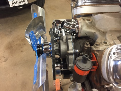

    I'm putting a 302 in a 32. By using a 70's timing cover, 1968 pump (water on the right side so I can use a cheaper Chevy radiator), Speedway's chrome pulleys and alternator bracket and a Y block 4 blade fan I am at 29-1/2" bellhousing flange to tip of fan/water pump snout. If I use a flex fan (shown in the picture) I have to put in a 1" spacer and I'm 30-1/2". With the 4 blade fan it's pretty close to the length of a SBC. I am using a Professional Products balancer to get the 3 bolt pattern for the crank pulley. I will be machining a 1/4" spacer to be used behind the crank pulley to get it all to line up.

  13. Wow that looks great! Thanks for the pics. Question on the water pump do you get that by going to the parts store and asking for the pump off a 1968 so and so? I'm new to this game.

    Just a suggestion but that type of flex fan leaves a lot to be desired,I prefer a steel fan,then you won't have to worry about the blades working loose. HRP

    I just went into my local small town parts store and asked for a water pump for a 1968 Ford 302. They even had a new one in stock. My reasoning on this pump is it's a really common pump and could be bought out on a trip someplace if I had a problem with one. It also lets me run a cheaper Chevy radiator that is easier to find. As a plus it gets the lower radiator hose away from the fuel lines. I'm trying to keep it a simple and drivable build.
    I have already decided to use the steel 4 blade Y block fan because it shortens up the engine a bit more than the flex fan. The flex fan was a leftover from a previous project. I've used them in the past without any problem but the 4 blade just looks more correct for this one. Also using 1964 Fairlane valve covers, not the cheapo finned ones in the picture. Have to run a Mustang II or Bronco pan to clear the cross steering, so the finned aluminum pan in the pics is a wall hanger again.
