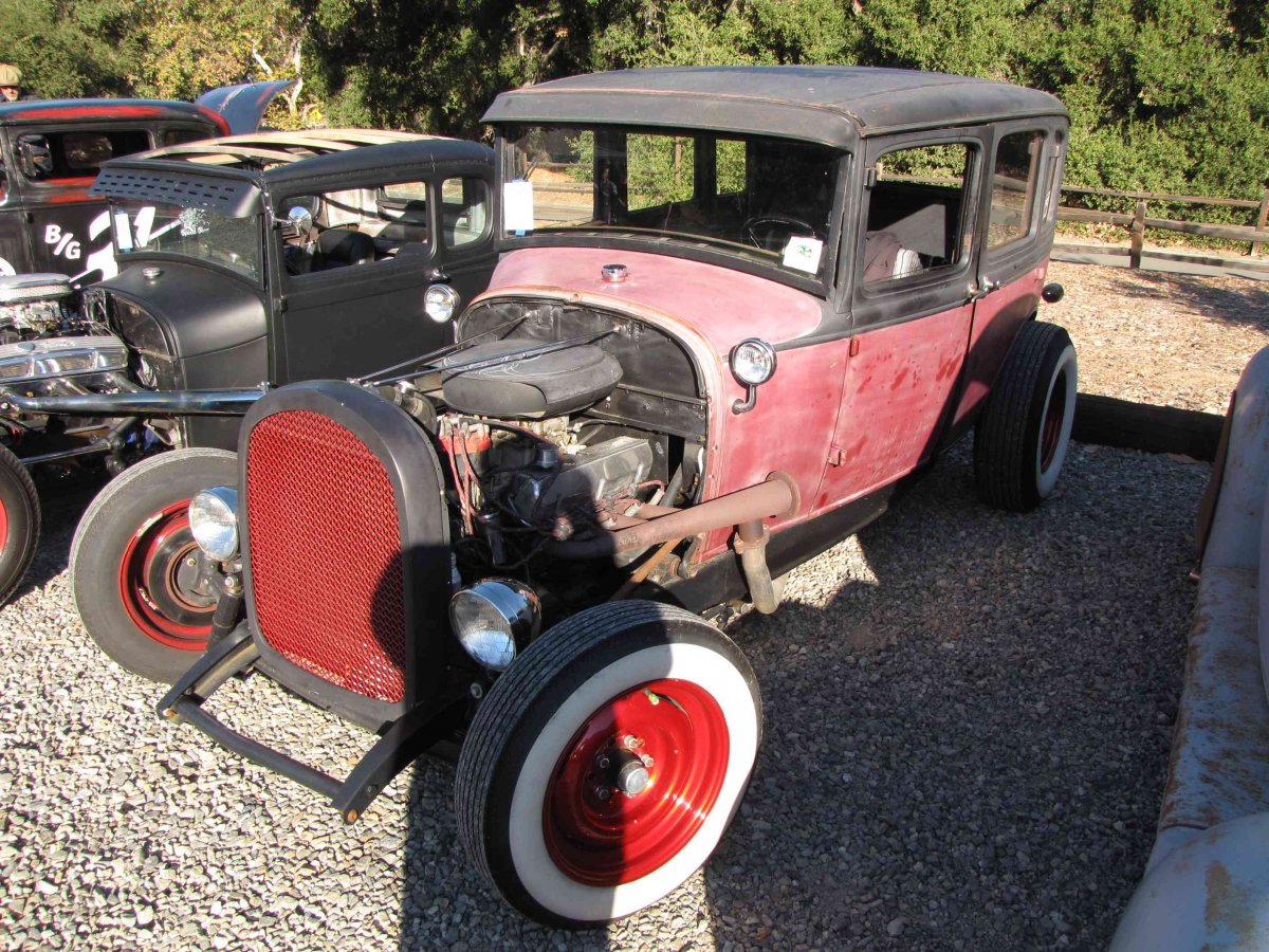

  11. buzz4041
    Joined: Nov 14, 2008
    Posts: 364
    buzz4041
    from Texas

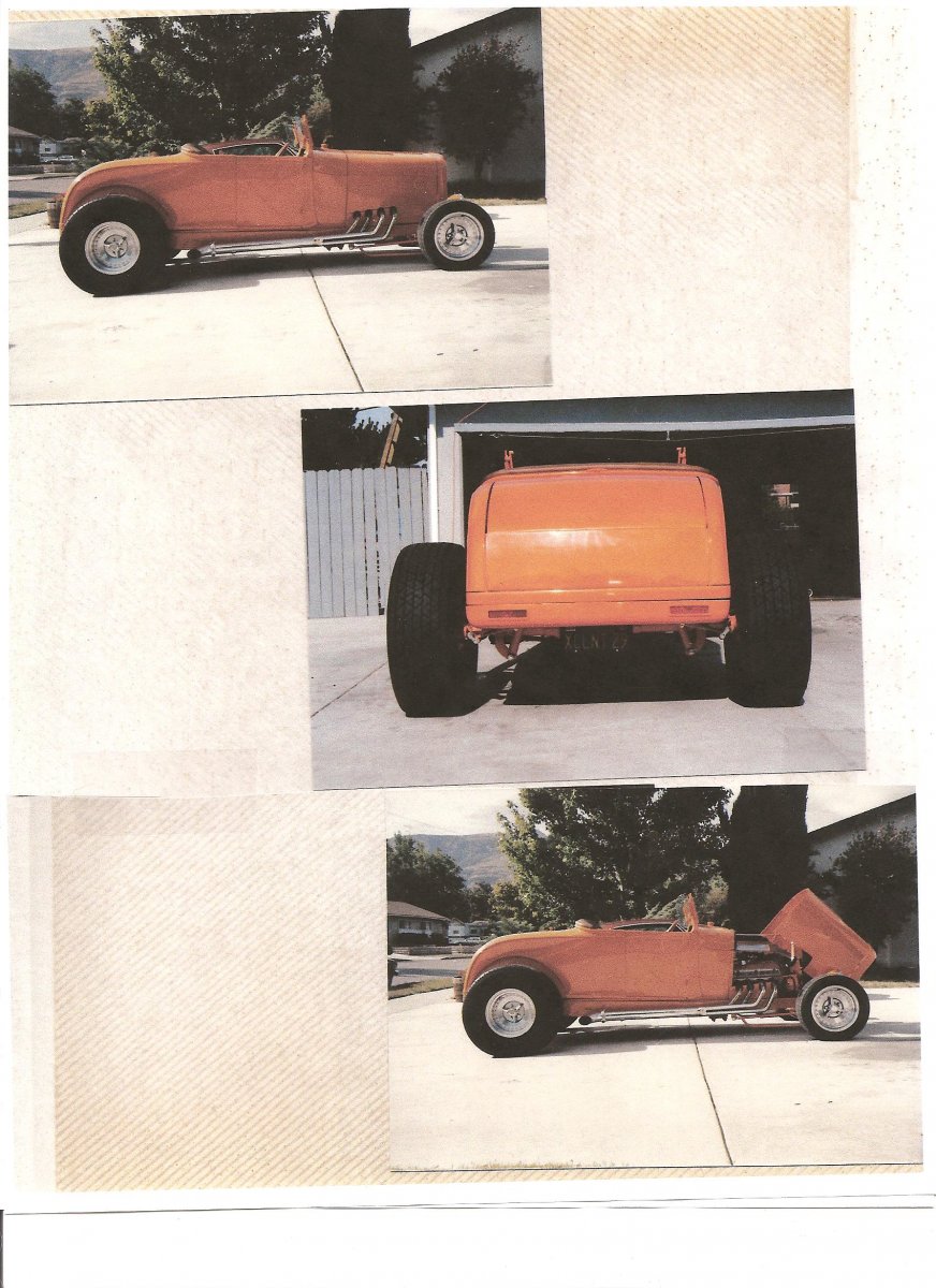

    My brother stuffed one in his A sedan. He put a chebby ****** on it. 001.JPG

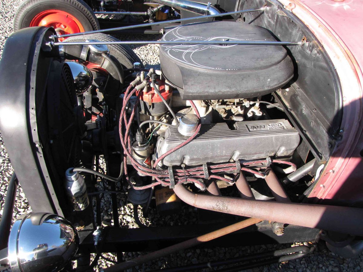

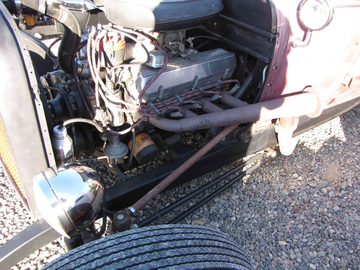

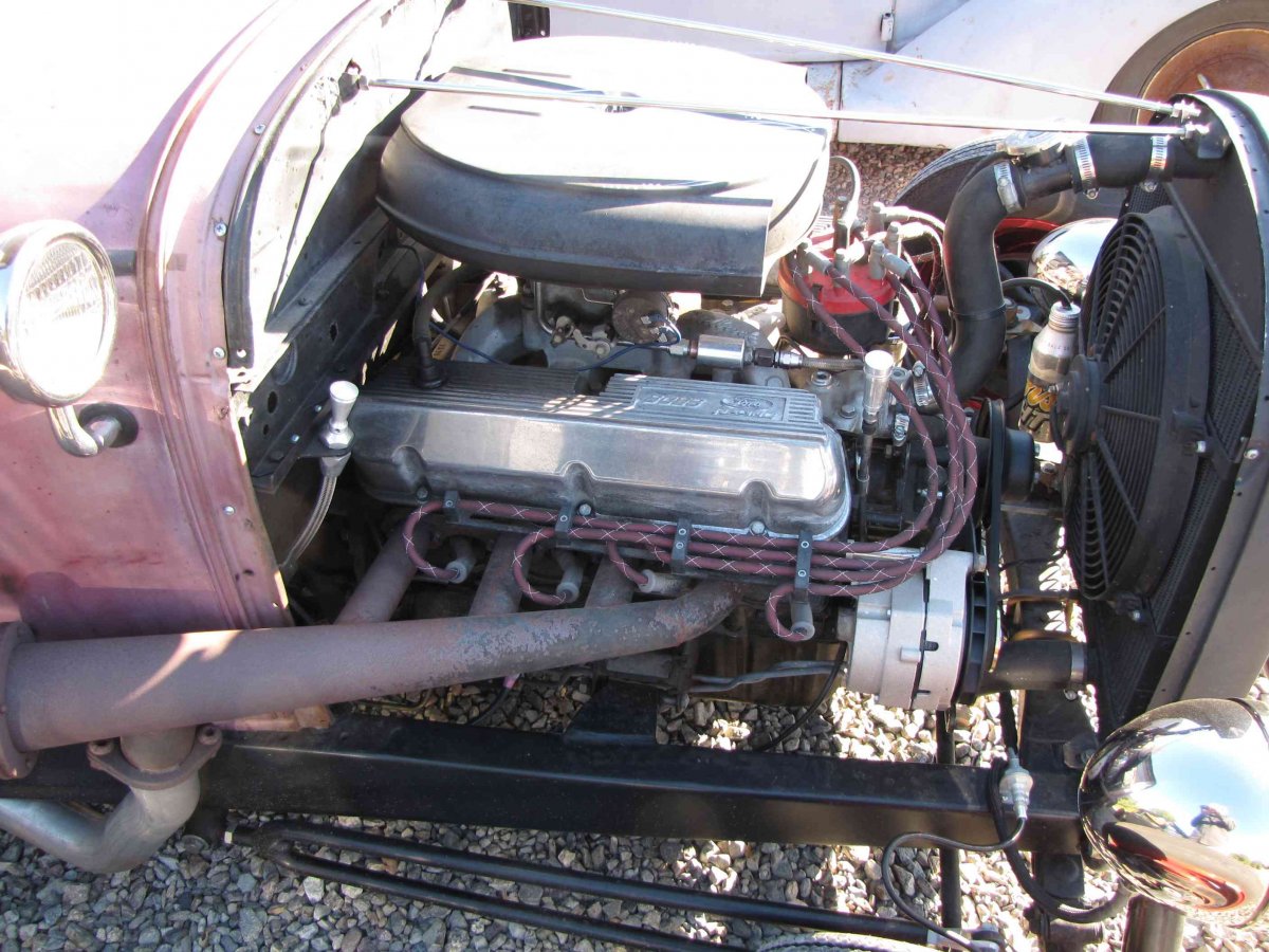

    Saw this at a rod run yesterday and shot some pics to post here, hope they're helpful.
    Note, don't run your pitman arm,drag link like this, it will induce a lot of bump steer.

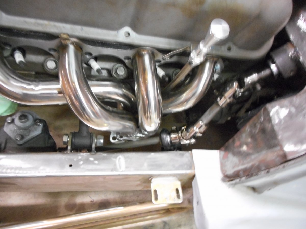

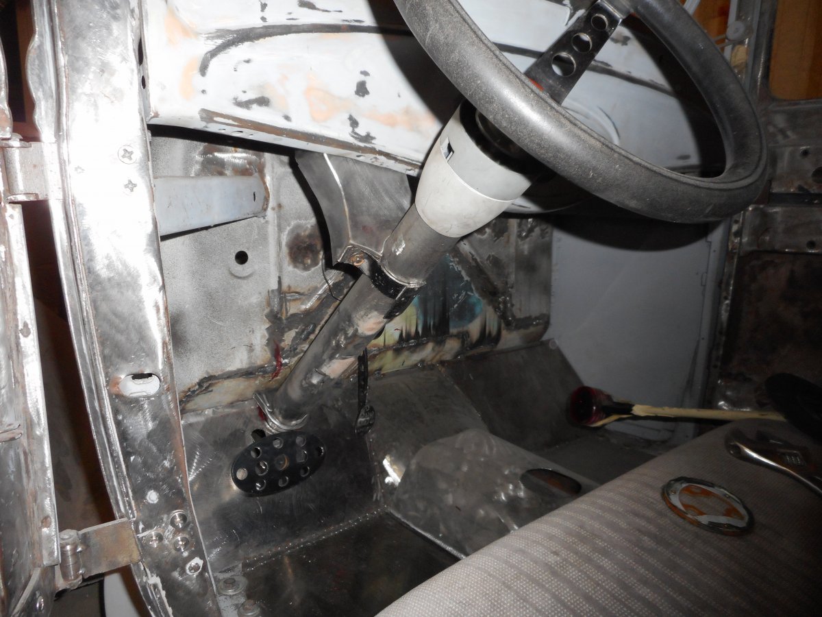

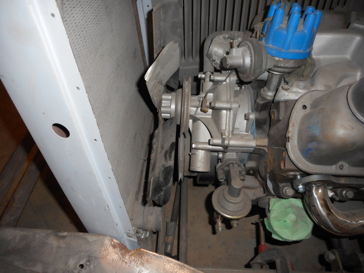

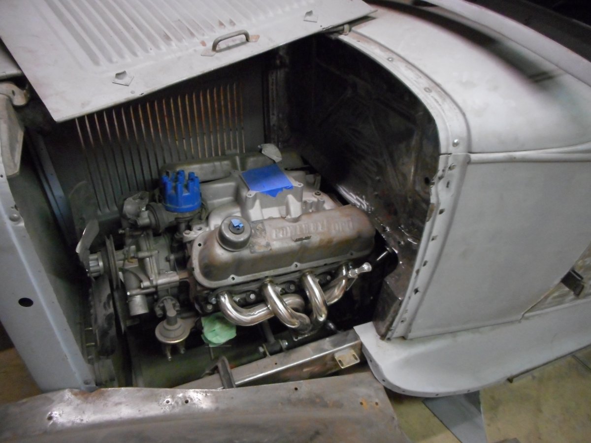

  21. BigKel
    Joined: Sep 22, 2014
    Posts: 11
    BigKel

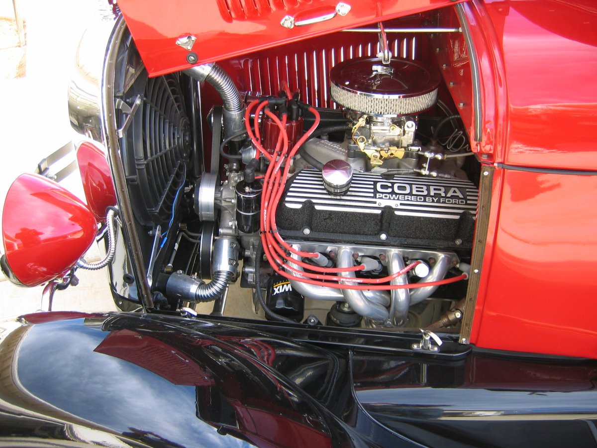

    Here is what I came up with, short fms water pump ( spendy ) and flipped firewall. Headers were hard to find and some crafty steering linkage. [​IMG] [[/ATTACH] DSCN0236.JPG DSCN0236.JPG DSCN0456.JPG DSCN0457.JPG DSCN0458.JPG

    If your going to use headers I like the Ford Motor sports headers. This is for a few reasons and one is where the exhaust dump is and in the back by the firewall and hugs the block tighter so you can run a steering shaft straight . The only u-joint you'll need will be at the steering box . I used a vega box just under the biscuit motor mount so you don't see the steering box just the shaft.. I made my own motor mounts and engine mounts but biscuit mounts are cheap and all over the place . As far as the engine mount I believe it was a 2 7/16 or 9/16 --14 bolts that go into the motor and made a simple bar stock 8 inches long with the 2 holes. And made a simple triangle 3/8 stock that goes to engine and frame biscuit . I will look and see if I have a strange laying around I made a few for buddies. The 90 degree oil filter adapter will clear front crossmember and vega box, it's tight but looks nice when done and thought out.

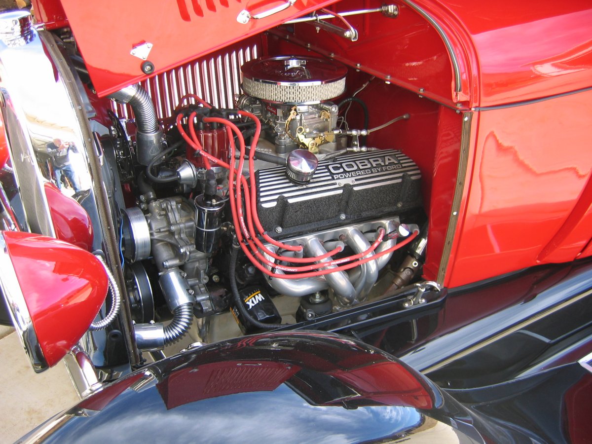

  29. Dave Mc
    Joined: Mar 8, 2011
    Posts: 3,082
    Dave Mc
    updated from 73 302 to 87 5.0 . thicker timing chain and cover required newer shortie water pump from Ford Performance ,which runs clockwise with the crank , also running a C4 trans. 87 engine requires 50 oz external balance flex plate , getting the right flex plate took some shopping , went back to points condenser distributor so had to change dist. gear from cast iron to steel gear to mate up with billet steel cam.
