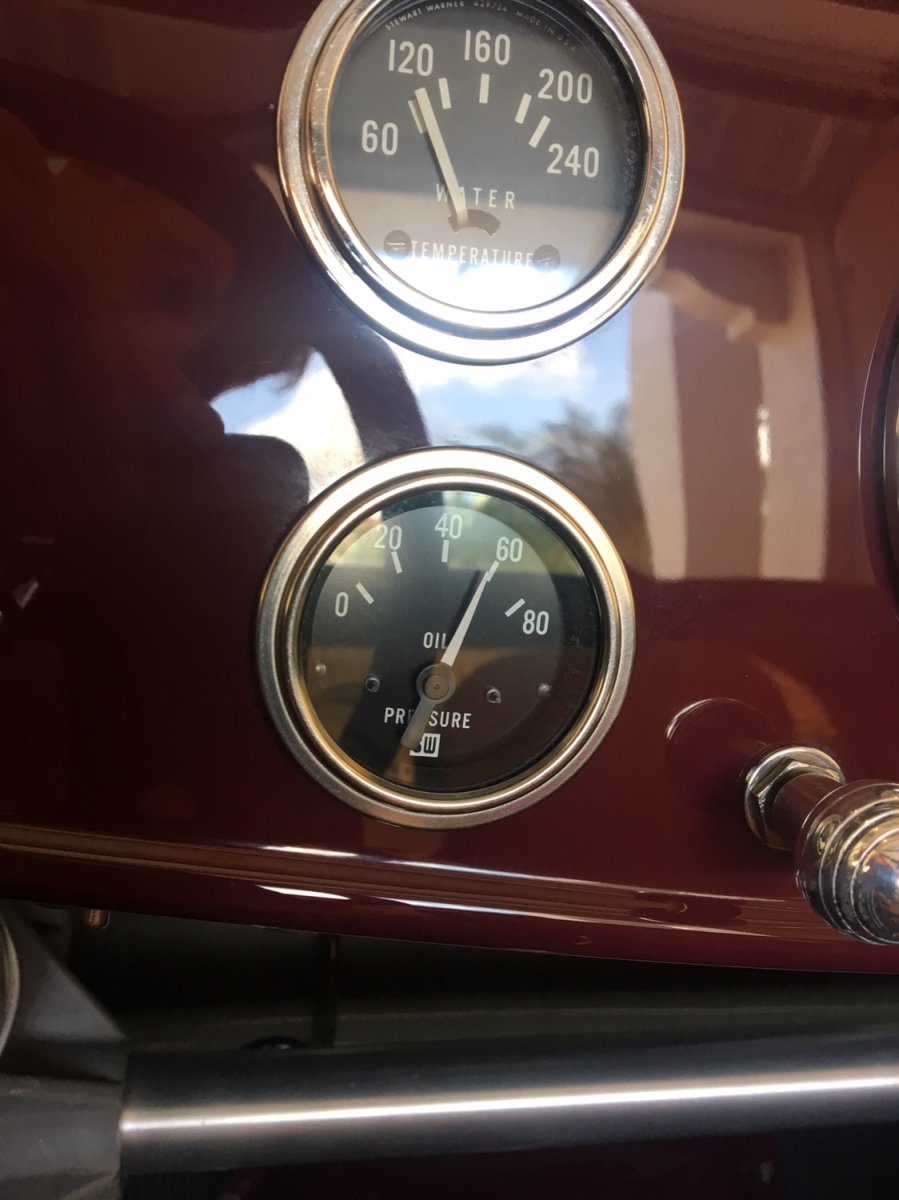

  14. stegman
    Joined: Aug 12, 2008
    Posts: 42
    stegman
    I started it this morning and the oil pressure jump right up at 55 and 40 hot at idle. Oil looks clean and sounds good. Going to run it a little, drain the oil and cut the filter open. Hoping it looks clean. Hopefully just a bad bearing install or defect in the bearing. Thx
