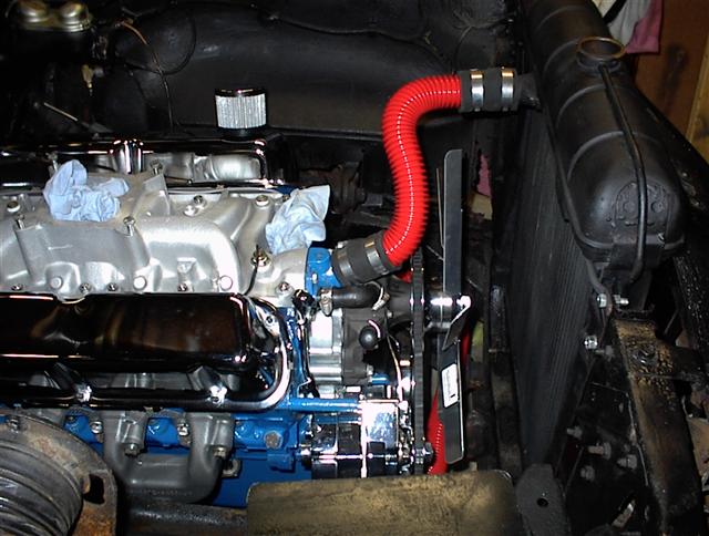

    I know right? When all this is said and done, Im gonna be spending probably over $400 just replacing a harmonic balancer, timing cover,water pump and purchasing custom machined pulleys that are overpriced..what a friggin PITA!!! Now I know why my comet had a Chevy motor in it when I got it....:mad
    Oh and spending $300 plus on that Snow White stuff is insane considering the damn belt rubs on the hose when you install it..(true, its right in their instruction manual..)

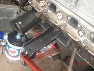

    Here are some pics of the motor mount progress, They were tacked in and Im gonna need to drop them about 2.5" yet..Then the bushing will raise it back up about 3/4"..

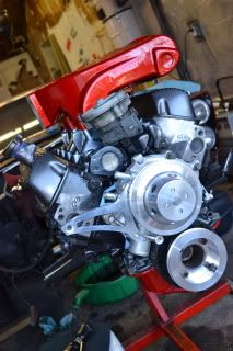

    The short damper I spoke of from Speedway is http://www.speedwaymotors.com/S-B-Ford-Harmonic-Balancers-and-Pulley-Spacers,1802.html and comes in 28oz & 50 oz,you don't want billet pulleys? here is a cheaper option http://www.ebay.com/itm/V8-FORD-CHR...ies&vxp=mtr&hash=item3cc09ce839#ht_3220wt_954 about a 1/3 of the price of billet here's the water pump http://www.autozone.com/autozone/pa...?counter=1&itemIdentifier=72037_193802_0_4548 or go cheap the rebuilt with core is $24.99.About 1/2 of $300 for those on a budget.As for SBC's being cheaper they also had short and long pumps and cause the same problems as well as the change in alternator locations to deal with,SBC's also made a lot more pulley changes so you always need to get them in matched sets or be very damn lucky.If you take a look at the second to the last picture DajerseyRat posted you see the Ford long pump below you will see the Ford 1965-69 pump and how much shorter it is.All three pictures are 54' Ford 302 installs.

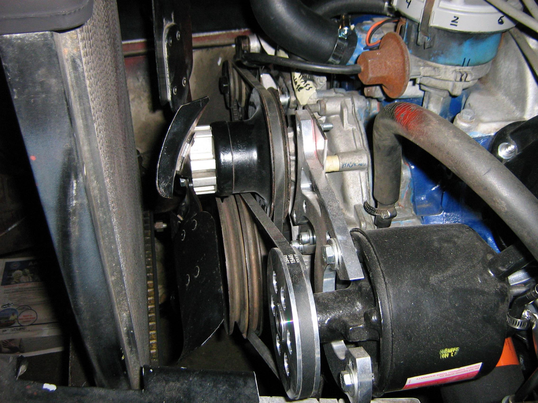

    i used a 69' pump on 78' 302 and had the same problem. Days and days of playing with pullys. I also made a new alternator mount to run a GM 3 wire.
    Heres some pics. I cut down a water pump pully on my lathe and then trued it up for welding.

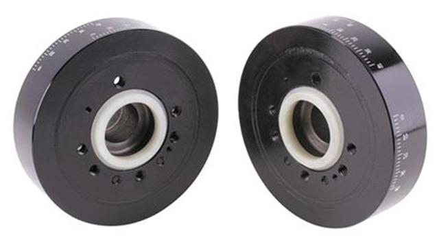

    This is not a problem using the Professional Products balancer I referred to in my original post(post #5 in this thread),this balancer has all three of the timing marks Ford used engraved into it,you can use any pointer you want.If a lot of you would go back and read it,all the information you need is right there in black and white and your SBF headaches will be over.
