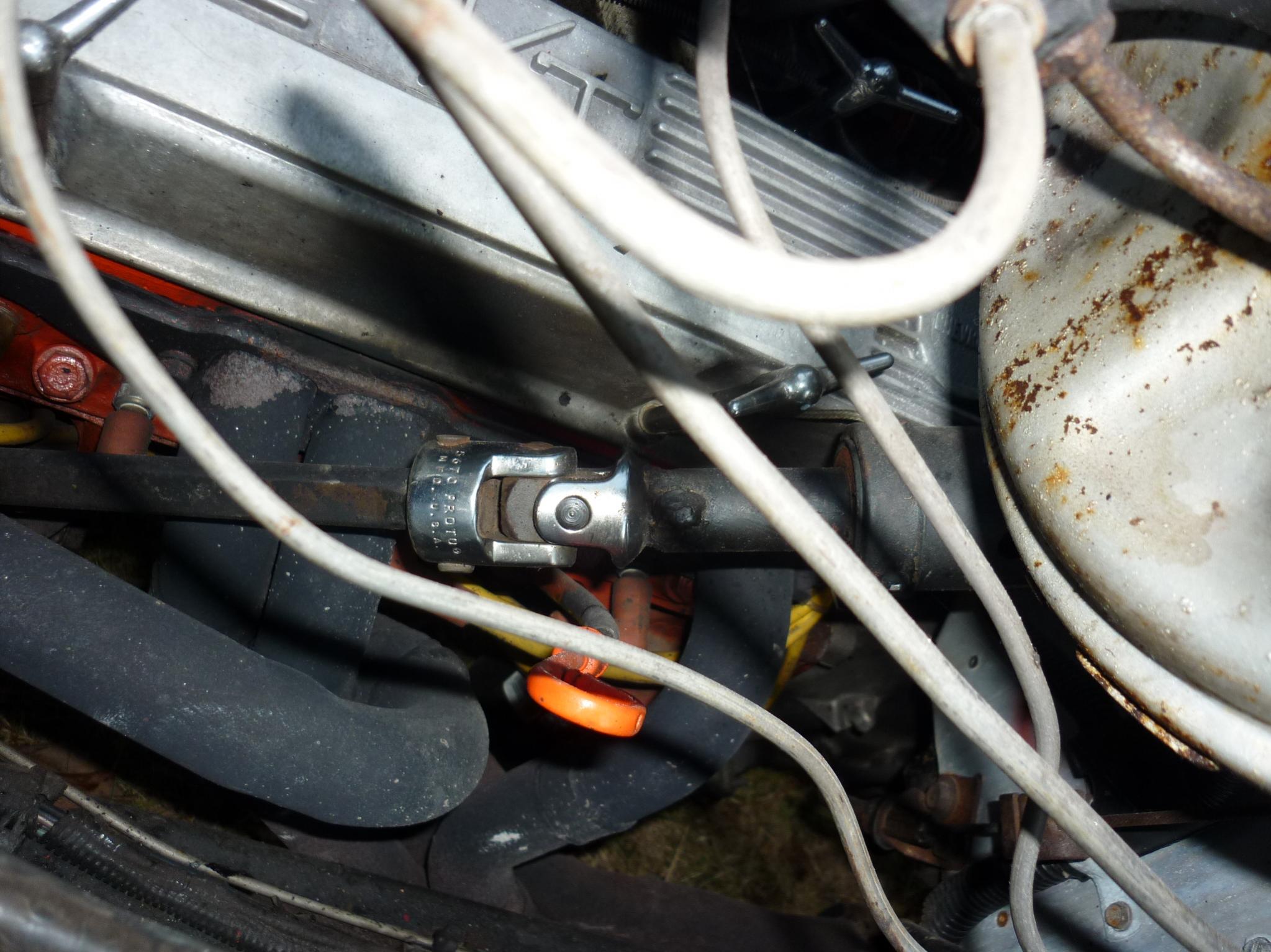

    I had to work on this 38 Nash to remove the sunroof and doing the tailpan and while inspecting the car i found two socket joint welded in the steering shaft, the new owner told me the car was built in the 70 and could explain the scary stuff.The car will be totally rebuilt once i'm done with it.I hope they will replace the wheel also.:eek:

    don't worry, it won't hurt anything when it falls apart. being able to steer is over rated.

    A Ha Ha Ha Ha Ha---------Haha ha--------haaaaaaa! A Proto and a 3/8 rod coupling, classic! HaHa, this is like a what not to do course. It's fully covered.

  7. Now, with a proper suspension/steering box set up, how much torque do those joints actually get? I'm pretty sure my 600ft lb air gun does more than they should - and i have yet to brake a joint...
    not saying its right either, just for consideration.

    Well, I know those rod couplings fail if you hang a 400 pound gas pipe off of them overnight, sounds like a bomb went off when a 400 pound gas pipe hits the floor at 2 AM, I can't really elaborate much as to how I may know this, you might have to trust me on this one.

    I am reluctant to admit that when I was in my teens I stick welded in a 3/4 drive, 3/4" impact universal in the steering shaft of a car I built. At least I used a Snap-On socket!:rolleyes: It didn't bother me much until I learned enough to understand all the reasons why it was a bad idea. I guess that's covered by the phrase "ignorance is bliss".
    It's not uncommon to find scary steering on cars that were otherwise done pretty well. I have fixed quite a few, all of them worse than the car pictured. I'm not sure whether it's because people don't know any better, don't want to invest the effort to do it right, or don't want to spend the money.

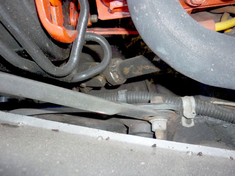

    I could see this happening in the 70's, maybe the builder figured this was the best he could do to solve a problem. And it has held up this long.... Curious to see how long the owner ignores this and continues on with the body work. So did they drill an additional hole in the steering knuckle for clearance or to make it harder to steer? I've never seen that before.

    I saw an MGB with a small block Ford in it back in 80-81 that used the same Craftsman wobble socket steering joint. The car was very nice except for that, so maybe some magazine was promoting that at the time. Very scary, as I've broken them with a 3/8 ratchet and a tight bolt.

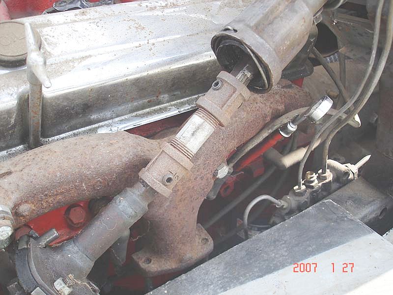

    Here's one, shown next to the replacement, that I found in an FJ40 Land Cruiser:
    The customer complained about the steering being a little vague. It was u-joint, to a rag joint, to a telescoping section, to a wobble joint, to another u-joint.
    Added bonus: NO SUPPORT BEARINGS!

    9 out of 10 of us are thinking thats fucking scary. The other guy just figured out how to get the wheels turning on his project without an expensive borg joint.

    That is likely the original steering arm/spindle. One of the holes is for the tie rod to the steering sector, the other is for the tie rod to the other steering arm/spindle. Very common on cross-steer setups. This appears to have been converted to a rack and pinion, so the "extra" hole isn't required.

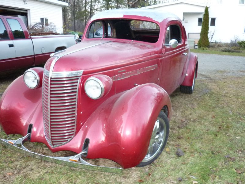

    I would wonder about the driveline mounting, probably a lot of little stuff wrong like the front blinkers. Tall sidewalls on traditional wheels, trim rings & cool caps. It's a beautiful coupe, lots of nice parts, just need's to be sorted out. Hate Foosish wheels, belong on something like a Cobalt (someone else's) IMO
