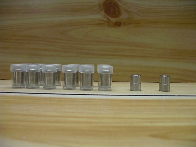

Just finished having a few dozen crank pins made for both the factory cranks (.438" x .4675") and the aftermarkets (.439" x .4675"). The Eagle shafts definitely use the .439" size for the correct press-fit, not certain about the Scat shafts. Would need an accurate hole size on their's (measured with a bore-guage) to determine which dowel size is required? Thanks, Gary in N.Y. P.S. Highly recommend using the dowel pins and NOT relying on the bolts only to keep things correct! Some maintain the pins aren't needed, we feel Ford put them there for a reason?
