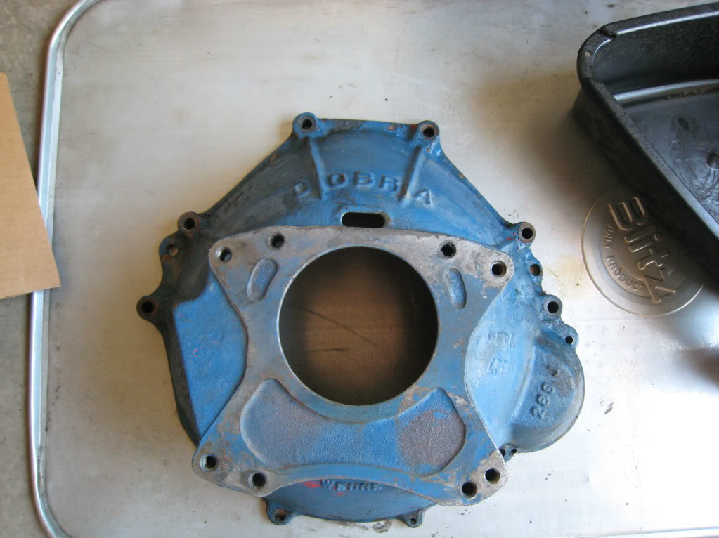

  7. falcongeorge
    Joined: Aug 26, 2010
    Posts: 18,339
    falcongeorge
    from BC
    If you go looking for one of these, be prepared for some SERIOUS sticker shock...No, this isn't mine, its an internet photo

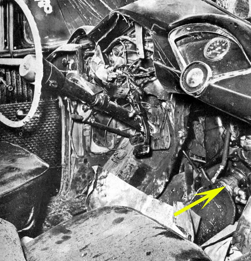

    Here is an excerpt from a story I wrote for the WDIFL web site. It is about our 40 Willys destruction in the finals of a C/Gas race at Lions in 1960 which ended our drag racing involvement. My brother was at least two car lengths ahead of the cl*** champion when the clutch let go and the flying pieces went everywhere. They went everywhere, even into the legal, approved Moon fuel tank bolted to the floor in front of the p***enger seat.
    "...The following Sunday, Atts Ono and I went back to Lions to see what happened to our 40 Willys. The car was a burned out hulk. The fire did a complete burn and melting of the interior. The seats were just wire and metal, the moon tank was gone, survived by a couple of nuts and bolts in the floor, the glove box door was half gone into a melting mess, etc. The worst thing we noticed was that there were metal chunks wedged into the top of the dash, near where our tachometer used to be mounted. The doors also had metal pieces wedged into the window sills. There was a huge hole in the floorboard where the ****tershield just flew out somewhere. We never knew where it went. It was a scary sight to see such destruction in the bright sunlight..."
    [​IMG] The best thing to come out of this destruction was the new rule that went into effect moving all interior Moon gas tanks outside. No Moon tank inside, no fire, just flying clutch and ****tershield pieces wedged into almost every nook and cranny from a stick shift unit. This was late 1960 and the landslide from this ruling moved a lot of racers into the B&M, C&O, or Cal Hydro camp.
    If we had continued racing with a new build, we were going to a B&M or C&O stick hydro. The only reason we put in a C&O in our 58 Impala was the initial conversion cost was less at Gino's C&O shop. (B&M at the time did not do stick to auto conversions) The stick hydros tend not to blow up under a 671 SBC horsepower.
