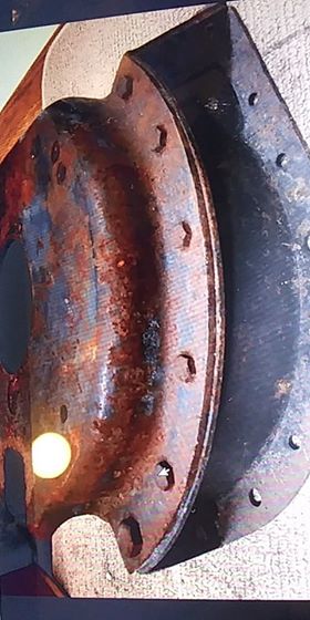

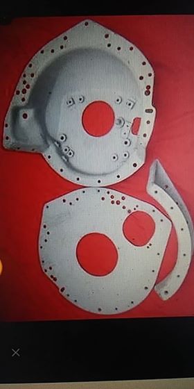

    Been a while since i have been here, been busy as we all usually are. if this needs to go somewhere specific, please redirect. I am hoping that someone knows who made this ****tershield, supposedly for a 55 through 83 Vette, but looks to be multiuse for any Chevy, I am hoping it will fit using a 168 tooth flywheel on a big block. a primary concern is that the block plate is not with it (gray pics from the net), and I would like to know if it might be safe to install without it. Any ***istance is greatly appreciated, Thanks, D.

    By "safe" do you mean it will protect you from any danger? or that it will p*** tech at some particular race venue? Or that you'll probably be OK driving with it, on the street?

  5. With all those holes it looks like a fitzall.

    I have to agree it is a BOPCCFMLAMCEH. And whatever you want it to fit just drill the holes. As for what that stands for is; Buick, Olds, Pontiac, Chevy, Cadillac, Ford, Mercury, Lincoln, AMC, Edsel, and Hudson. So yes it will fit on a Corvette as Chevy was mentioned.

    Since it is a two piece, it's probably old, likely designed to fit the large flywheel. Better pictures would allow us to see more. But you don't have better pictures

    I tried the 55 to 73 cast iron chevy bell housing, it fits the bearing retainer, but the other holes dont line up to mount the ******, even drilling and taping the case wont work, which is what led me to the steel ****tershield bellhousing, which like you said is easily modifiable.

    I will post the rest of the picks, I have to photograph them with my phone due to all the internet propriety stupidity.

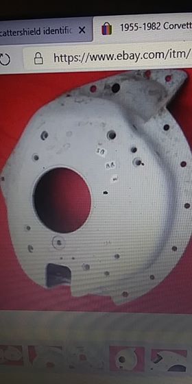

    Coincidently, this ebay item posted at the same time mine was removed for sale, but hopefully it answers the question, since it has BB and SB taped on it. And the two piece design was why I wanted it so I could change the TOB and clutch disc without pulling the bellhousing, I can rest the input shaft of the NV4500 on the bellhousing without completely having to drop the ****** and transfer case.

    The sm420 is indexed to 4.686 inches, sm465 is indexed to 5.125 inches, and the sm465 bell housing is the same as an sm420 bellhousing, with the major difference being the large round opening is larger on an sm465 housing. Early Chevy NV4500 is indexed to 5.125 inches, while later chevy and all dodge nv4500 transmissions share a common bellhousing mounting pattern indexed to 5.60 inches.

    What I personally think the problem is, is the flat faced throwout bearing riding on the peak of the clutch disk, with no freeplay built into the system. Chevy used three t/o bearings short, cc1705c, medium G1625C tall 1697C, the first two are flat, the last is rounded. Stole that image from someone here, net didn't say who. I got the bellhousing in the mail since I last posted, and have taken it to the machine shop where they drilled the holes, working on getting it installed, will post as events occur.

    Well, I got it, and it bolted up, the ****tershield is 1/8 of an inch shorter than the factory bellhousing. No conflict with the bigblock standard flywheel. Because the truck is a 94 GMC, I moved what I am going to be doing over to the GMT400 site.
