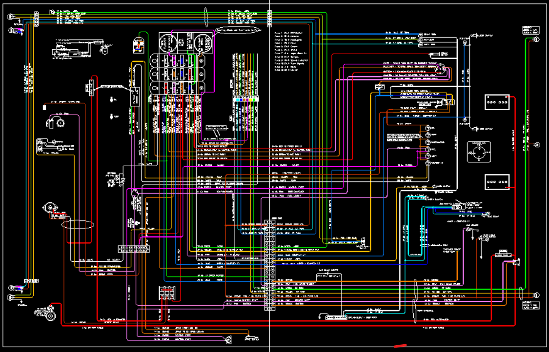

    If you have 12 volts coming into the switch 24/7 , why have an additional “ switched” 12 volt coming in, only when the ignition is on. Most cars I have dealt with, the ignition has no effect on the light switch. I guess there could be a reason you would only want a light on when the ignition is on, using a double pole switch. It has been a while since I worked on a car light switch!
    Bones

  3. Boneyard51
    Joined: Dec 10, 2017
    Posts: 6,805
    Boneyard51
    Well there’s got to be a reason! Lol It just escapes me now. Maybe he had his own reason for something special?

  5. Mimilan
    Joined: Jun 13, 2019
    Posts: 1,274
    Mimilan
    Most ignition switches are designed to switch off the accessory circuit / headlight circuit when cranking the engine over.
    Leaving the headlights on with a continuous feed while cranking would kill the battery
    There is a "P" provision on the Headlight switch.
    Whereas the taillights work with Park and Headlight positions.
    A lot of cars also require the Ignition switched on for stoplights to work, which is a car guy hazzard [especially for those that need to tow rope their cars home on a regular basis]

  8. Boneyard51
    Posts: 6,805
    Boneyard51
    Ok, I get that about the cranking, but wouldn’t the light stay on while cranking if there is a non switched feed coming into the headlight switch.
    Or does that wire from the ignition switch only becomes hot while starting and kills the power to the lights during starting? I have seen that feature on some OEMs. That would make sense to me. But you would need a light switch that has this feature. For sure.
    Bones
  9. The headlight switch in that diagram looks like an early '50s Ford headlight switch. It used two different power supplies. One for the headlights and the other for park, tail and dash lights, or something like that. :confused:
    Boneyard51 likes this.

  14. RICH B
    Joined: Feb 7, 2007
    Posts: 6,129
    RICH B
    Brake lights are normally powered from an un-switched source. 4 ways, too if you go that way.
    Signals are usually fed from switched power so you don't leave the car parked with a blinker going.
    Many OEM headlight switches have two un-switched power sources; one fused to suit the tail/dash lights, the other heavier fused or circuit breaker protected for the headlights.
    Aftermarket switches usually have only one power; some people add a fuse after the switch for the tail/dash lights.
    Never have seen a car where the headlights go off when cranking; maybe new computer controlled cars do that. Pretty common to check a no crank problem by seeing what the headlights do when cranking.
    Wiring doesn't have to be a mystery and scary; just look at one circuit at a time instead of the whole thing and you can see how it all works together.

  17. Canuck
    Joined: Jan 4, 2002
    Posts: 1,104
    Canuck
    Drew this up when wiring my Model A coupe. Is'nt really elaborate as far as wiring goes but details color and gauge and is laid out roughly by location in the car. Used a Rebel kit, but basically a economical source of coloured wire in various gauges. Prints out on two 8 1/2 x 11 pages so it could be carried in the glove box in the dash.
    Handy for troubleshooting and a good source of info for the new owner.
