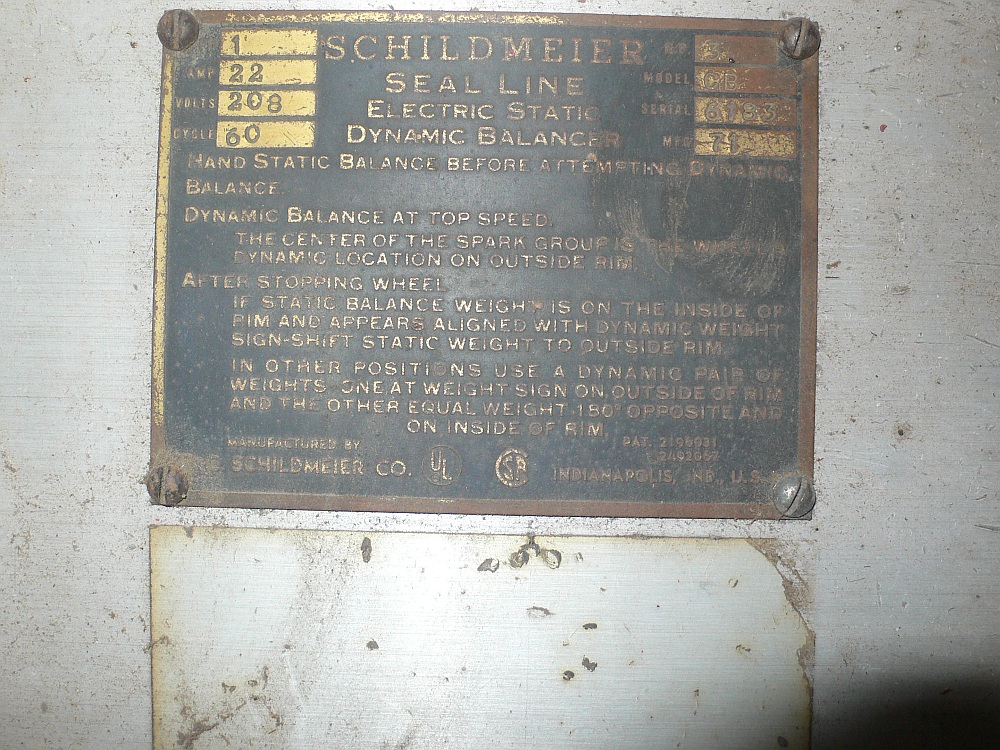

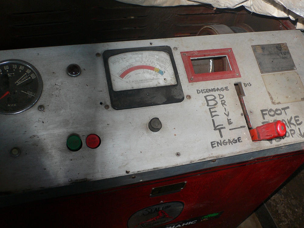

    OK guys-n-gals, I have this Schildmeier Seal Line wheel/tire balancer probably late 50's early 60's vintage. How does this thing work? it spins, it sparks, what the heck does it all mean? "School me" You wouldn't have a copy the operating instructions would ya????? Thats a Dunlop Mga wheel on machine, I turned an adapter for english knockoff style hubs, like Brown & Gammons recomends. Thanks for your help! tt

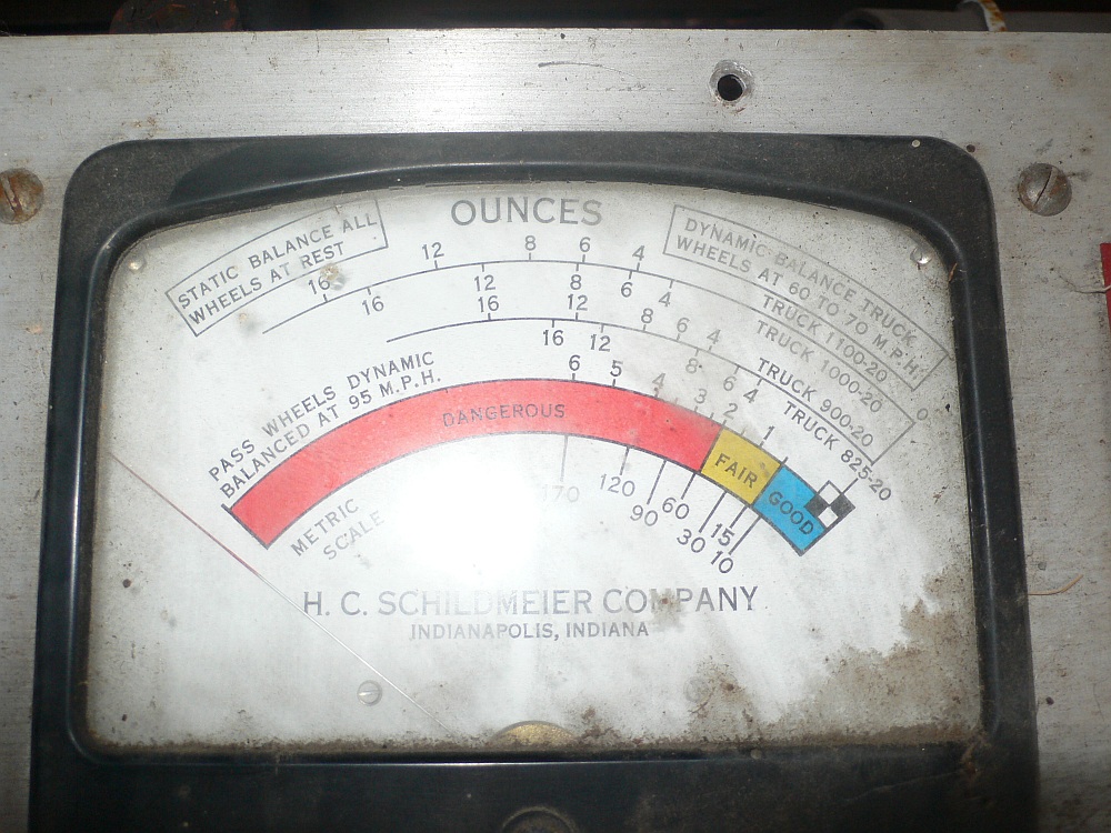

  3. if iam not mistaken it is real easy to use first do the static wieght by letting the wheel drop to the bottom and then moving it up to9 oclock get it so that the wheel can be placed any where and it stays put after that pull the handle back and put your finger on the nob it should be black and if the tire is in balance it wont vibrate if it is out u then have to dynamic balance the wheel one wight on the inside and one on the out side the wieghts have to be of the same wieght it is a great balancer
    and they are balanced to about 140.mph use the clock method to apply wieghts

    Thanks for the reply (doaaaah i missed it yesterday). I guess what I'm having a hard time with is the out of balance will always ends up on the bottom? That's where the weights go? The shaft runs true, I've been using a dial indicator to check run-out and repairing some dings. I will be bolting it down, it has been sitting in a corner here for 10 yrs at least. Haven't thought about this before, will it do motorcycle wheels? Damn I can't remember shaft size??? Thanks again for the help! tt
  6. take the tire from the 12oclock position and move it to the 9 oclock position the tire will move up
    to the 12oclock position on its own thats how u judge the amount of static wieght u put on u can put the wieght on the inside genraly one wieght a good starting point is about 1 to 1.5 oz some too lots like 3 oz then spin it up and ad equal amounts of wieghts one inside one outside oppeset to each other

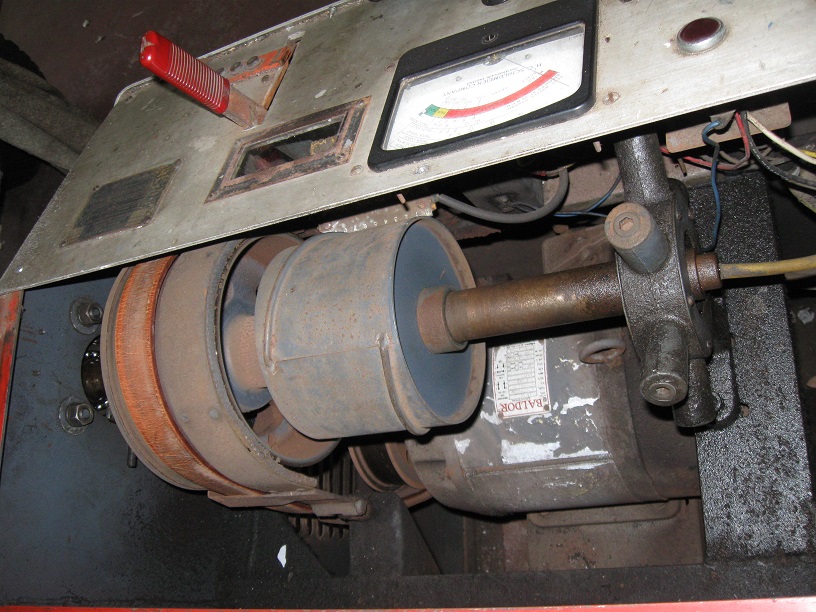

    pic's And I have recently inherited a tire balancer from my dad. This is the same machine I used to use all the time when I was growing up and back then it would work really good until one day the old man made an attempt to make the machine more sensitive by adjusting the spring tension on the main shaft. At least that’s what he said he did, back 20 years ago. Everything works, its just that the sparks on the worm gear are not in a close group. Do any of you have a manual or know of a link to a good site? Please share your knowledge and/or experience, any help will be appreciated.

    On the inside of the shaft there are five set screws to adjust the spring tension. The outer side has two. I was thinking of putting a torque wrench on the set screw to get a torque setting and then making sure they are all the same. Then I can try more or less tension on the springs. What do you think or what would you do? I am anticipating that once i mass with the set screws I'll have to remove them and clean up the treads.
