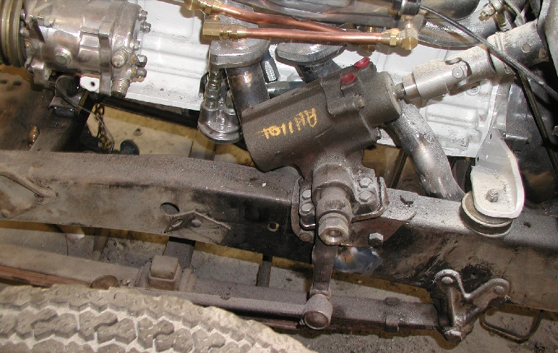

    Here is a 1950 Chevy pickup power steering conversion [being advertised on the net] It is a recipe for disaster [with the spring and the drag link arcing opposite each other]
    If The OP's pickup requires an outboard mounted steering box [as above] I would suggest a Mitsubishi L200 /Pajero/RWD Sigma power steering box for a RHD vehicle.
    The sector shaft is on the RH side of the frame rail, and the steering shaft is on top of the frame rail
    The Pajero also has a telescopic steering shaft with universals at each end [it will bolt onto the L200/ Sigma box]
    here is a RHD Sigma power steering box
