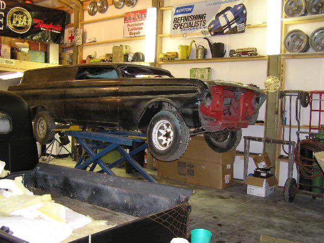

    The SBF from a late model mustang is a nice bolt in, especially if you keep the T5. A 8" or 9" is a nice swap.
  23. My Falcon is getting a SBC one day. In the back!
      78.9 KB
      149

    Tinbender...Now thats a cool lookin ride but please don't put a sbc in that Ford....
