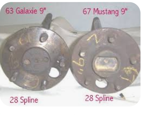

    OK so I figured out the rear end in my 56 T-Bird has been changed to what I think is a 9" Ford p***enger car. It has a 3.70 ratio according to the tag. Which makes sense as my speedometer reads way high. From what I have read to work in a T-Bird you need to use lowering blocks with the p***enger car rear, which my car already has. Also what I have read, they either have 31 spline axels or 28 spline. Is there anyway to tell which I have without removing one? I need to change it to a 3.30 ratio, to get better hi way speed, and there is no speedometer gear for my auto trans for the 3.70. So I think I should look for a pumpkin with a 3.30 ratio. Thoughts? Comments. 3.70 Ford 9".jpg ratio. What cars and years can I get a pumpkin with the 3.30 ratio from?

    Not absolute but usually the hub end on 31 spline axles are solid with two small holes and 28's are dished.

    Screenshot_20230805_210659_Google.jpg usually like the one on the left. Google it for better info though.

    I have never seen a 9" axle like the one on the right, only 8". That one can be used in a small bearing 9" housing, but you need to have the backing plate and drum to match.
    tommyd, Bandit Billy and BJR like this.

    Me either. I didn't notice the writing on the axle until you mentioned it. All I've seen are the solid drum register variety like on the left.
