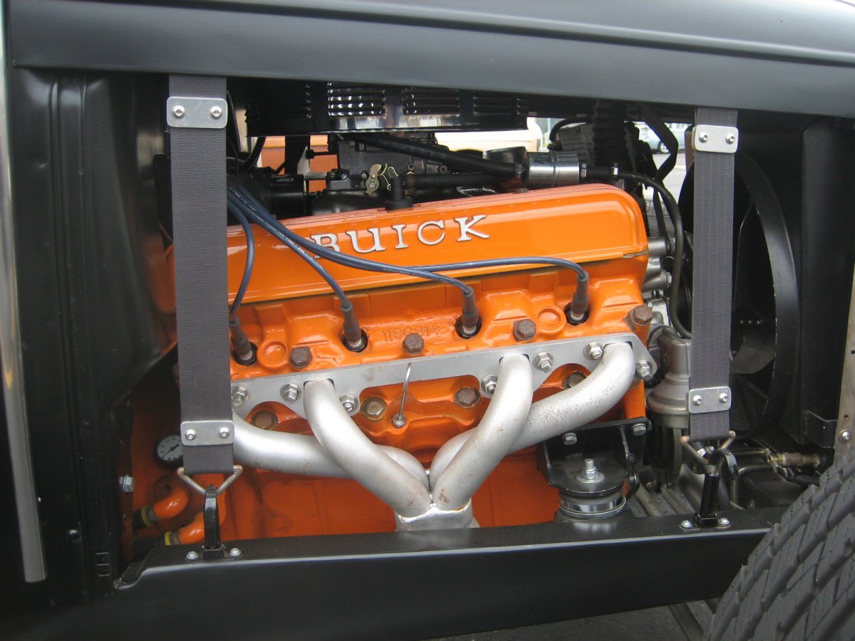

    401 with BW 4sp. Bell and flywheel from Russ Martin. Super fun to drive! MarchMeet15 002.JPG MarchMeet15 003.JPG
