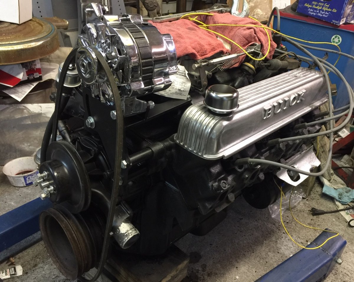

    IMG_4018.JPG I found my manifold in CA!! Be here next year!:eek::D
    As you can tell, the sprucing up of the Gran Sport engine is coming along and the valve covers have really perked up!:)
    That's an Allen Grove bracket holding the alternator. He has a number of options... add that to your school notes.;)

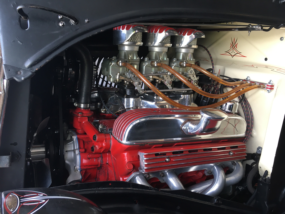

    A bit late, but here's mine....

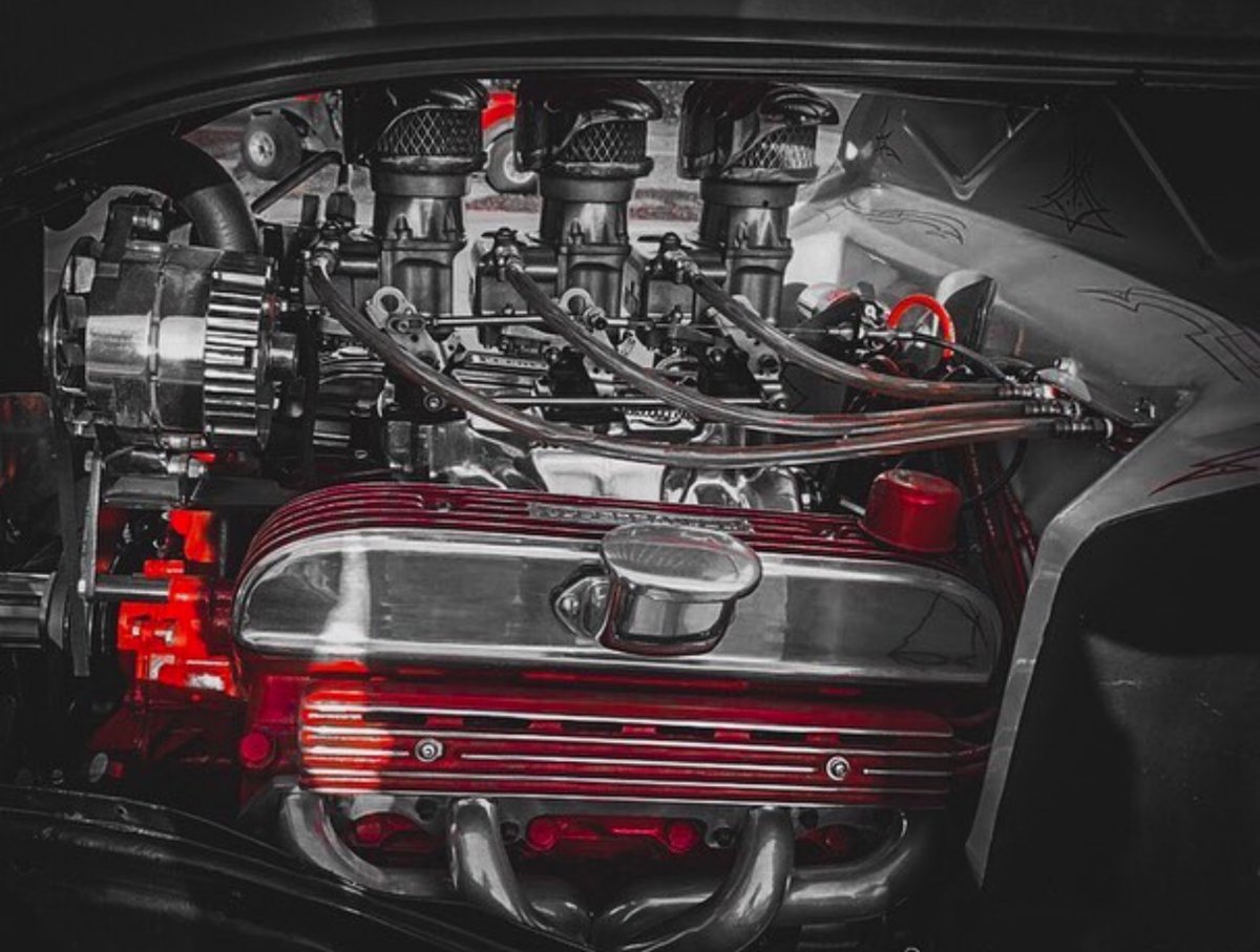

    Thanks guys. I’ve attached a pic, sans the filter. Good to know Hamtown AI regarding the lower radiator hose. I have a similar set up as yours and it's currently pieced together to get all the bends right. It works but would like to change it at some point. Fantastic looking rides by the way.:)
