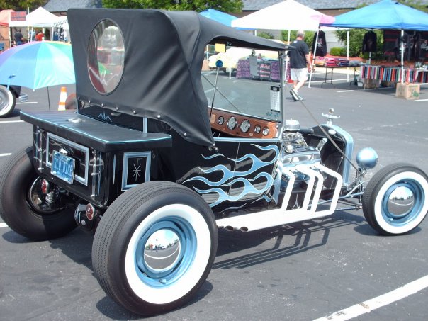

    I had a 67 with a Muncie out of a Chevelle in my TBucket with a 66 327 Corvette engine. All I remember is I had to be careful if I pushed it hard into second gear or it would get jammed between second and third gears. IMG_0004.jpeg
  9. DDDenny
    Posts: 22,122
    If it was the factory shifter I'm betting that was the bulk of the problem.
    I had a factory four speed 65 ElCamino with the original shifter and it would jam up.
    Found an NOS shifter and that fixed the problem.

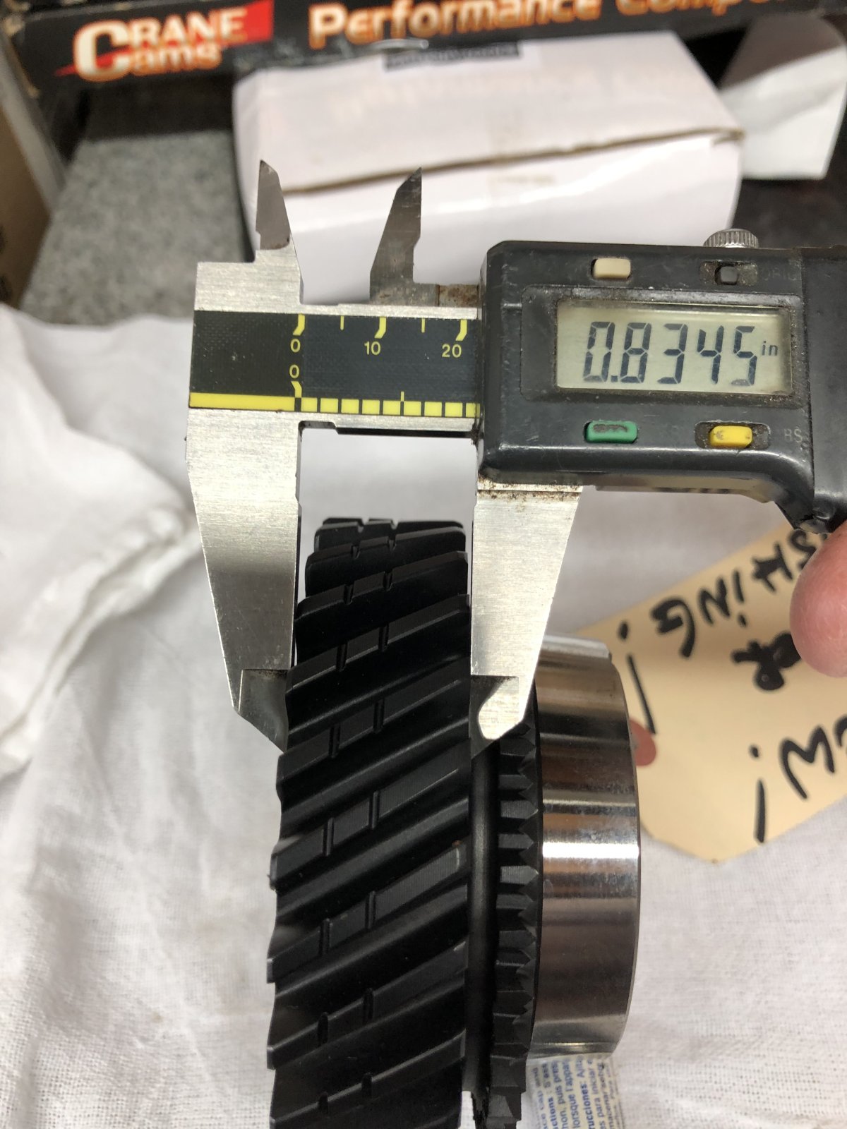

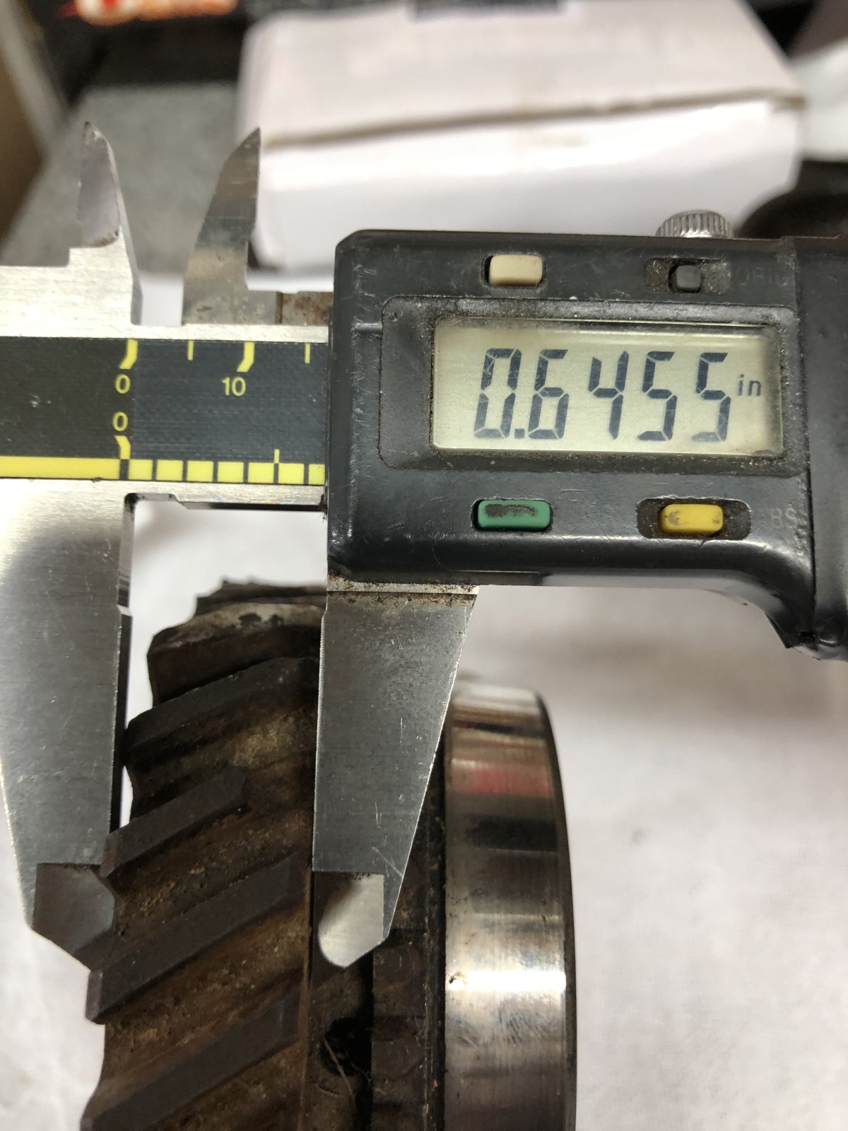

  24. The Saginaw is a decent transmission,,,,,but it is not strong at all .
    It was designed for light duty,,,,,,and we should be aware that it is exactly what it was built for,,,,light duty vehicles .
    I had a friend back in high school that destroyed 10-12 of them in an old truck,,,,with a Six !
    He was pretty rough on them,,,,but a stock Six !
    I broke a couple of Muncies,,,,,,and an old T-10,,in my Camaro .
    And I was definitely hard on them,,,,,,behind a pretty stout 350,,,and later a 327 !
    Really had a lot of fun !!!
    The T-10 failed fairly easy at that time,,,it was a 1962 model,,,,close ratio .
    I kept the old carcass in the barn for years exposed to the elements,,,,moved it a couple of times to different places I lived,,,,almost threw it away once or twice .
    Several years ago I decided I should try to repair it.
    Here are some pics of the old broken gear compared to the new replacement .
    The new gear had teeth that were almost .200 thousandths wider,,,,a lot stronger in my opinion .
    I switched to the wide ratio because I couldn’t find the correct cluster at that time .
    Either the later versions were updated with stronger gears,,,,,or my original was cut too narrow to start with .
    Here’s the pics for proof .
