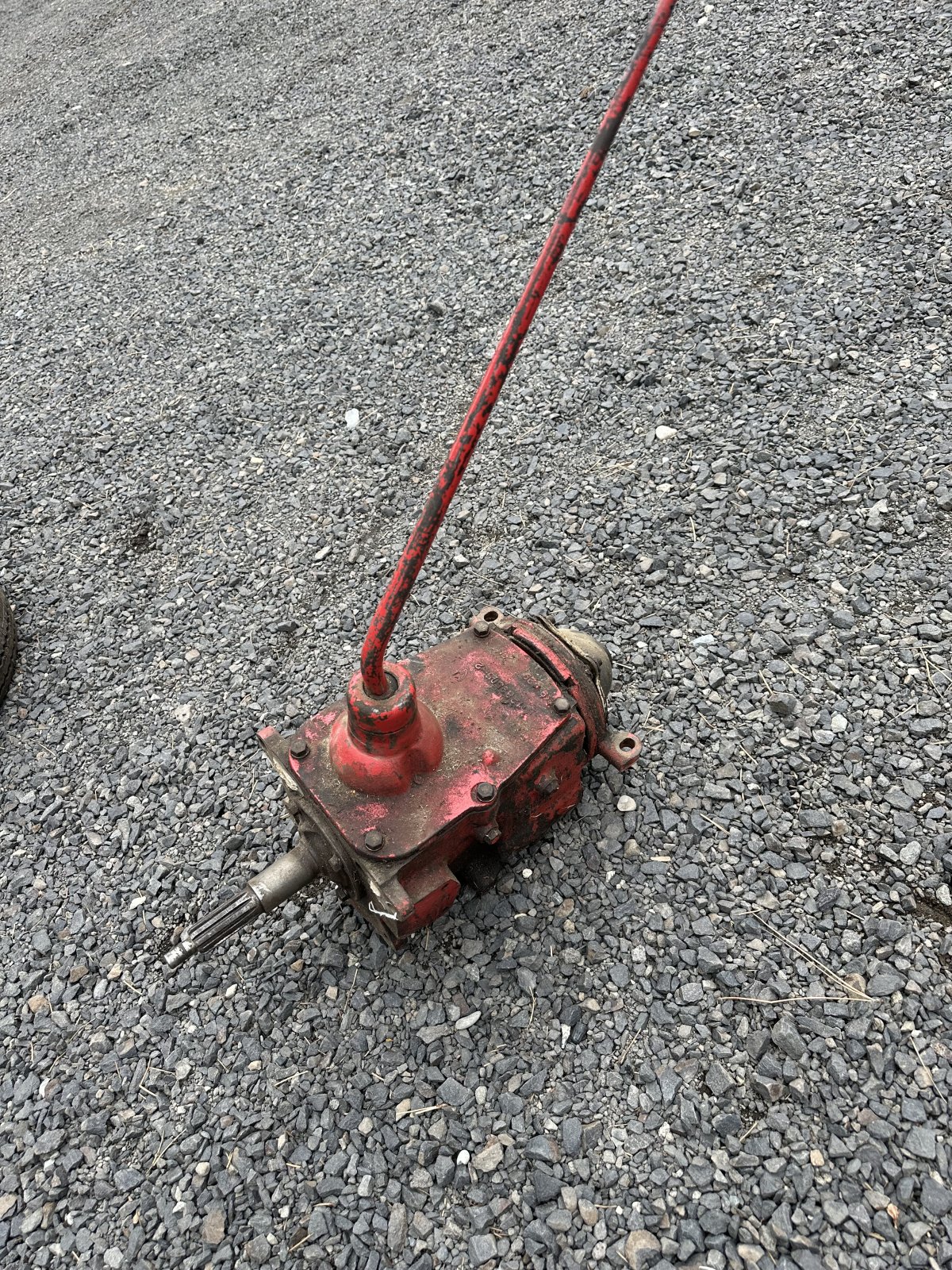

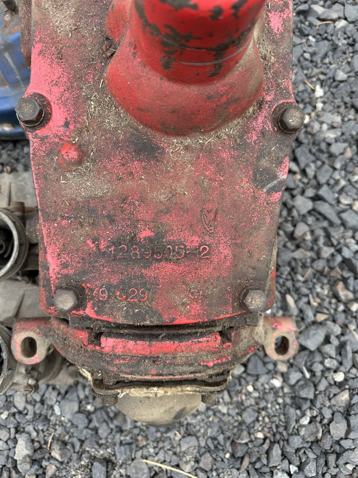

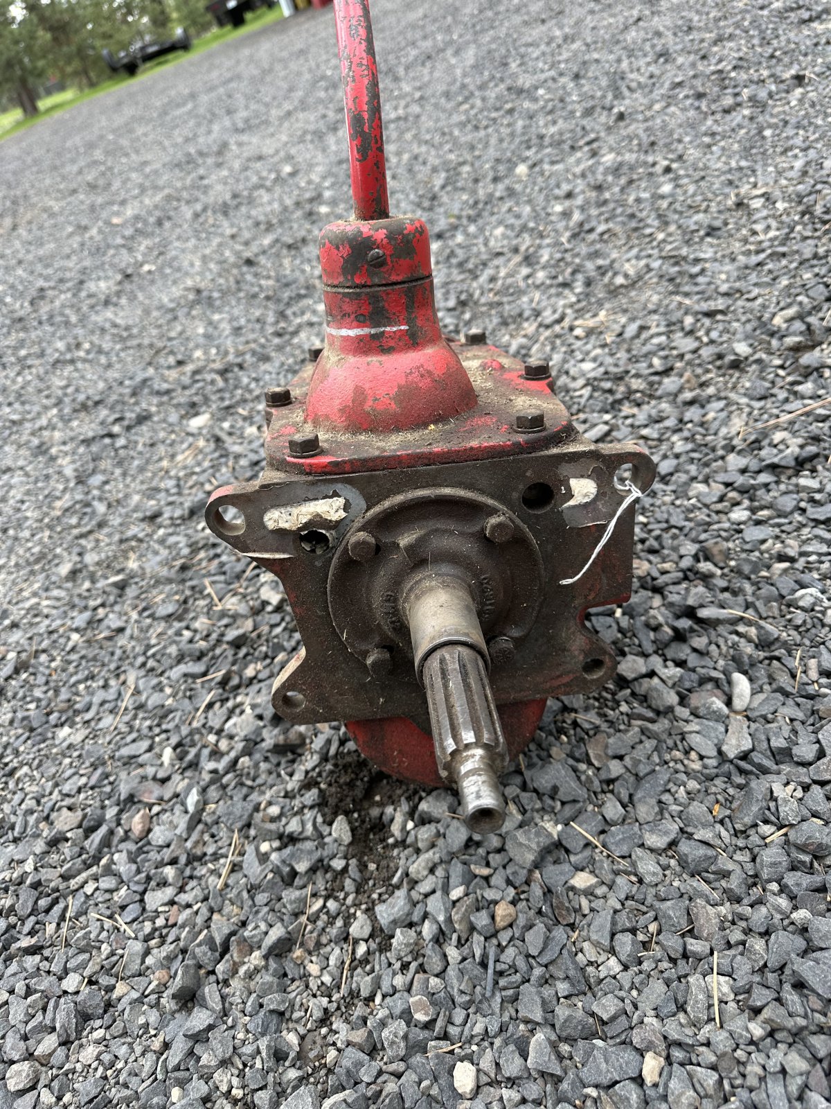

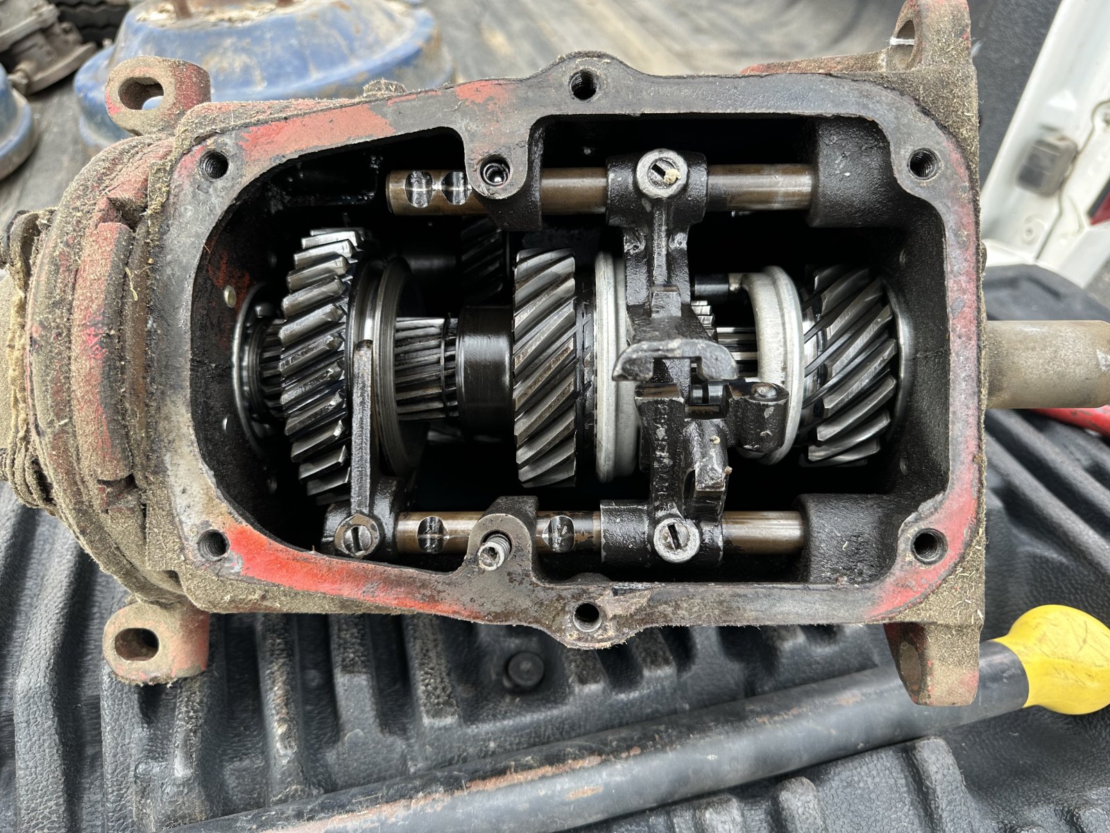

    Hello all, I was at a small swap meet yesterday and came home with a (I think) 1937-39 Buick 3 speed that’s been converted to Ford closed driveline at the rear. Trans looks nice inside.
    anyone know anything about these? Are they decent transmissions? I know LaSalle and Packard were often used in hot rods, Oldsmobile as well. Bolt pattern looks like Chevy? Just a neat piece I’d love to learn more about
    thank you!

  2. I think it is more like 36-38, as I believe Buick went to column shift in 39. Non- synchronized first gear. Not a particularly strong unit, but will handle 100 HP. Looks like the upper mounting holes have been elongated some. A good find for a FH project.

    Those Buicks originally had a torque tube. Are you sure it's converted to Ford TT? Also, that appears to be the smaller of the two versions of the Buick transmission available in that timeframe. They came behind the 233/248 ci engines. The trans behind the 320 ci was a much stouter version.

    Yes Ebb, that is a Ford torquetube ball. I recognize the ‘34 Ford mount.

    In the later Buick, three speeds, the 5-bolt top covers are the "weak" ones, the 6-bolt top covers are the "strong"ones. Are the earlier transmissions different?

    This is definitely the stronger of the two Buick transmission choices.

    What is interesting about this trans is the front bearing retainer/T.O. Bearing tube. Buicks of that era didn’t have that part bolted onto the trans case. The front bearing was ‘exposed’. The stock Buick bell housing mating face served as the bearing retainer when the trans was bolted to it. It required a gasket between the trans/bell housing as the front bearing was lubed by the trans gear oil.
    The bell housing had a ‘channel’ below the bearing leading to a hole in the front of the case below the bearing that was the return path of the gear oil. If that wasn’t weird enough, the throw out bearing carrier consisted of a flanged tube that inserted into an opening in the bell housing. The front bearing retainer in the photo is adapted from something else. Perfectly reasonable thing to do, just not what the trans came with (***uming it IS the trans we all think it is)
    It was popular at one time to swap Oldsmobile upper line series transmission gears into the Buick case. I don’t recall exactly why that was popular but Frank (not his HAMB name, but recall is failing me here, but he was a prolific poster on the HAMB and an authority on this subject. Lived in the wilds of the Northeast…Connecticut I think). There will be lot of posts in the old threads that can shed a bit of light on this topic. More to it than meets the eye.

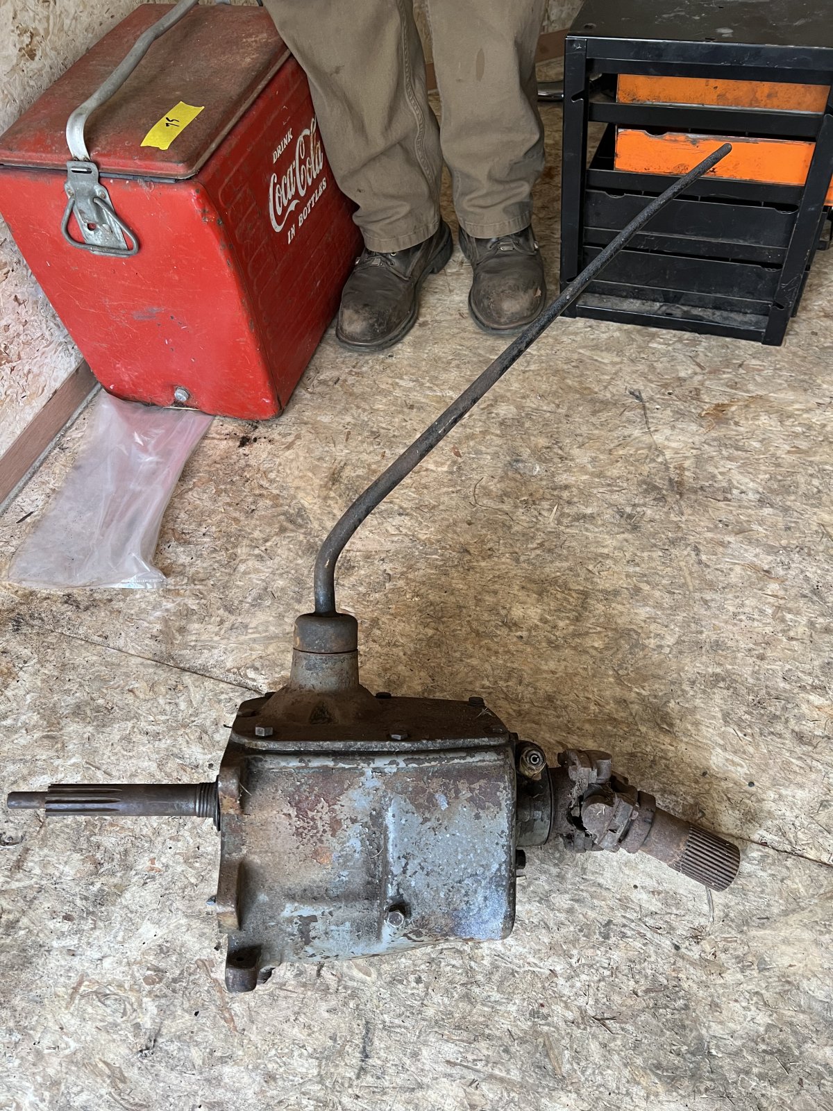

    My buddy picked up a similar transmission which was marked 36 Olds. 761EF6AC-D080-44A5-A929-DD6CD43C5B3B.jpeg

    Frank and I both use these behind our Olds engines. Both have been modified with newer Olds gear guts circa '51-64. Paul has used them as well. Pretty straight forward mod with one tail stock retainer bolt having to be moved. Frank did a build segment on his a while back.

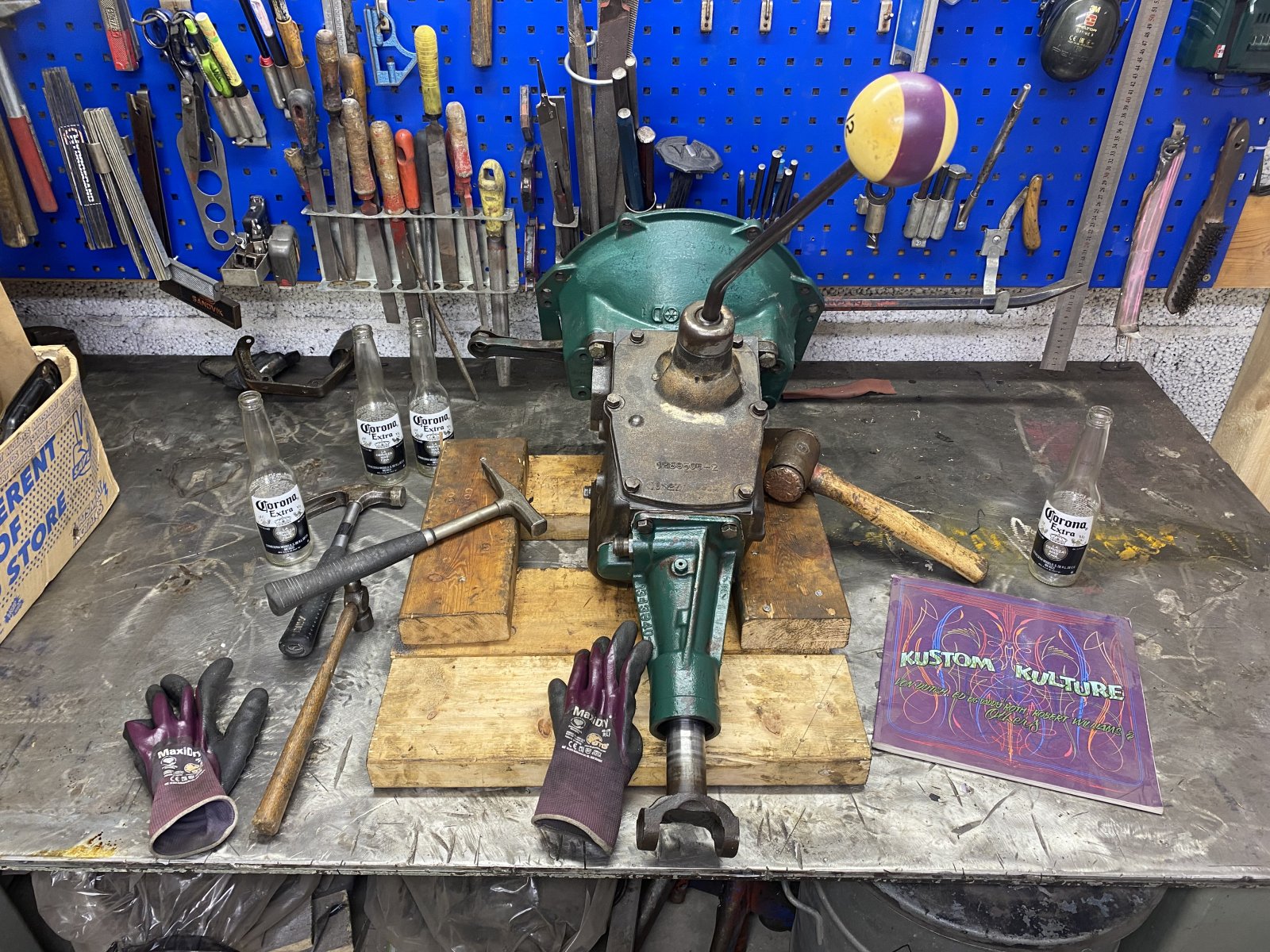

  19. don colaps
    Joined: Nov 29, 2007
    Posts: 232
    don colaps
    …and I’m preparing for some gear swapping action here

  24. don colaps
    Posts: 232
    don colaps
    Done! Easy peazy, haha.
    Or maybe I should paint it. Then done.
    Or maybe also put it behind a running engine in a hot rod and try it out. Then done…
