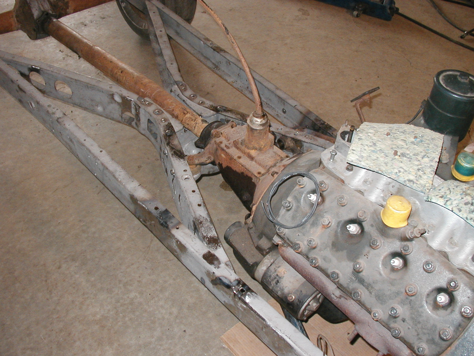

    Model A rails, 36 X member graphed in with 39 Trans mount and 39 pedal unit. I believe I already mentioned I don't think like normal people.
    rusty valley and brett4christ like this.
