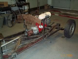

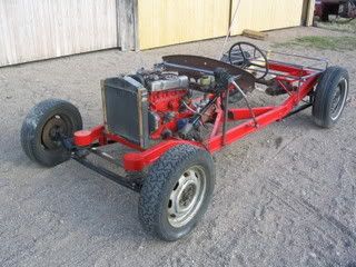

    Now it is time to show you some pics of school project rod. I don´t know if someone in somewhere has done this kind of job before, but I think that we are first in Finland working with hot rod. Boys who are in this project are on 9th grade. They have learned many skills before, so they can do almost all by themselves...
    Part #1
    That is how we started. August 2002.
    Frame is Volvo Duett (STW) 1960. It was almost rustfree after 17 years storage undes trees. You can see that there are leaf springs and front suspension is missing.
    Engine is Volvo´s 2.0 l and gearbox is 4-speed. Volvo rear end comes with disc brakes. That green thing is our parts car Volvo 144!
    Our old project car is also in that pic.
    After few weeks we had done something. We had shorthened frame after some measurements and calculations. No more leafs... Engine and gearbox are gonna be as behind as possible.
    What kind of front axle or steering? At that moment we had no idea...

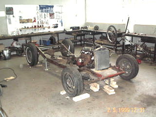

    Part # 2
    I found that old looking radiator from my junk pile, which is full of treasures like this.
    But there was no solid front axle. IFS was out of question! I remembered that once I met a chevyman who said that he has "house full of old Chevy parts". I called him and drove three hours to him. And he actually had two old houses full of carparts! He gave, not one, but THREE Chevy 28 axles! They weren´t top quality, but good enough.
    We decided to build this car as low as possible. So prop shaft goes above X-member of frame, not going through it.
    But no steering...

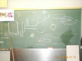

    Part #3
    We had to fix Chevy axle. And boys learned how to use lathe. They turned spacers so Volvo bearings could fit Chevy axle. That big nut is also spacer, it just looks better than a turned piece of metal...
    And... a perfect fit. To get brake caliber into its place was much more harder job to do.
    We did some drawings too...
  6. How will you locate the front axle, split wishbones, hair pins, four link, quarter-eliptic?

    Part # 4
    Rear suspemsion
    That´s the way we did it.
    Part one: Volvo coils cut in half. 5 inch Metal tube and upper Volvo links.
    Part two: Panhard bar and lower links instead of Volvo parts. (not seen in this pic)

    Part # 5
    Oh yes it´s a pick up!
    Now you can see Panhard bar and there are lower brackets of four-link. Instrument panel comes from an unknown car (can you help us to identify it) and steering parts are 48 Chevy. I had that steering column and gear for my G***er American, but I donated it to this rod. (I haven´t found another as good as this was, so my project is still without one) We shorthened Volvo´s propshaft, leftover part leans on rear wheel.

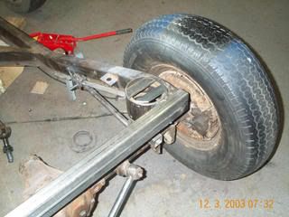

    Part # 6
    We made our own front axle links. Instead of Chevy style front leaf springs we used coils in 5" tube. Ed Roth had almost similar in his "Outlaw"- rod. Panhard bar is to come. Notice that modest gear shifter, no Hurst, no Mr Gasket, just "Mr 6 feet".
    Instrument panel is attached to a tubular frame....
    because in same frame there is place for brake master cylinder and clutch wire. Brake and clutch pedal ***embly is welded to it,too.
    My Chevy steering is now on its place. (Not in my G***er!) There is a heavy support plate and steering gear is bolted to it with 12 mm bolts.

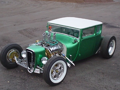

  16. That's something else. Those kids will learn a lot, but nobody gets it perfect the first time, don't let them get discouraged. Keep us yanks posted.
    P.S. Have you seen the green 60s style T coupe with the Edsel grille shell, from Finland? I can't remember who's it is, he's a HAMBer.
  17. juhap
    Joined: Nov 16, 2006
    Posts: 112
    juhap
    from Finland
    That 27 T Coupe belongs to HAMBer called Teemu (and he is from FINKland, too) Yes, I´ve seen it in a local show. Outstanding car with a lot of right at***ude... These old skool rods are booming in FINKland. And thats is good.

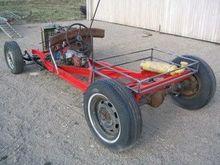

    Part # 11
    After Part # 10 guys worked hard and here you can see some progress. Shock abs are there, handbrake, and rear suspension is completed. We did rebuild those Volvo discbrakes. They were hidden under stupid dustcovers, but not anymore... And red and black paint, ofcourse! After that boys started to work with that wooden body.
