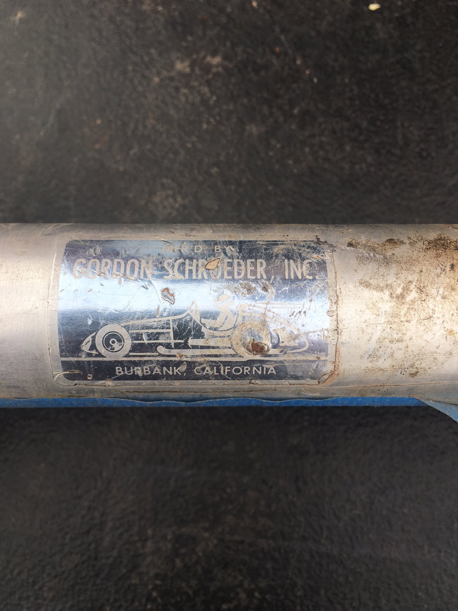

    Hey guys, Ive been looking for a Schroeder box for a while and ran across this on last week at the swap meet. Thanks homie from Amarillo.
    Ive never seen one with a power steering box on it.
    Im thinking of running the unit with a Volvo electric ps pump.
    I cant find any information on these units.
    I did a search here and found no information.
    Id appreciate any help..

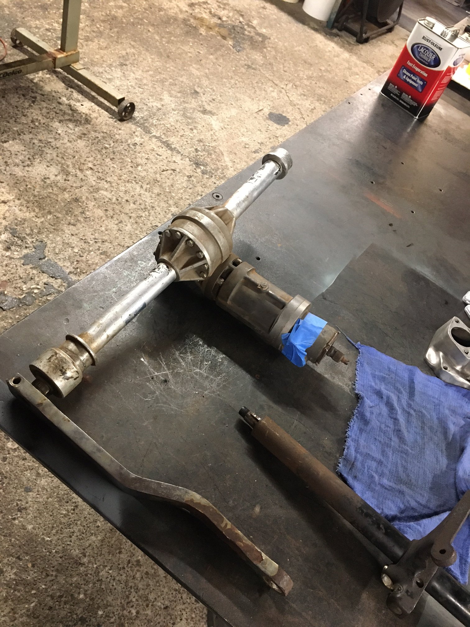

    And thank you Dave, I cant find any info on this unit, Id like to take it apart to clean and inspect it before running it.

    It's hard to tell from the picture, but it looks small like it might be a midget steering gear. I never had a Schroeder steering gear. My car with a manual 8:1 gear had a Hallibrand. My other cars with power steering had Lee gears.
    I see that IDI*** bought Schroeder and they do offer an inspection service. You might get in contact with them to see if they can identify the steering gear you have.
    After the first season with my car, I dis***embled the car and all the components. I asked a few people about going through the steering gear. I got some conflicting advise, but one guy said, why don't you just call Hallibrand? I did and got Ted Hallibrand on the phone. He was a bit gruff, however he did tell me how to go through the gear and the proper adjustment. I got the right advise from the right place.

  10. They were also used on Modifieds, the steering boxes in today's center steer modifieds are the same basic design, by Profile.
    They also started adding Caster which made the cars more stable, but took more physical effort to turn.
    I bought my manual Schroeder box from Russ Betz...
    ...he changed this car to a power steering Schroeder box in the mid 1970....
    this car still exist and is owned by Russ.
    A modern Profile box-
    and the pump-
    Link to pump -
    https://behrents.com/parts/profile-racing-pro002.asp
    A Profile P.S. unit is Kenny Weld Sidewinder ch***is

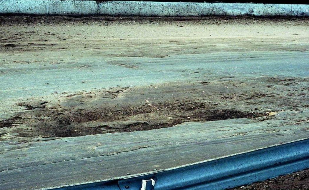

  15. Frist off its oval track not roundy round but for some reason people are under the ***umption (we all know what happens when you ***ume) all that these tracks are perfectly smooth and flat.
    Far from it!
    The tracks start off heavy and tacky as the night goes on and the more car hit the track it the dries out and goes dry slick the cars will tear the track surface up.
    Ruts and holes develop if those holes are in your line you have to drive through them you can have a car that has steering geometry, or bump steer.
    It is also a balance of trying to hook to the power without overpowering the track.
    All these photo are of local NY dirt tracks the night after the racing or the next morning, now can you imagen hitting holes like this a 80, 90, 100 M.P.H. with a car that bump steers or geometry with not to mention doing this while trying to advice your position and no lose position to 25 or 30 other people doing the same thing?

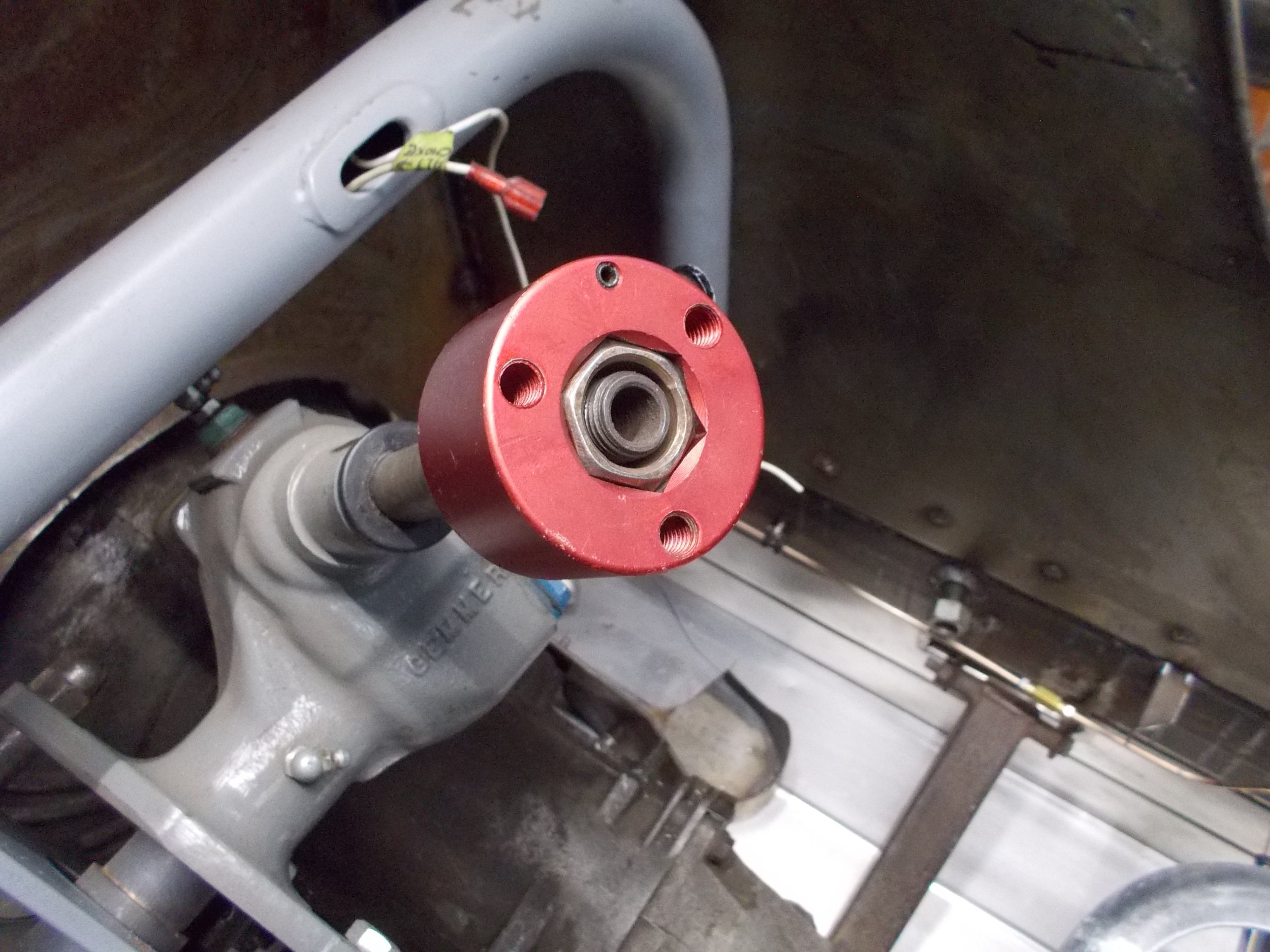

    I’ve got a regular Schroeder, and another with an added on power conversion. It’s packed away and I can’t remember the brand name on the power section. Can you find a name on yours? I was actually going to remove the power part from mine but never got around to it yet.

    I just looked through old PM’s and found a discussion about my power Schroeder. Mine has a Schrillo conversion on it.

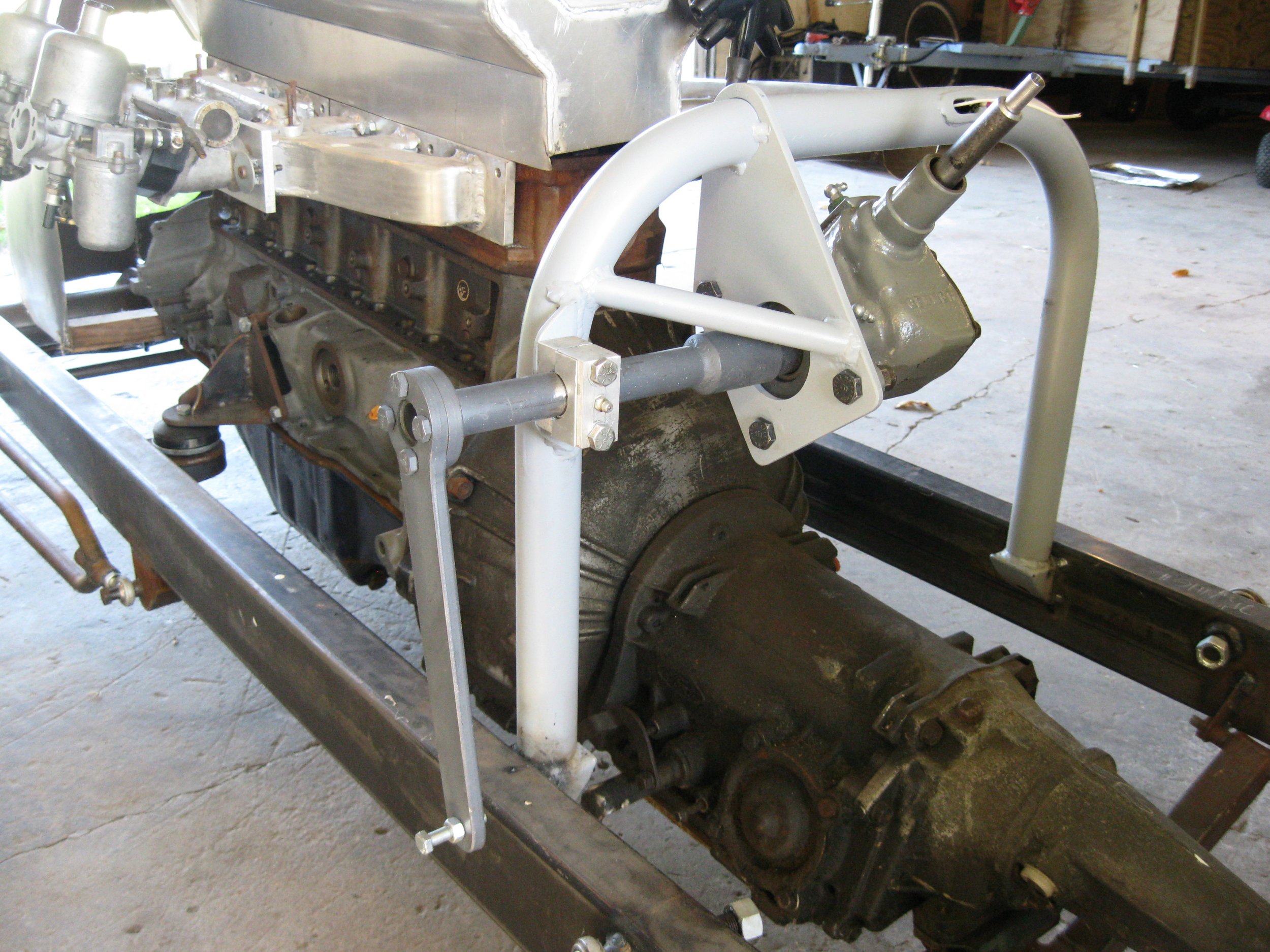

    If you don't insist on power steering, a much cheaper cowl steering solution can be made from an early '50s Ford pickup Gemmer box.
    seabeecmc and Bigcheese327 like this.

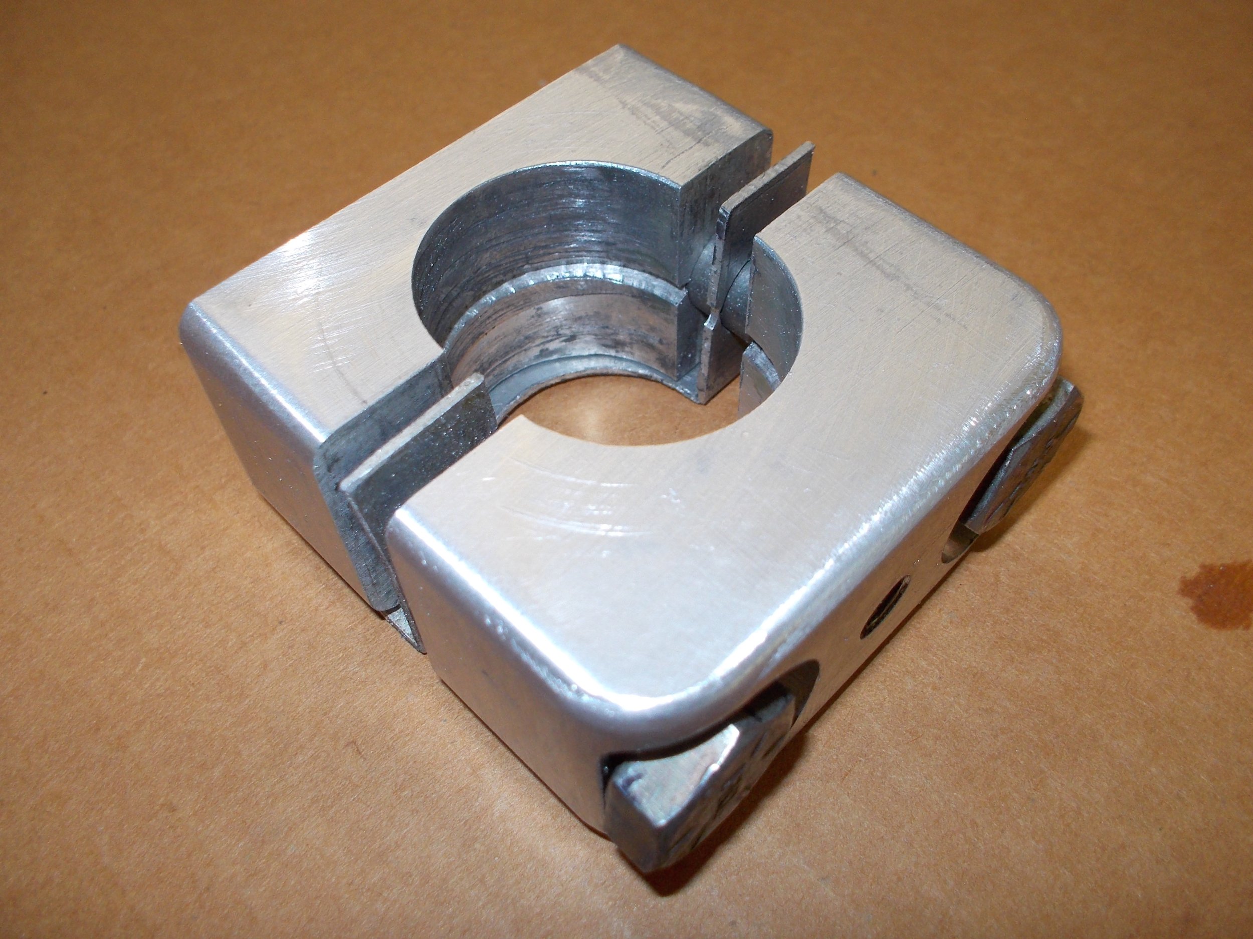

    What kind of bearing is that for supporting the shaft?
  30. THE FRENCHTOWN FLYER
    Joined: Jun 6, 2007
    Posts: 6,164
    from FRENCHTOWN

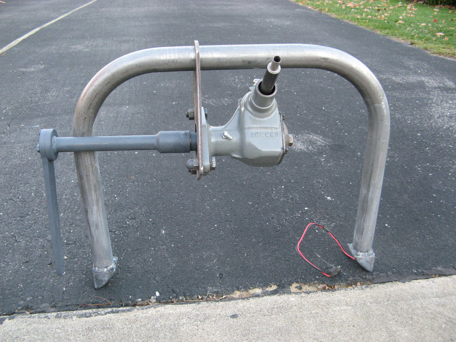

    After I welded the shaft extension on I measured the runout at the end of the shaft. It was only a few thou out. So I made up a split outboard pillow block with the same amount of clearance to the shaft that there was runout. That way it would still give outboard support with no bind. To keep it turning freely I bored an internal lubrication channel and added a Zerk fitting. To account for future wear I added a shim between the support halves so that I can remove a shim if it gets a little sloppy.
    You may notice I also converted the Gemmer box to grease lubrication, after I shortened the steering wheel shaft. Then I filled the box with a gooey mixture of original gear oil and grease to keep it from seeping.
