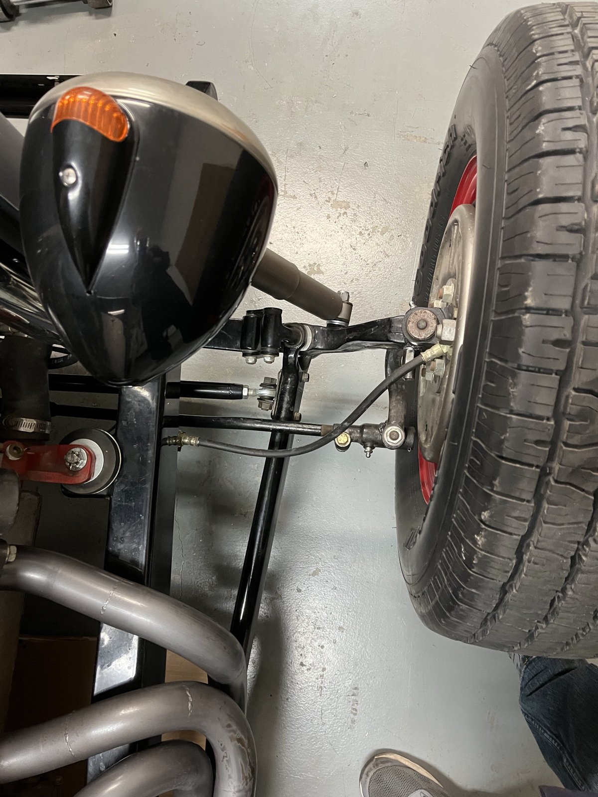

    Hey all,
    On my Hot Rod it has (1) Schroeder Steering Box and (2) Death Wobble.
    (1) Just wondering if someone knows how to adjust the box free play and how much free play should there be?
    (2) Death Wobble. I’ve read thru a lot of posts on this. My car would do it a lot till I put new tires on it, now it only happens at low speed if I hit a bump on left front. It feels and I can see the motor shaking badly. Only 2 ways to stop it 1) come to a complete stop or
    2) accelerate thru it. It doesn’t happen if you’re at higher speeds and hit a bump. I seen a couple threads on “steering dampener” and caster. I will try to post pics of the front end. Any thoughts or suggestions will be greatly appreciated.

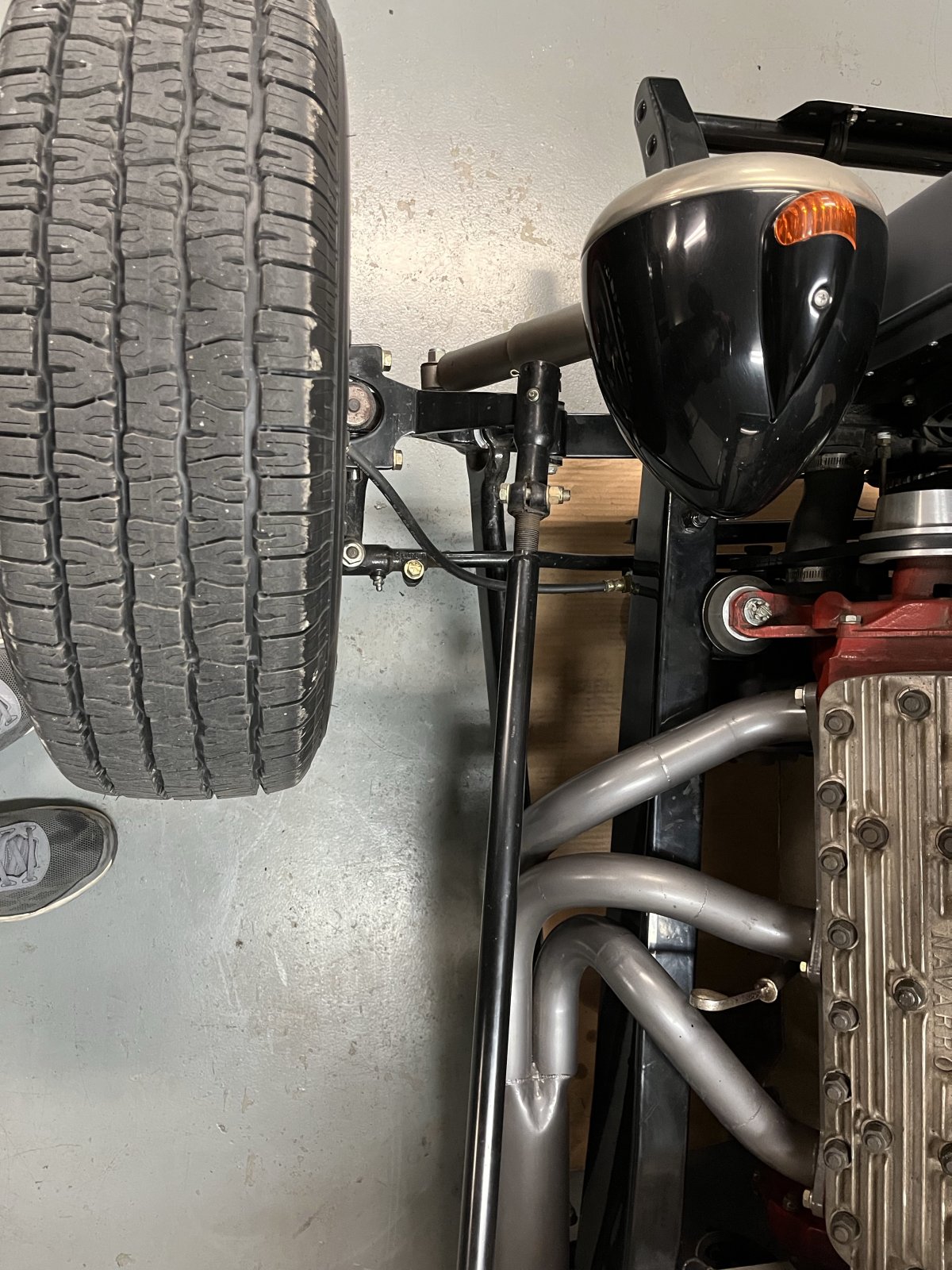

    From what I can see from the picture you posted the angle of the drag link needs to be parallel to the angle of your Wishbone and it is way off. So you're going to have some pretty bad bump steer also.
  5. Your pitman arm is adjustable, the first thing (it may require changing the headers) I would recommend is to drop the drag link so it is parallel with the wishbones/ch***is
    When the draglink is running at an angle it can cause bump steer, and by dropping the draglink on the steering box end it will quicken the steering.

    No no no no no! Nothing needs to be parallel to anything else. The bottom of the pitman arm needs to be as close as possible to the rear end of the wishbone, and no angle of anything enters into it. Why that is is explained repeatedly in the above-linked thread.

    Drag link parallel if using four bars, or in the exact same plane with same length and pivot point if wishbones. With your split wishbones, you are about one whole foot from proper geometry for the bump steer issues.
    All that said, the death wobble might actually be separate from bump steer. The death wobble might be caused by weak joints or flexy tube. Or caster improperly set. Or excessive scrub because the wheels are too offset. Or toe in not set proper.

    I would like to see the front attach point of the drag link. You might be able to cancel some of the bump steer by raising that point, ala Doane Spencer. The stabilizer is a must to deal with the wobble. Great looking car.

  18. To see exactly what happens to the geometry of your setup, jack up the front of the car, getting both tires off the ground. then put a 4 X 4 under the drivers side tire and let the front end down. Compare the draglink angles before and after. This will give you an idea of how much the draglink angle changes when you hit a bump. Proceed from there with modifications or the addition of a steering damper.

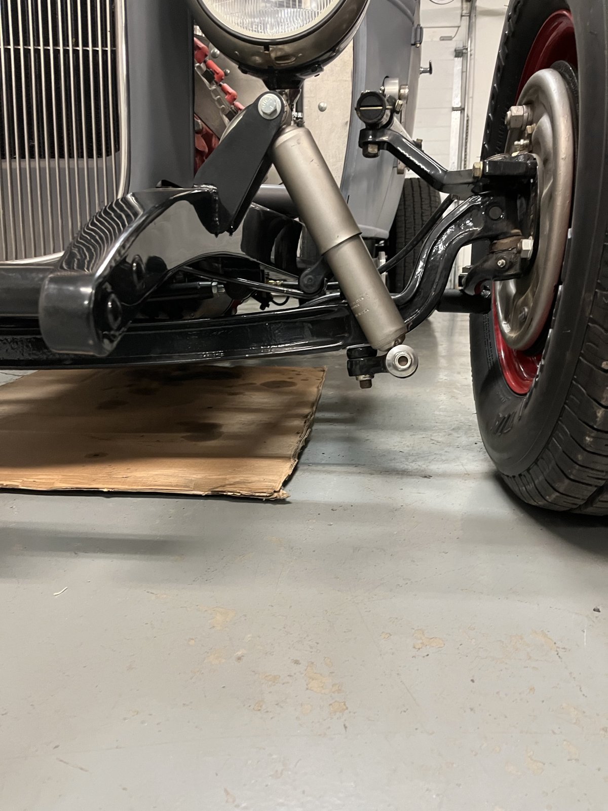

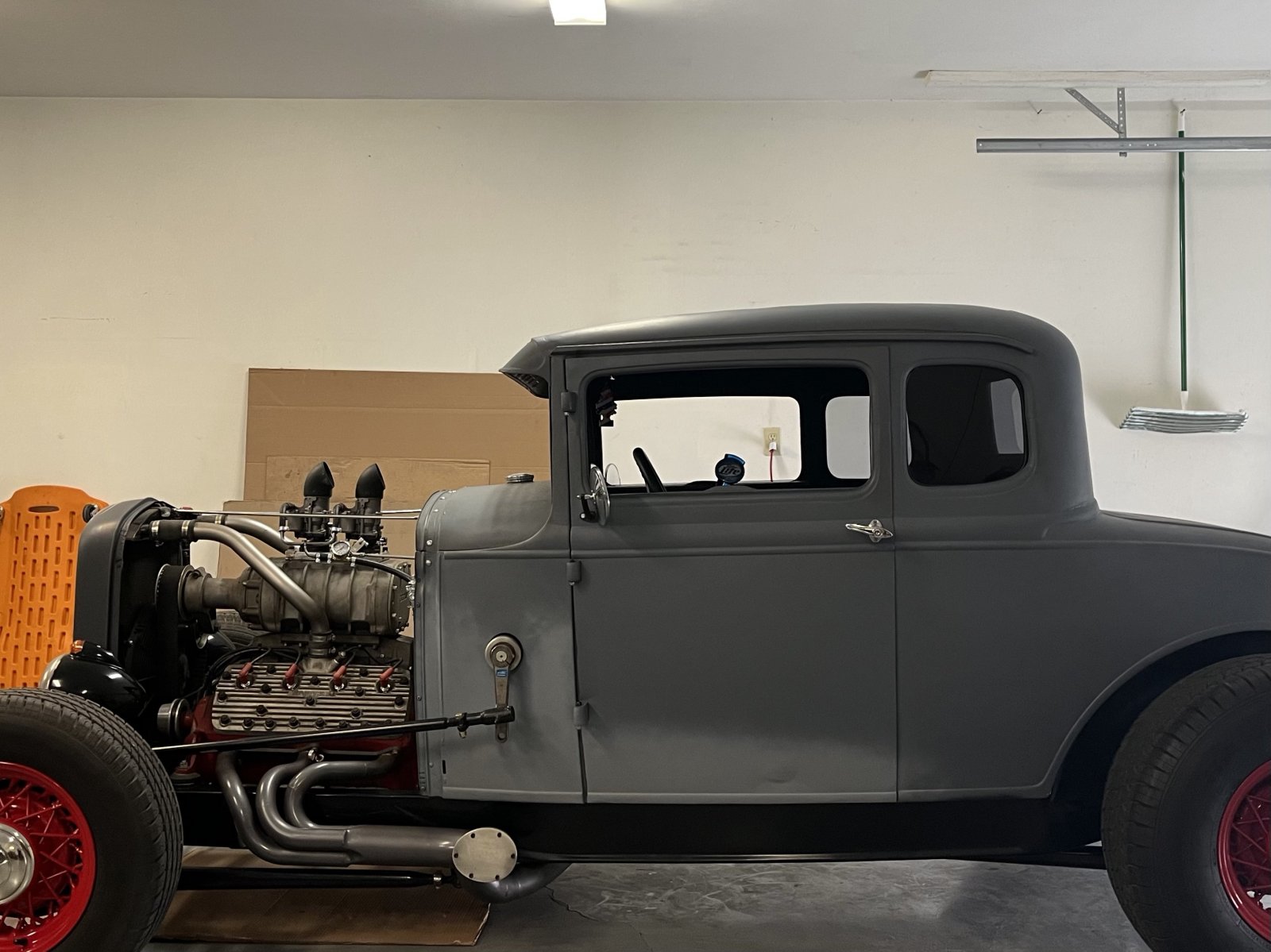

    More pics please. Front on shots especially.

    Your wheels could have more positive (inwards) offset to get the scrub radius a little better.
    And the way the panhard connects to the right hand bone could be tweaked.
    Otherwise, I can't see anything that is drastically out of place with the front end ***embly.
    Read the thread that was recommended on cowl steering in posts #2 and #9. There is very good info in it.
    Some understand and some don't. Just follow the geometry, it doesn't lie......:)
