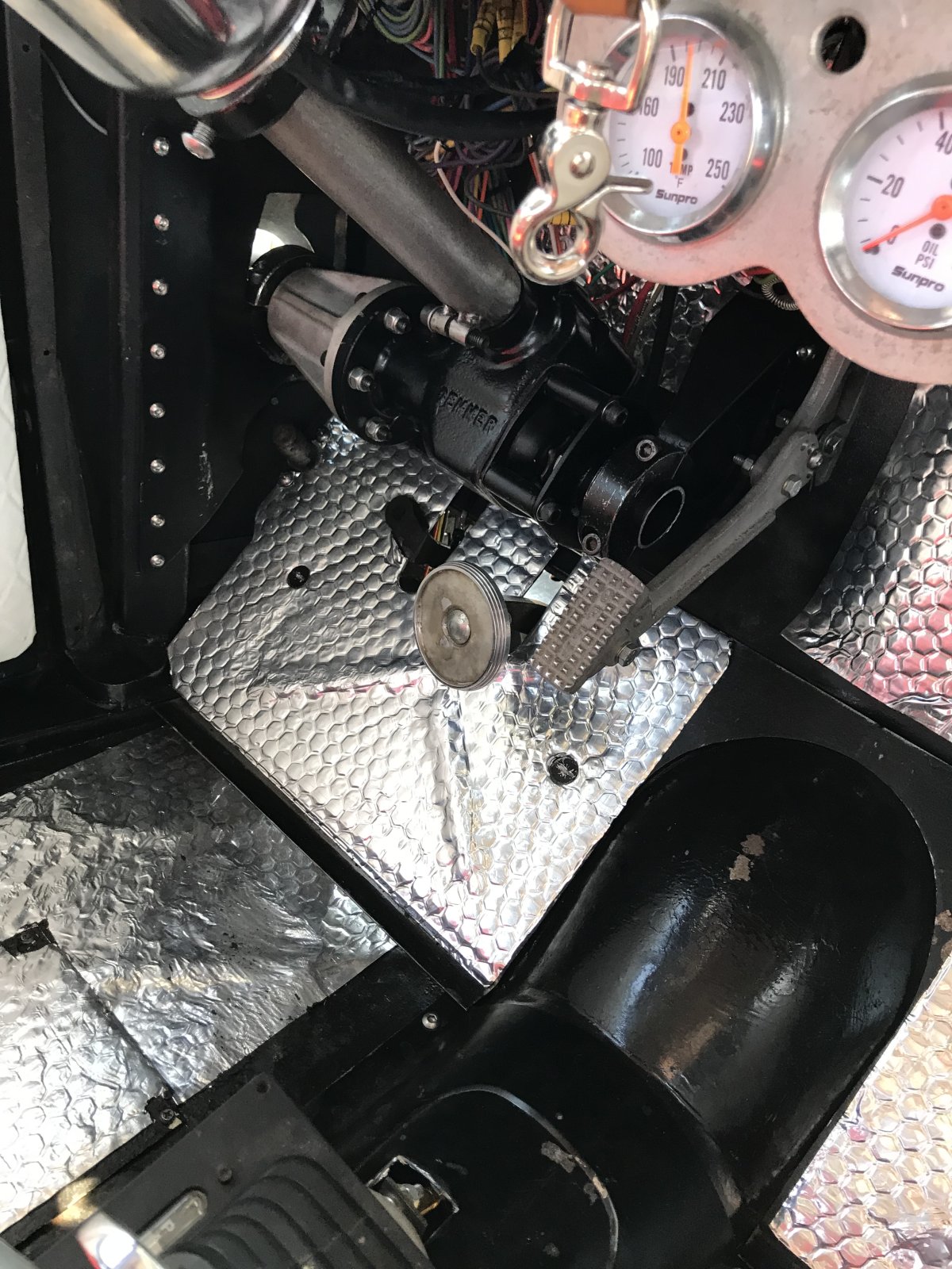

    That tie rod looks pretty small in diameter and has several bends to clear the frame. Could be flexing quit a bit when you hit a bump and causing the wobble to get started.

    I'd do something about the tie rod ***embly also.
    Too small and the bends are making it worse.
    A dampner might cure it but the bends in that small of tube are flexing too. I'd go after the small tube and bent tie rod then go after the death wobble if it's still persistent.
    Fix the apparent problem then go after the drivability.

    Your lower shock mounts don't have enough thread engagement. The nylock isn't doing anything.
    Oof. I feel the pain the fixed bushing and shaft of that damper experience every time the tie rod and axle move. Bind and bend city.

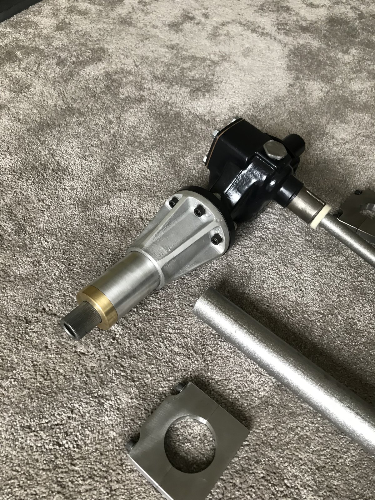

    All this talk about Schroeder steering. A few years ago there was a hot rod shop in the south selling F100 boxes modified for cowl steering. If I remember I looked inside a couple Hilton Hot Rods coupes and they were using this setup. Wonder what happened to the manufacturer?
    Tman likes this.
  11. ukgav
    Joined: Jun 16, 2008
    Posts: 361
    ukgav
    It was Mike Bartlett (mikesspeedshop) but I’m not sure if he is still producing them.
    I bought one from him for my A sedan. A bit spendy but an excellent piece of engineering and made the car far more pleasurable to drive with the 16-1 ratio. I found my shroeder too heavy.
    Lots of compromises with cowl steering with regard to geometry etc but they can work well. Personally though I wouldn’t run another.

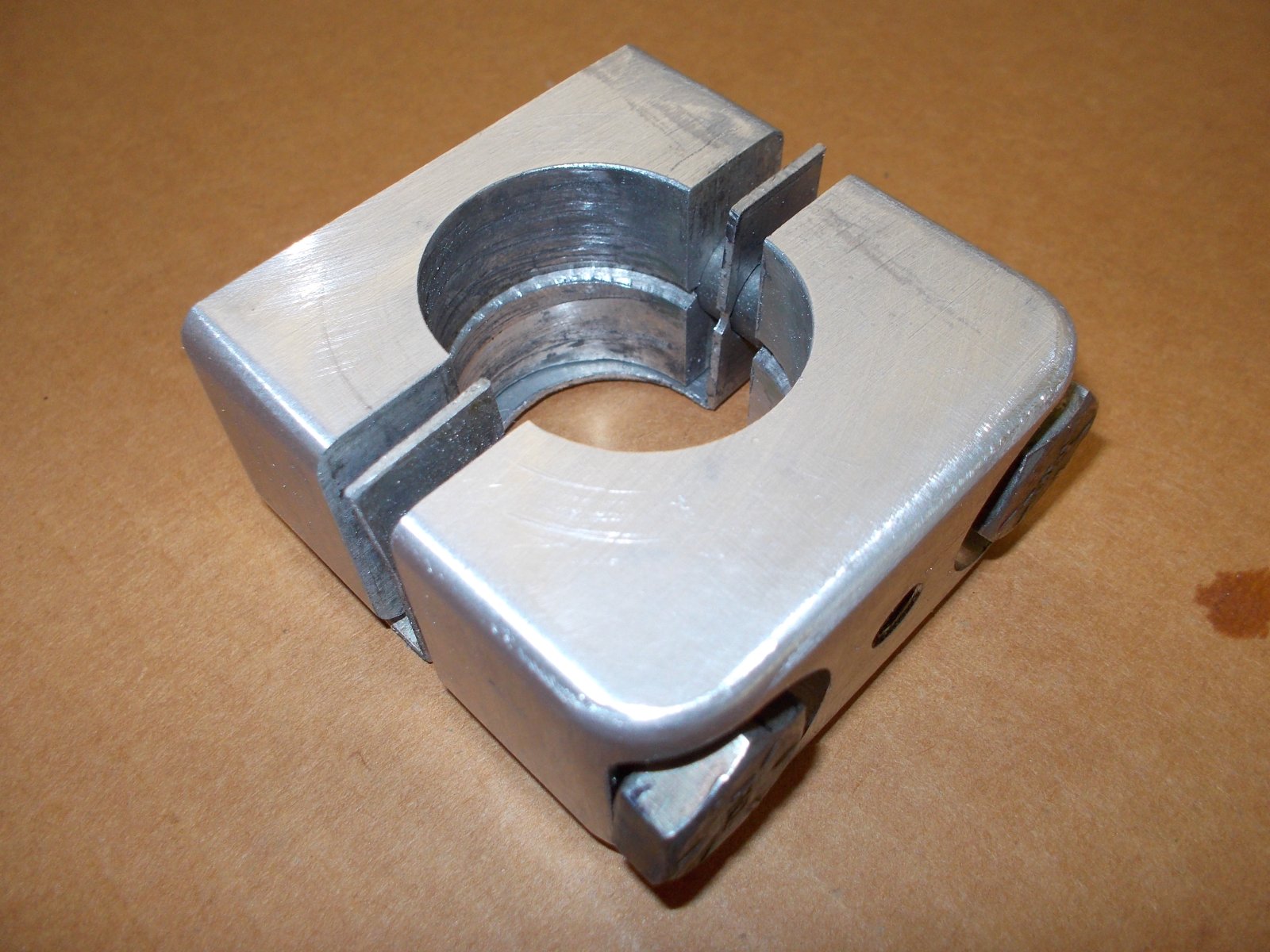

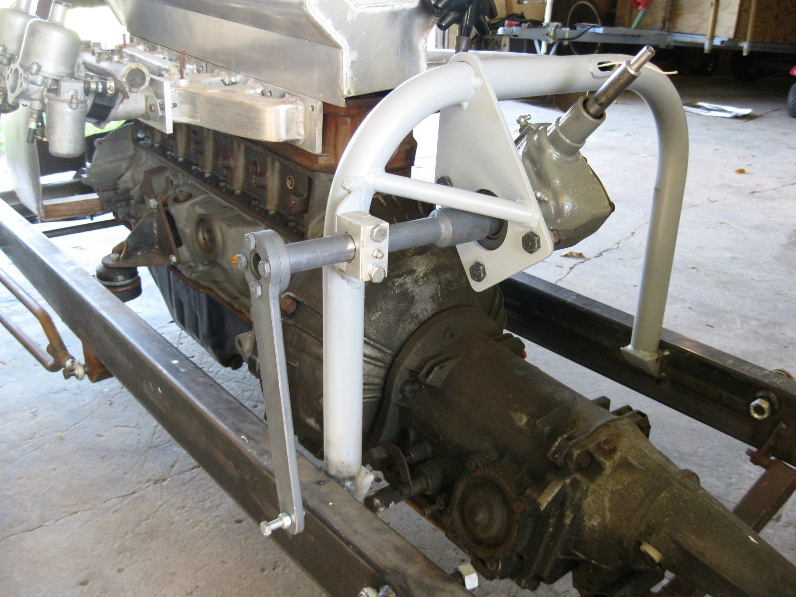

    With a little bit of trickery****ery I made my own cowl steering from a Gemmer F1 box. The only bad thing about my design vs the Barlett is mine is not serviceable because I welded on the extended shaft. I also added Zerk grease fittings for periodic lube and a shim at the outboard bearing so I can take up any wear as time goes by.
    Tman likes this.

    A large cause of death wobble is perch bolts not being tight or firm in the axle and allowing the axle to rock, this usually only happens when the left tire hits a bump. This is amplified on dropped axles. When building my T RPU i found that the perch bolt's shoulder didn't engage in the axle fully, this is due to the 35 to 48 bones having a much thicker top piece than the spring over bones for obvious reasons. I don't know if there are perch bolts made to correct this or not but i extended the axle purchase area of my perch bolts by adding a nut that was machined to the same size. JW

    Remove the cowel steering,an fix it right*................Those that don't understand engineering, love too to make up BS storys about how there poorly done cowel steering works so,good*< It dose not ,they just defend to the death there mistake out of ignorants*{ I'm not saying stupid,just that they don't know,and don't want to know * ].
    Stop the bump steer,by learning about engineering design.. Not learning, all excuse cover up BS why the cowel set up shown in your pic is OK to them< it is not !!
    Also the front tires are [too wide=too heavy an hard to control when they start death wobble.=Contributing factor to oscillation strength{ death wobble ].
    You can put a band-aid on { VW steering damper on tie rod,or any of the same design dampers,it will help,but it is really just a cover up that makes if feel OK kind of. } Except it will still dart to the side on a bump, from the bumpsteer feed ,by that cowel set up. .
    Try to over come trendy,lazy fix ideas,that some pick as EZ way around.

    Two more points are that the front wheels are wide and have outer offset putting the scrub point way outside the king pin center line, this gives the tire/wheel leverage to try and turn out coupled with that ''funky'' tie rod that will be flexing like crazy under the load applied by the above mentioned and the extra force applied from bumps you get what you have. If you have any of the issues i mentioned in my previous post (#44) then many issues that are contributing to the problem. JW

    Compare the height of the drag link above the hairpin pivot here to what is the case on the OP's setup. The greater the vertical distance, the greater the tendency to bump steer. The angle of the drag link is immaterial, and tweaking that would achieve exactly nothing. The death wobble has nothing to do with this issue.
    That there should be death wobble with that extremely slender tie rod would tend to support my su****ion that death wobble can be due to elastic oscillation of either the drag link or the tie rod, i.e. twanging like a bowstring, set off by momentary compressive strain. A substantially less slender tie rod should fix that, if my su****ion is true. That is, a large-diameter, thin-wall tube rather than a small-diameter solid bar.

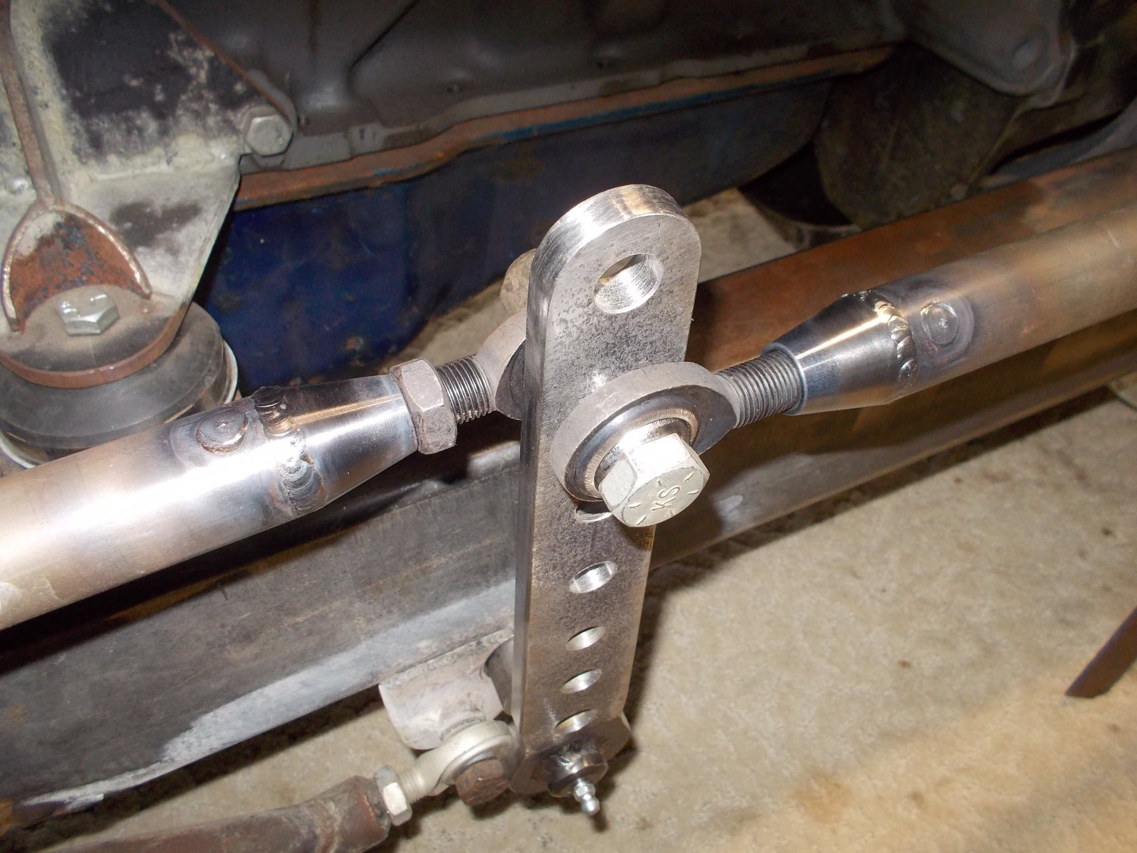

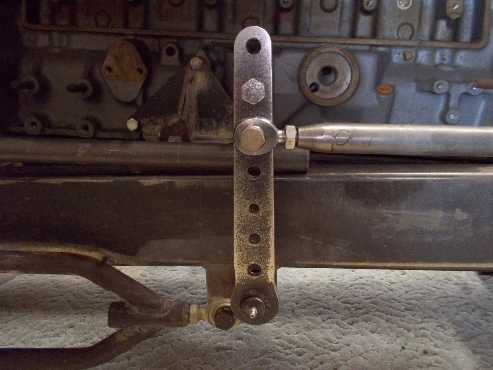

    I recently ***essed that condition on my replica champ car build and decided to change the long drag link to a two-piece drag link that will mitigate that problem. The tube diameters are rather stout too.
    26 T Ford RPU and Ned Ludd like this.

    Every time the topic of death wobble comes up it's always the same suggestions, most of them wrong.
    Death wobble in the jeep world is extremely common. It's caused by three things.
    Wide off set wheels and tires with poor king pin axis of inclination.
    Loose, worn or flexing steering linkage
    And lack of correct toe in!
    Ya think is scary with skinny tires, low center of gravity and 2-1/2" of suspension travel?
    Try it with a short wheelbase, 35" in tires in something that weighs 5500 lbs minimum and has 20" of travel. Ya better pack an extra pair of undershorts.
    In the OP's case I would also have the axle checked for flex. Some of home dropped axles were slow cooled in sand instead of air cooled for proper quench. It makes them super soft and bendy.

    As an engineer, you had a course in kinematics. Go back to the basics, and sketch up the side view of the front suspension including the steering linkage, to scale, as accurately as possible. Now move the suspension thru it's range of travel, and look at the arcs. In particular look at the paths of the steering arm where the drag link attaches relative to the arc of the drag link itself.
    Unless the pivot point of the rear of the drag link is exactly over the rear pivot point of the suspension, say the tie rod end if you were to use hairpins or split wishbones, the arcs will be different. This is what causes bump steer. With quarter eliptic springs you have a different situation, and the virtual pivot moves around. Cross steering can minimize bump steer in those cases, but in reality there will still be some effect.
    There is a way to get most if not all of the bump steer out, but at the expense of increased complexity and unsprung weight. That is to mount a rack and pinion steering gear on the axle. Obviously you then have to articulate the steering shaft, which if done wrong will also induce steering inputs. Articulated steering shaft that can move up and down and also in plunge without inducing steering inputs.
