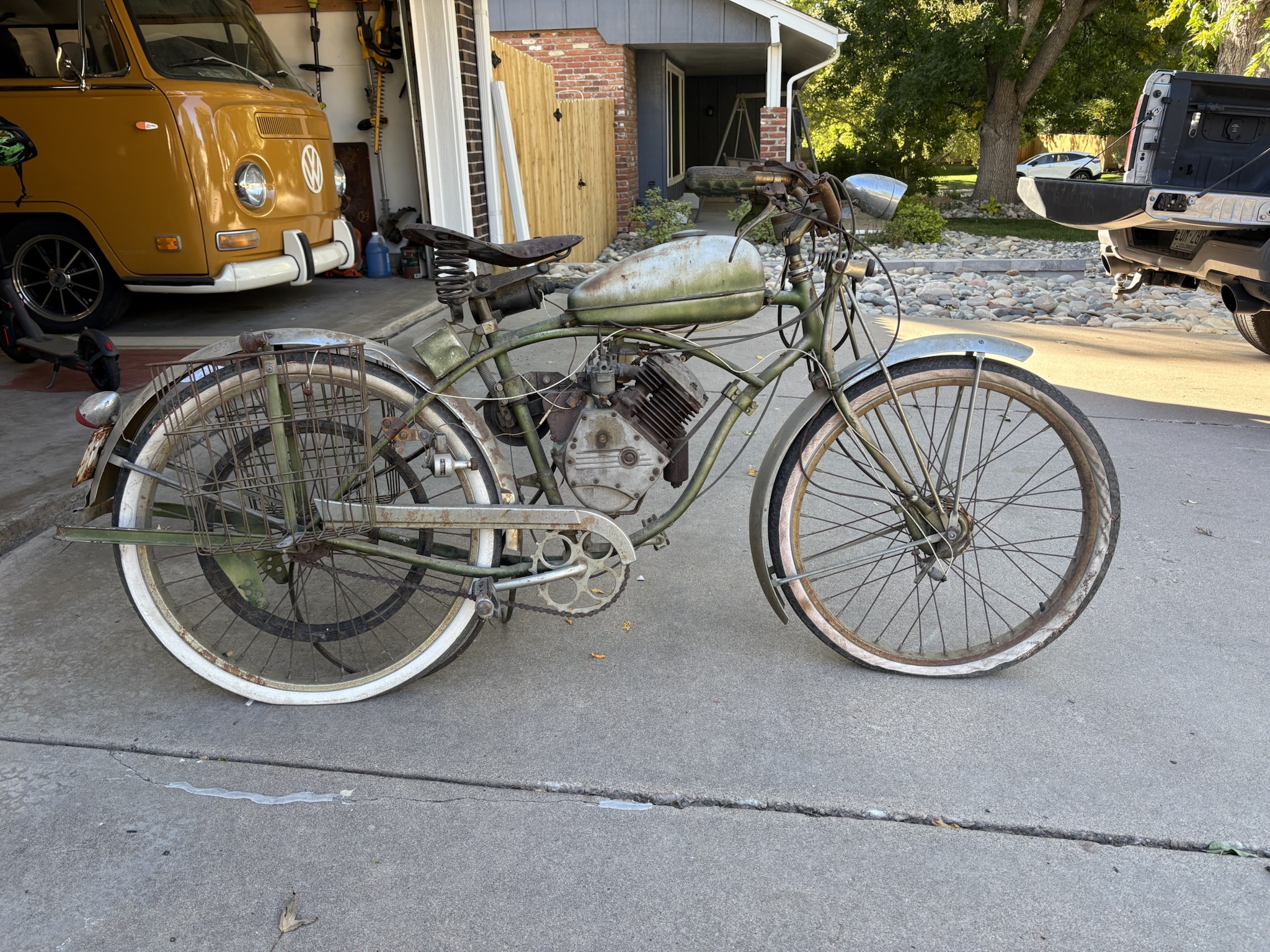

    I was looking at Facebook marketplace for Flathead Parts when this bad boy popped up on my screen. A few hours later, it was in my garage. I could not say no. Anyway, does anyone have any information on these bikes? I see some on the Internet, but I am trying to figure out what I have. Should be a fun little winter project. I am hoping it’s a real whizzer and think it is but am having a hard time id’ing it.

    Genuine Whizzer... skip-tooth chain suggests that it's "older" than most!! :cool::rolleyes:

    Looks like a Model H … look at the serial number on the case side next to drain plug and most likely starts with an H … Memory says 1946 or ‘47
    Cool find!
    Interesting it has ignition coil… can’t see in photo but must be missing the magneto next to the flywheel, which also would mount the missing belt cover …

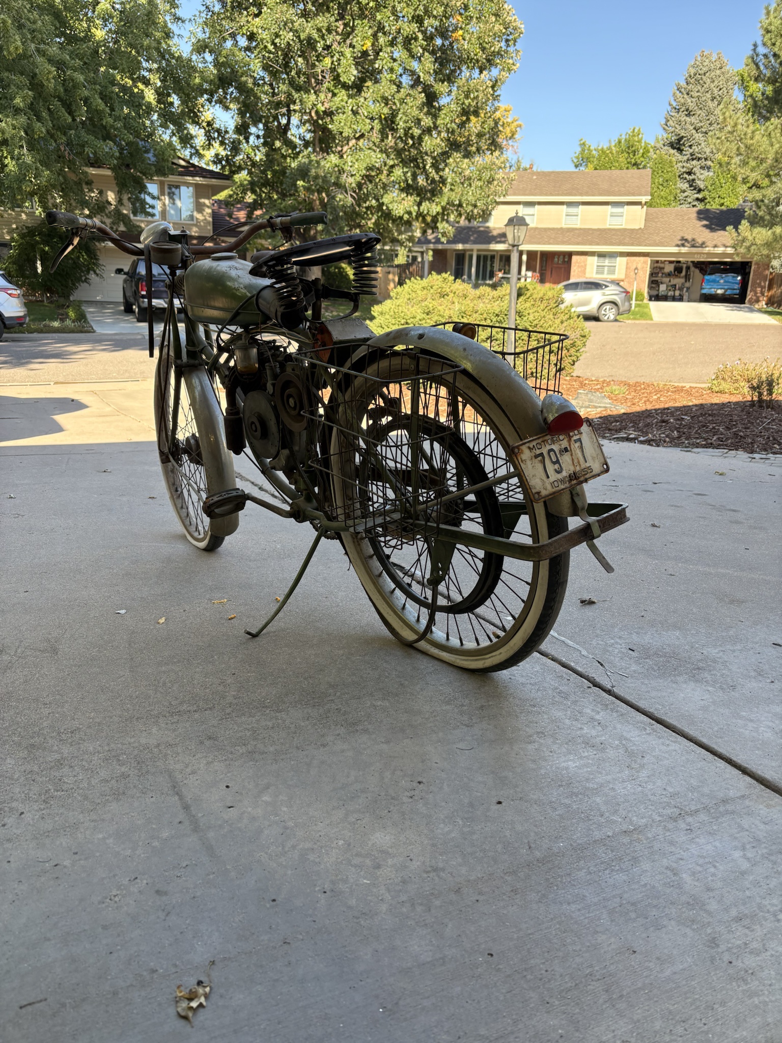

    That is too cool, don’t know if I like where the coil and wire is located, a little to close for my comfort level lol

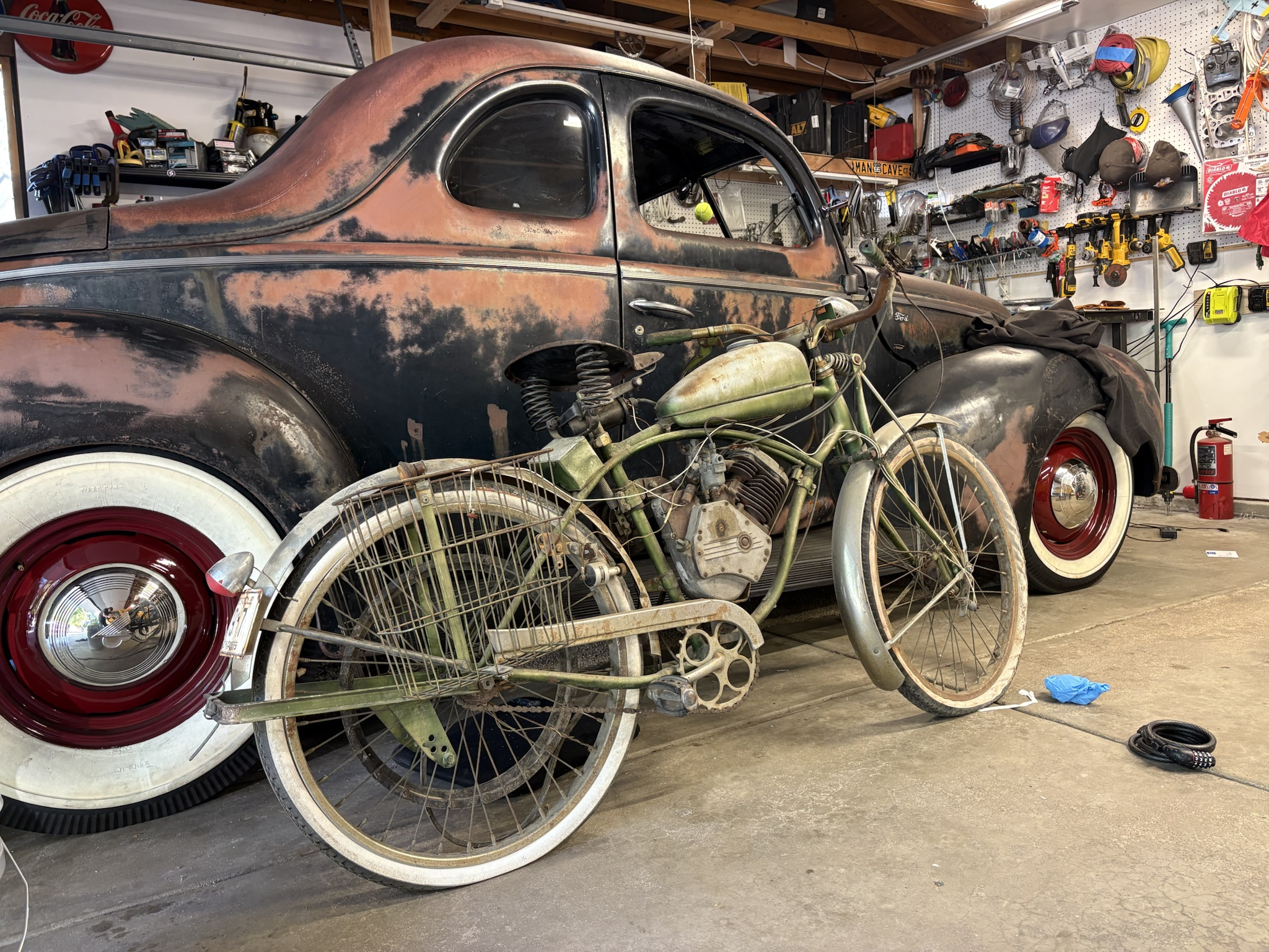

    I had that thought too! Took the engine out and it was producing compression so I took the head off and the valves were stuck. Kept taking it apart and found the lifters frozen in the bores. Got that stuff cleaned up and will put it all back together and see if it runs.
    I do not believe it’s a real Schwinn whizzer but just the whizzer kit someone put on an old Schwinn. Still cool.

    well, you asked. Haha. Turns out even though the engine turned over, there was no compression. So I took the engine out and started to take it apart. There was a little bit of water in the oil. I found both lifters, intake and exhaust frozen which explained the valves being stuck open. After wrestling them out I cleaned the lifters and the bores up with some 1200 grit sand paper. I’m waiting on some gaskets to put it back together.
    I think the carb is likely bad though so I’m looking for a better option. The throttle shaft is super loose which makes me think it will have a crazy vacuum leak.
    Anyway, that’s where I’m at. I think it’s a ‘47 h engine. The jury’s still out as to whether it’s a whizzer engine kit or a full on real Schwinn whizzer. Either way it’s a cool early skip tooth Schwinn bike. I’m a patina guy but I’m torn on painting or just cruising it as is (likely). The paint is definitely not original and probably a rattle can special from the 60s. Good times.

    Looking at the front suspension, I’d say it’s a real “Whizzer Bike”. I’ve had several in the past, including a near “mint” version that was very similar to yours with the same front suspension. Also had a rare version that was direct drive, with foot pegs and no bicycle pedal system. Long gone, and sorry, no pics…
