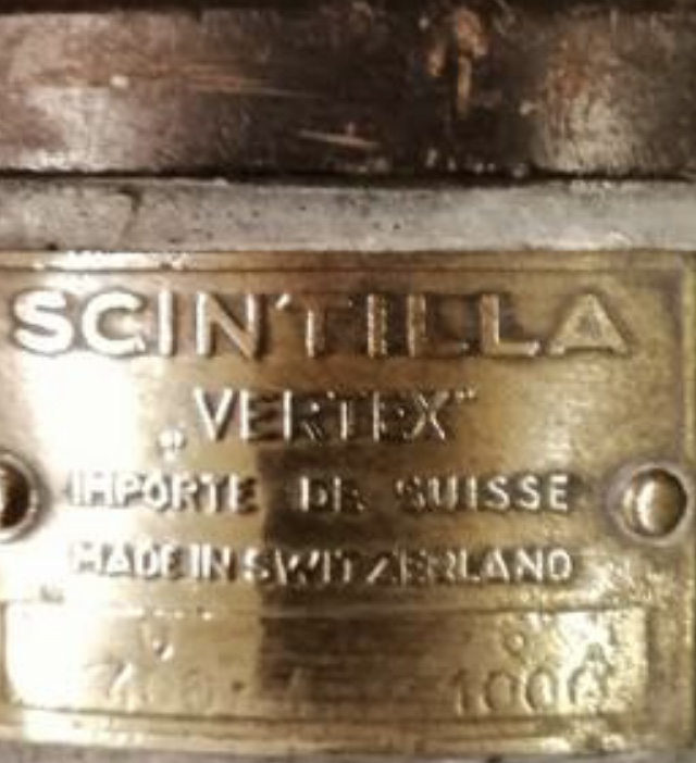

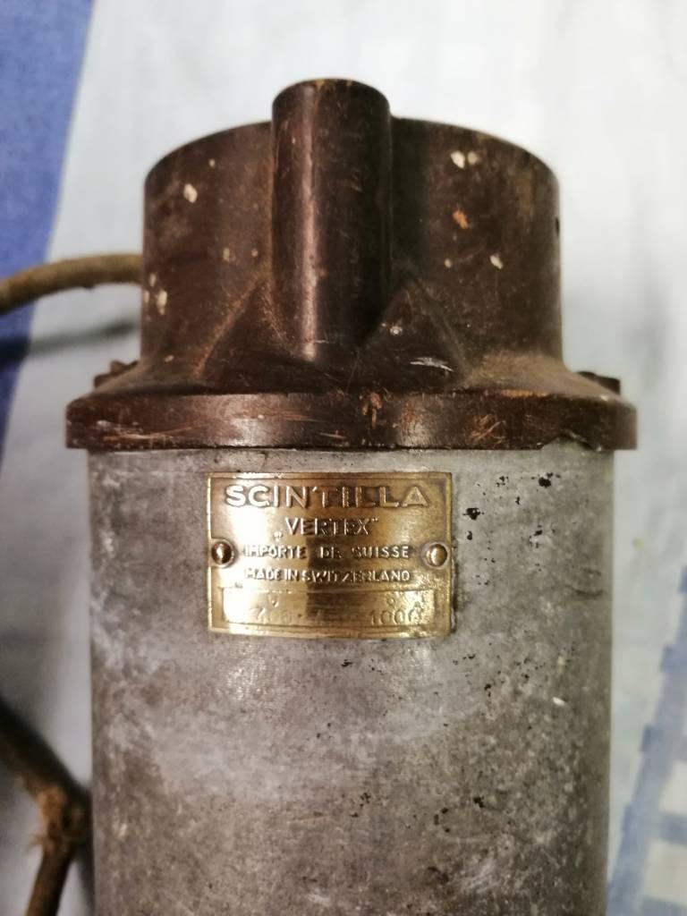

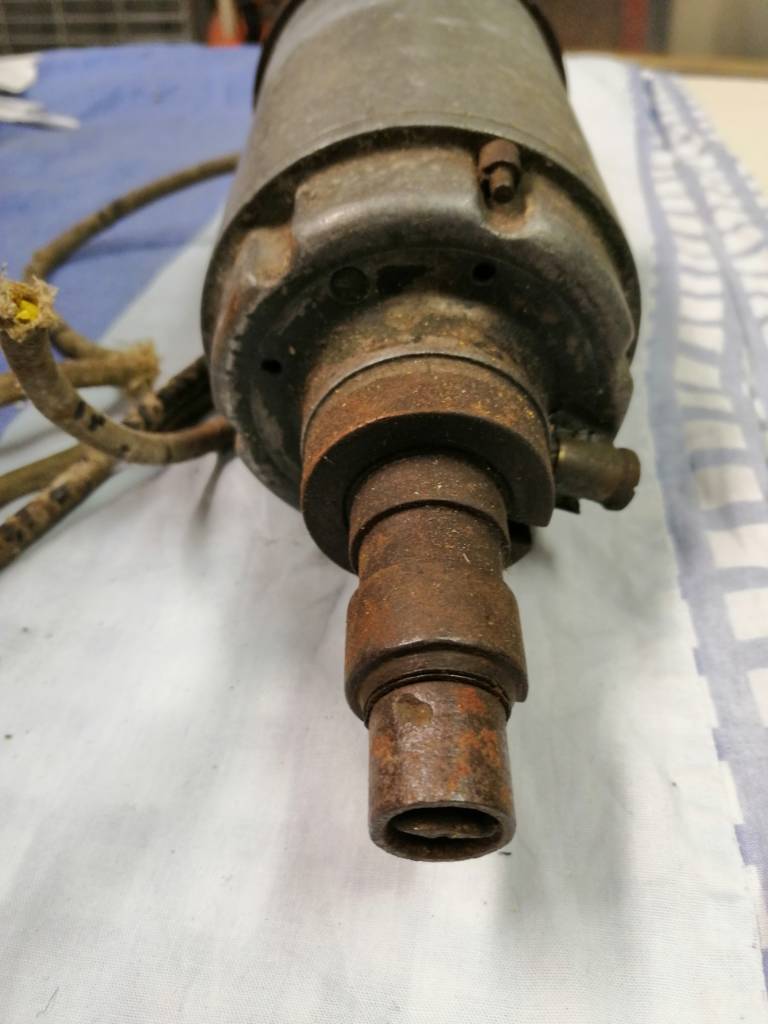

  1. In a box of parts I got I found a Sincilla Vertex Magneto. I have no experience with this type of ignition.
    Can I use this on a Ford Model A engine? It looks cool. How does it work? Can someone give me an introduction to Magneto's. The only numbers on the data plate that I can read are 400-450-1000. IMG_20210207_185933.jpeg IMG_20210207_185941.jpeg IMG_20210207_190017.jpeg

    It will need to be gone through, at that time they could add correct base, rotation, advance or whatever needed to make it work for you.
    Cap might be worth as much as the magneto as it sits if it's in nice condition.
    I wouldn't pay more than a hundred or so, considering how much work it needs.

    Not familiar with that shaft end configuration.
    What "box" did you find it in...a Model A, parts box ? If so, it might just fit, a Model A engine. What's left of the ignition wires suggest so.

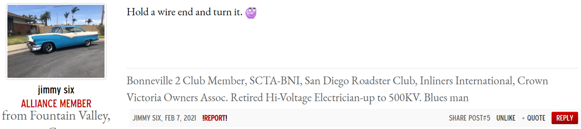

    Hold a wire end and turn it. :rolleyes:

    Please don’t hold the coil wire and turn it. That will juice you good. Looks like a model A and B magneto but it is missing it mounting plate/ clamp. The clamps I’ve seen are made of bronze. If it spins free and makes juice, run it.

    In looking at that tag is that a zero above 400? I see 6 degrees above the 1000, and the number above 450 is illegible to me but I think that may be where the advance curve begins.
    Keep in mind that the magneto turns 1/2 of crankshaft rotation so the advance curve probably starts at 900 RPM and is all in with 12 degrees @ 2000 RPM.
