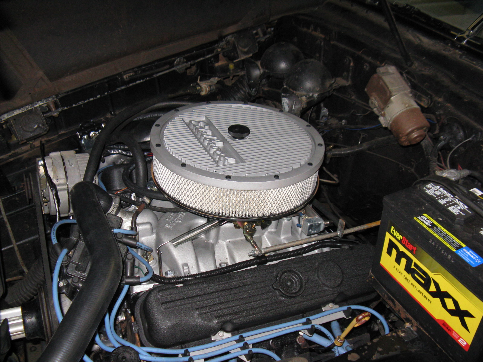

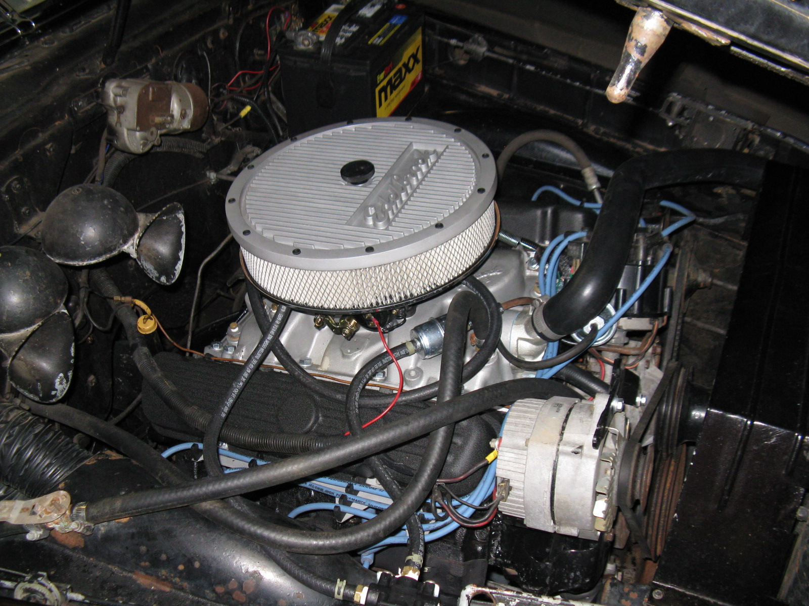

    Well, I got sidetracked a little. I had foot surgery on 4/22 and all was going well until 5/7 when a bad*** infection got into my incision. Fortunately, it wasn't MRSA but the doc made me sweat until the lab results came back. Anyway, I lost some time but I hope I'm on the road to recovery now.
    I got a new exhaust manifold installed, got the engine all put back together and the darn thing still didn't run right. After checking compression, I ***ured myself that the long block was right. So, I went to work on the ignition. It has an HEI distributor that wasn't working right, so I educated myself.
    I found out that the center plate was installed upside down and the centrifugal weights were worn out (pivot holes elongated), so I lucked out and had some extras and replaced them. After all was replaced, I ended up with about 15 degrees of mechanical advance with the full centrifugal set at 30 degrees. When I connected the vacuum advance, I had way too much.
    So, I did some research and stole an idea from the Chevelle forum, I think. I installed a Crane adjustable stop but instead of installing it the way that they describe it, I tapped a 8-32 hole in the vacuum advance and installed it as an adjustable stop. Works slick as snot on a doorknob! I now have 14-15 degrees of vacuum advance, so I'm about 30 degrees BTDC at idle (full vacuum) and at wide open throttle. The throttle response is great and it seems to run very well at cruising throttle, which can be as high as 45 degrees.
    I also cleaned up the engine a little. I bead blasted the intake and air cleaner and coated them with high temp satin clear. I sprayed the valve covers with black wrinkle finish and installed new hardware. I also pressure washed untold years of grime off the engine and front suspension. So, at least I can work on it without getting nasty as hell now.
    Also, I set the toe in. It was about 1/2" toed in. I swapped that for 1/8" and it drives better. Still have some suspension issues to sort out but that's for this coming weekend.
