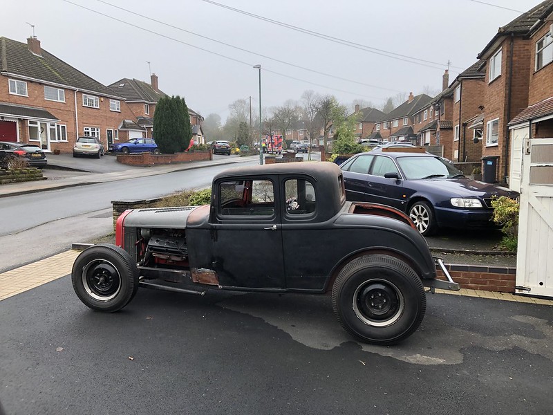

    Mart's video above does a pretty good job of highlighting the problem areas on the car but I thought I would throw up some detailed pictures. Whilst the car does run and I can pull it in and out of the garage it's by no means a driver. In an ideal world I would try and keep the car as together as possible and carry out the remedial work as I went along but I think there are too many engineering issues to sort and they will be easier to do with the body removed and if I'm going that far I may as well take it all the way so I can make everything more presentable and better protected from the elements. Add in the fact that I drive my cars hard and compete in hill climbs etc then I want to know it's built right.
    So the body and tin will need a lot of work but I'm not too bothered as this can be done over time. Good thing is the floor pans and rear wheel wells are new but everything is just tacked in. It was interesting to find that the body may have been heavily channelled along time ago and along with the fact that the cowl top and front 4 inches from another car have been grafted on it points to a possible interesting history of the body. Channelled, engine set back drag coupe? who knows.

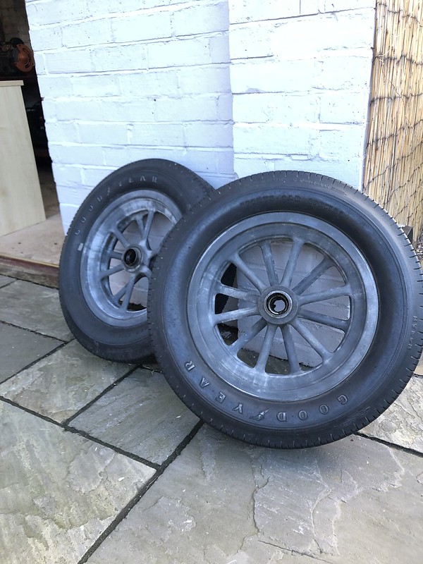

    I did have a rush of blood though and bought a set of ARE spindle mounts, they are just one of those things that I always wanted to run on a car.

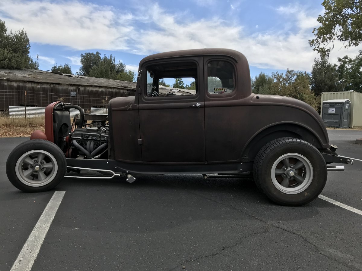

    Mine before fenders

    Love the new wheels, already makes a big difference.

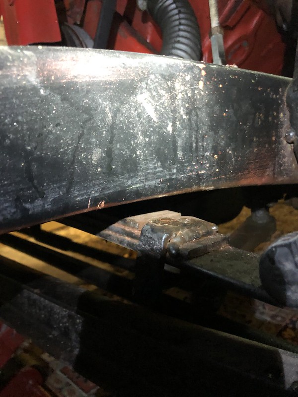

    The plan is to go through the front and rear suspension set ups while the engine and body are in place so the car remains at ride height. I decided to start at the front and address the issues there first.
    There was little to no clearance between the front spring and the ch***is so I had to notch the rails. This was just a rough job until everything is apart and I can tidy it up and box it in. I also removed a piece of box section that was used on top of the spring pack to raise the frame.
    With that sorted the next job was to address the excessive castor the car had. I measured it at 10 degrees which is 2-3 more than the ideal figure. I undid the wishbone tie rods and moved the end of the bones to where it gave me 7-8 degrees with a view to remaking the mounts but they wanted to sit right in line with the bottom of the frame and the boxed frame had a tubular member fixed to the inside rail at that height too. I decided to pie cut the bones instead to get the desired angle while using the existing mounts. First try and I ended up with 7 degrees so I'm calling that good.
