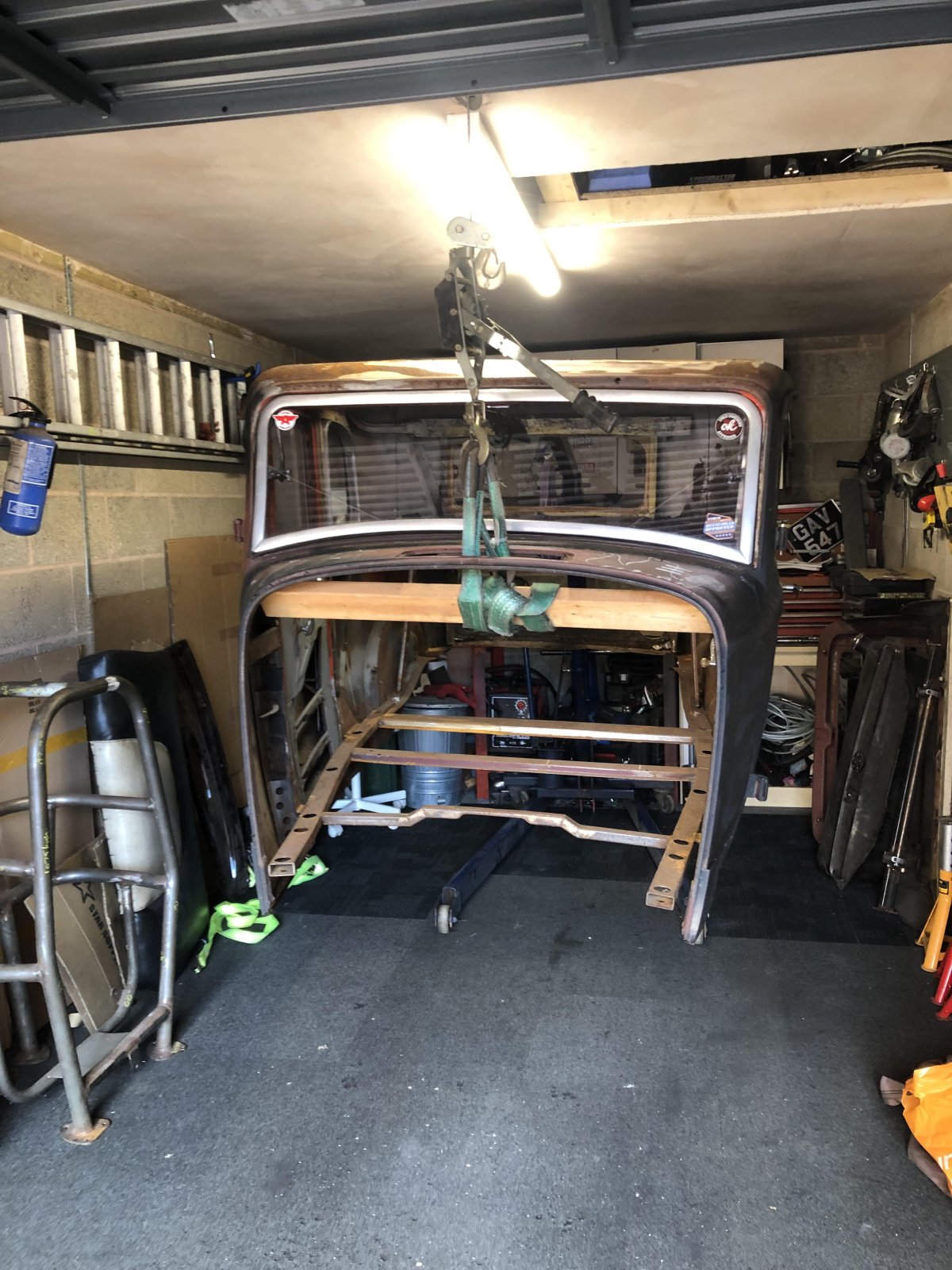

    Been a while since I updated progress on the coupe. Mainly because there wasn't much. A bout of poor health and the distraction of getting to race a flathead dragster meant the 5 window took a back seat but I'm back on it now.
    Since getting the car back from Kelvin I did undo the channel slightly at the cowl. Kelv had put where we agreed but I kept looking at it and decided it would look better with a uniform gap between the bottom of the body and side rail.
    Oh yeah, this was the distraction!
    With that done I could pull the body and continue the dry build of the ch***is. It was a sketchy operation but I managed it without incident!

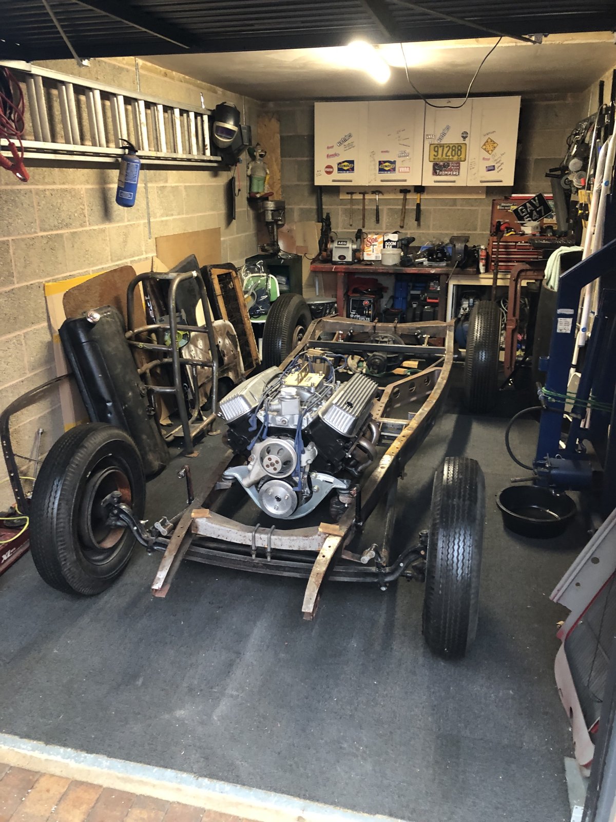

    Bit more done.
    With the exhaust fabricated and the brake lines ran the dry build of the ch***is is pretty much done. Managed to tuck most of the system up into the ch***is so it wont be visible side on. Need to add some cut outs up front for when I want to piss the neighbours off but they have been marked out and can be done off the car. I will also fab some 'weed eater' style headers for drag racing.
    I also added a mechanical brake light switch as I have had a few of the hydraulic type fail on me.
    I could now put the body back on, using the sketchy method that got it off, and enjoy it looking like a car again although there is still a long way to go. Floors will be next along with how to mount the set back firewall.

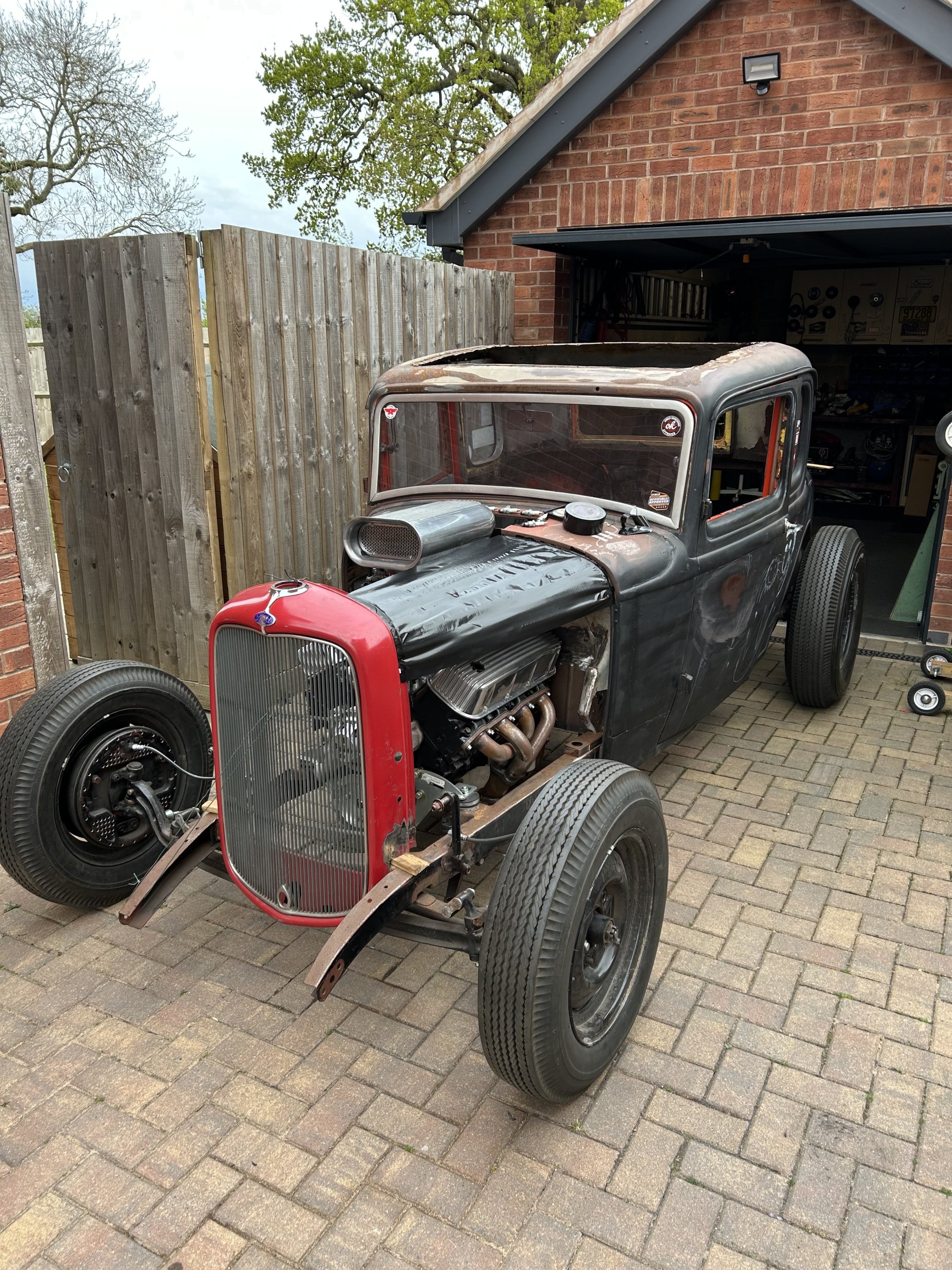

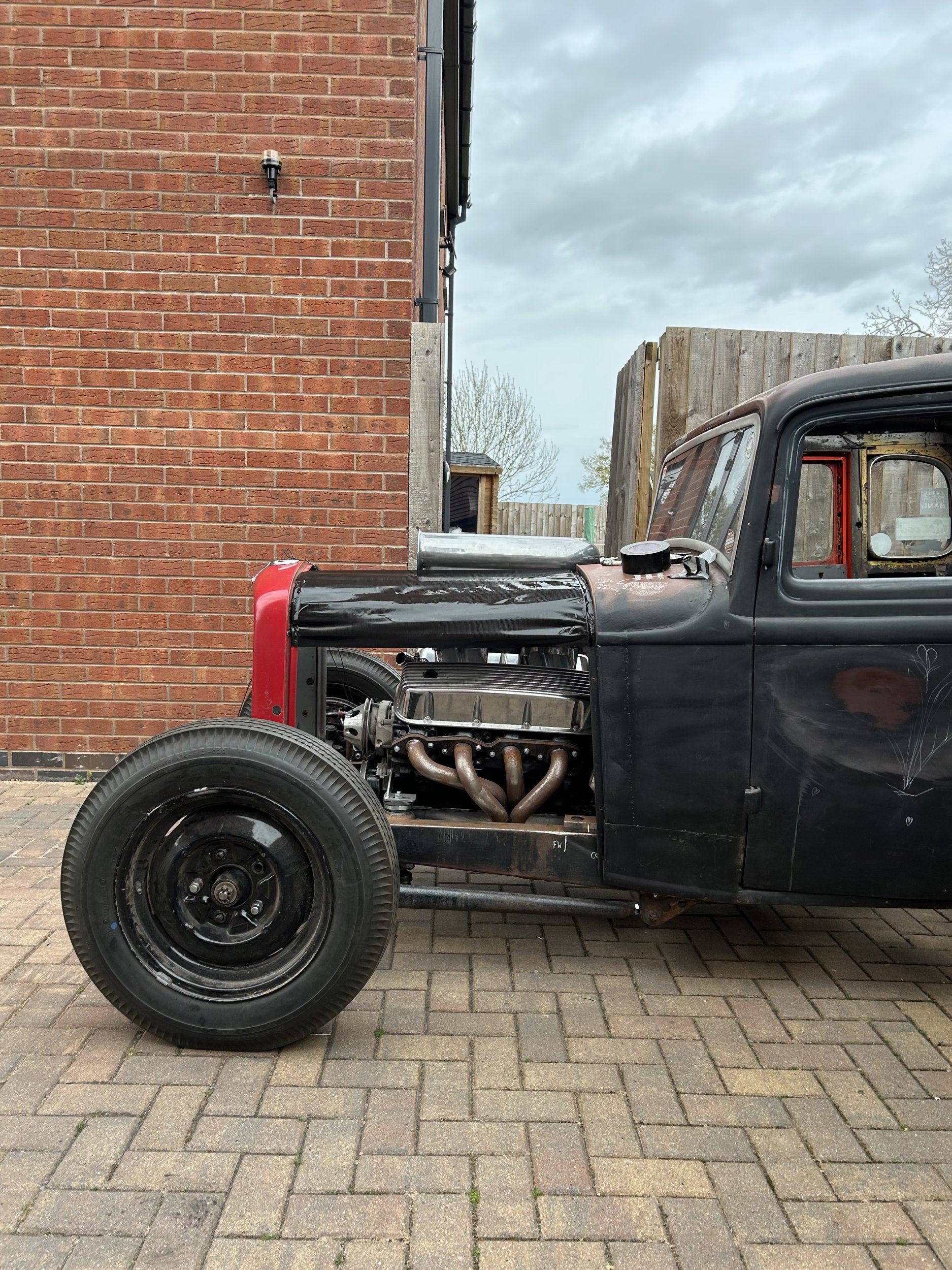

    Rolled it outside to make sure I like the tunnel ram. I do!

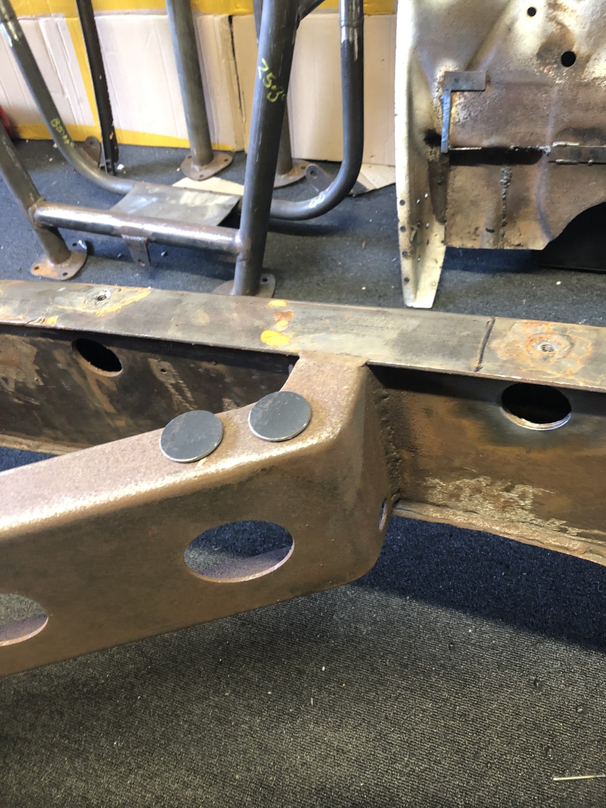

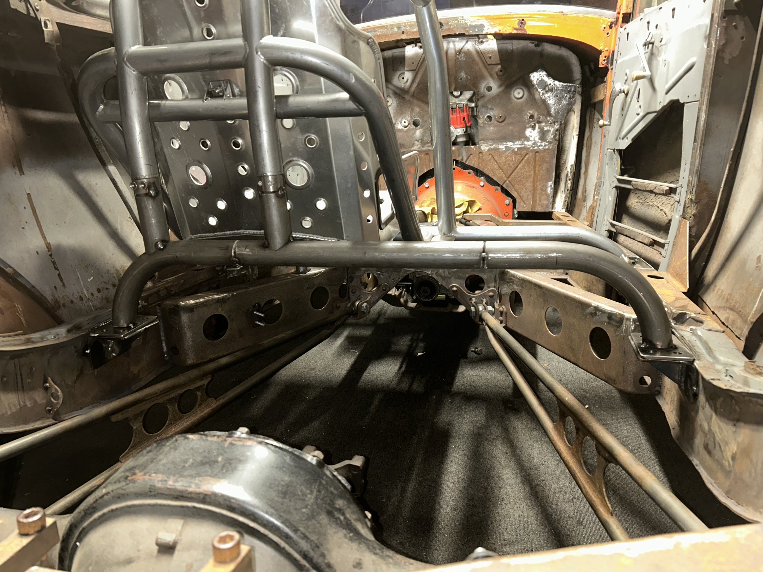

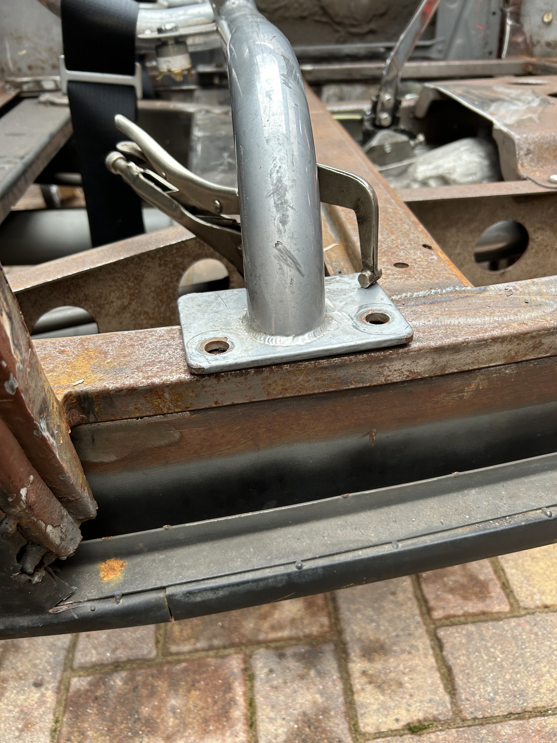

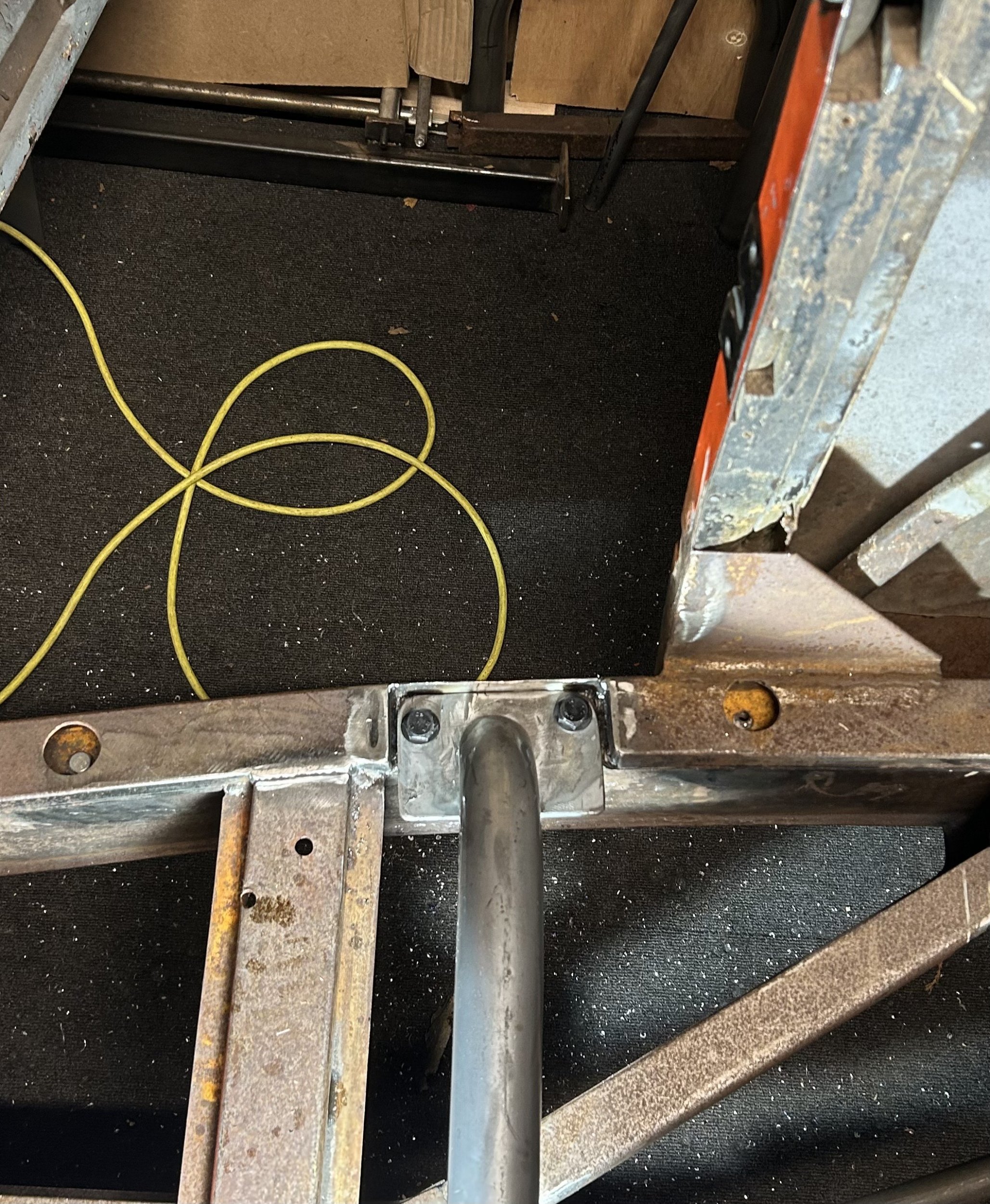

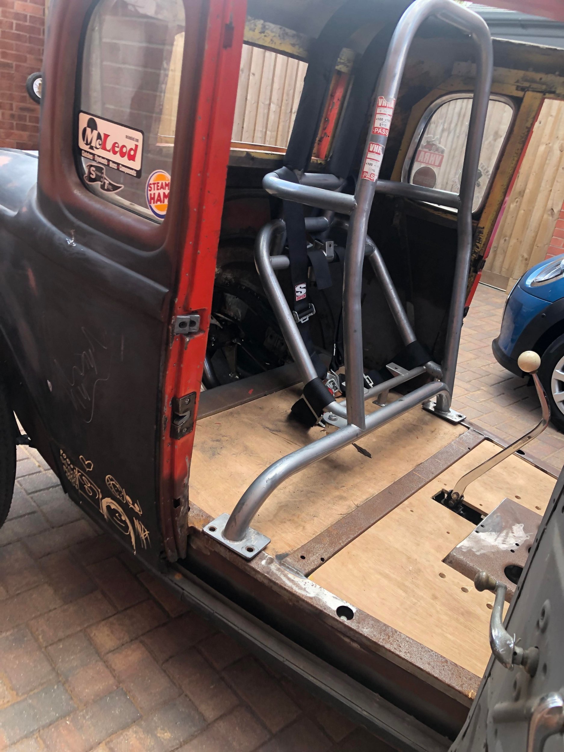

    I ended up removing all the crossmembers for the roll cage I had as a much better one came up for sale which had already been built for a 32. It was fitted in a roadster but after measuring I was confident I could squeeze it into the confines of the coupe.
    I ended up dropping the mounting feet through the sub rail's both to gain some clearance and to satisfy the regulations, there are brackets on the inside of the frame to support the overhang. Next up is a to fabricate a bar to support the rear of the cage.
    At this point I had fabricated the floors in wood but my neighbour, who restores VW t3 vans, said they would look much better in steel and dropped a bead roller, shrinker/stretcher and folder round for me to borrow so, now that the metal has arrived I will attempt to fabricate them again.

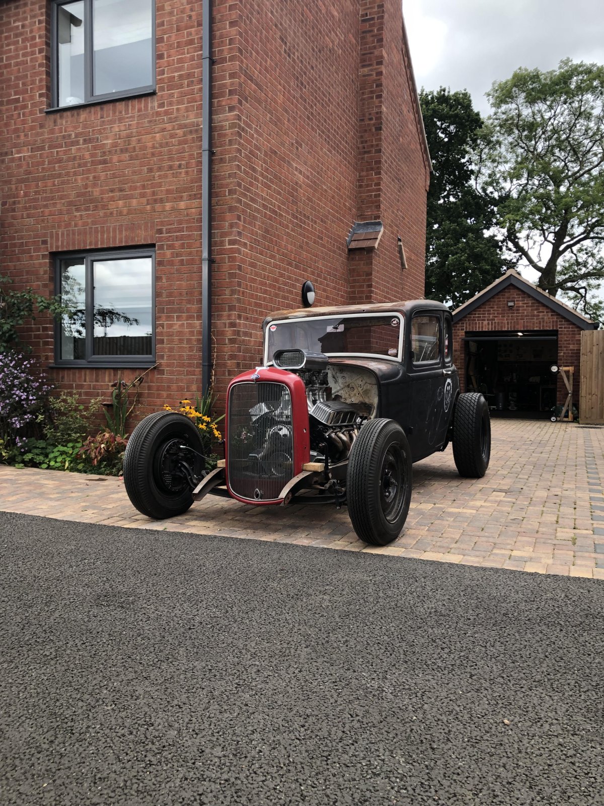

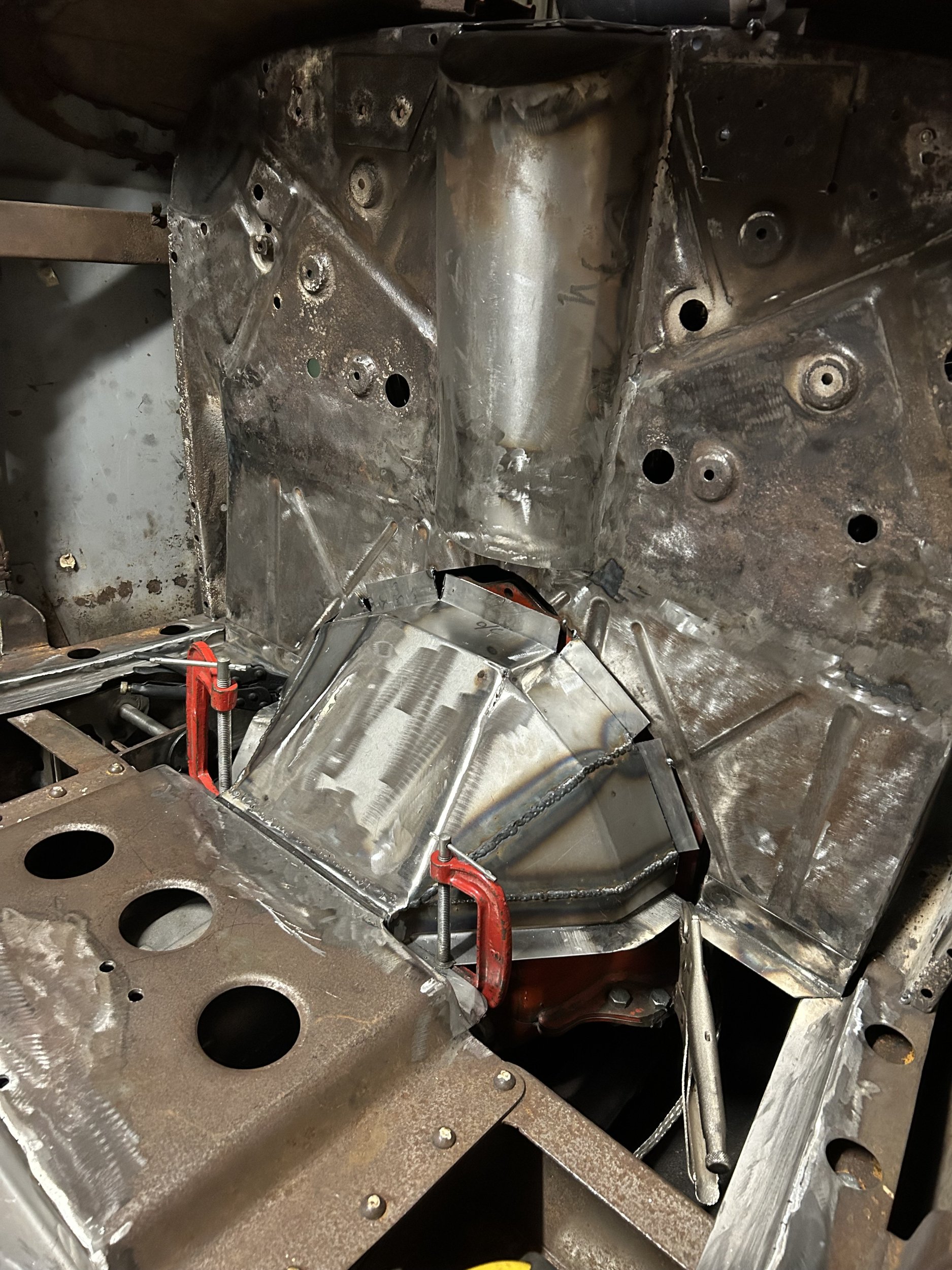

    Progress is still slow on the coupe but I'm getting bits done here and there.
    The mounts for the removable cage were finished and tacked in and I made a start on the steel floors.

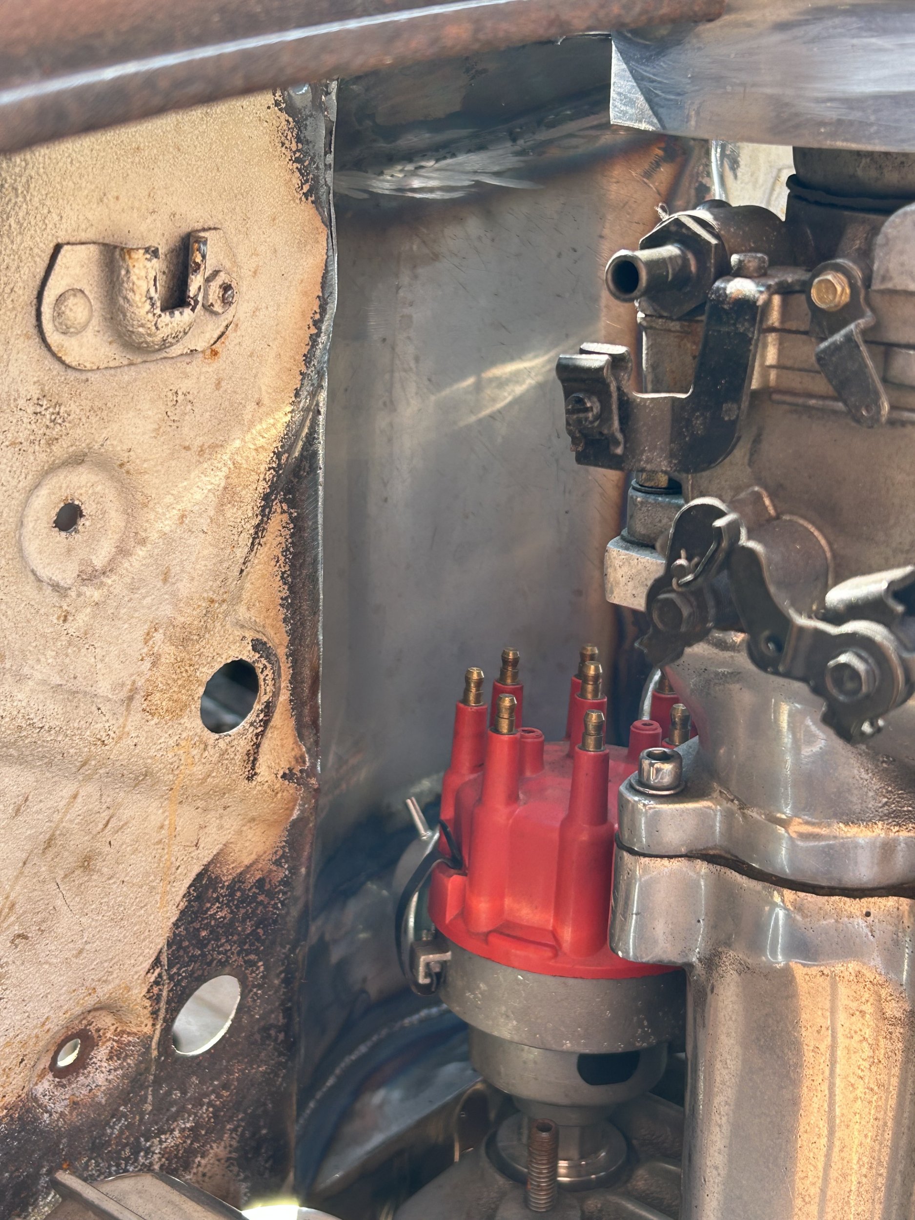

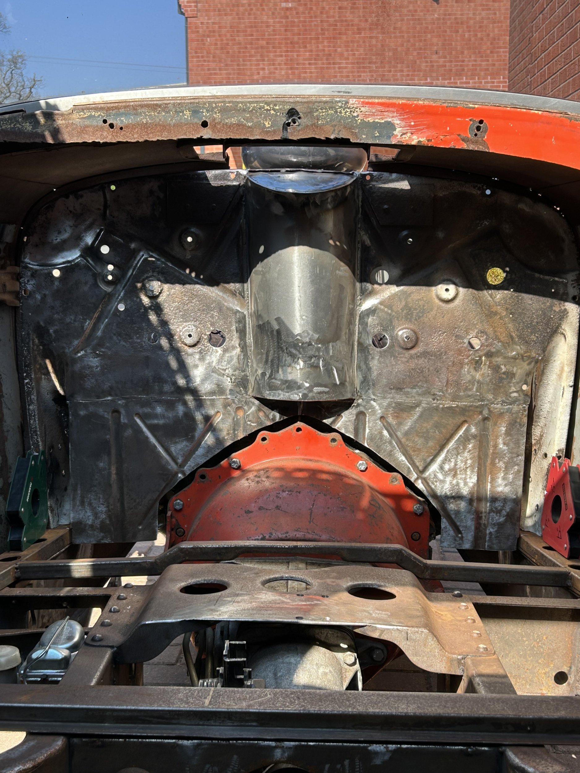

    Also, due to the engine set back, I needed to fabricate a piece in the firewall to allow clearance for the dizzy. I am by no means a fabricator and I nearly binned this attempt numerous times but with a bit of cleaning up and some paint it shouldn't look too bad.
    Next was mounting the rad so I could finalise the grill shell height. This can make and brake any car and we have all seen plenty of hot rods with the hood running upwards towards the shell. It never looks quite right. A roll of gaffer tape and lots of 'eye balling' and I think it's about right.
    At this point my enthusiasm was lacking a little, usual story so much to do not seeing the woods for the trees etc, so I decided that rigging up just enough stuff to get the big block fired up would be just the boost I needed.
    The motor, although rebuilt, has been sat for around 8 years so it would be good piece of mind to know it has no issues at this point anyway. I ran the fuel lines, fitted water hoses, wired up what was needed and incredibly it fired right up!
    Enthusiasm renewed! Hopefully more updates soon.

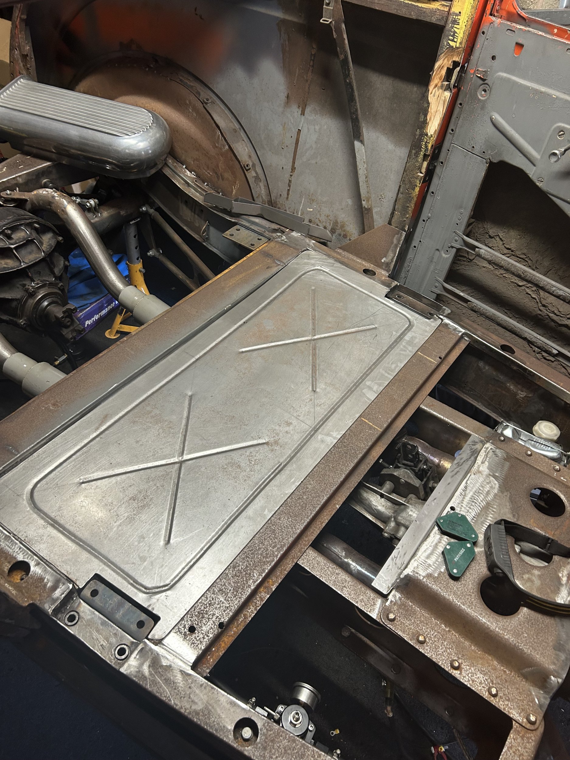

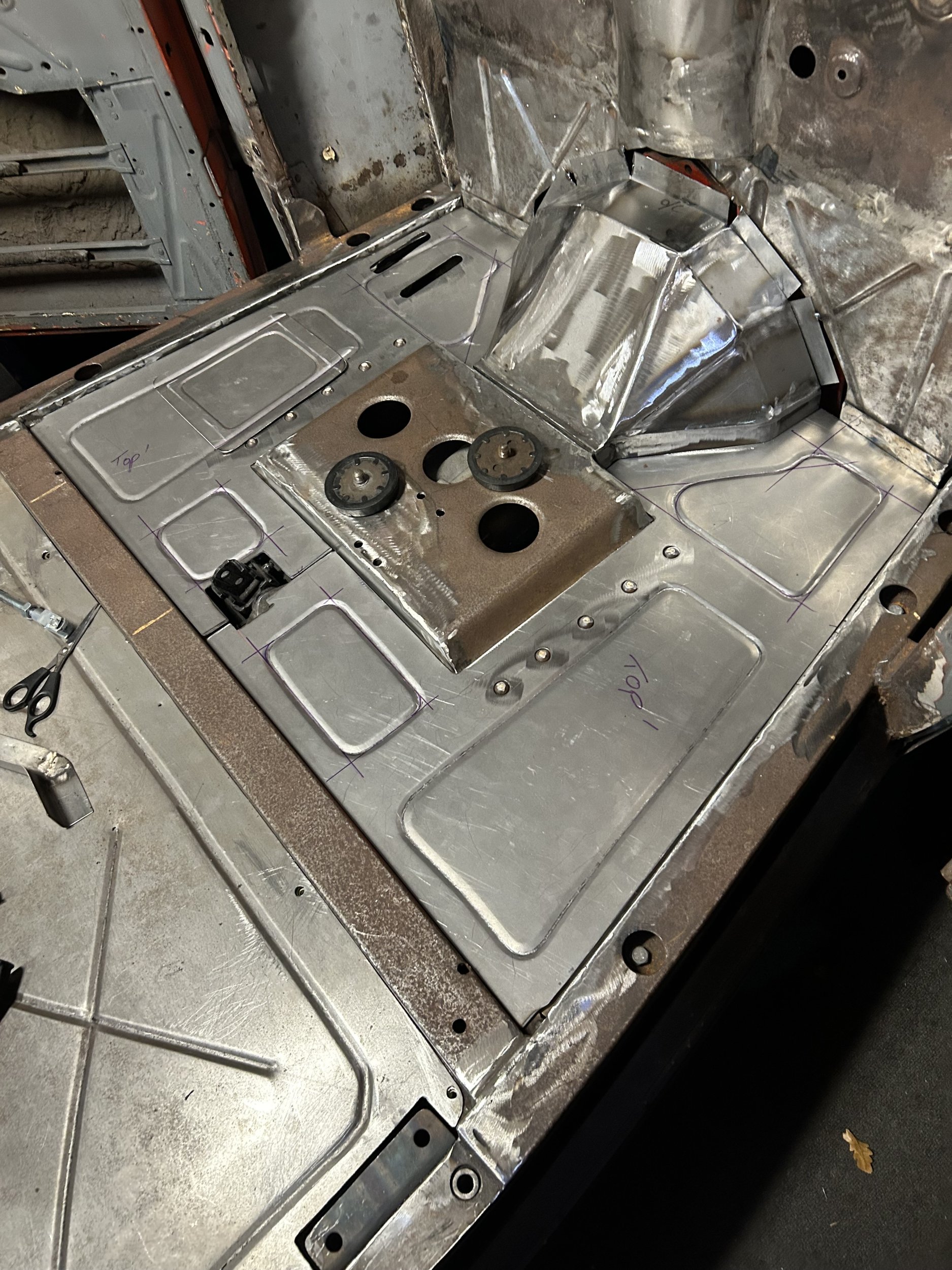

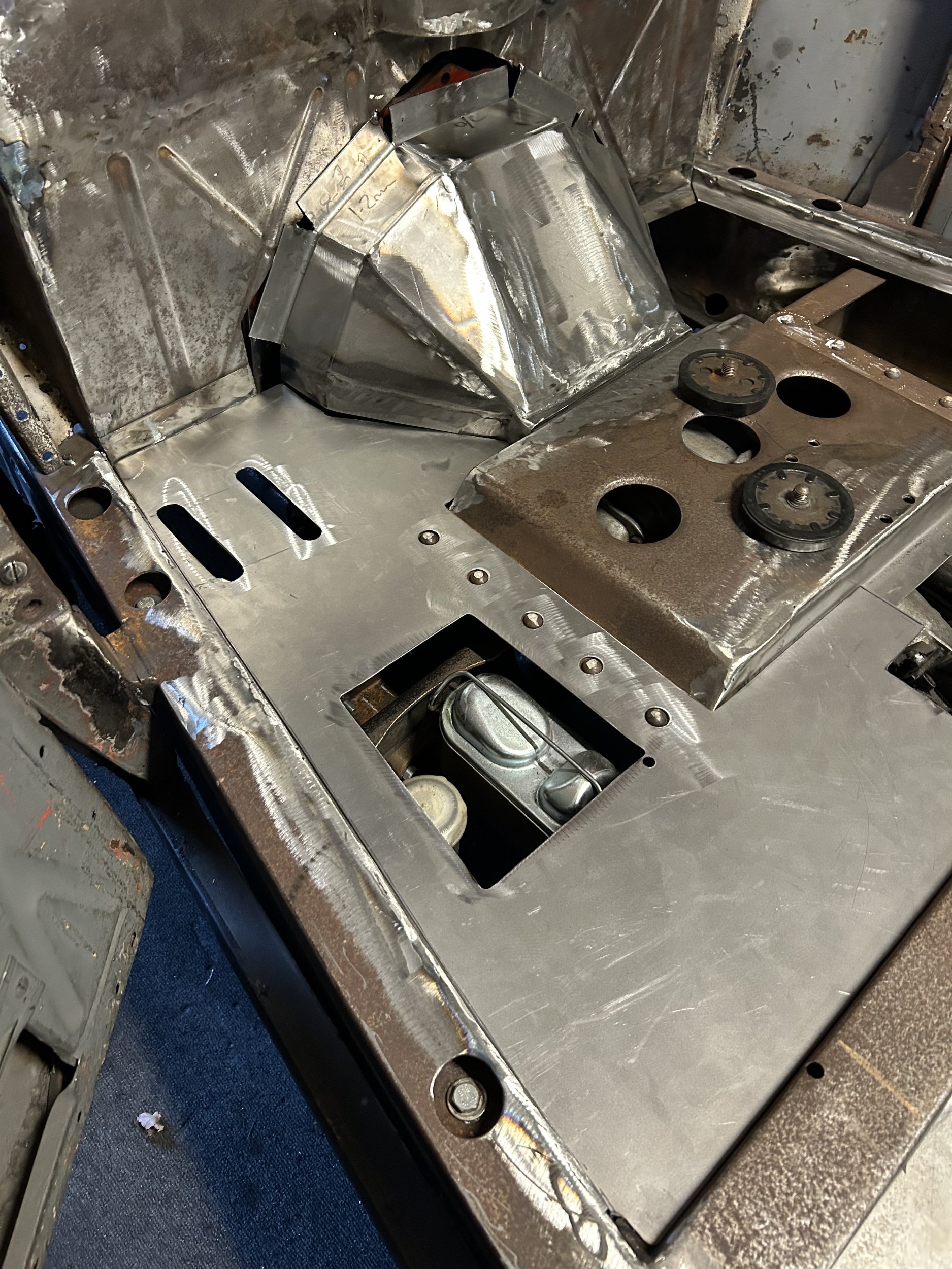

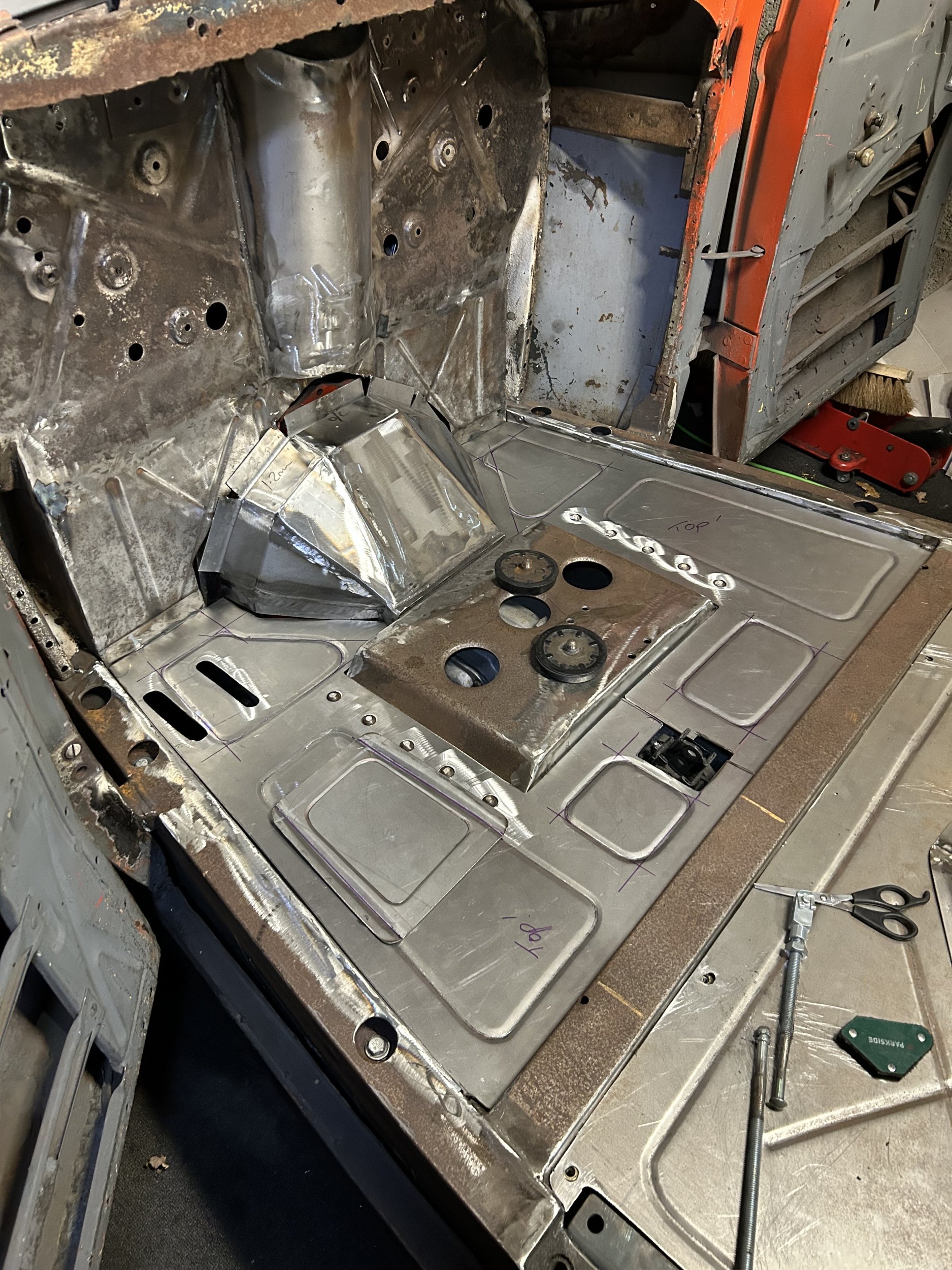

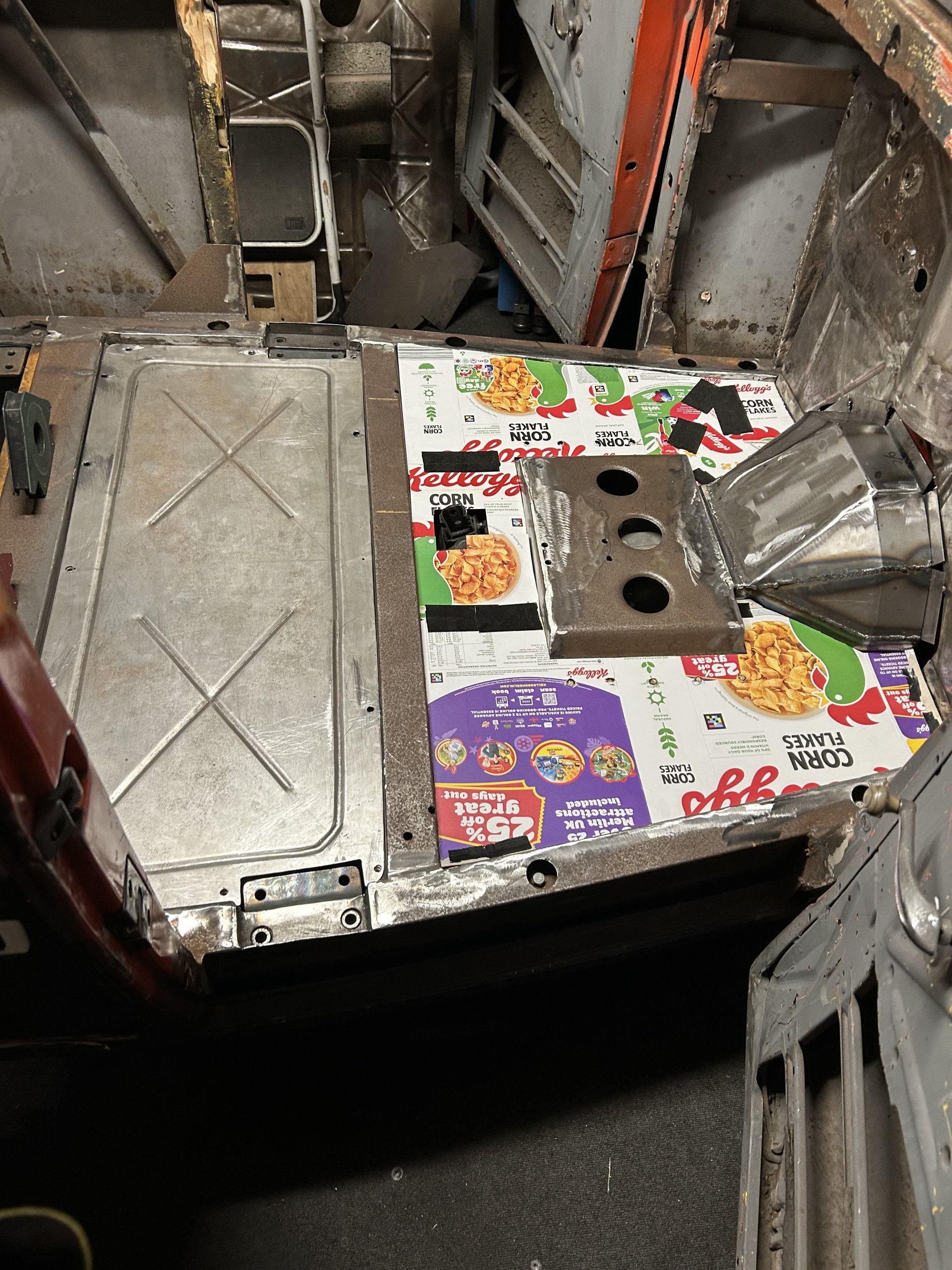

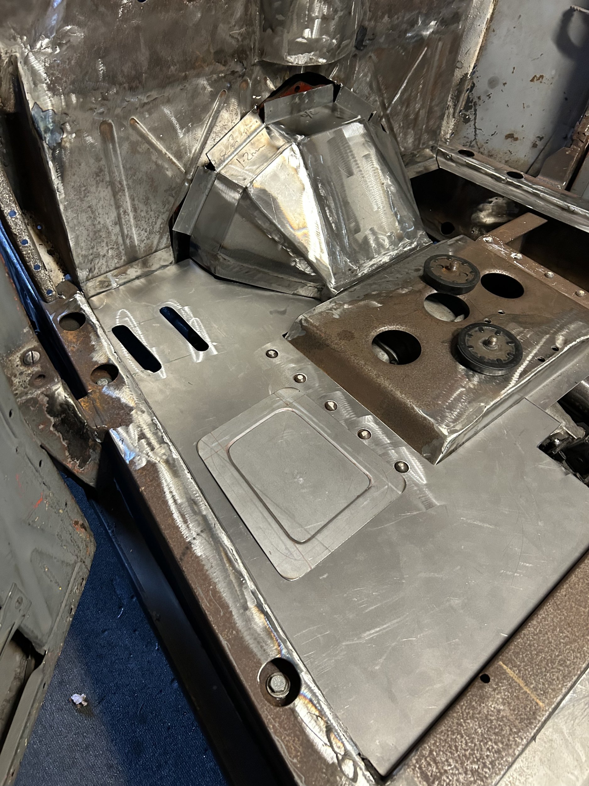

    With the motor firing up, sounding good and boosting enthusiasm it was time to turn my attention back to the floors.
    I finally decided exactly where the firewall should be located and tacked it in place ready to make some CAD (Cardboard Aided Design) templates for the floors and bellhousing cover. Kellog's boxes being my material of choice.
    I welded 1 inch angle around the internal perimeter of the subframe and the bottom of the firewall for the floors to sit on as opposed to mounting them on top.
    Once cut out, m***aged to fit and an access cover made for the brake and clutch master's, they were put through the bead roller. I little wobbly in places but hopefully people wont look too close!
    IMG_1598.jpeg IMG_1623.jpeg IMG_1600.jpeg IMG_1624.jpeg IMG_1628.jpeg IMG_1629.jpeg IMG_1632.jpeg IMG_1631.jpeg
