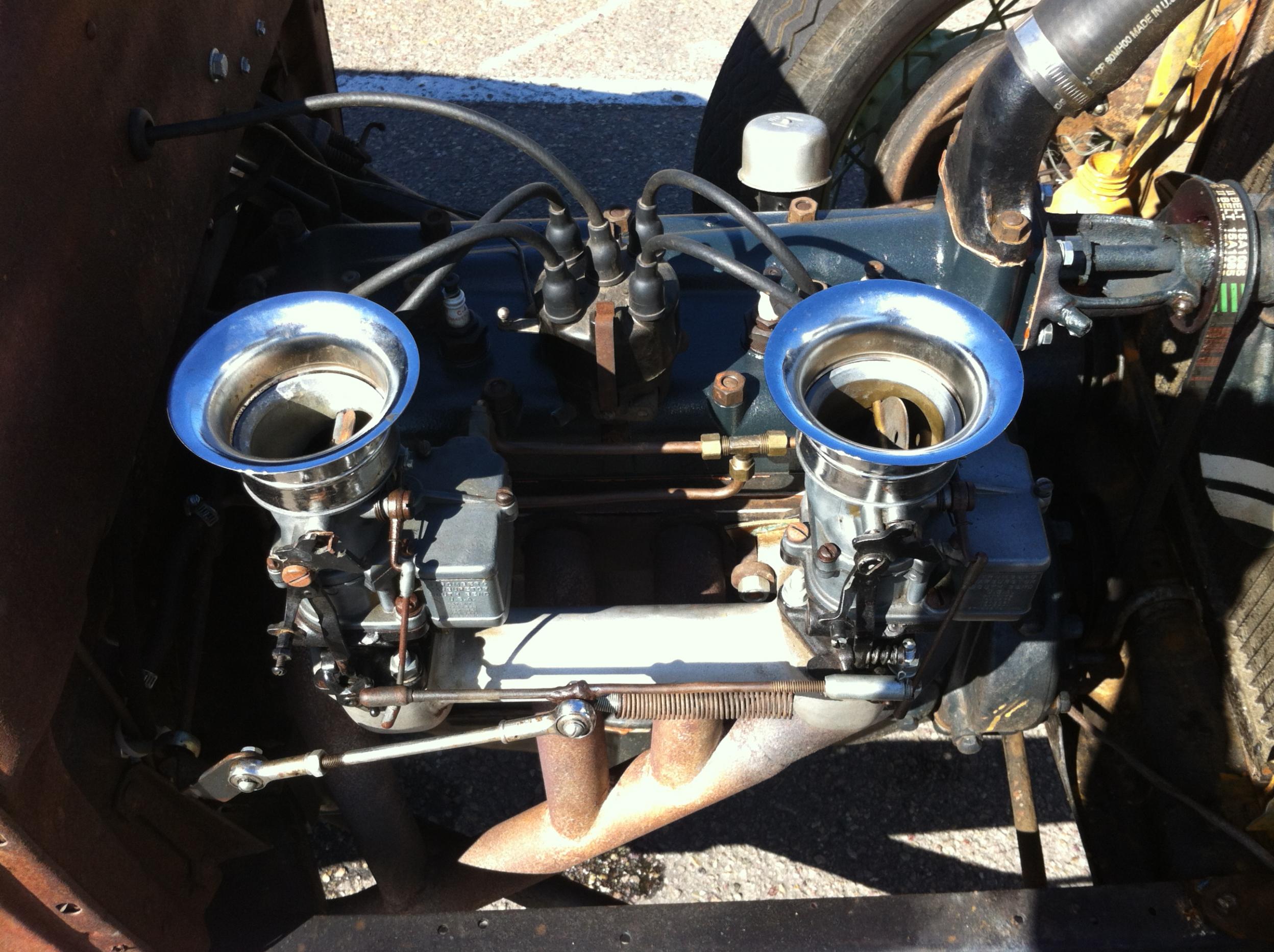

    Here are some too big carbs on an Evans intake. Ran best with one carb closed off. Hasn't been really tuned in yet. My buddy Russ's car.
    Rick
