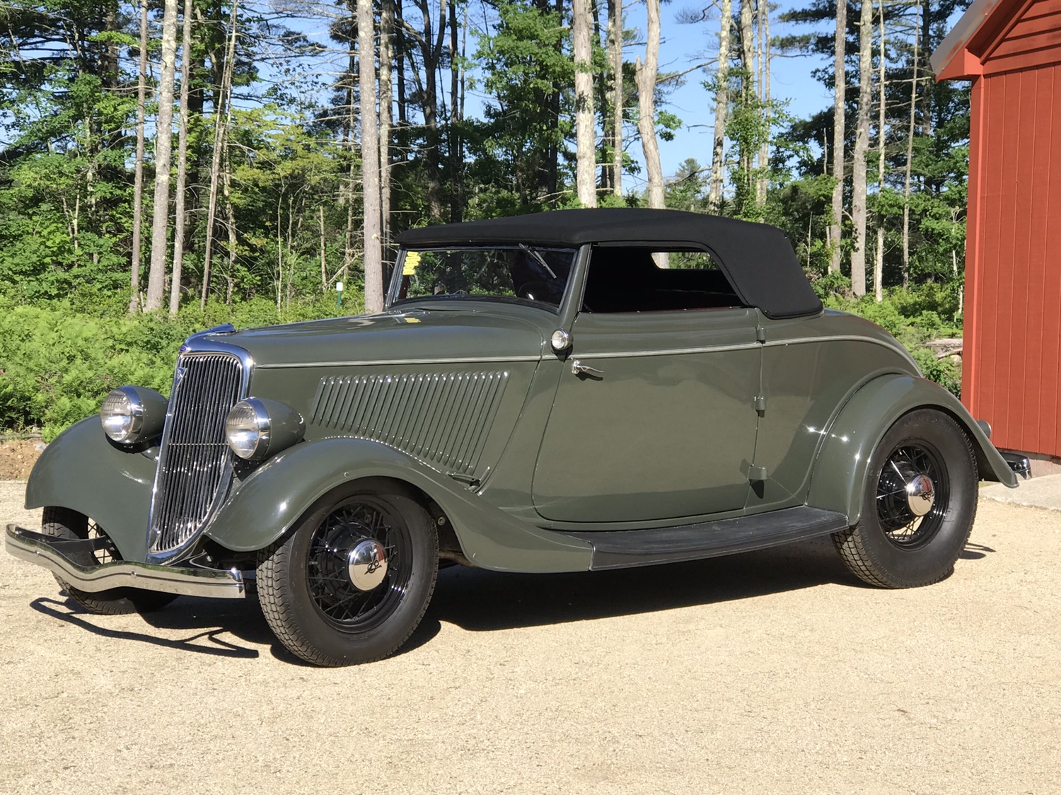

    I'm jealous. Best looking 33-34 cab i've ever seen.... Wow and Wow... And the top job! Wow again...

    I’ve been following along on instagram but only now just read through the whole build, an absolutely stunning car and build by quality craftsman. Very envious.

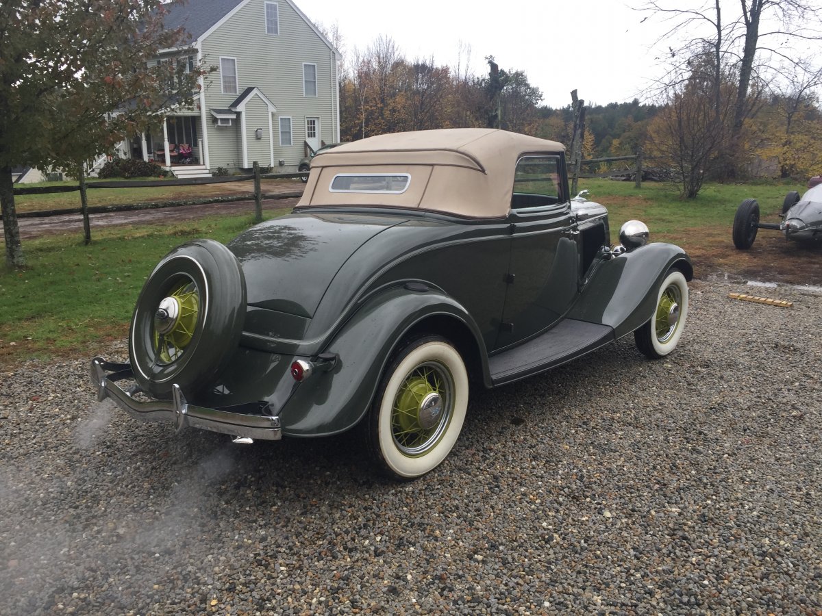

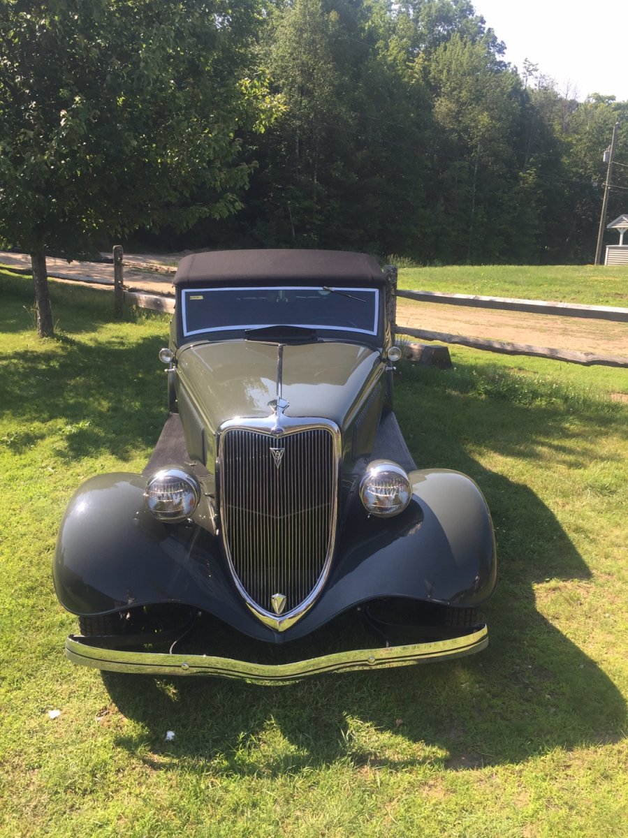

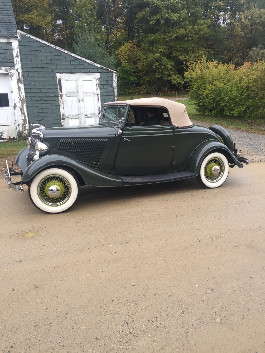

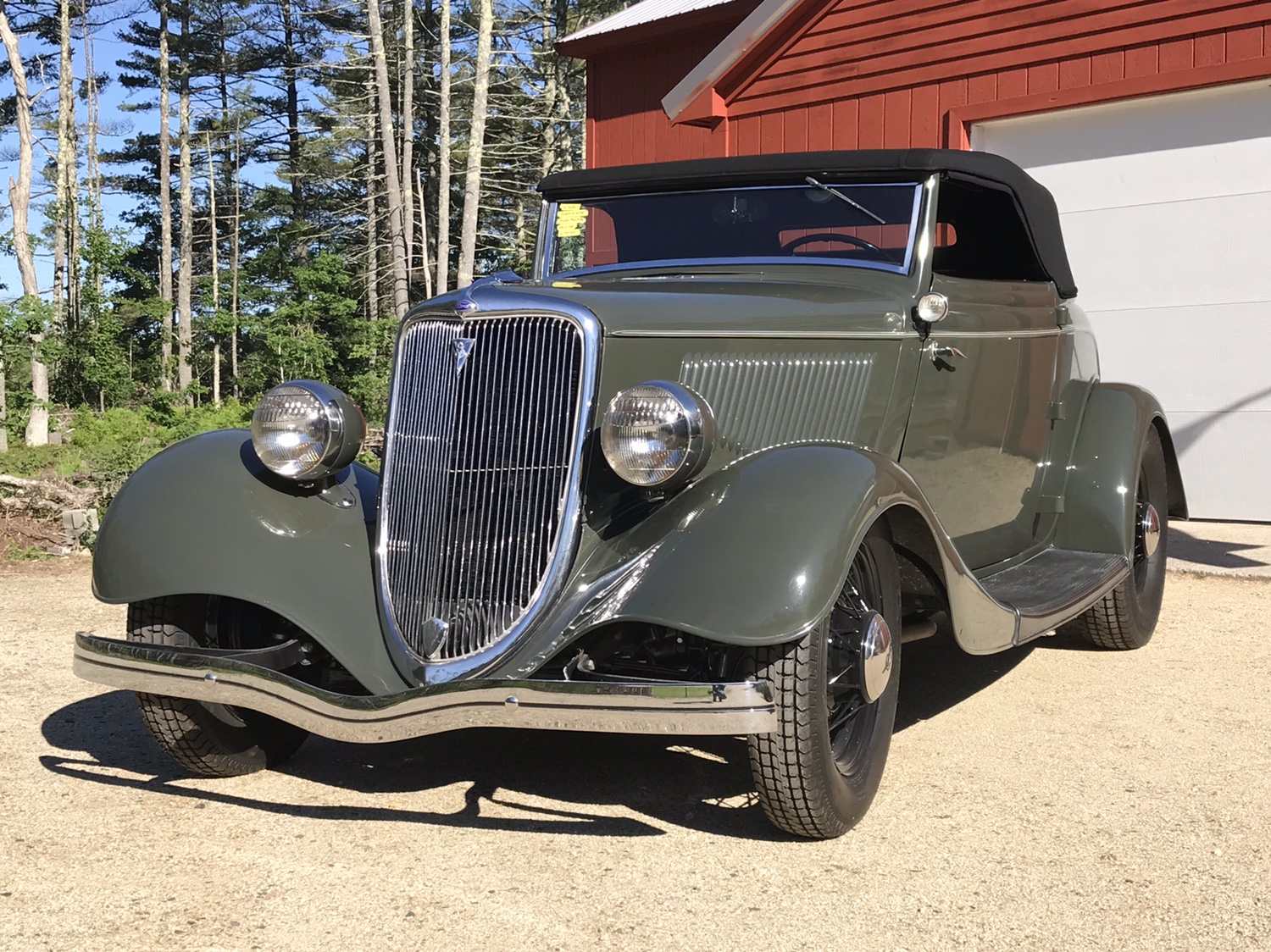

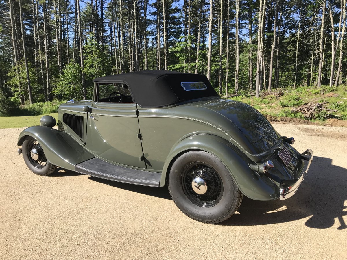

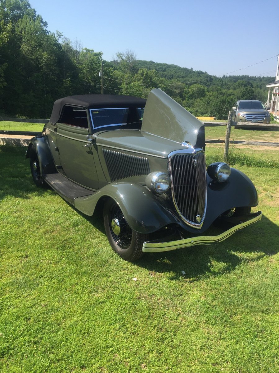

    image.jpeg image.jpeg image.jpeg image.jpeg From this to this in 7 months.
    All original Ford sheet metal.
    '40 Ford brakes, and a built 59AB, '39 trans, stock rear, dual exhausts, tube shocks.
    Windshield chopped 2.25", frame narrowed 1/4" to tighten up the gaps, and the A-pillar pie cut, and leaned back 4*.
    The B-pillar was lead forward 4.25", and the rear bow lowered 2", and the front header extended about 2", tapered, and lowered 3/8" to get it closer the the chrome frame.
    Lightly tinted green gl***.
    Reversed eye springs, F&R, and a 3" dropped '32 big beam.
    5:50, 7:50 Excelciors on stock 17" rims.
    Bumpers tucked in F&R.
    New Neal Jennings 18:1 steering box.
    '36 Ford headlights, stock tail lights, shortened 2" with '37 Chrysler lenses, 12V.
    '39 Ford Banjo now, but waiting for my restored '37 Zephyr with translucent rim, horn ****on, and shift knob.
    Cognac leather interior in stock pattern.
    Eli's fooling around with a junk dash to add some Diamond T, Art Deco gauges.
