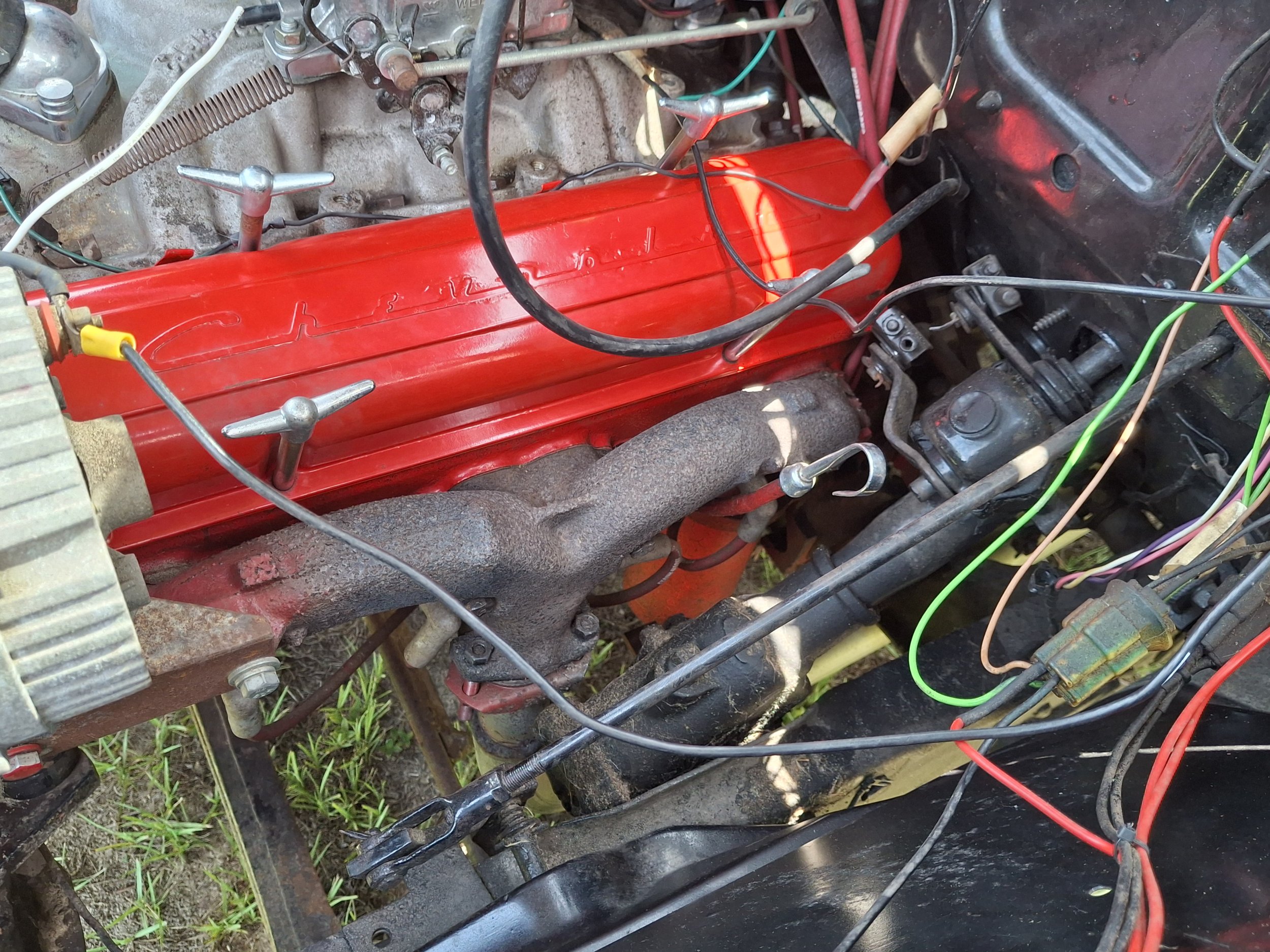

    I took a **** ton of pics. What would y'all like to see? Here are engine and ***ociated pics. It's far too hot and humid to climb under the truck today, and I'm home sick, so these pics are all from above. 20250610_134448.jpg
    Please don't get hung up on the wiring! This is me tracing circuits and labeling everything so it can be rewired properly. It's what I was doing when I parked it a couple years ago. The engine runs amazing! Thanks for looking.

    Sounds like you are a long ways down the road if you were to just finish up the wiring, get the steering tightened up, get brakes either rebuilt or swap to disks if that is what you would rather have, get the suspension rebuilt and then just do some cosmetic stuff. Oh, and sounds like the shifter linkage could also use a rebuild to get it shifting better? It is a very cool pickup and wouldn't take much to get it more enjoyable to drive.
    Thanks for posting the pics. That helps us all know what you are working with.

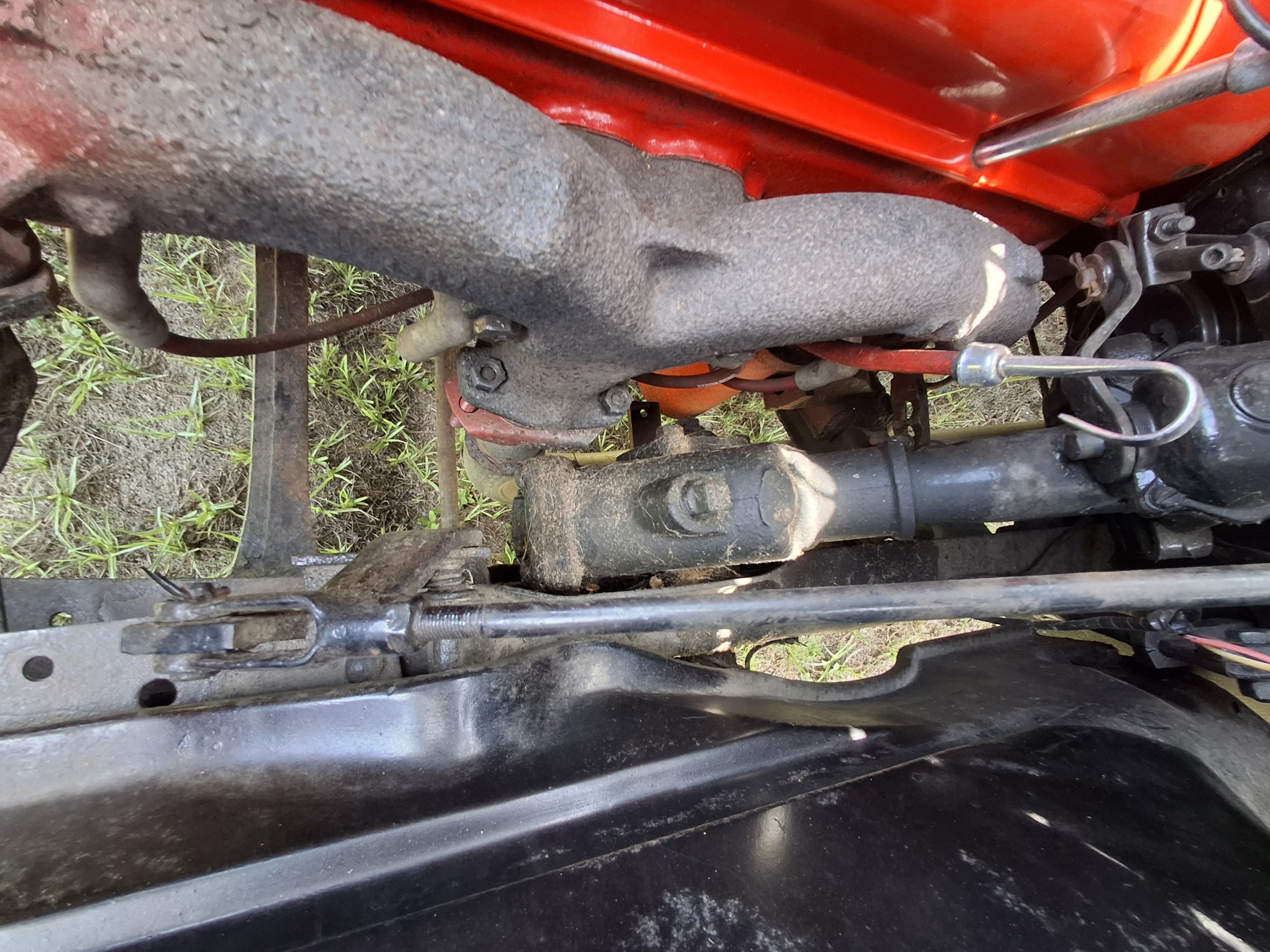

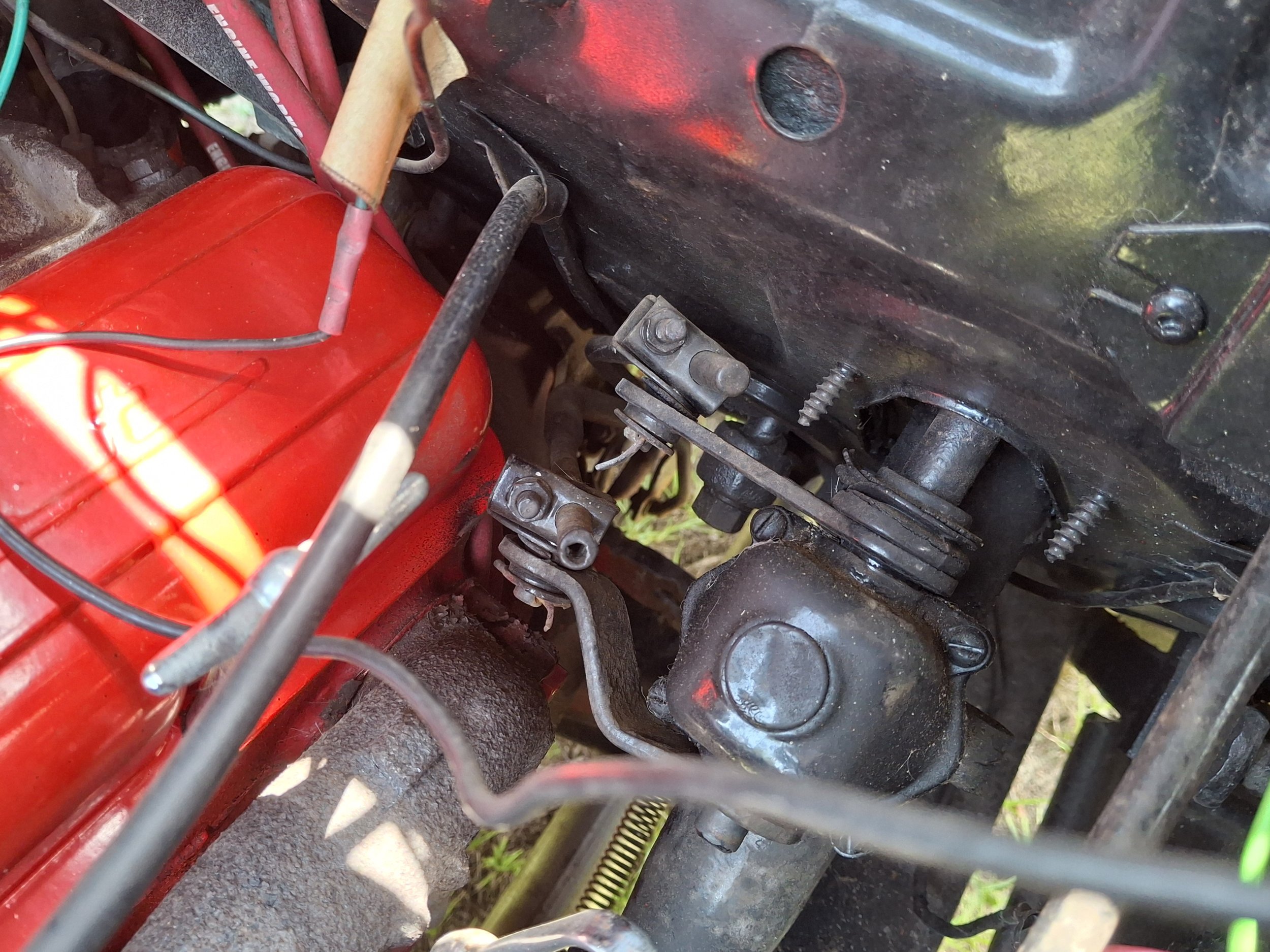

    The original steering box has two adjustments you can do, on the bottom of the box there’s a large “nut” that’s held in place with a metal lock ring with tabs on it, flatten the tabs (bubba speak coming) and use a chisel and hammer and snug the nut up. Just enough until you feel a resistance to the light taps on the chisel.
    Then on the top of the box there’s another adjustment, break the lock nut loose, if memory serves, a flat blast screw driver adjusts the “bolt”.
    Now when you do this part, put the tires in the air. Use the axle as the lift point.
    Rotate the steering wheel, tighten the “bolt” with the screw driver. Go through lock to lock as soon as you feel the slightest drag, back the “bolt” off a bit. Maybe 10-15 degrees? I dunno, been many years since I’ve done it.
    You don’t want to leave it tight, if too tight you’ll have steering issues, so sneak up on it and then back it off.
    This just takes the play out of what you have, it’s not a cure for worn out parts.
    There may be instructions in a service manual, Motors manual, not sure.
    My dad had the know how and had me do it to the TF pickups I had. It did keep the trucks steering and holding the road much better.

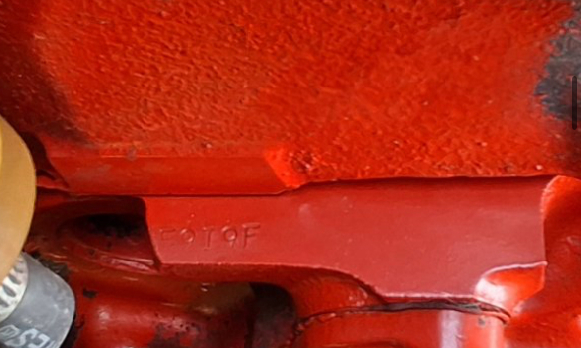

    Looks like an F
    it has side mount provisions it’s a 57 283. If no side mounts it’s a 265.
    Originally power glide according to internets info
    Regular heads.

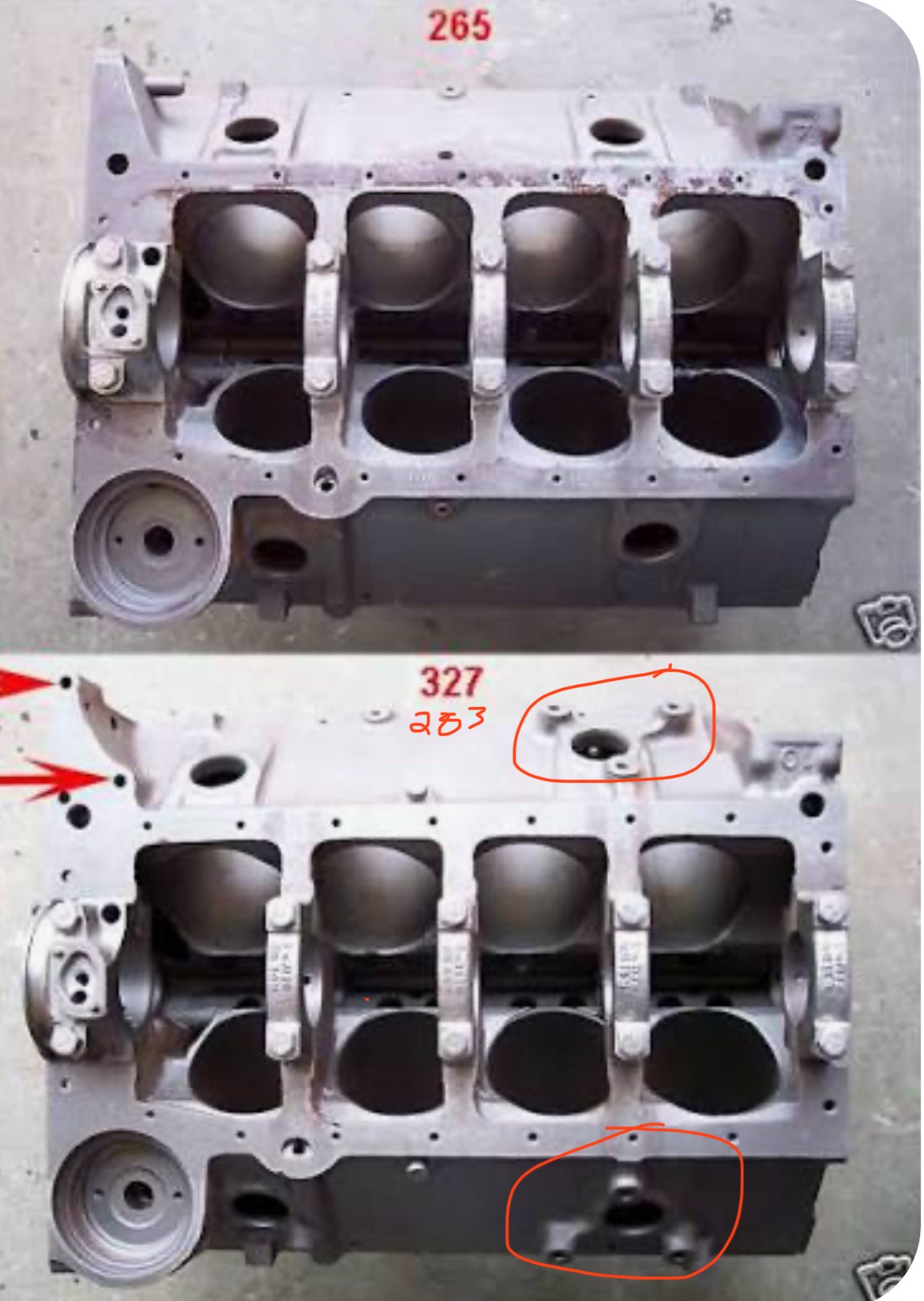

    F 9 19 F, it looks like, so it would be from the beginning of either 56 or 57 model year. The casting date at the back will get you more info.
    F at the front means it's from the Flint engine plant. 9 is the month it was ***embled, 19 is the day it was ***embled. F code was used for the 265 2bbl with powerglide in a car in 56, and 283 2bbl with powerglide in a car in 57. The casting date and casting number at the back of the block will tell you which, but that's usually hard to see when the engine is installed, and probably covered with dirt back there.
    I see the mounts, sort of, looks like they welded a thick strap on top of the frame, hanging out in back to support the mount cushions, which I can't see at all.
    Yes, the wiring is the place to start. It looks like it has the original wiring under there, with a big mess replacing part of it, and added onto it. I wonder if they still sell reproduction harnesses for a reasonable price? That's how I'd go, unless you intend to add a bunch of "stuff" to the truck, and want some fuses and more circuits. In that case, it'll take some effort to get it to what you want it to be.
    When you get to the steering gear, first pull the plug and poke something in there and see what you find, you're looking for thin grease, not rusty globs. The nut and stud on the engine side of the box is the pitman shaft adjustment, if the threads on the screw in the middle are no longer visible, then it's likely that the bushings are worn out, and the screw has been adjusted in too far, to try to get it a bit tighter. But there could be more serious problems with it, which are easiest to diagnose by removing the gear and dis***embling it. And having a good used one on hand to replace all the worn out parts :)

  9. 265 vs the later blocks
    But a 57 283 probably shouldn’t have the side mount bosses either
    Showed up in 58

  11. 2Old2Retire
    Joined: Jun 6, 2025
    Posts: 30
    2Old2Retire
  12. I added a side note.
    58 should be the first year for side mounts.
    Ive heard rumors of some late 57. I’m no expert
    I posted the pic so you’d know what to look for
    osage orange and 2Old2Retire like this.

    On the steering...beware that it could be the kingpins causing hard steering. Just another thing to check.
    You could jack up the front axle and put it on stands, and then have someone wiggle the steering wheel back and forth. If it doesn't wiggle easily even a little bit, then it's probably the steering box. If it wiggles a little then gets hard to turn, likely the king pins. If it turns easily, then you just need more muscles in your arms to drive it. Or possibly the kingpin thrust bushings are seized.

    I have a late 57 235 with side mounts that came out of a 57 car . I know V8 mounts are being discussed.
    2Old2Retire and anthony myrick like this.
  16. In the one picture, doesn't look like there a side mount bosses in it. But, it could be my eyes.

  20. The first 283s didn’t have side mounte
