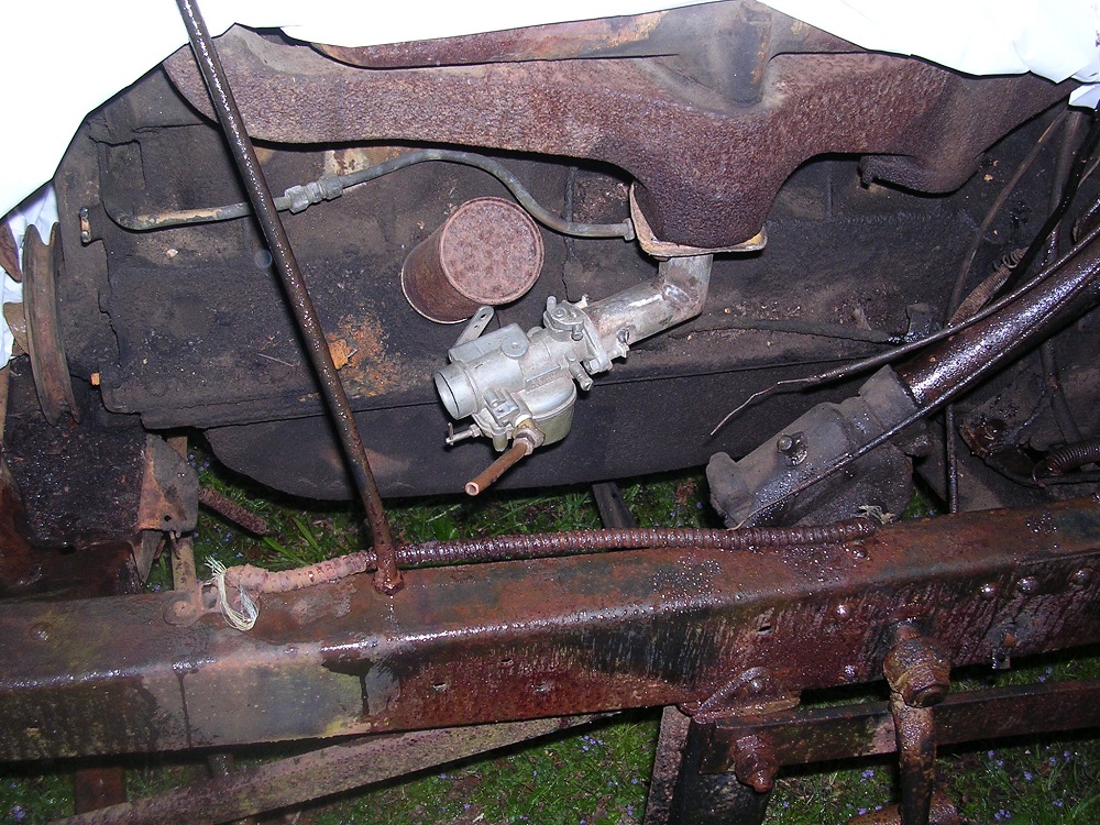

    Well, I did "snap" the valves on the Number One cylinder that was no compession, and now I have good compression on all six......but the drill can't turn it over very well now. If my friend can't find a starter soon, I either need to make a hand crank, or pull 3 or 4 plugs out, to see if it will fire.
    We have a early 50s crawler loader here that can easily pull the Chevy in gear, but I don't dare! We have all heard of the early Chevy's having weak rear axle shafts, if I try to pull start it, the amount of force on the axles, from the big gears trying to spin the small gears, might snap an axle? IDK
    I got rained out, but it is ready to fire. I took the points out and ran the contacts on the wire wheel, and they are mint. One distributor cap clip was rotted off, but one from a VW bug fit perfect.
    Then my son showed up and he cranked while I watched the oil pressure gauge.....no pressure..
    So I fed oil down the 1/4" copper line from the gauge, to prime the pump. It looks like a small piston pump on the block, not sure though. Priming did not work until I primed it again while turning the motor backwards. Could be coincidence, but it then started pumping oil when I went the other direction with the drill.
    I also found a single cylinder horizontal carb that I has forgotten about. It was one that I made a 90 degree adapter to mount on I think it was a 2 cyl-opposed 1907 Maxwell, that I needed to test start. So, that is on the Chevy now....and I have a one gallon test gas tank to hook up to it, and it's "ready to go" :) ..it does not sit level, but should work for now.

    The Ford Model A carb you mentioned would be a better choice than the small engine carb you are currently using.
    Original carb on the 1929 Chevrolet is a Carter type RJH-08. Early production is part number 125s, later production is part number 136s. Both were superceded in 1930 by type RJH-08 150s (which has a slightly larger main venturi). The Chevrolet carburetor has a 30 degree offset where the carb flange bolts to the intake.
    While the Carter is a beautiful carburetor when restored, the 1929~1931 models were all much more problematic than the Zeniths used by Ford.
