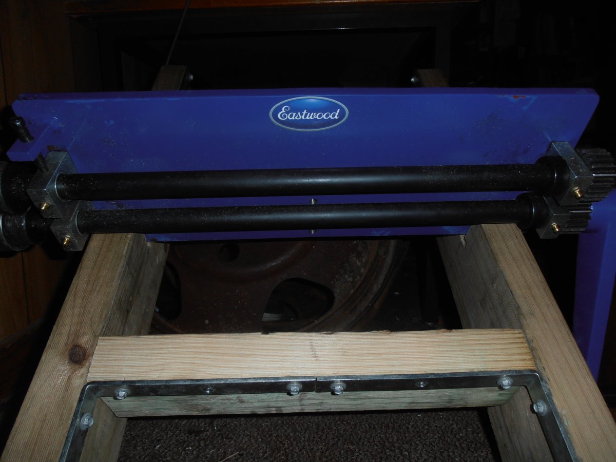

  5. chev34ute
    Joined: Nov 13, 2011
    Posts: 1,532
    chev34ute
    Hey Guys.
    Perhaps one of the biggest stumbling blocks with this project was how to tackle the doors and one thing that I did earlier in the year was purchase an Eastwood Bead roller with a separate set of dies. I was pretty disappointed with those dies due to the fact that the half round ones were too small and had resigned my self to having to either purchase more dies or get them machined to suit the complex shape of the doors.
    However the idea of spending hundreds of dollars more really put me off. I decided instead to get creative and try out some combinations from the bead rollers mandrels and the extra dies. I came up with this combination. DSC00028.JPG

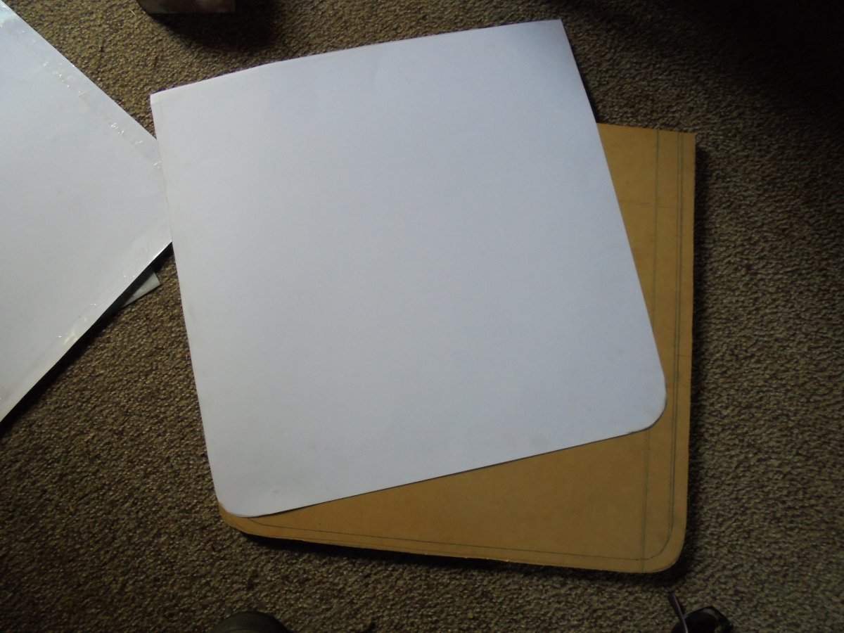

  6. chev34ute
    Posts: 1,532
    chev34ute
    Another thing I did was purchase some 20x25 sheets of white cardboard from my nearest craft shop. These are to be used as stencils from which I can trace a guide onto the sheet metal for the beads to be rolled. I used the MDF buck for reference and crossed checked the stencil against the original door as well. DSC00029.JPG

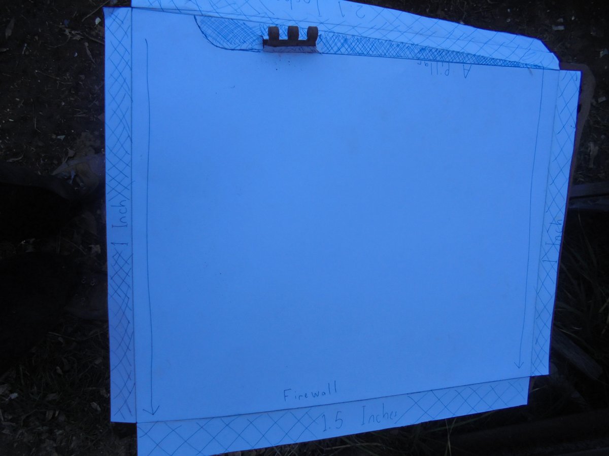

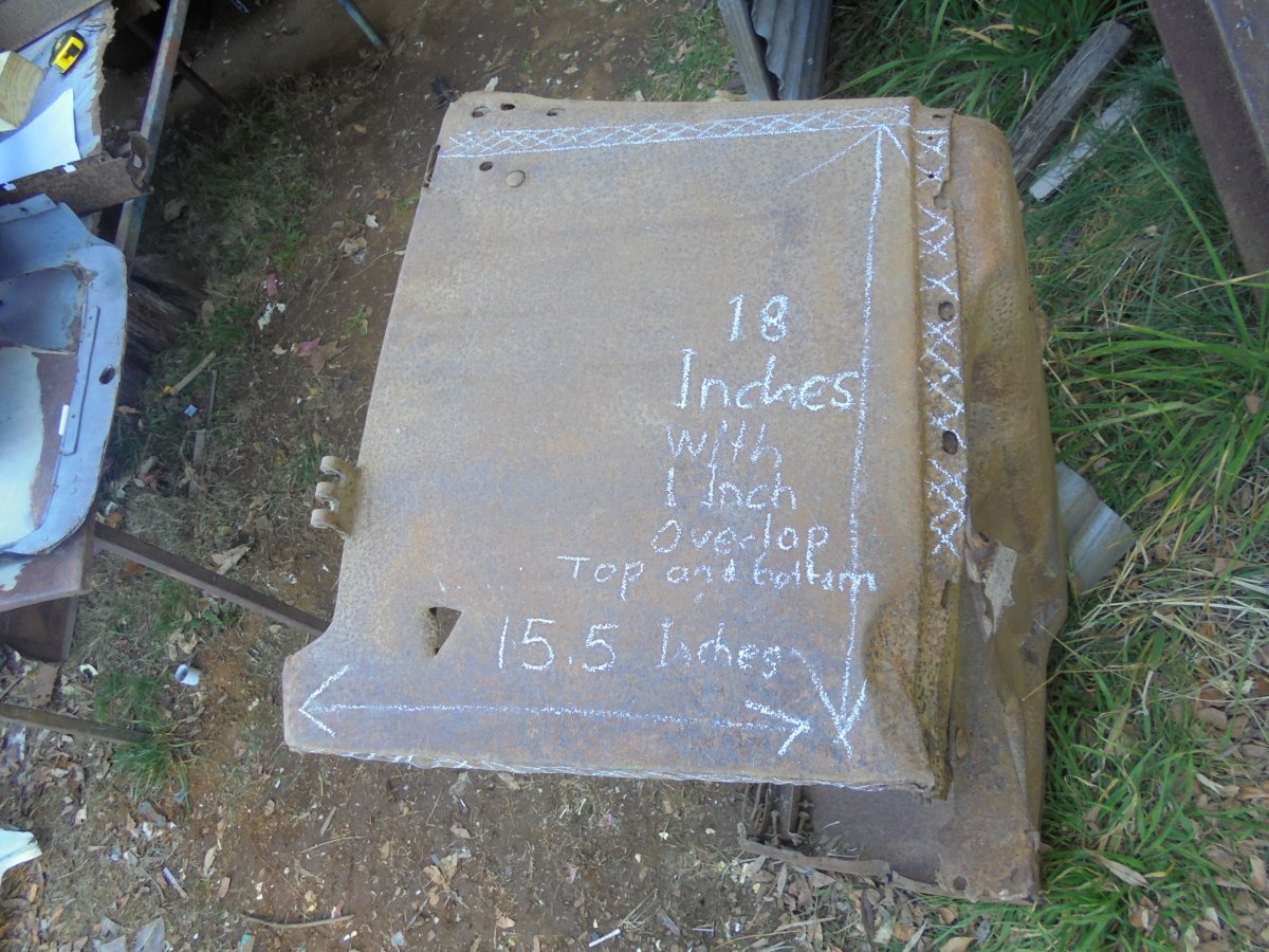

  23. chev34ute
    Posts: 1,532
    chev34ute
    The image at the top is the cardboard pattern that I made up. I would normally make a paper pattern first then a template afterwards but because the contour in the side of the cowl is so shallow, I was able to get away with using the cardboard once I had made a concession for the lower hinge placement. This pattern is also a reversible template that I will be able to trace straight onto the sheet metal to save time. I have made major changes to the original design, originally I was going to try and form the outer cowl from a single piece of sheet metal, but I soon realised that there would be a lot more forming needed on the edges. another thing that stopped me from doing so was the fact that I could not decide if I wanted a stock style cowl or one that accommodated a Duvall V style windshield. Then I figured I could have both if the cowl skin was a three piece unit. From the base to the top the side cowl panels are 18 inches not including the flanges. I got the original measurement from the Model A Roadster cowl sides at the leading edge. The overall measurements between the T and A Roadster cowls are remarkably similar which will make things a lot easer. as mentioned previously, the T cowl will have an almost indentical lower firewall to the A cowl. The main difference will be the straight join line. Most people know that the A cowl tapers up to meet the beltline. Because the T roadster doors have no belt line, I intend to make the join between the upper and lower cowl sections as flash as possible as to be more or less invisible. Like the A cowl, the T cowl will unbolt the same way. When I said I wanted to be able to swap between a stock or Duvall V type cowl, I took into consideration the petrol tank and dash layout. The petrol tank will be located at the rear and the dash will be separate from the cowl to allow easy change over.

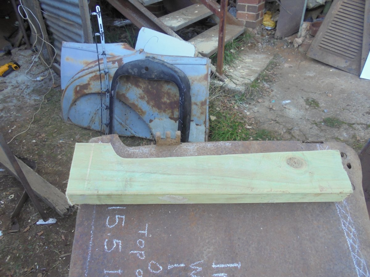

  24. chev34ute
    Posts: 1,532
    chev34ute
    There was something else I was able to finish today as well. That was the timber die that will be used to shape the A pillar. I made it up with a sawzill, belt sander and course file. Because it's shaped out of softwood, I will be sourcing a sheet of 1.5 to 2mm sheet metal to reinforce the top of it. You can see the Model A coupe quarter panels and grill shell in the back ground. The wheel wells will be measured for a guide to make up the wheel wells for the T roadster quarter panels when I get around to making them, that will be a long way off however, as the focus at the moment is to get the cowl done. Another thing I have decided to do is to fabricate a 32 style grill shell, by using the trailing edge of the A grill shell. It is considerably wider than the T version, which coupled with a longer wider hood will in theory mean that I will be able to fit a larger engine without interruptions to the external appearance. Next task will be to get a pattern of the cowl top and once that is done, start sourcing the sheet metal and cutting it to size to make it up. DSC00513.JPG
