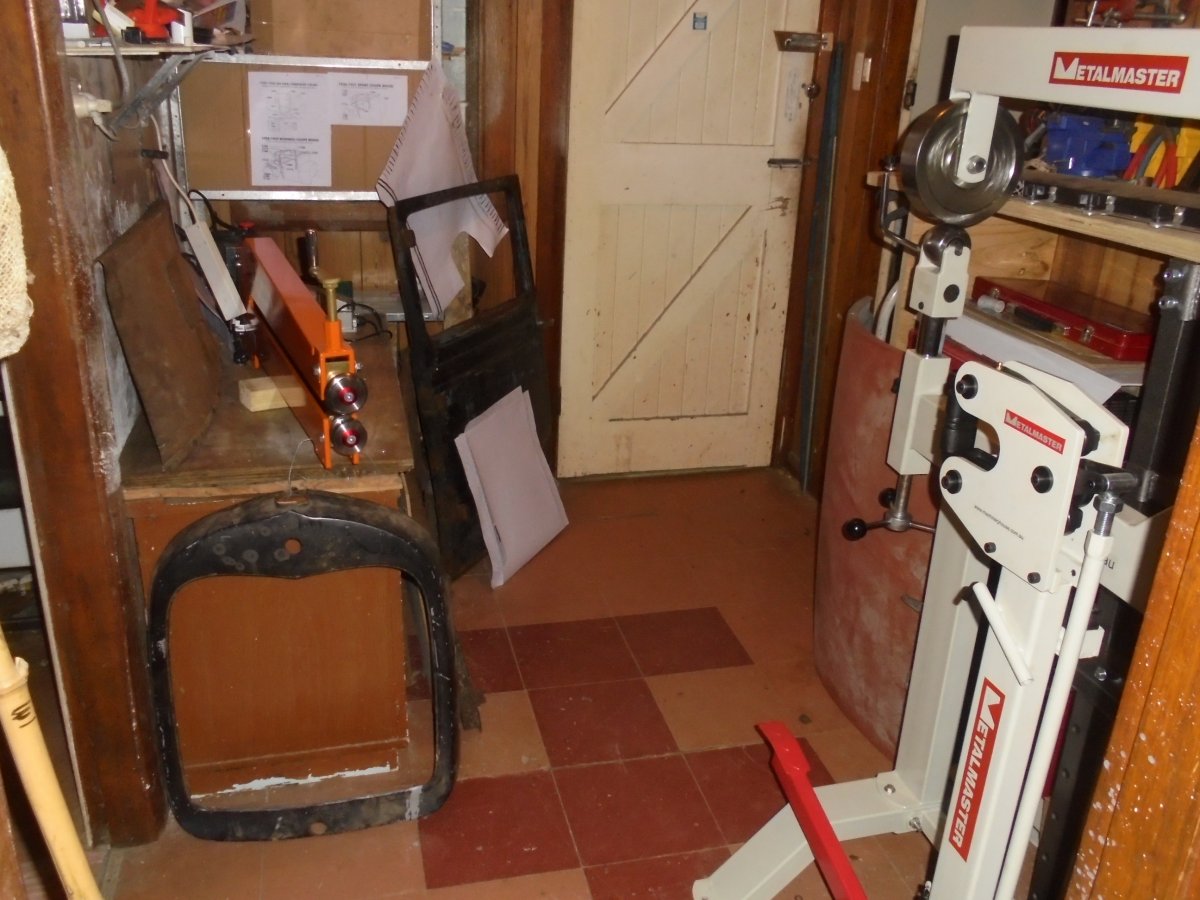

    Hey Guys.
    I finally picked up the equipment on Friday, so I can really get this project into overdrive now. I spent the whole weekend setting it all up as well as setting up a space to use it. That included building a whole new workbench. The space was going to be in a purpose built workshop under the house, but I decided against that idea due to the excessive time and effort that would have been expended setting it all up. I will eventually use that space but it will be for fitting the body to the ch***is, the extra space saved by having the workshop in the house will make that task easier. Having the workshop inside the house, allows me to work on the panels day or night without having to worry about the weather or an external power source. As well as creating the new work space, I also put together a 12 ton shop press " that will do the internal frame and louvers for the hood" English wheel, Shrinker/stretcher and electric bead roller. I also a purchased a number of extra dies and a guide for it when I went down to pick up the tools on Friday. As for my old Eastwood bead roller, I am pretty sure a 1mm sleeve insert will allow me to use all those dies in the new bead roller, which is a good thing considering how much I spent on them. DSC00542.JPG

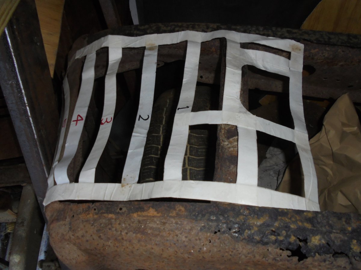

    chev34ute

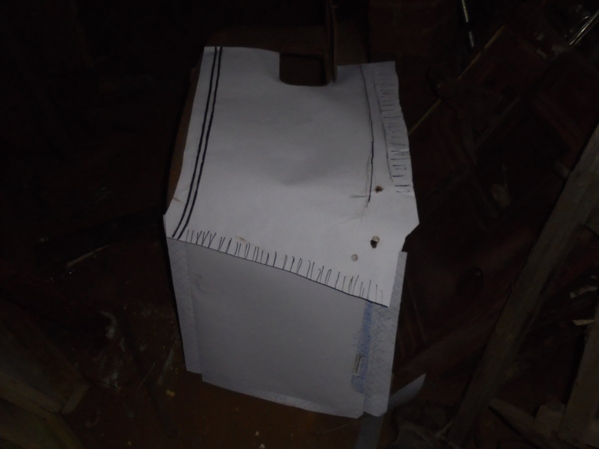

    Here is the pattern for the cowl top as it stands. Its a reversible design to allow a perfectly asymmetrical shape, measured from the halfway point along the cowl vent opening. The idea is that it will also act as a stencil that can be flipped over to the other side when tracing out the shape onto the sheet metal for cutting There will also a be a steel die to shape the cowl vent opening, that will comprise of four sheets of 1mm sheet metal attached to a timber base, similar to the bucks that will be used to shape the A Pillars
    The cowl buck will be a two part design with one millimetre step at the top of the lower section and the bottom edge of the upper section to allow the two sections to join together like a Model a version. The folded sections in the join will be much squarer than those of the Model A, so therefore much less visible, that will be helped by the fact that the windscreen posts will bridge the two joins as well and they will also be part of the structure that bolts the two parts together. DSC00533.JPG DSC00534.JPG

    Posts: 1,525

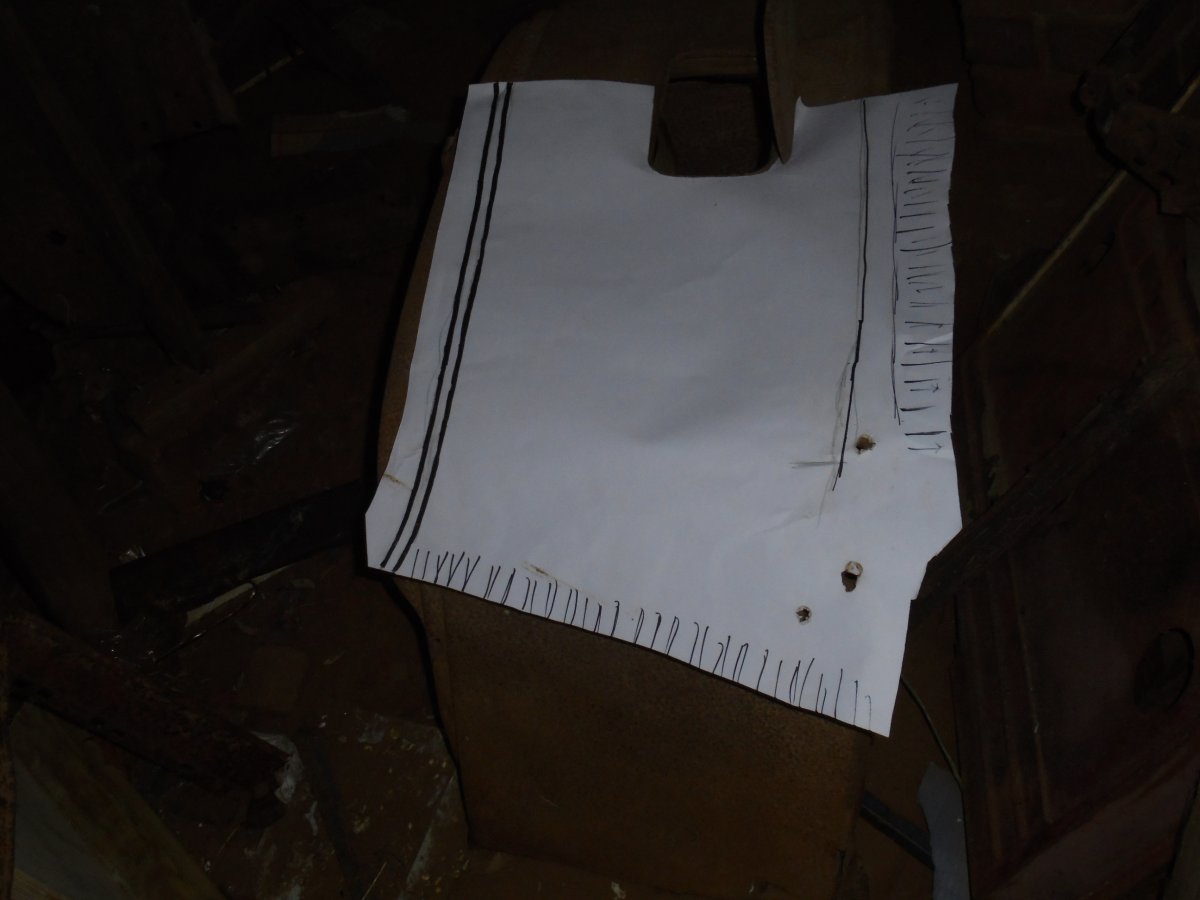

    I was careful to capture all the information in this section including the areas that will need to be stretched along the lower edges once the flange has been created, those are the vertical lines marked in with a black texta. I have been using this section for a reference for the cowl vent area as well as the swage that sits behind it that sits above the dashboard. DSC00535.JPG

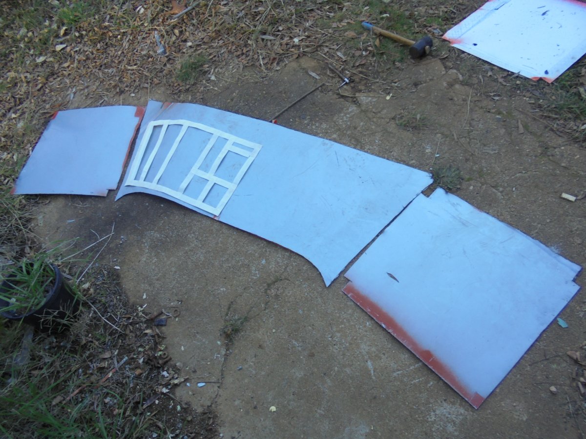

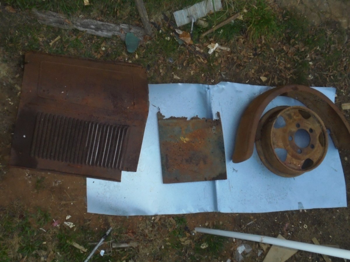

    DSC00546.JPG Hey Guys.
    Work on Roadster is finally underway again after some much needed downtime between jobs allowed me to finally visit my local s**** guy to collect my sheet metal. After cutting out the section, I spied what looked like a BB Ford truck wheel. I have a soft spot for AA and BB Ford trucks and I already have a pair of these rims at home so I figured a third one would not hurt. When I went over I spied something else as well, one half of a hood from a twenties tourer along with a rear door and rear fender. I was able to fit it all in the car and bring it home.
    kidcampbell71 and brEad like this.
  9. chev34ute
    Joined: Nov 13, 2011
    Posts: 1,525
    chev34ute
    All in all it was a good find. The hood half can be used as a template. I also checked the rear fender against my Model A quarter panel out of curiosity. It turns out the radius is almost indenticle to the Model A wheel well. As I have posted previously the wheel wells on the T will have the same radius as the Model A so this fender can certainly be used as a master to duplicate should I decide to fabricate the rear fenders.

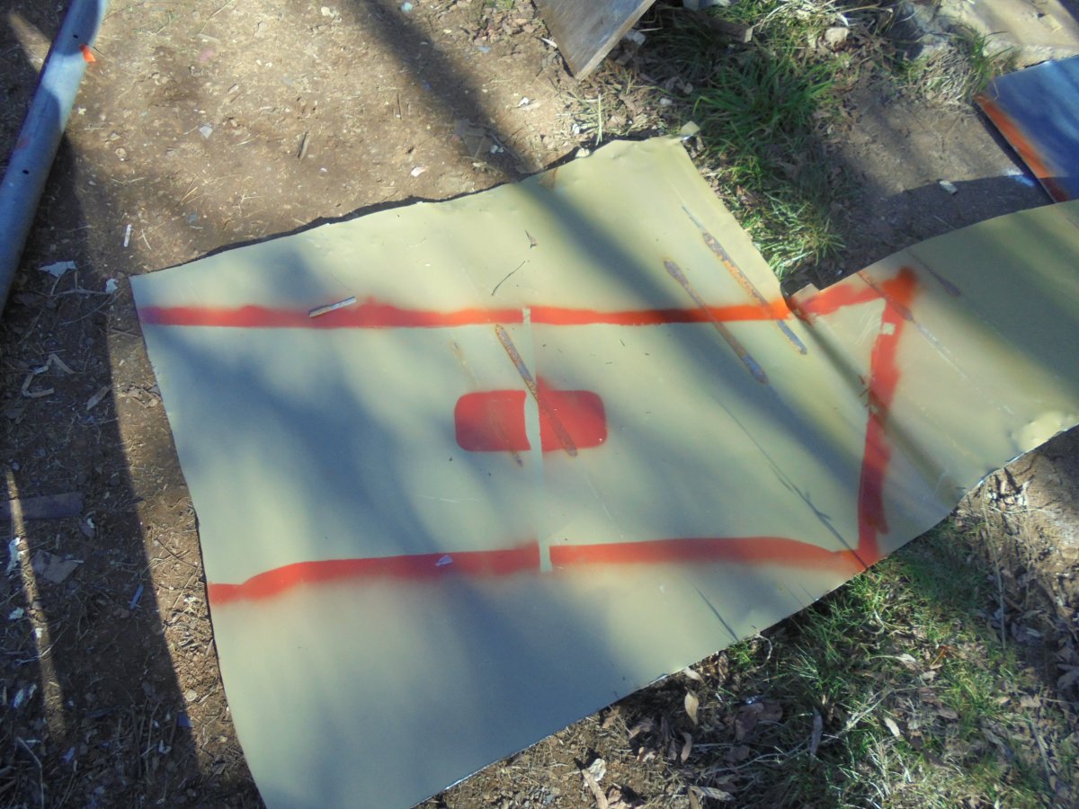

    DSC00555.JPG With the sheet metal layed out, I used the cardboard patterns as a stencil for the outines that were sprayed around them. It was a good feeling to finally be able to cut the sides out. After they were done I did the same thing for the cowl top. To get an asymmetrical reverse side, I taped the pattern directly to the centre of the piece of sheet metal to allow it to flip over to the other side.

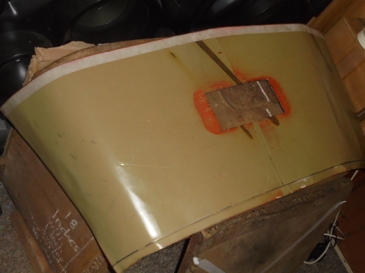

    DSC00575.JPG Hey Guys.
    I found some time this afternoon to do some more shaping on the cowl top. The first thing I did was run the fold through the bead roller using the tipping dies. Once I turned the edge, I stretched the fold to give the bottom edge of the cowl a reverse curve. While the reverse curve is not as pronounced as one found on a 28/29 Model A cowl, its nevertheless still difficult enough that I could not continue the reverse curve further up the side. I ran the piece through the English wheel numerous times top and bottom only to fail each time. In frustration I took to the side with a hammer more out of anger than anything else. I then realized that wheeling alone will not reproduce the complex cowl shape needed, but hammering will.

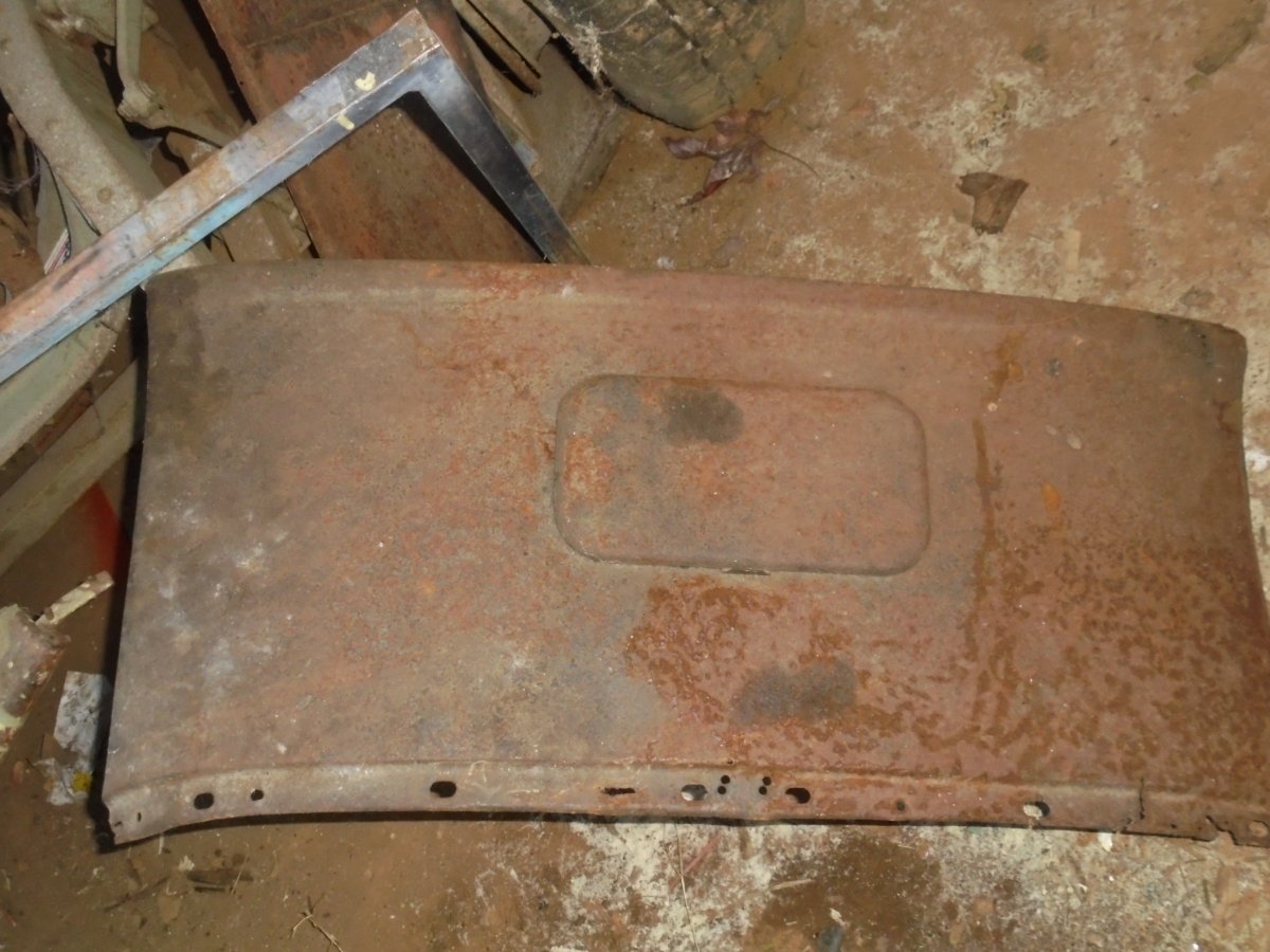

    The image above is of the template sitting over the original cowl. When I found this cowl, it was sitting upside down so all the upper area had rotted away. By placing the template over this cowl, I have a much more accurate idea of how to shape the buck. The buck itself is shown below. I will most likely add extra walling to the front and the back before I begin adding the stations to make it more rigid. Once I have done that I will begin shaping the stations. To do this I will place the template over the second cowl and use a contour gauge to trace an outline along the numbered strips that run between the firewall and the beltline that sits above the dash rail. I can then transfer that outline directly onto ply that I can then cut and slot into the buck.
