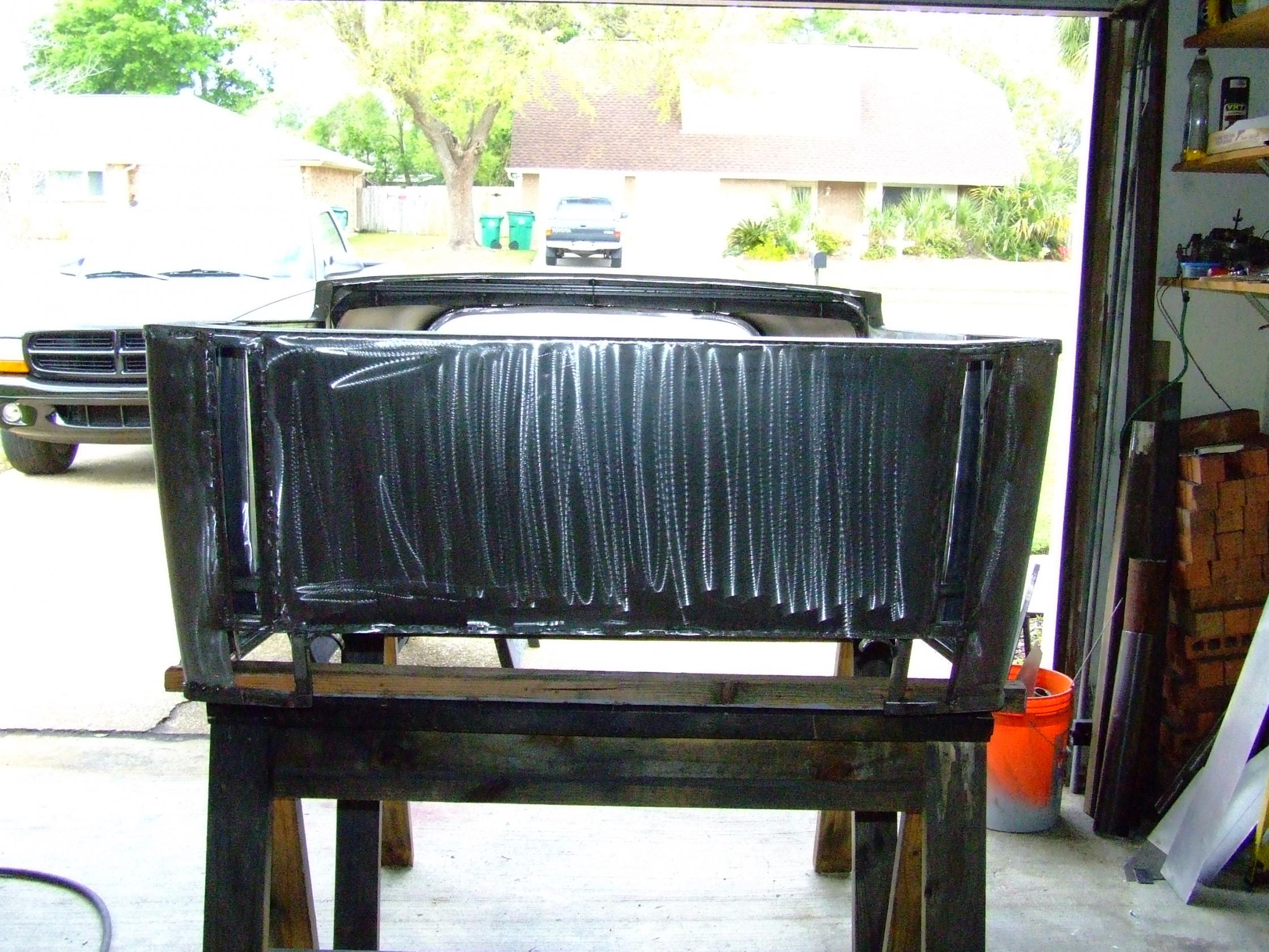

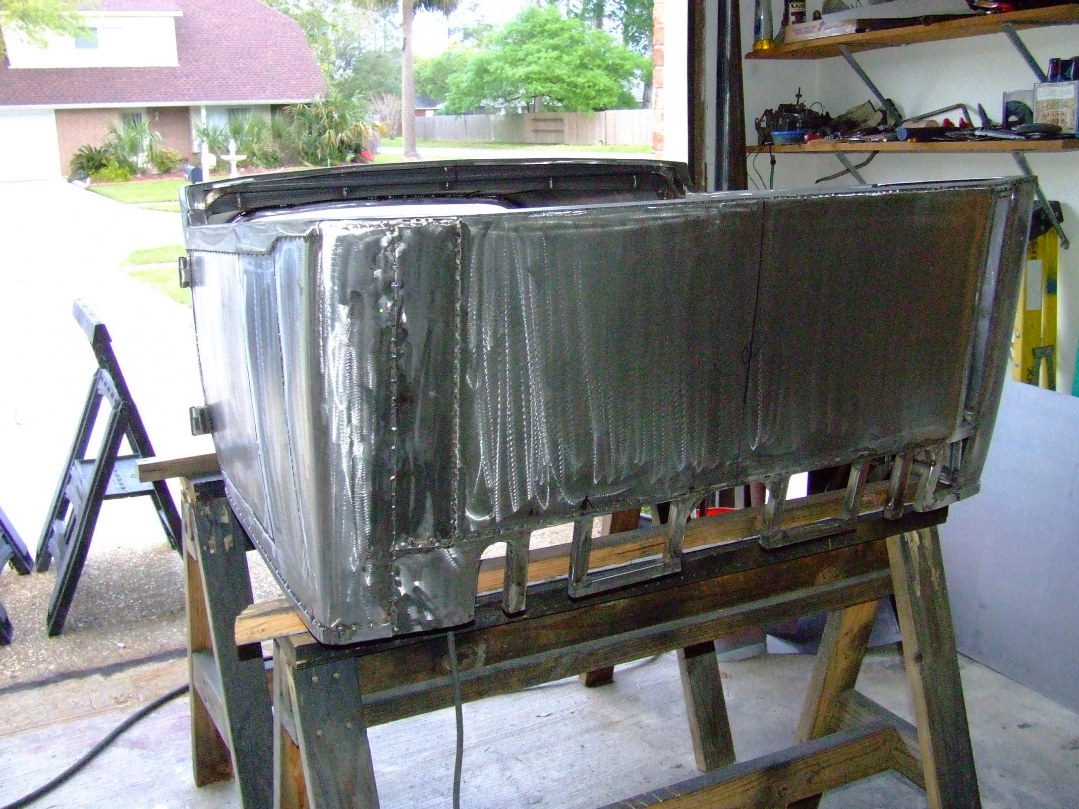

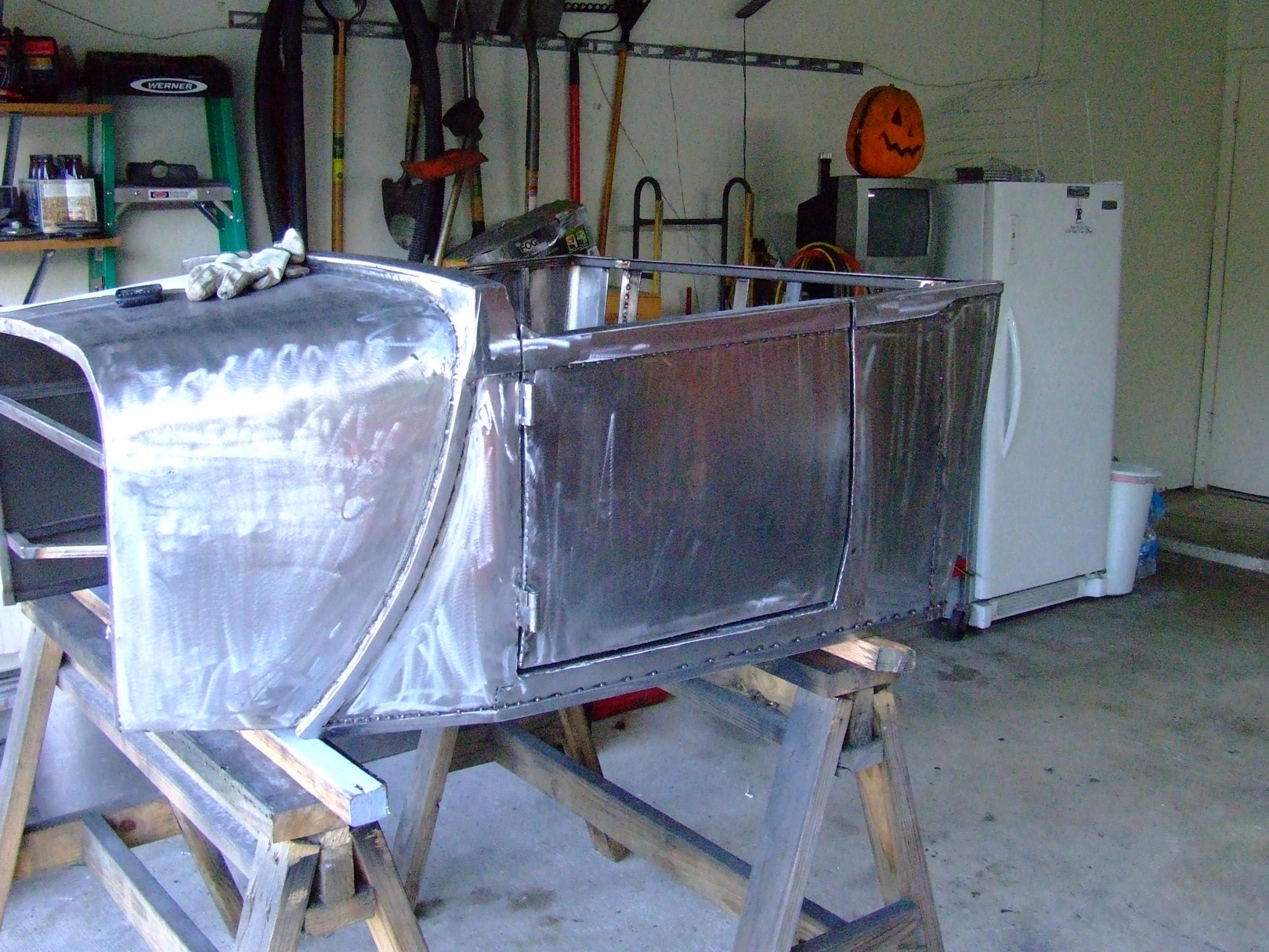

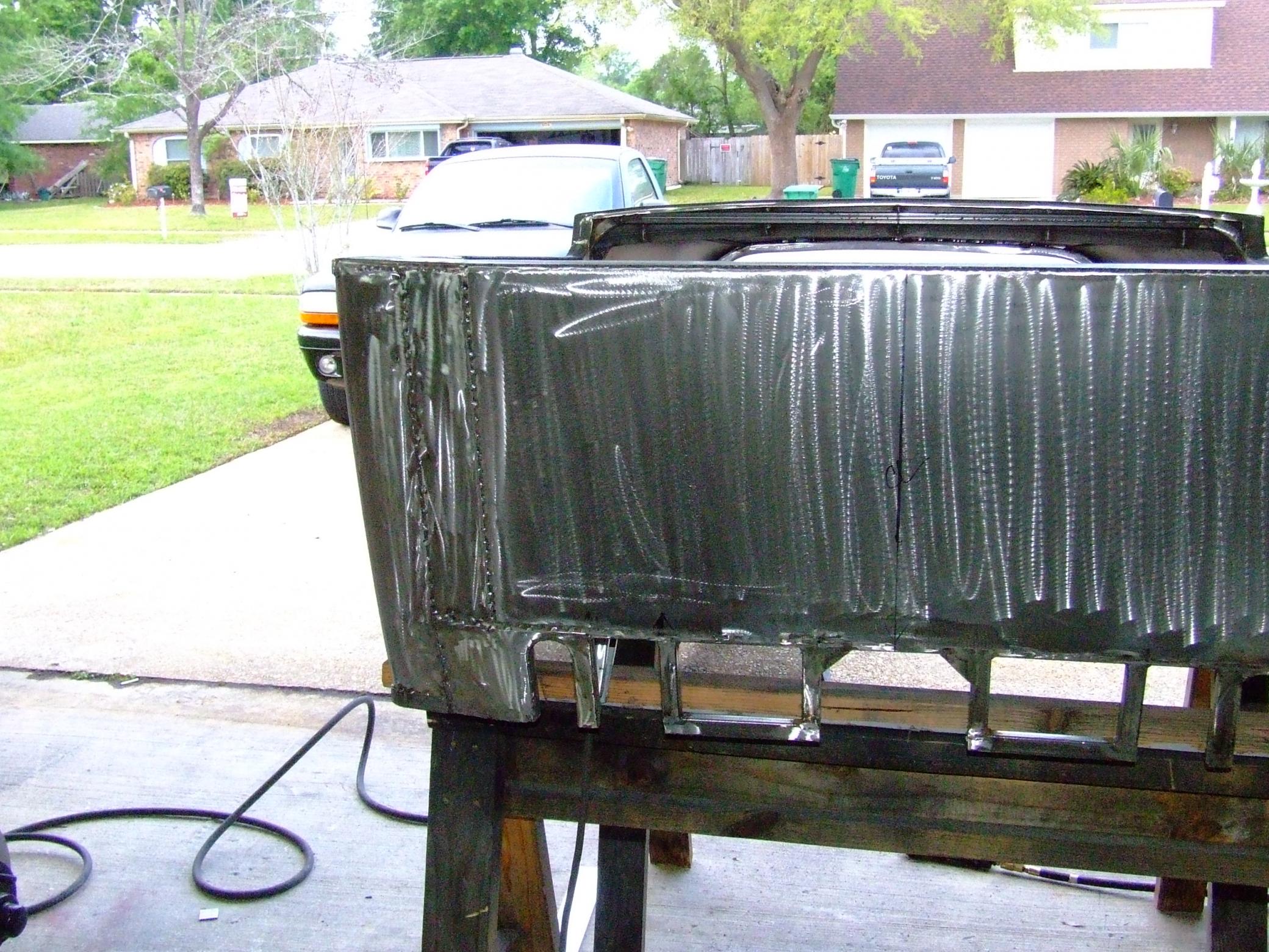

    Ok. I used a 1800 degree heat gun! I made templets for every panel I would need to skin the substructure. I then used the templets by laying them on the flat 20 gauge sheeting. I then traced the templets and cut them out. Then I layed the flat sheet square to the substructure and tack weld at the top edge center of the cowl. I then start applying even heat with the heat gun and applied even pressure across the area I wanted to roll with the body until it meets the next part of the substructure tacking it into place as I move to the finished edge. The heat gun rearranges the molecular structure of the sheeting just enough to make it soft enough to bend without kinking. I truly learned this by trial and error building my own fenders for my custom harleys. That's my secret!

    Holy crap! You might be"computer stupid" but your a sheet metal genius! Hope to be half that good one day.

    That is just crazy and insane! I love the use of a heatgun haha. I would have never thought of using that to do metal work.

    Wicked job man! Those upper and lower moulding pieces really add a finished dimension.
    Are you gonna lead the spotwelded seams or will you completely weld them..or???

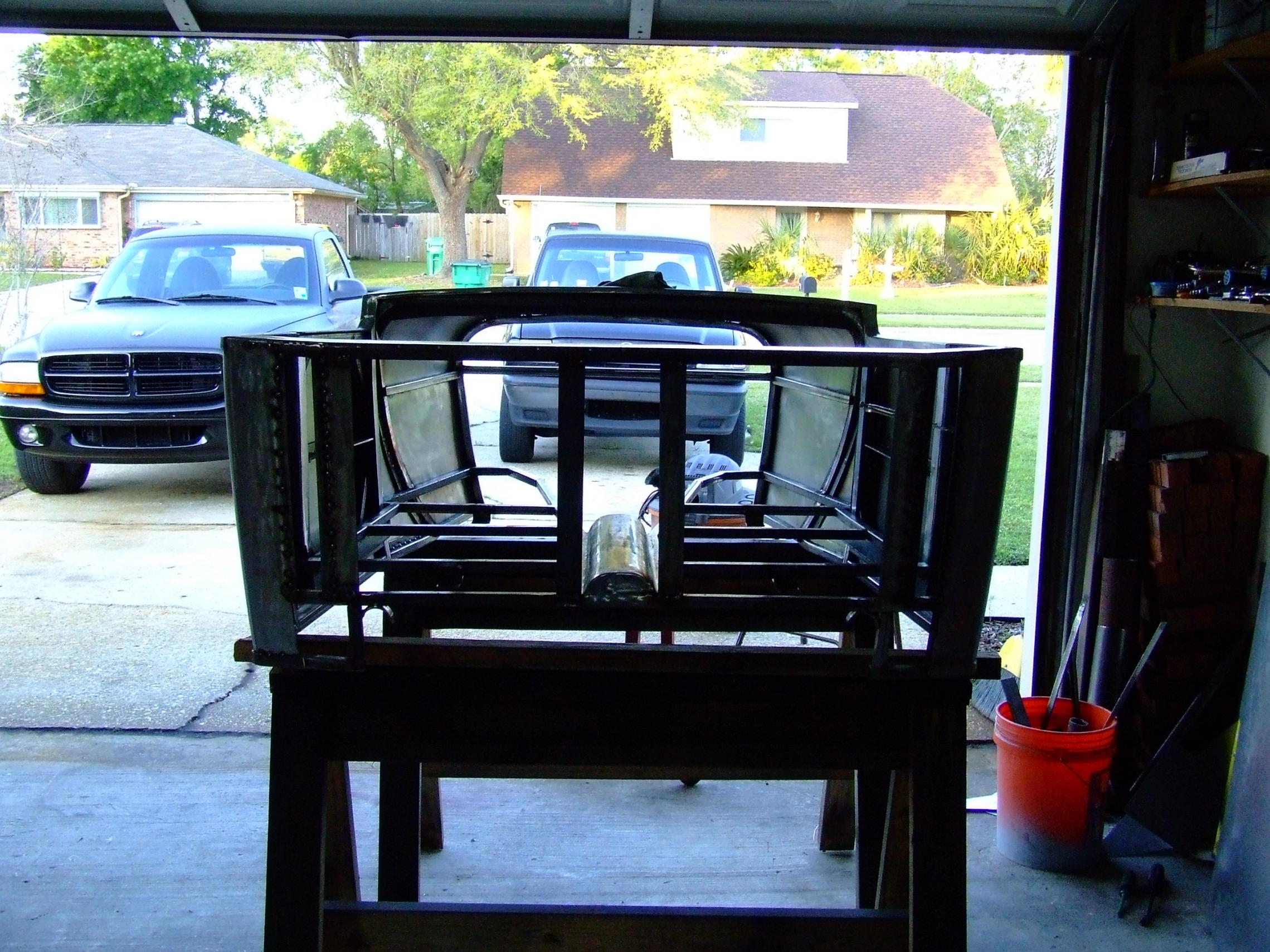

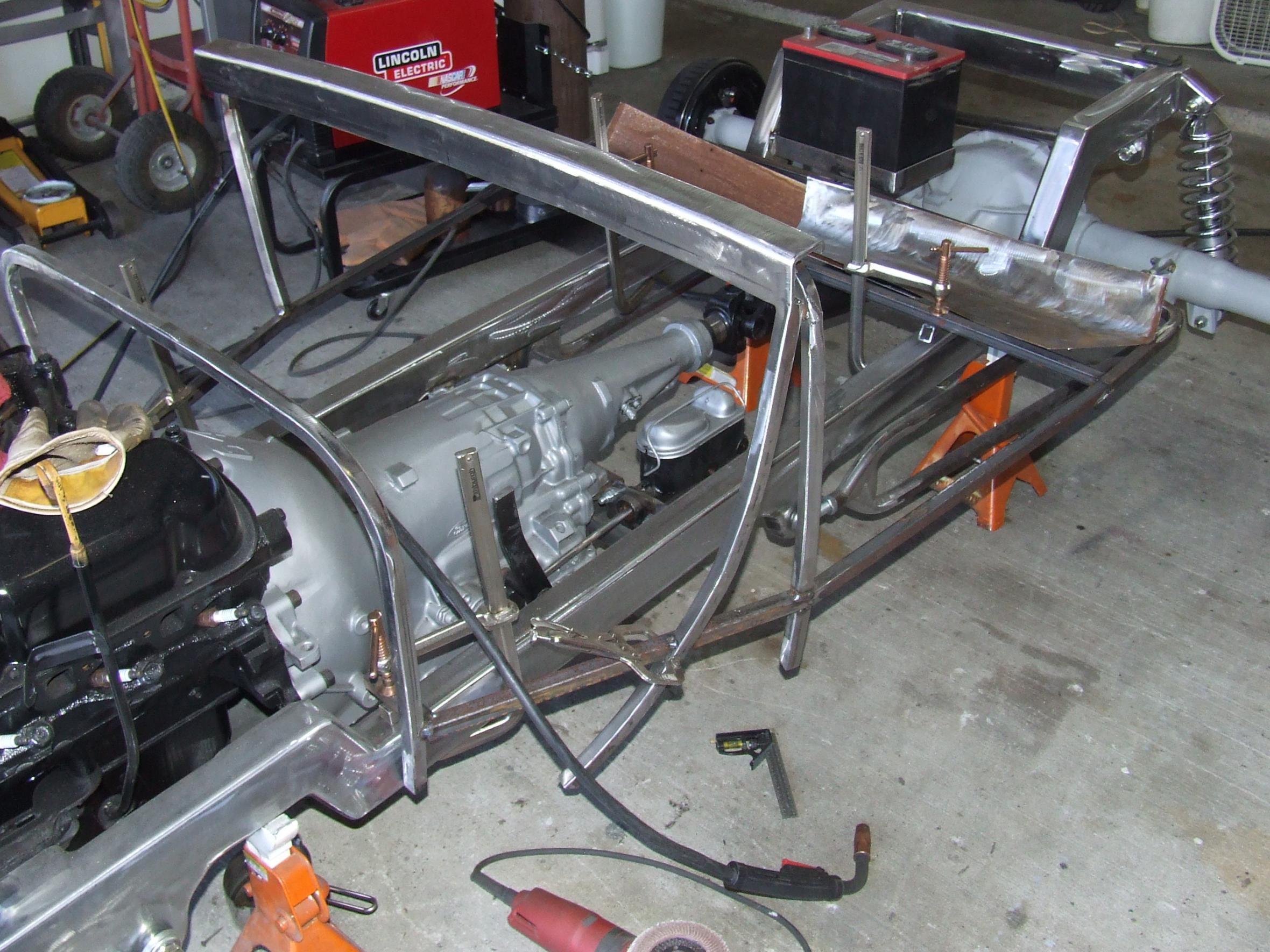

    Hey everybody, didn't get to do much today welded in a brace for the fire wall to set the height for the trans tunnel and finished the structure (supports) for the rear panel. My father and mother and a slew of neighbors all stopped by at once! It was cool to see my parents not complaining! Everytime I open my garage door neighbors come by in droves to see what else I got done. That's cool but sometimes I can't get anything done. Well here's the latest pic's.

    As you can see by the previous pic's I removed the body from the frame to finish out the rear panel and the firewall. Couldn't get to them with the body mounted. Still need to put a few angle braces from the underside of the sidewalls below the floor surprisingly the sides didn't move as well as the door gaps so all is good. Will spend a couple of hours tomorrow attaching the rear panel and maybe do a little with the upper firewall. Later guys!

    I will tack weld around the cowl section approximately 1" apart. And yes I will lead all seams and file of coarse i will have to use some body filler can't avoid it! Thanks for asking.

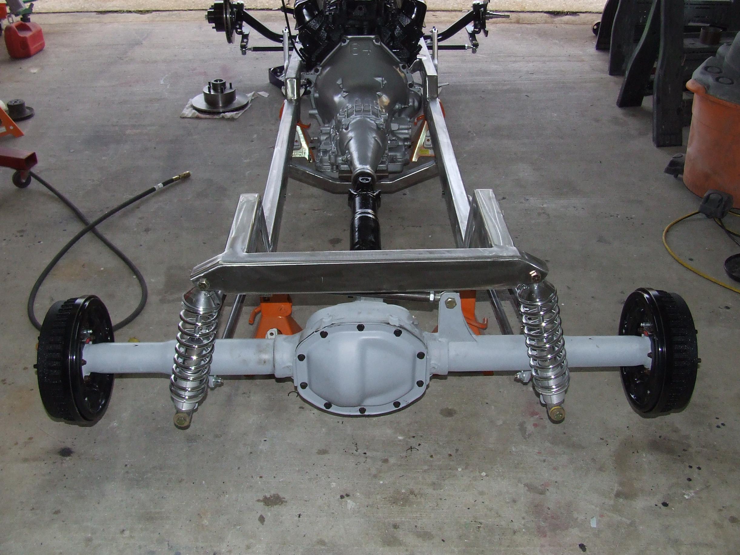

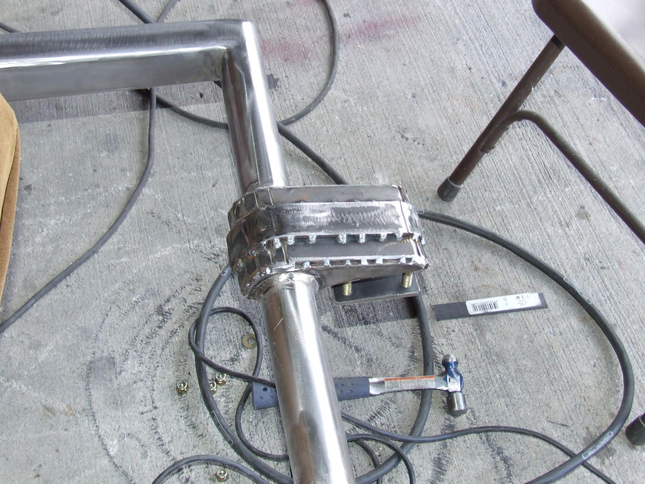

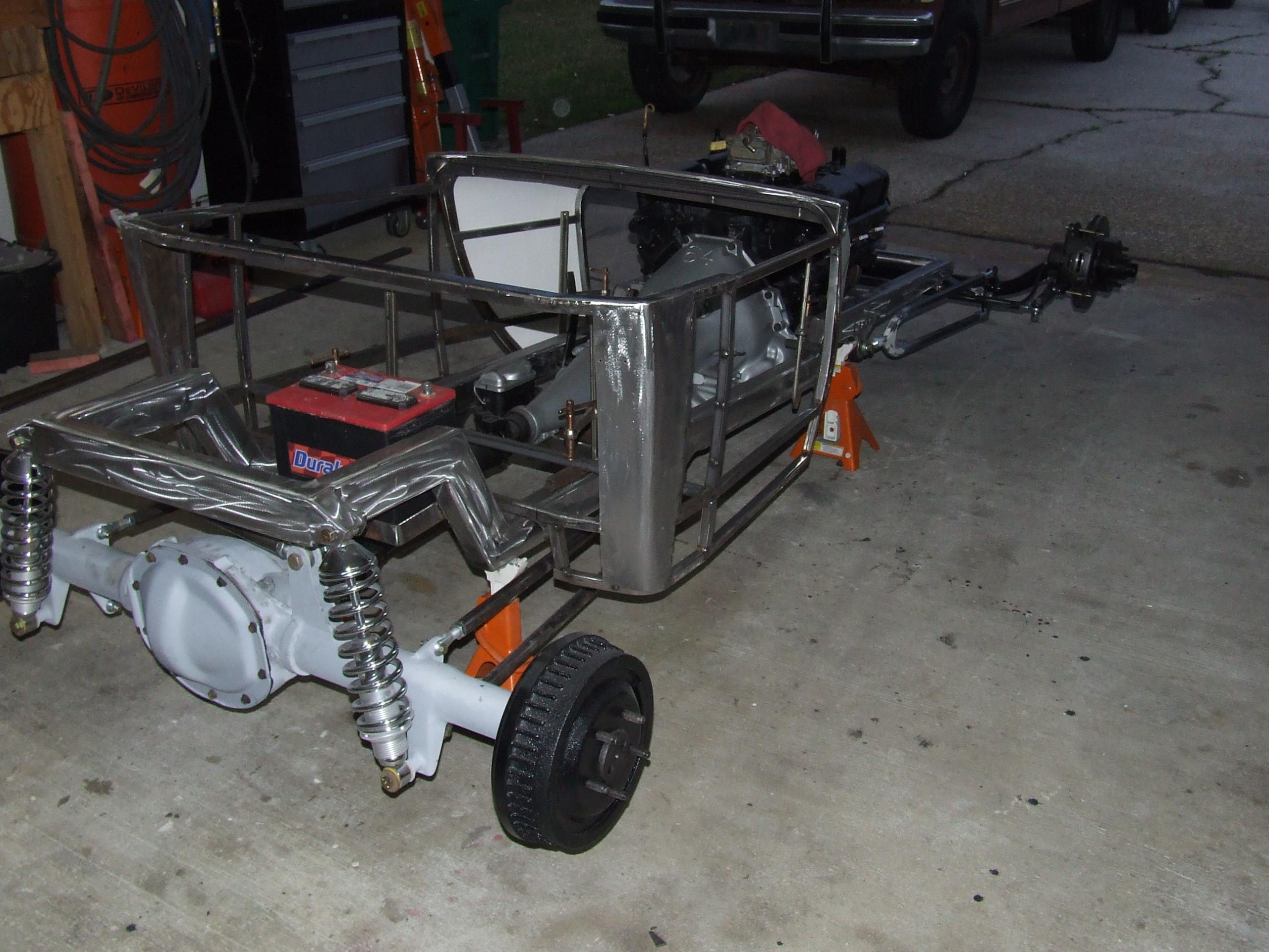

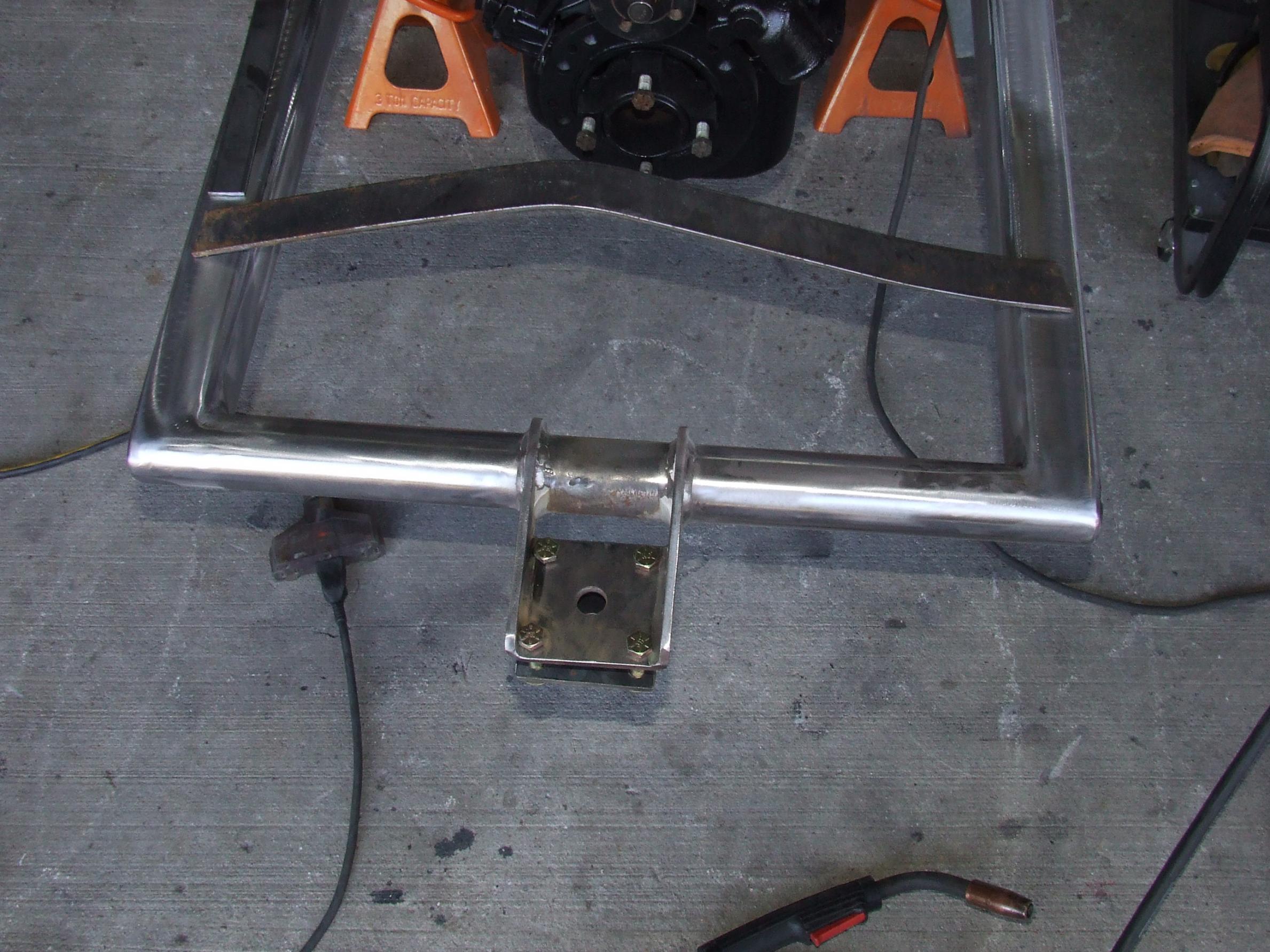

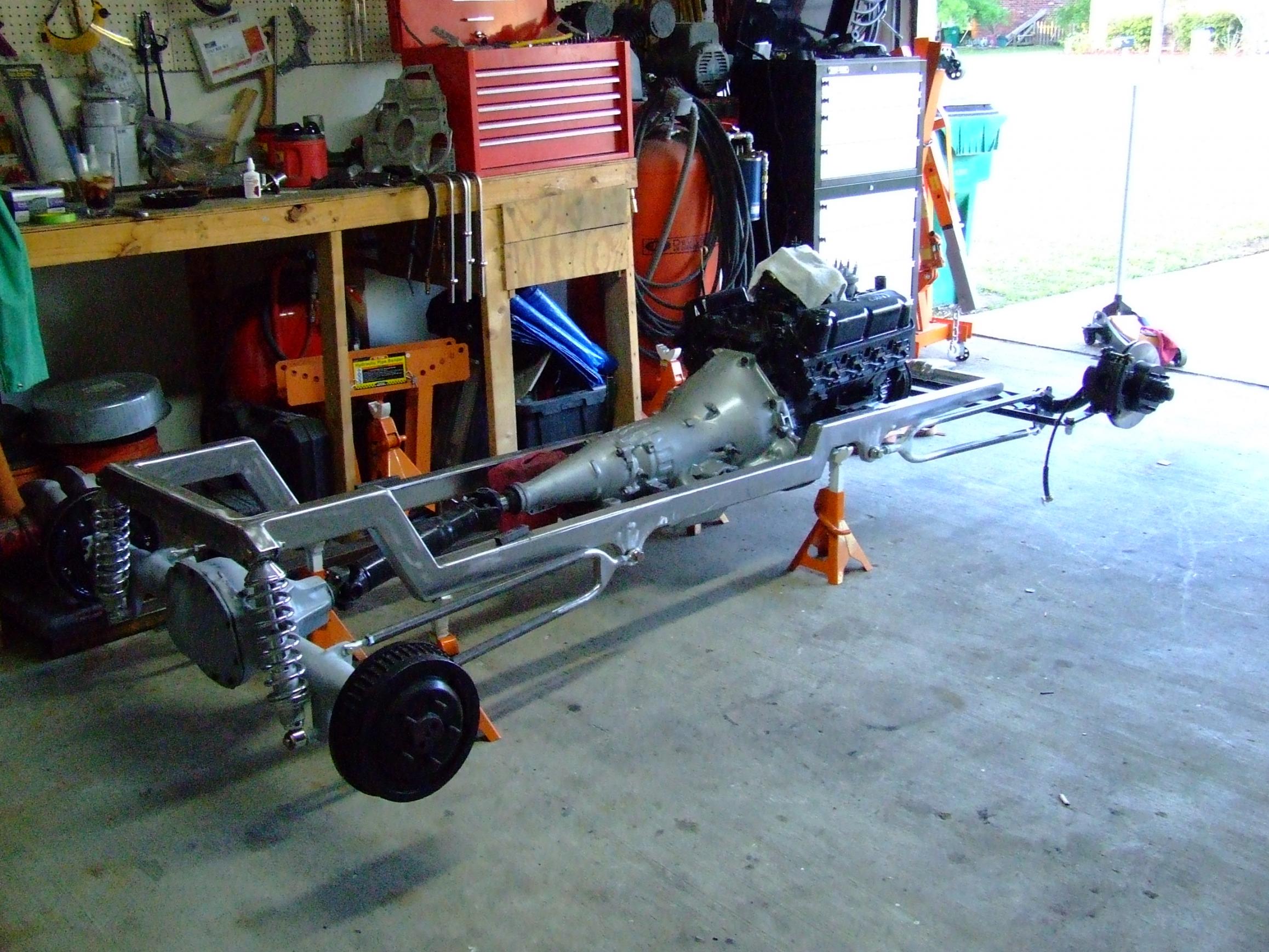

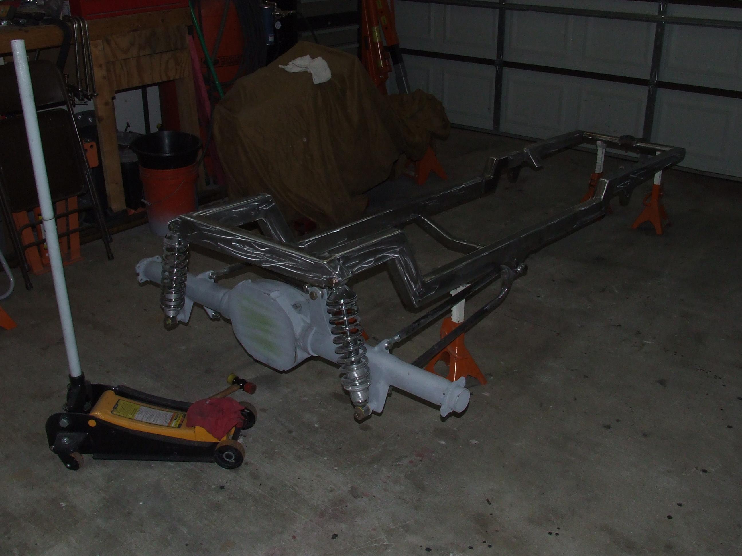

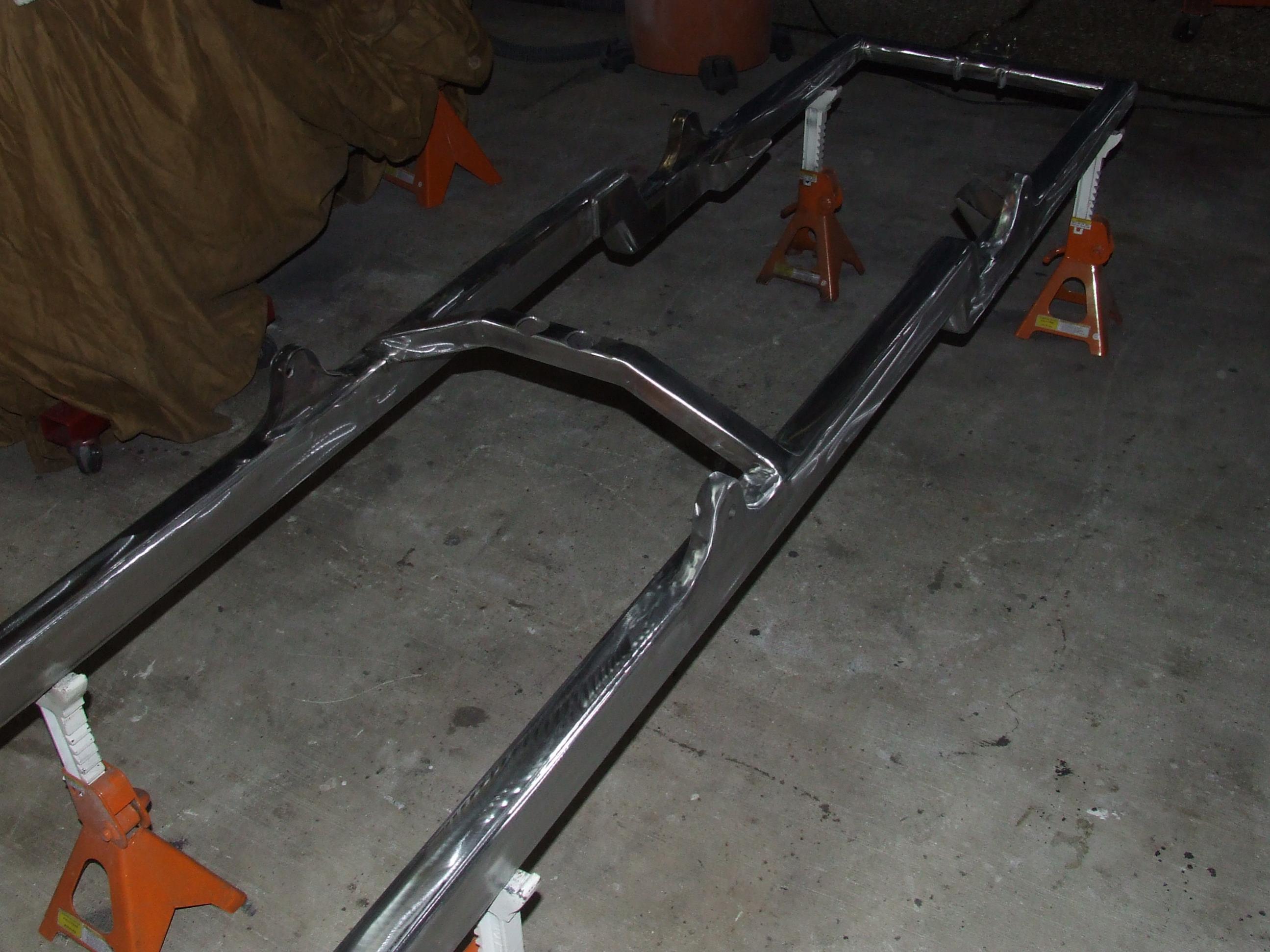

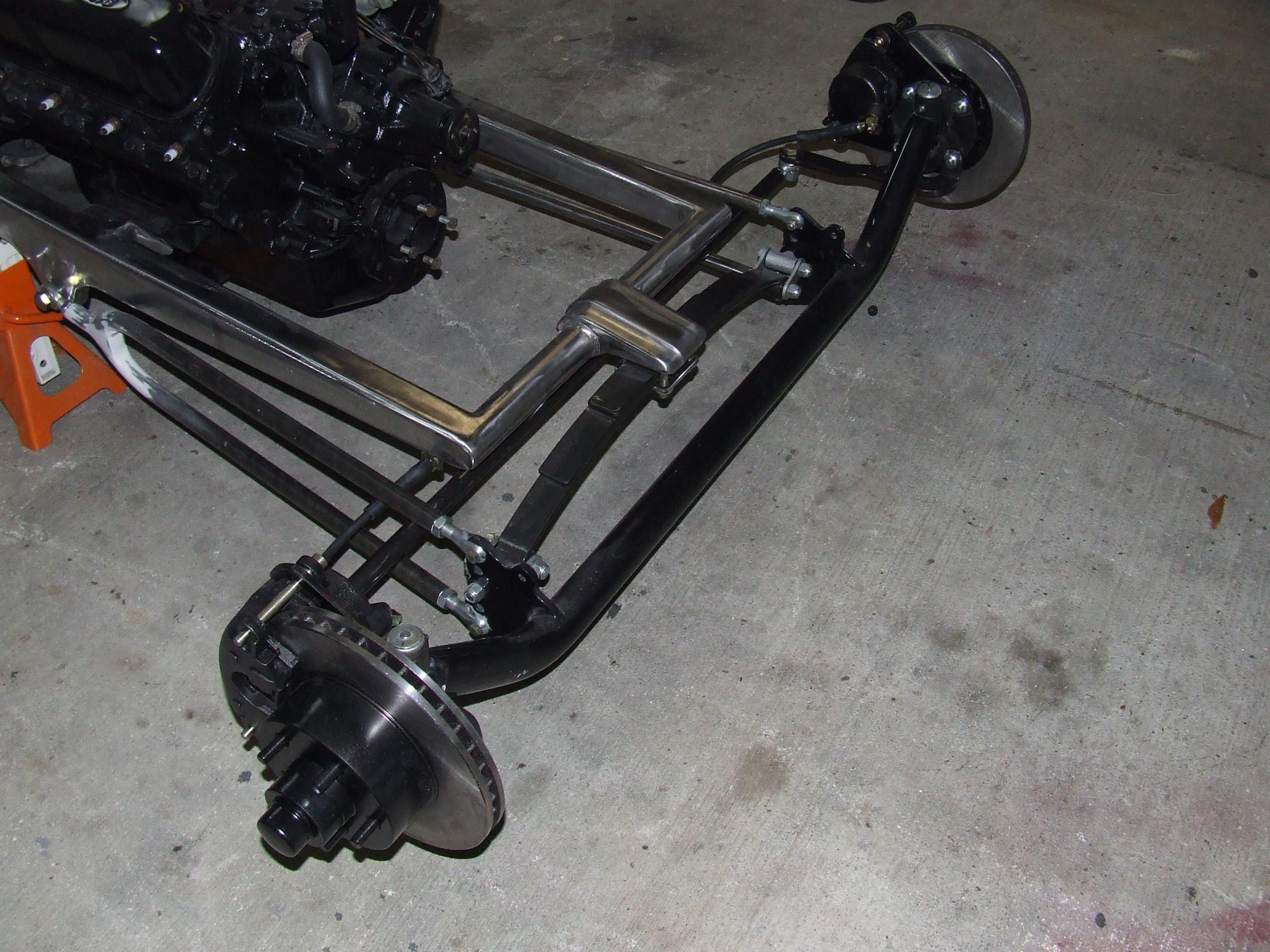

    More pic's of the frame and drivetrain, I have never liked the way most front spring perches looked so i decided to cover mine with sort of an art deco look don,t know why was just in a mood, I like it that's all that counts. LOL!!!!

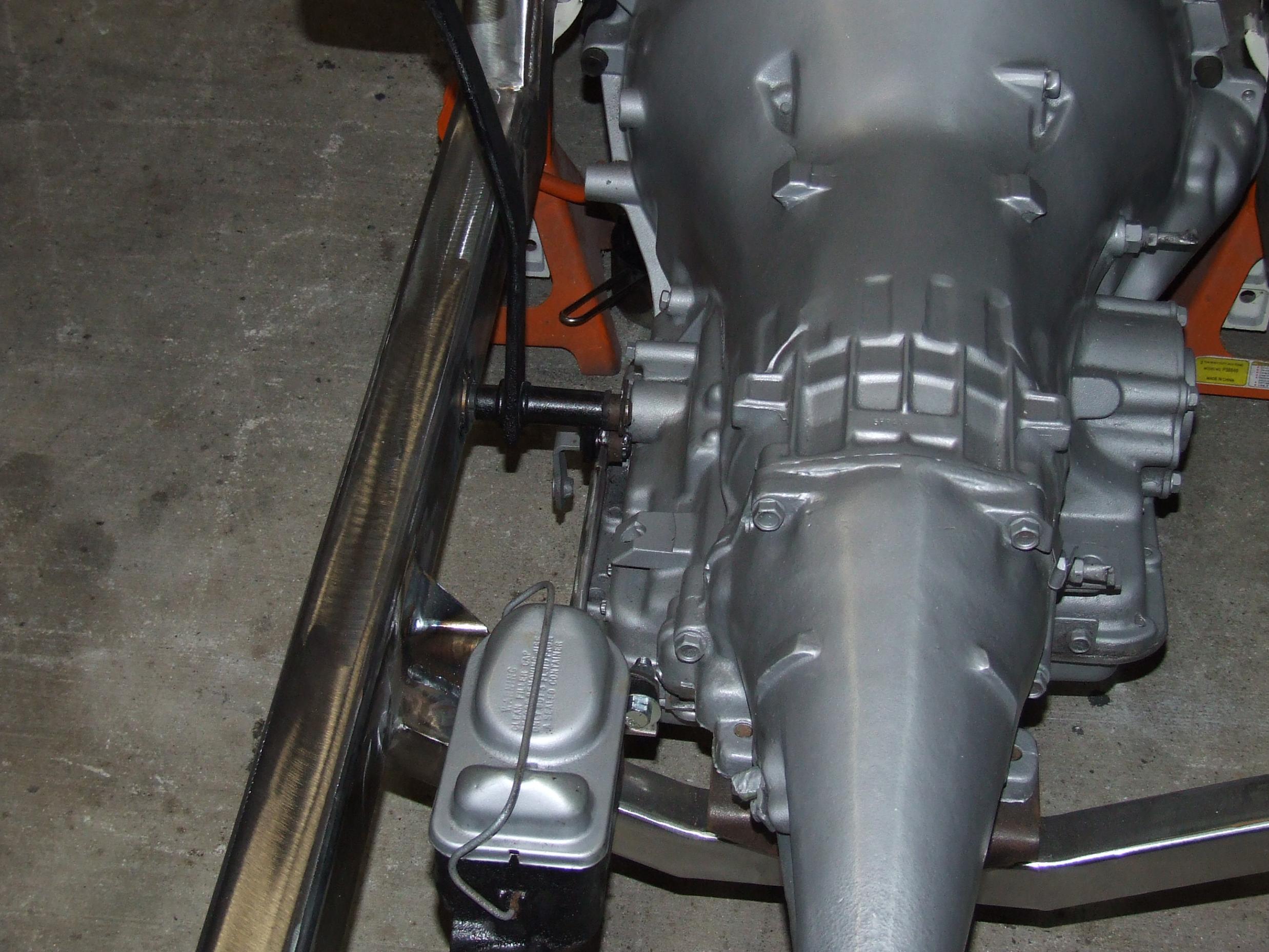

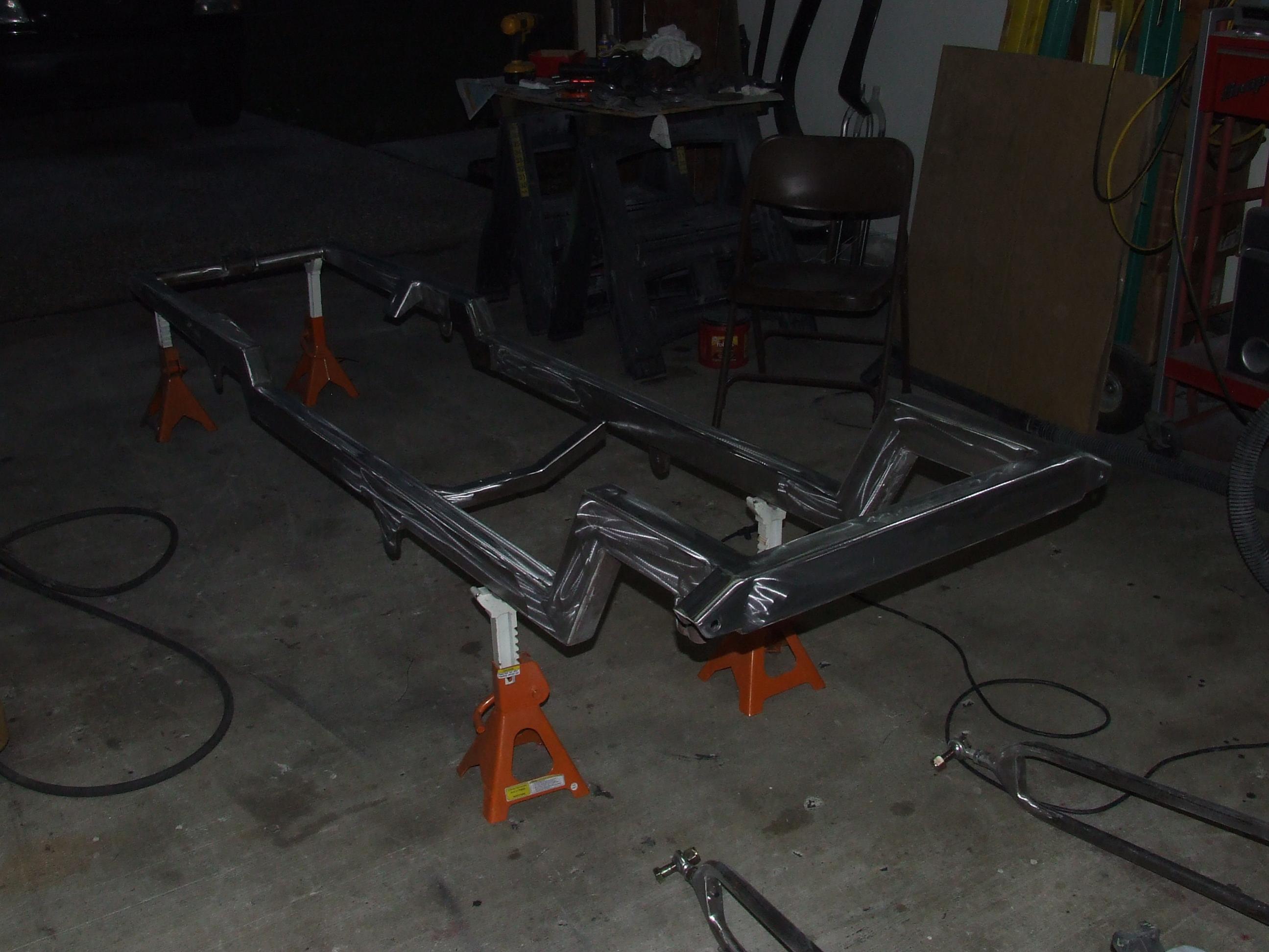

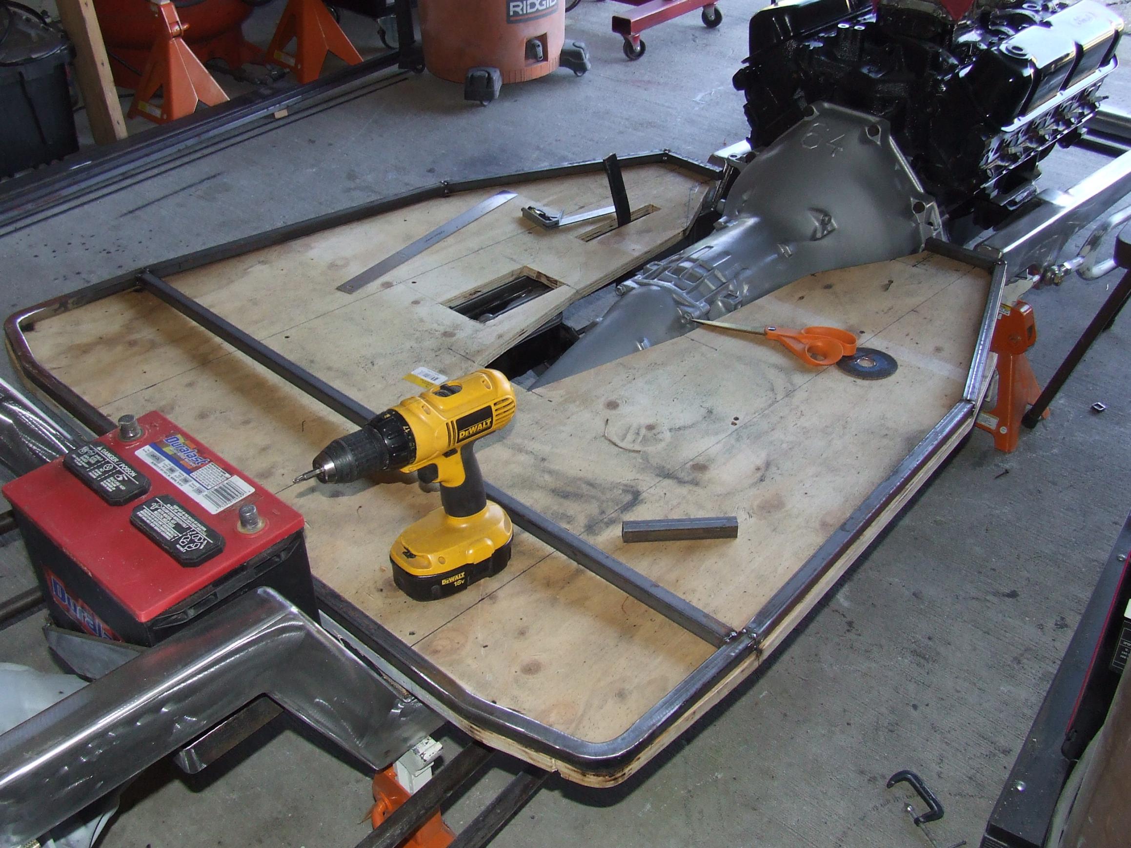

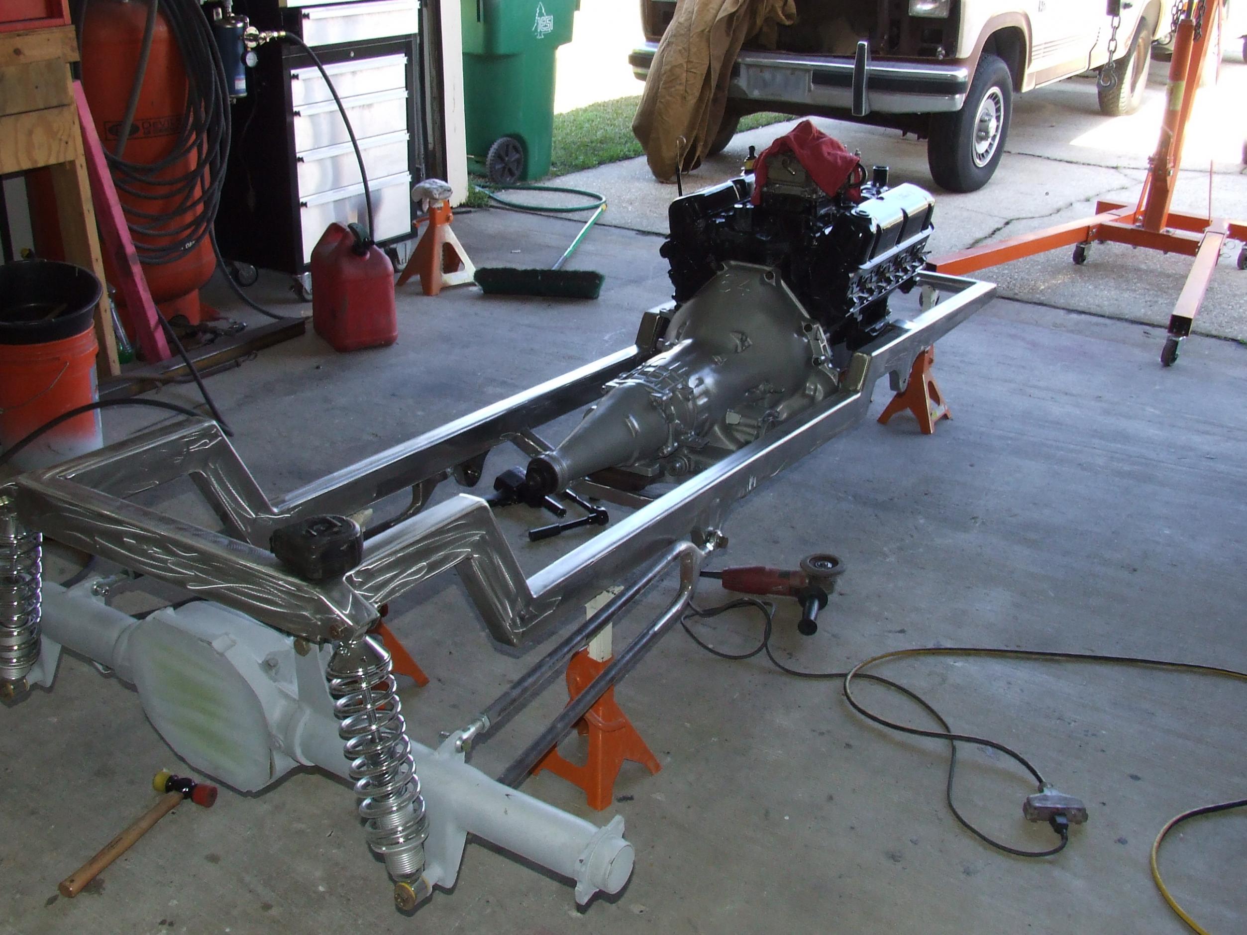

    Ok! Here's a couple more pic's of the frame and drivetrain and the very beginning stages of building the body!

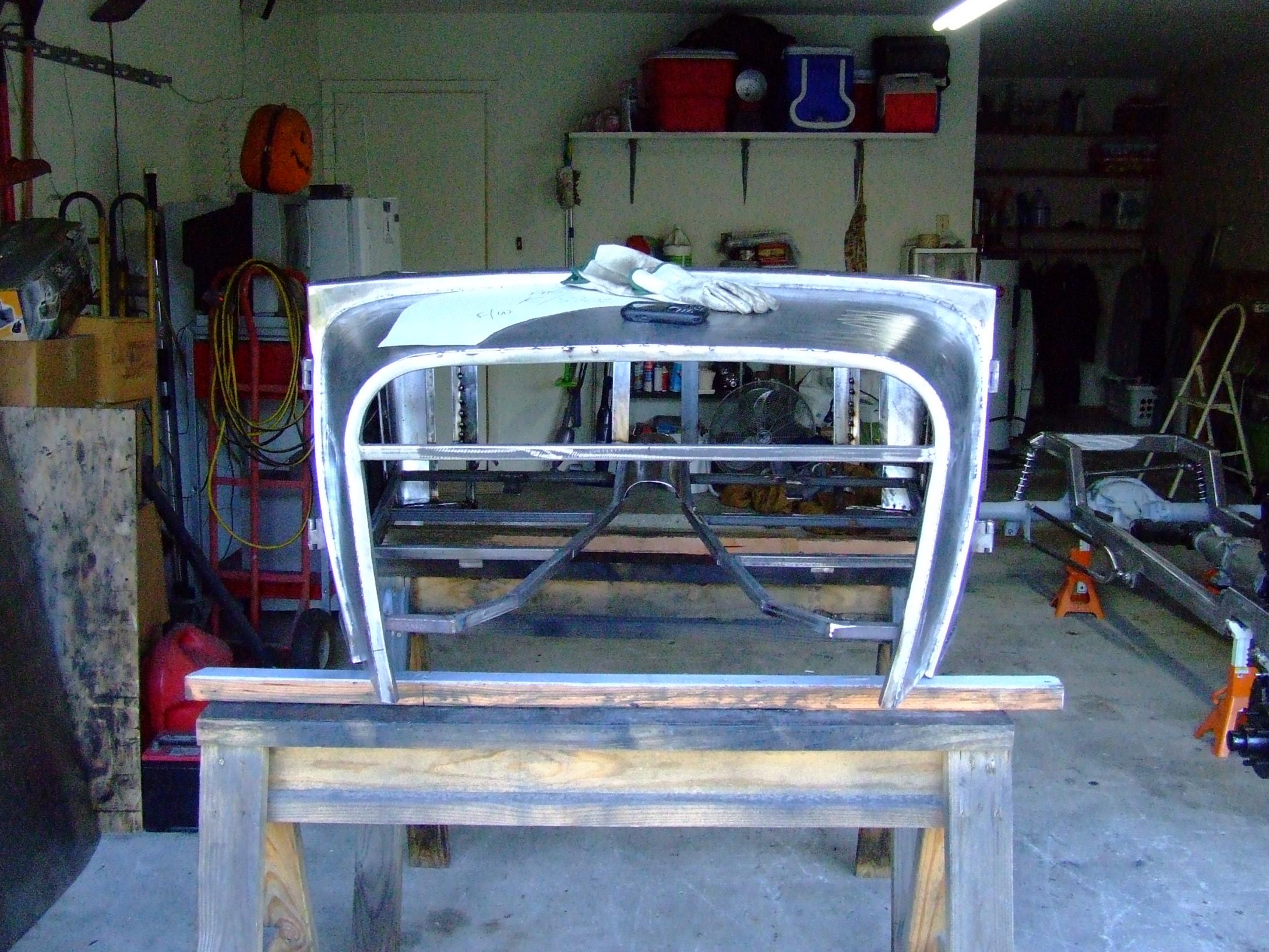

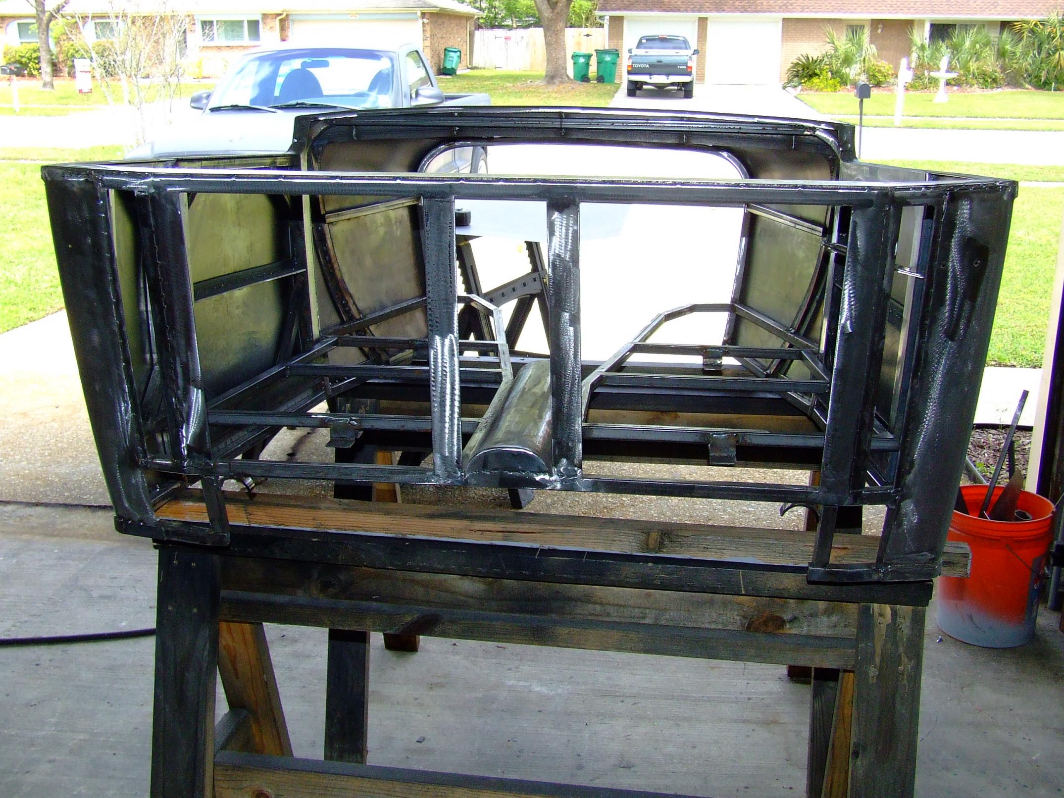

    More pic's of body structure in the beginning stages this took a little while firewall opening had to be right so the rest of the body would look right!

    Floor structure and cowl section taking shape!

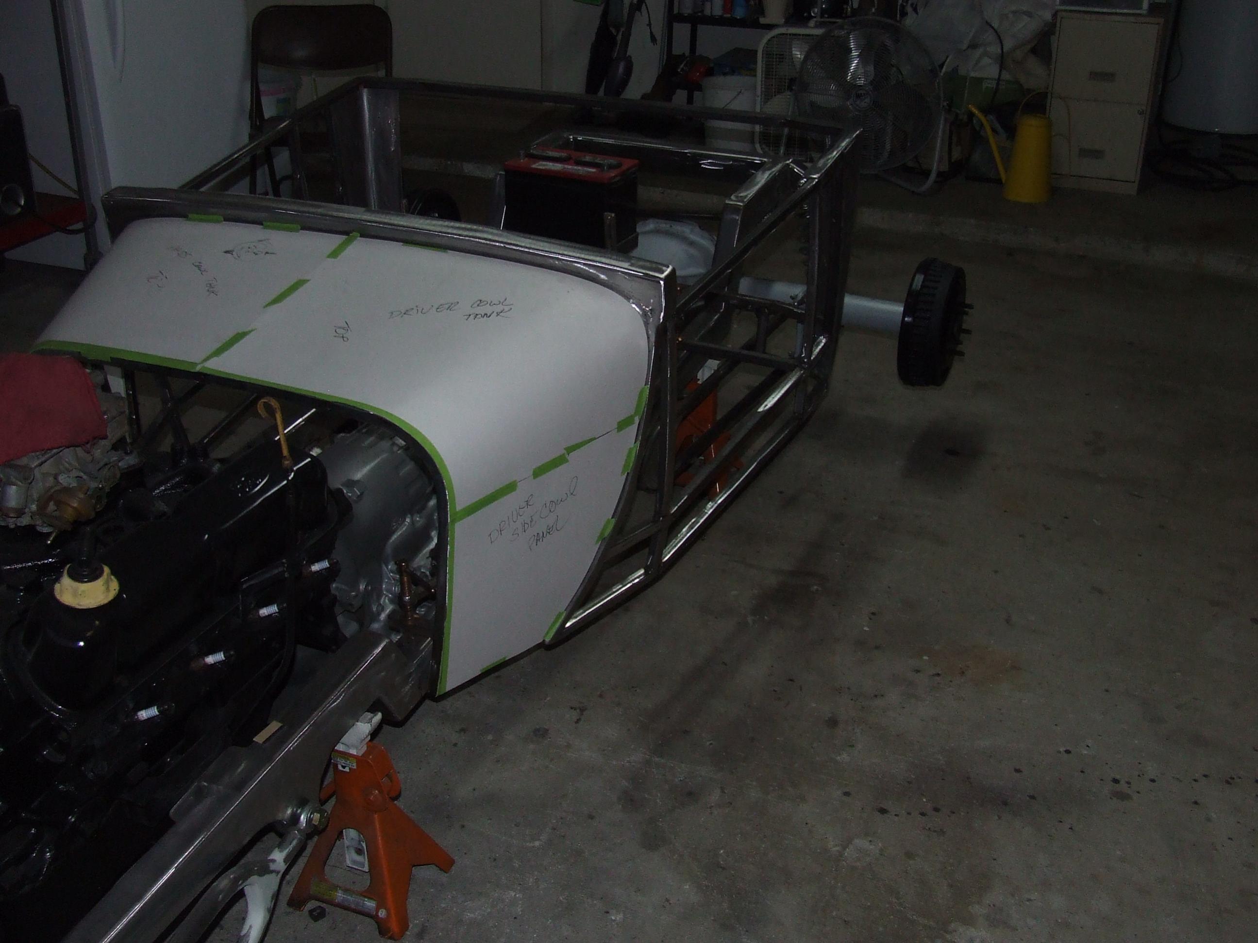

    At this point I am happy with the profile of the cowl section and floor structure and will build the side structure. The white on the body is poster board (templets), Ok that should catch everyone up, So this is how I got to the stage I'm at! Wow that took awhile!

    By the way, the last pic's are of the my poster board templets which as I previously explained were used on the flat! Saved these in case I decide to build more.

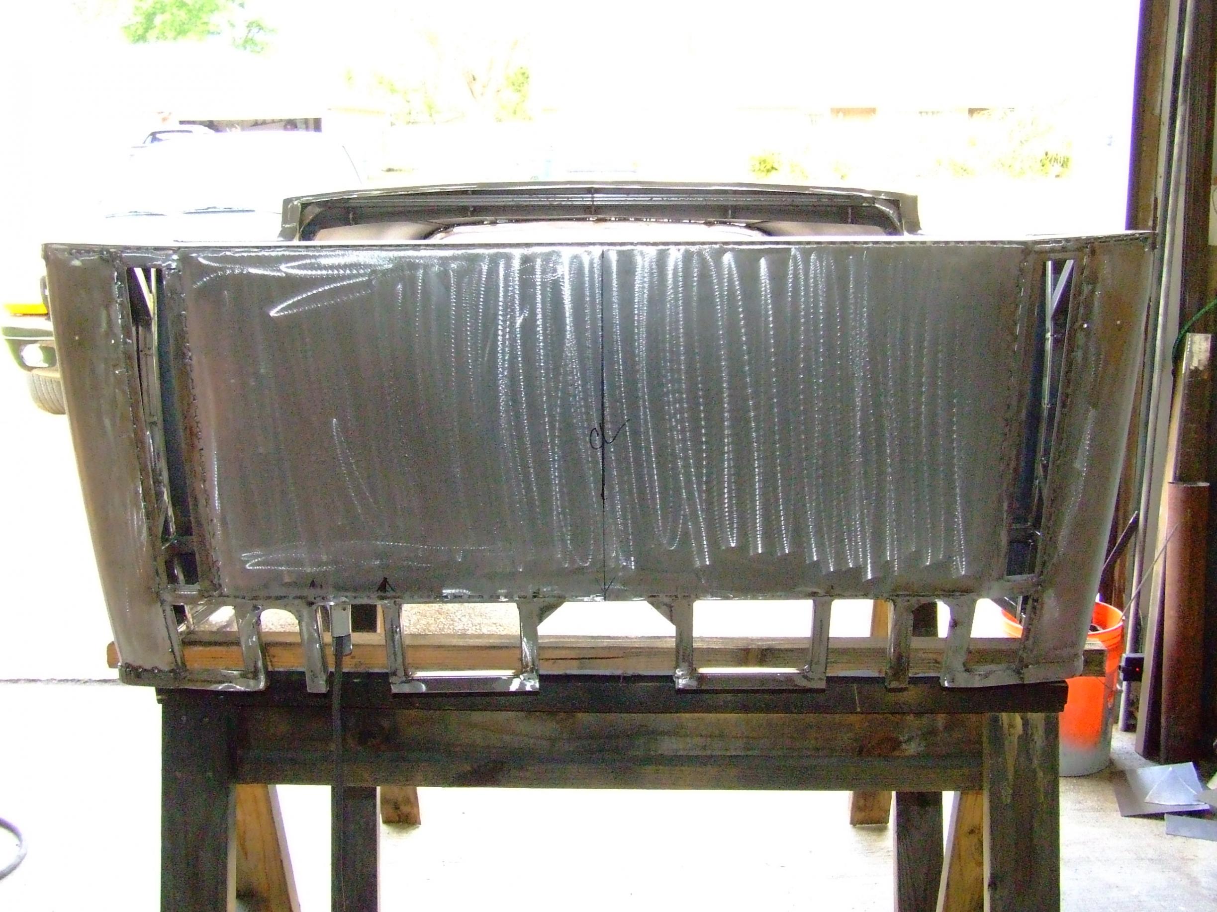

    Didn't get as much done as I wanted, Had a job interview. I did get the structure for the rear panel attachments and got the largest panel in the rear done as well as the driver side rear panel in. It took some time to fab the bottom attachment points because i had to clear the hairpins and drive shaft. So here are the pic's.
