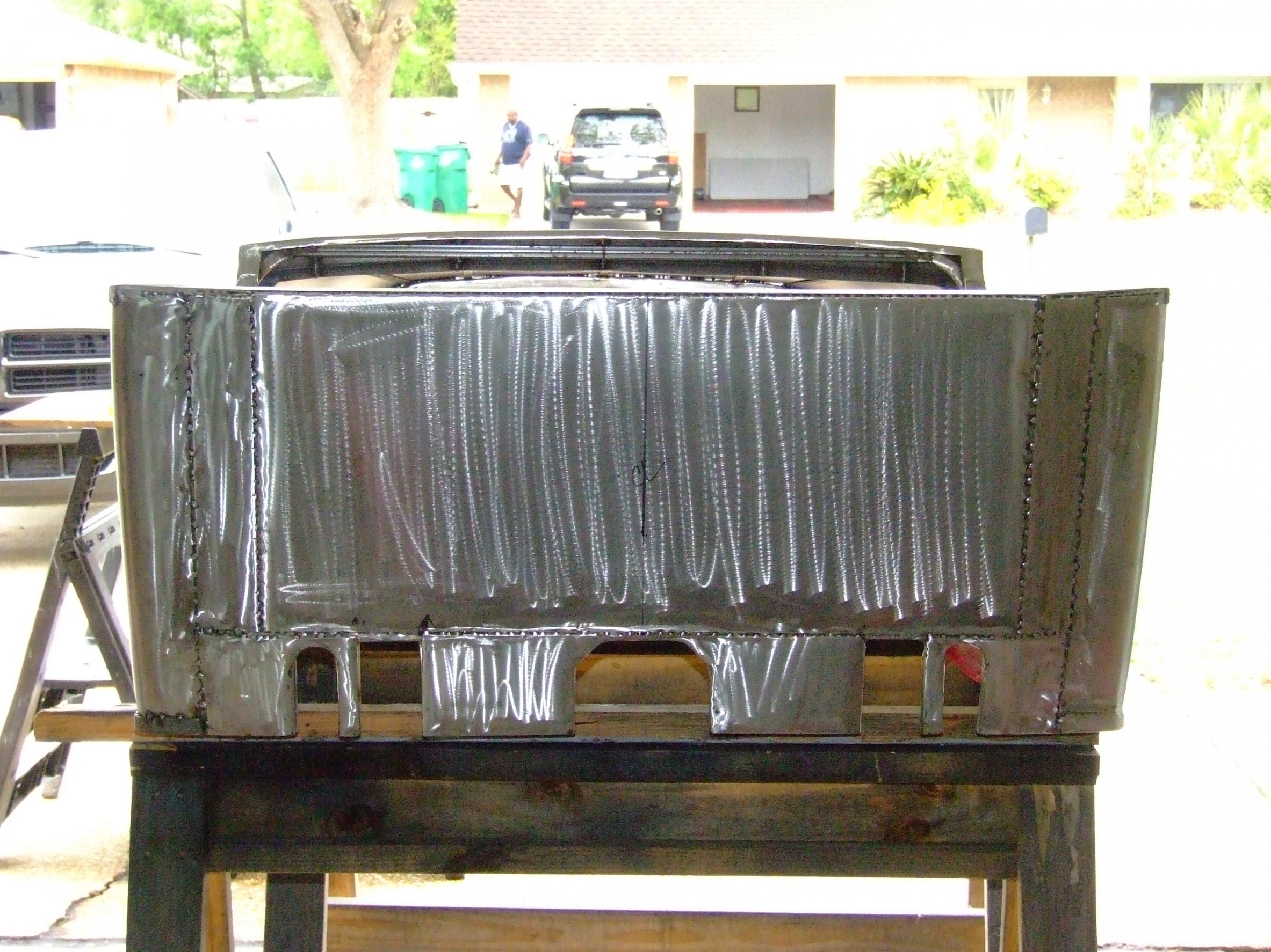

    Firewall is from bottom to center top 28", at the dash the body is 42.5 and at the rear of the top of the body 48" lenght is from firewall face to the rear body panel it's 50". The cowl is a full 16" deep from firewall to dash.

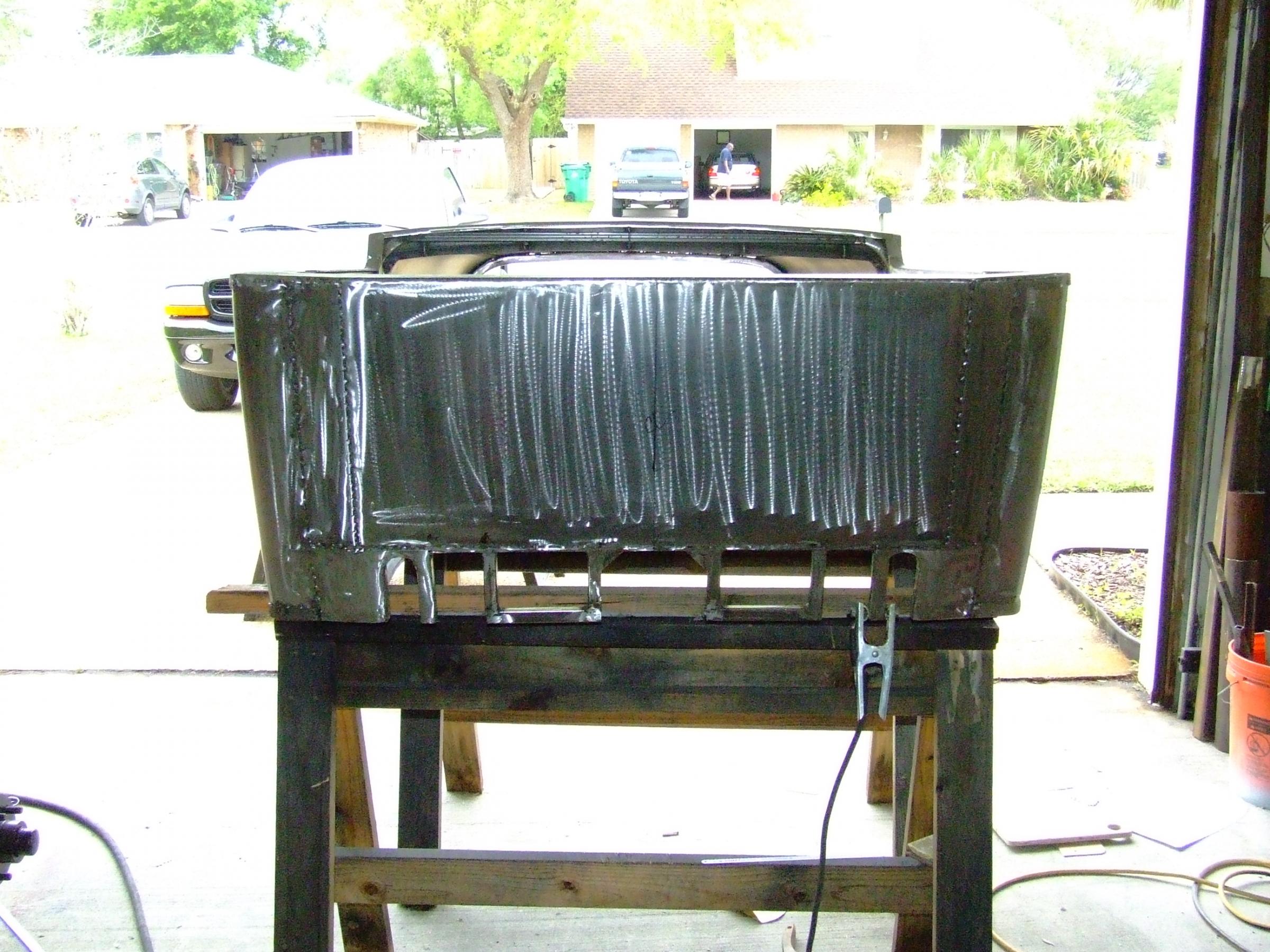

    Of coarse the body is approximately 1.5" wider at the top than at the floor. The body has a slight contour outward so as not to be flat or slab sided this is a mistake I have seen on other custom made bodies by hobbyist. It was harder to maintain the contour but I built all of my uprights for the structure at the same time all had exactly the same curve and were made with graduating lengths from front to back so I was able to maintain the same curvature along the sides and back panel to look more like an original. Hope that helps.

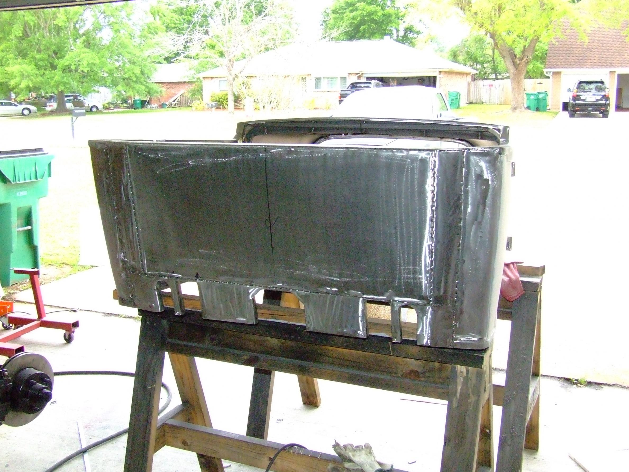

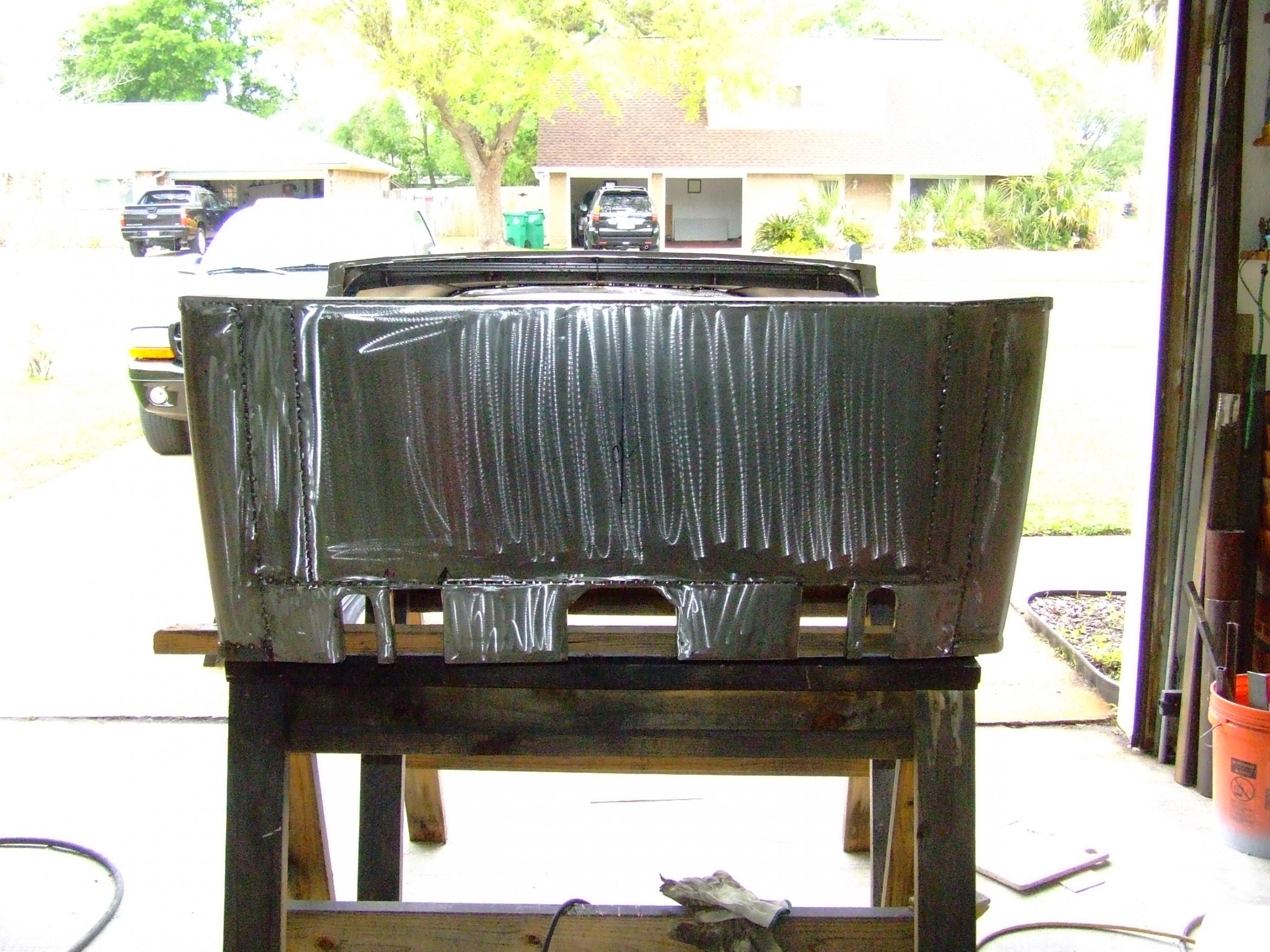

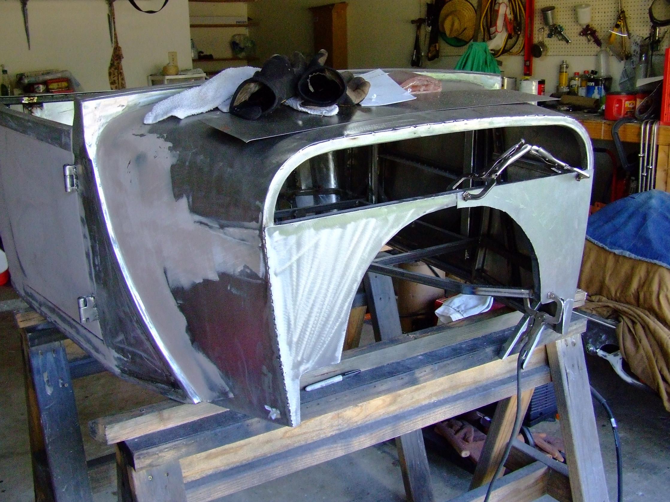

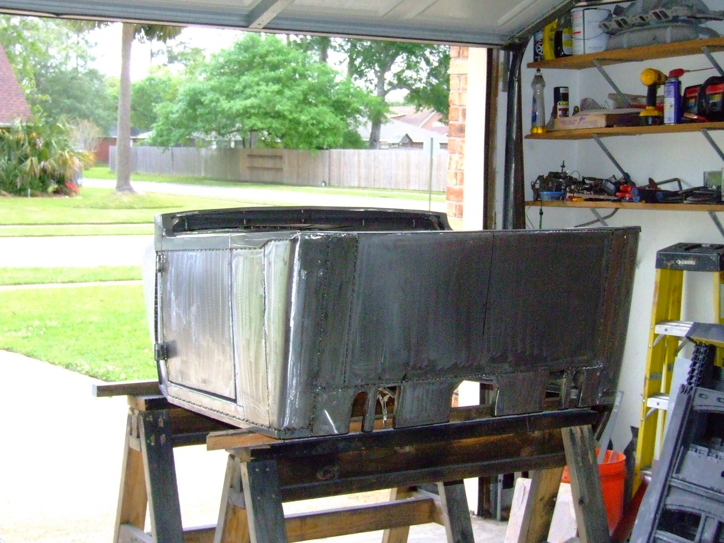

    Worked on it for a little while, finished the rear panel.

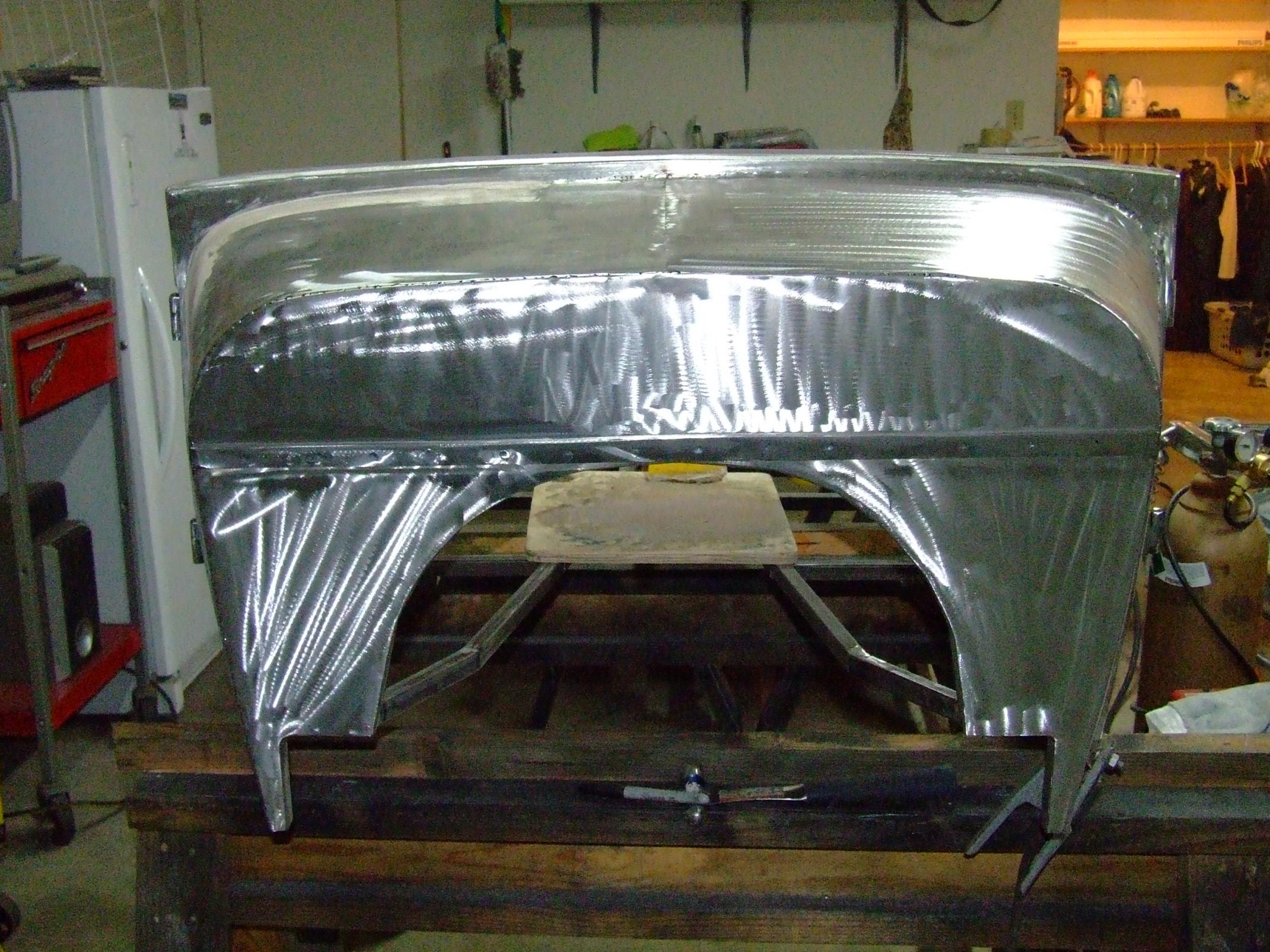

    hey there cryptkeeper,your chassis looks real nice. The body has nice lines ,but I have a couple questions.1: How much tension is in the skins when you fit them to the frame stucture? 2: are you fully welding your joints before you lead them?
  10. cryptkepper
    Joined: Feb 29, 2012
    Posts: 155
    cryptkepper
    from louisanna
    To answer your questions there is no stress or tension at all when I heated the sheeting with the heat gun it was able to expand slightly and relive any stress. As for welding it is tack welded approx. 1" apart and only hard welded in vital areas and those welds are less than a inch in length. Not the first body I've built. I have completely leaded the body already, and have started the body work.

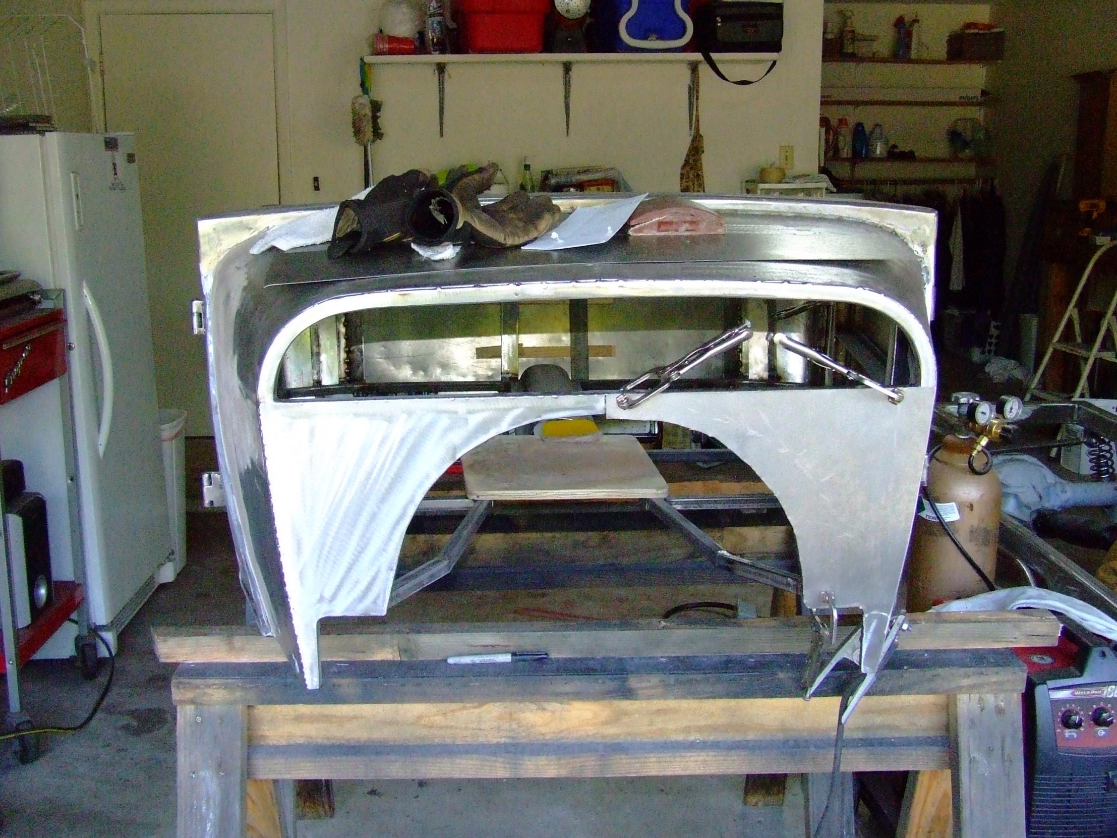

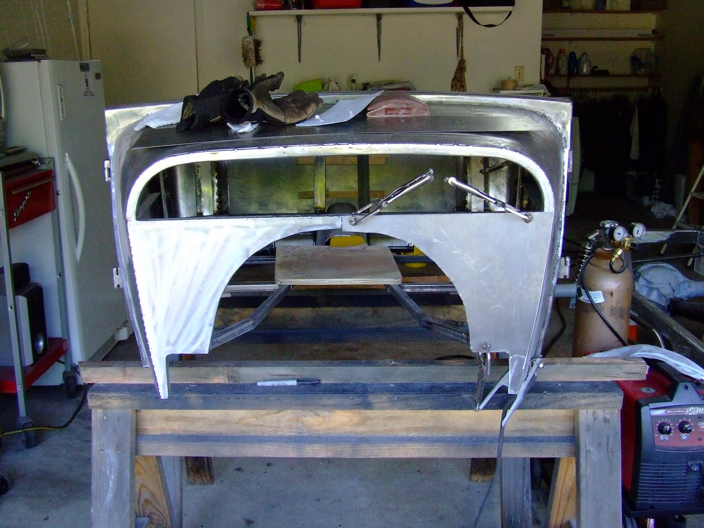

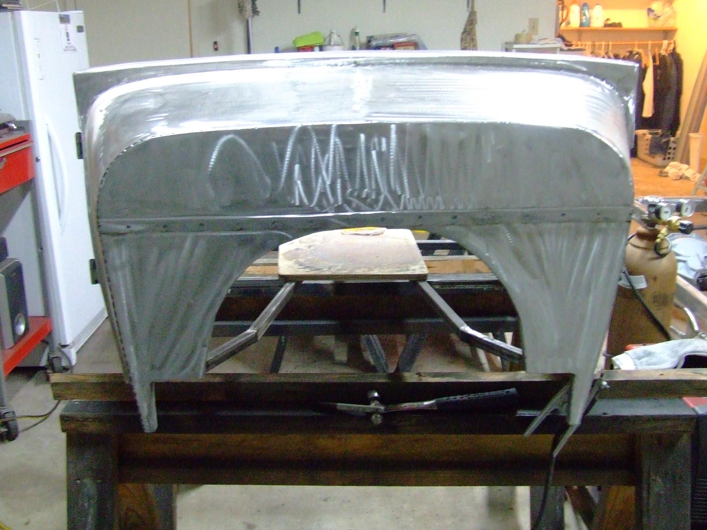

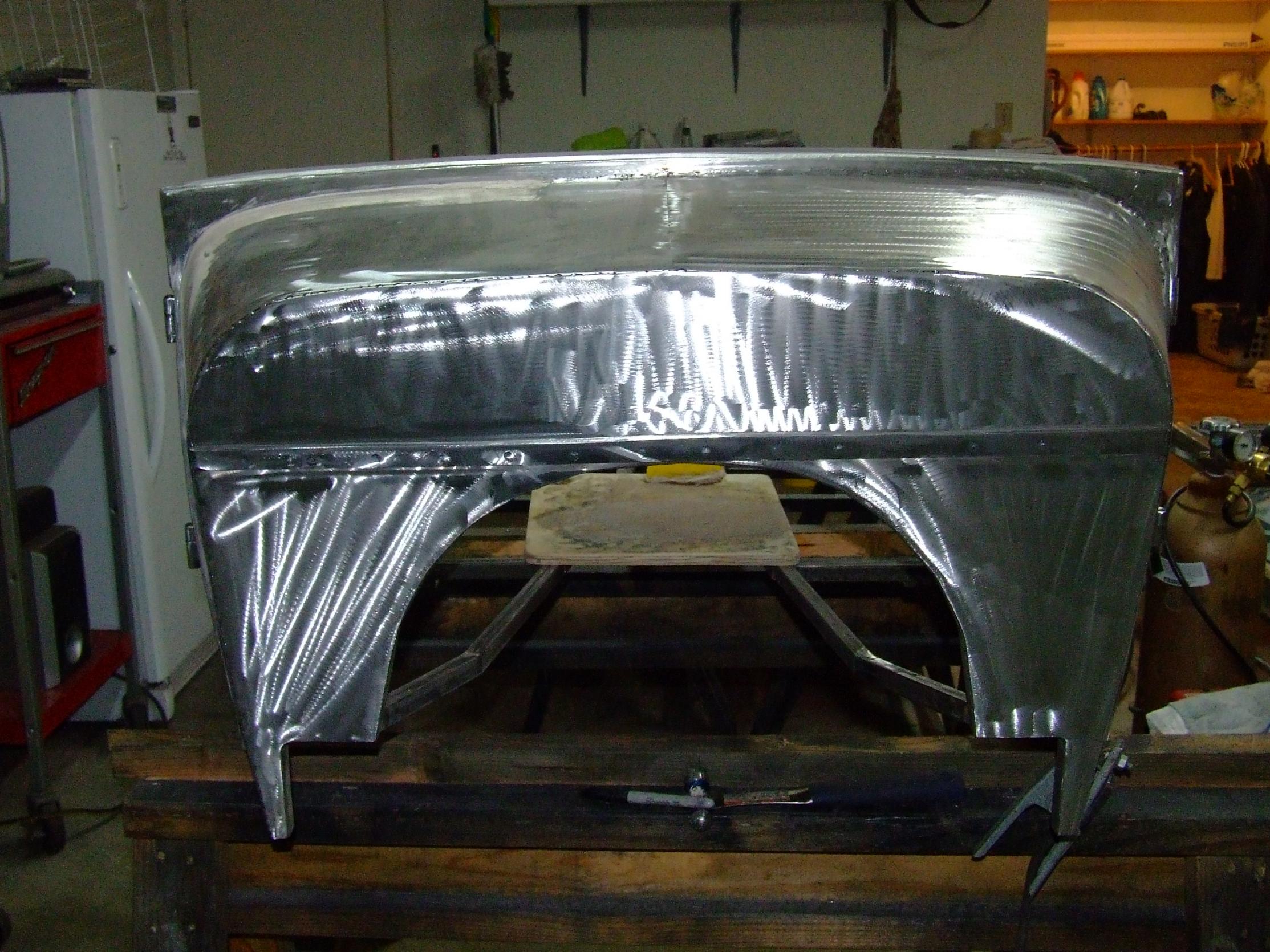

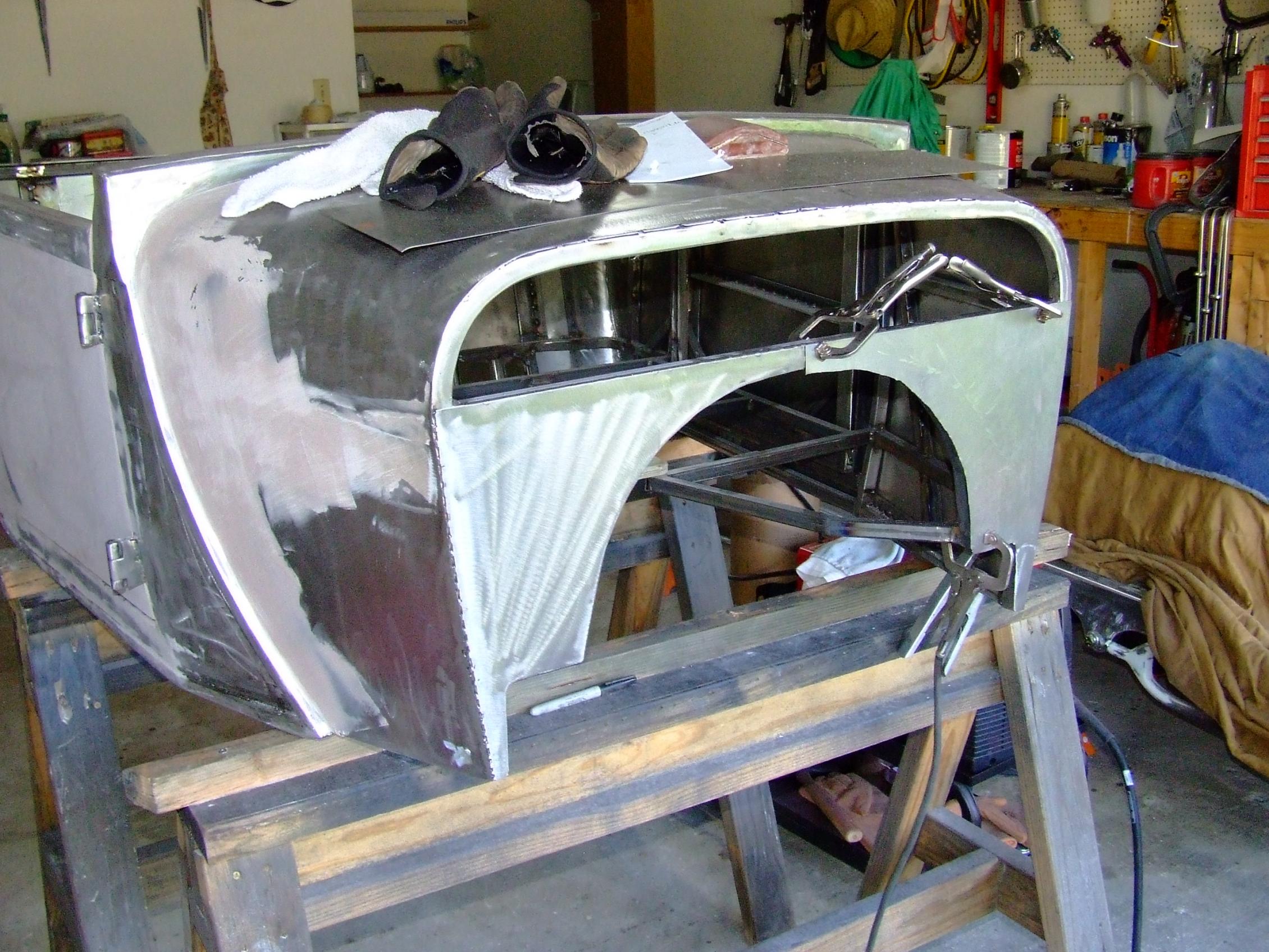

    Hey guys been working long hours on the new job but managed to get a little done. I did the firewall, I like it, I wanted very little detail but went ahead and put a seam in it to give it a little detail. Well here are a few pic,s.

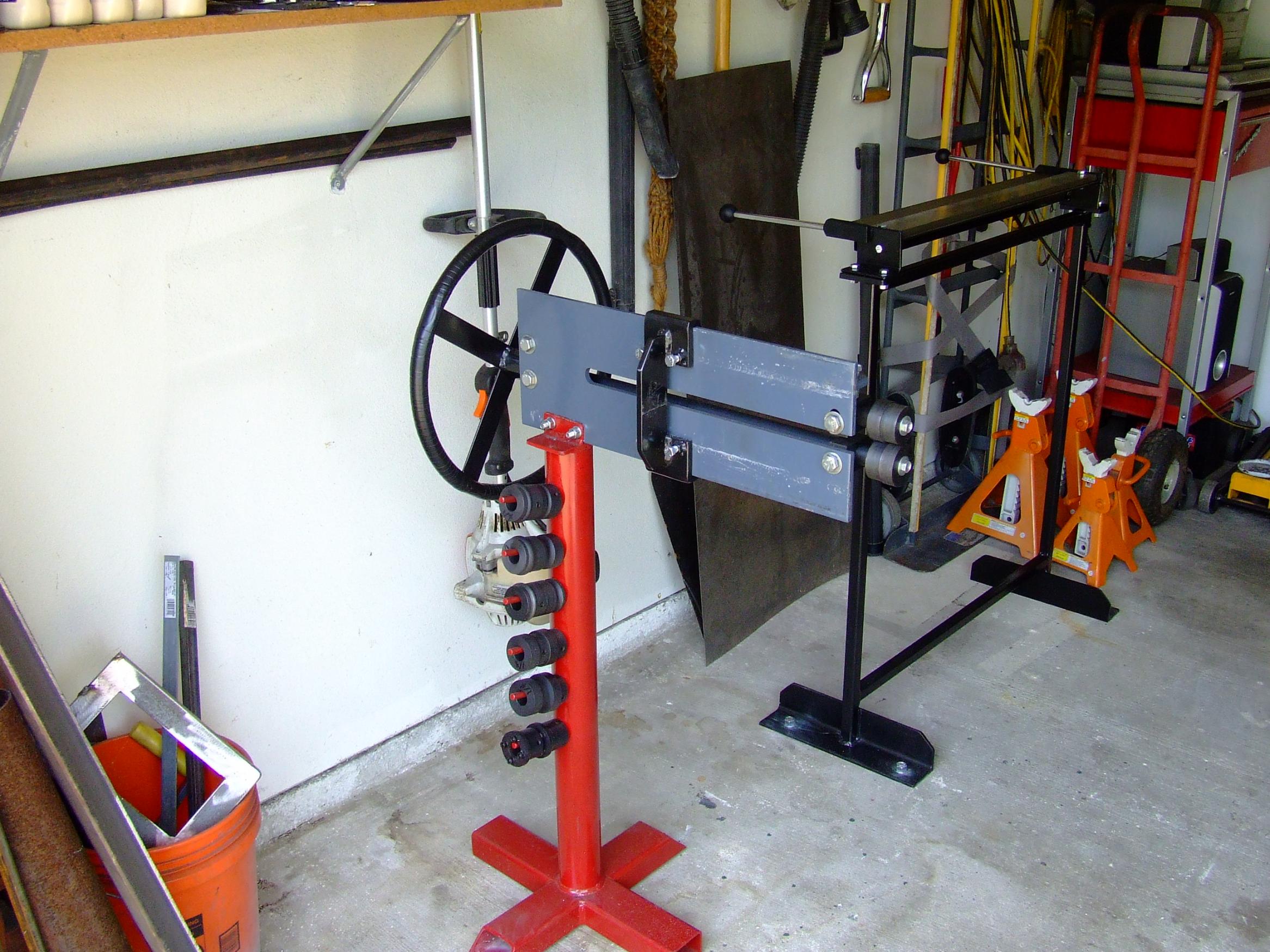

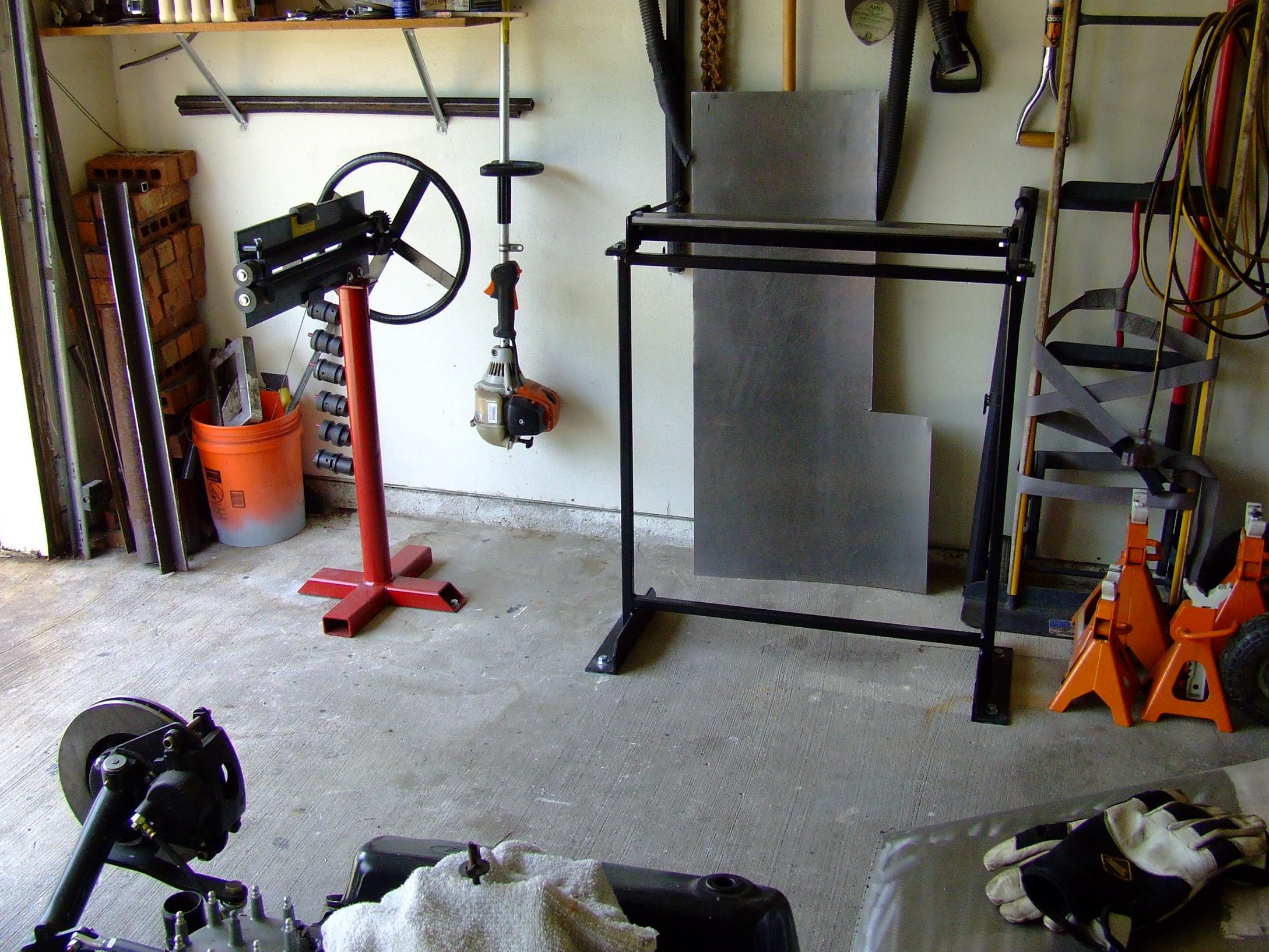

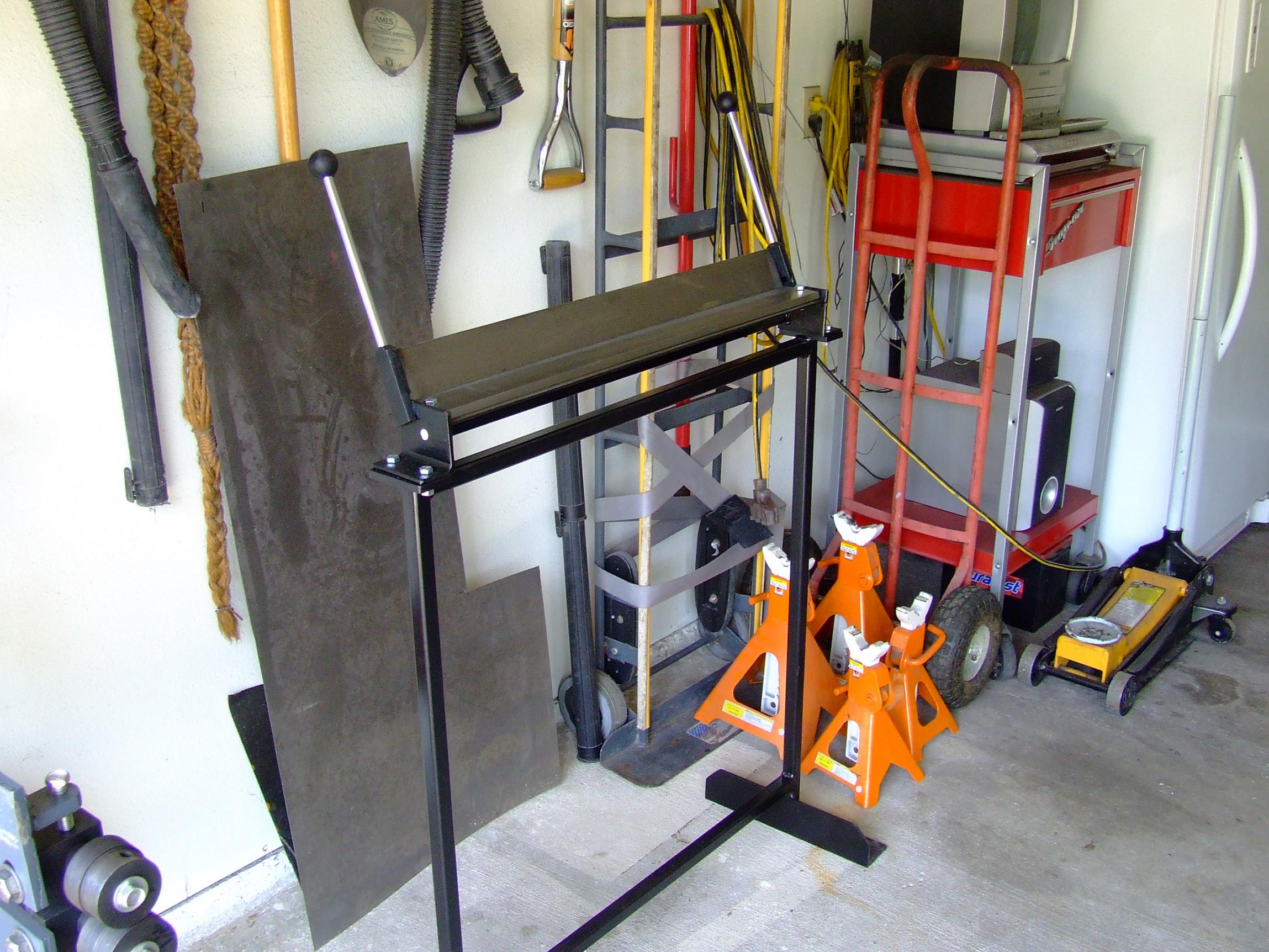

    Hello folks, I haven't had a lot of time to work on the rod lately. I have been working the new job. But being back to work has afforded me some extra monies to by some tools such as a bead roller from HF not the best but i beefed it up and it works fine. I also bought a 30" bending brake, I also modified it too. I have plans to work on it this weekend, and attack the floor then onto the fabricating of the bed. Will post pic's as I go!

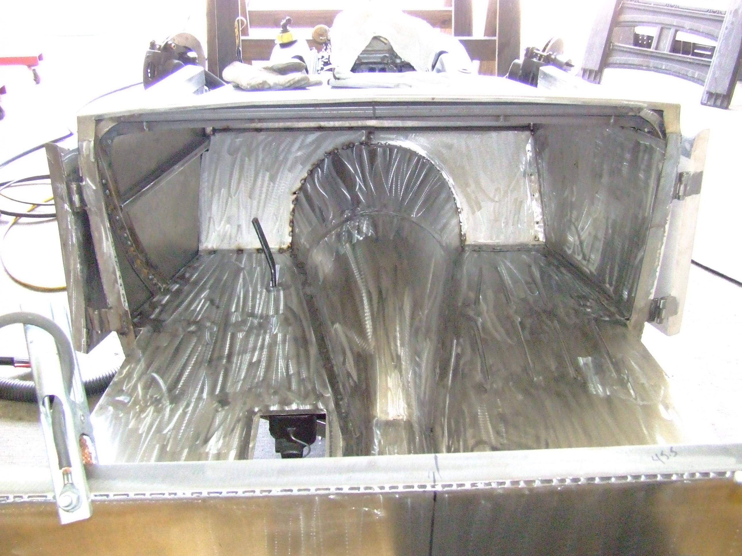

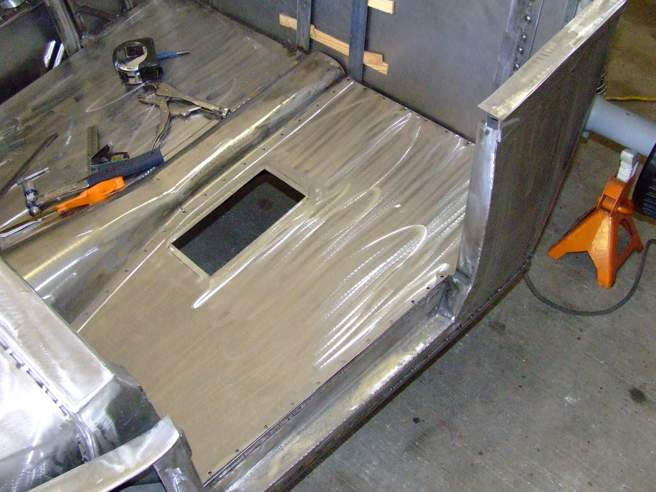

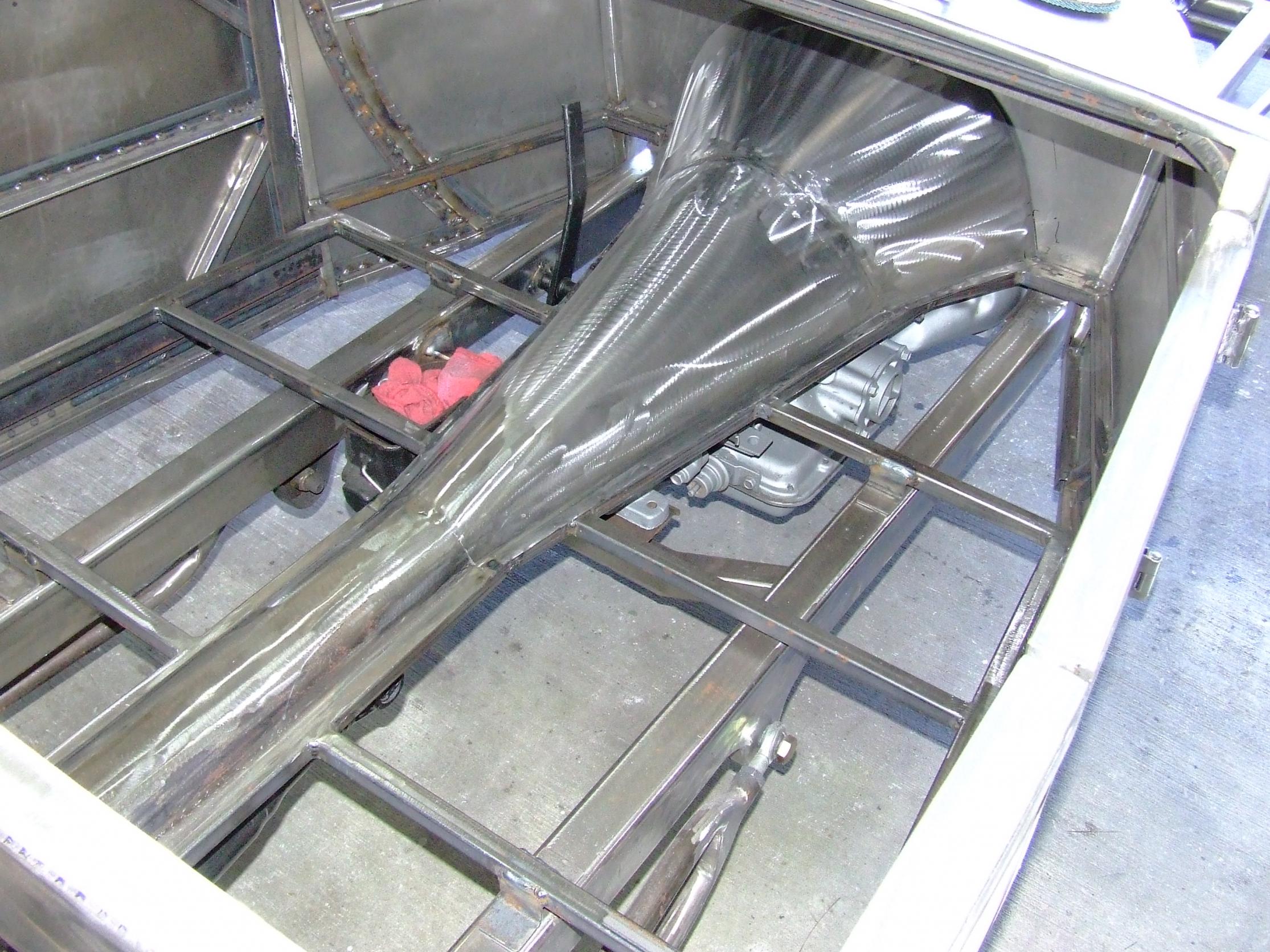

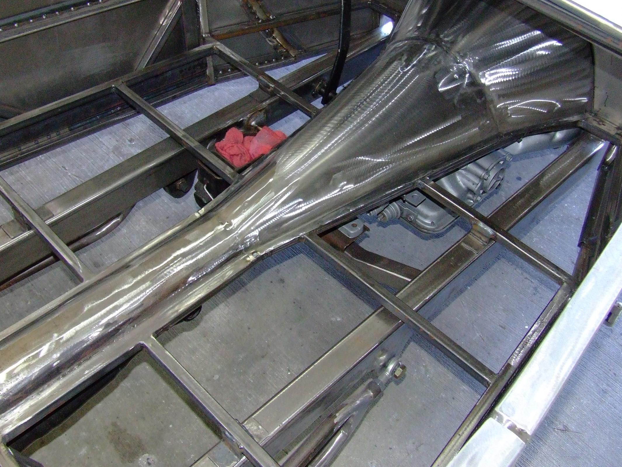

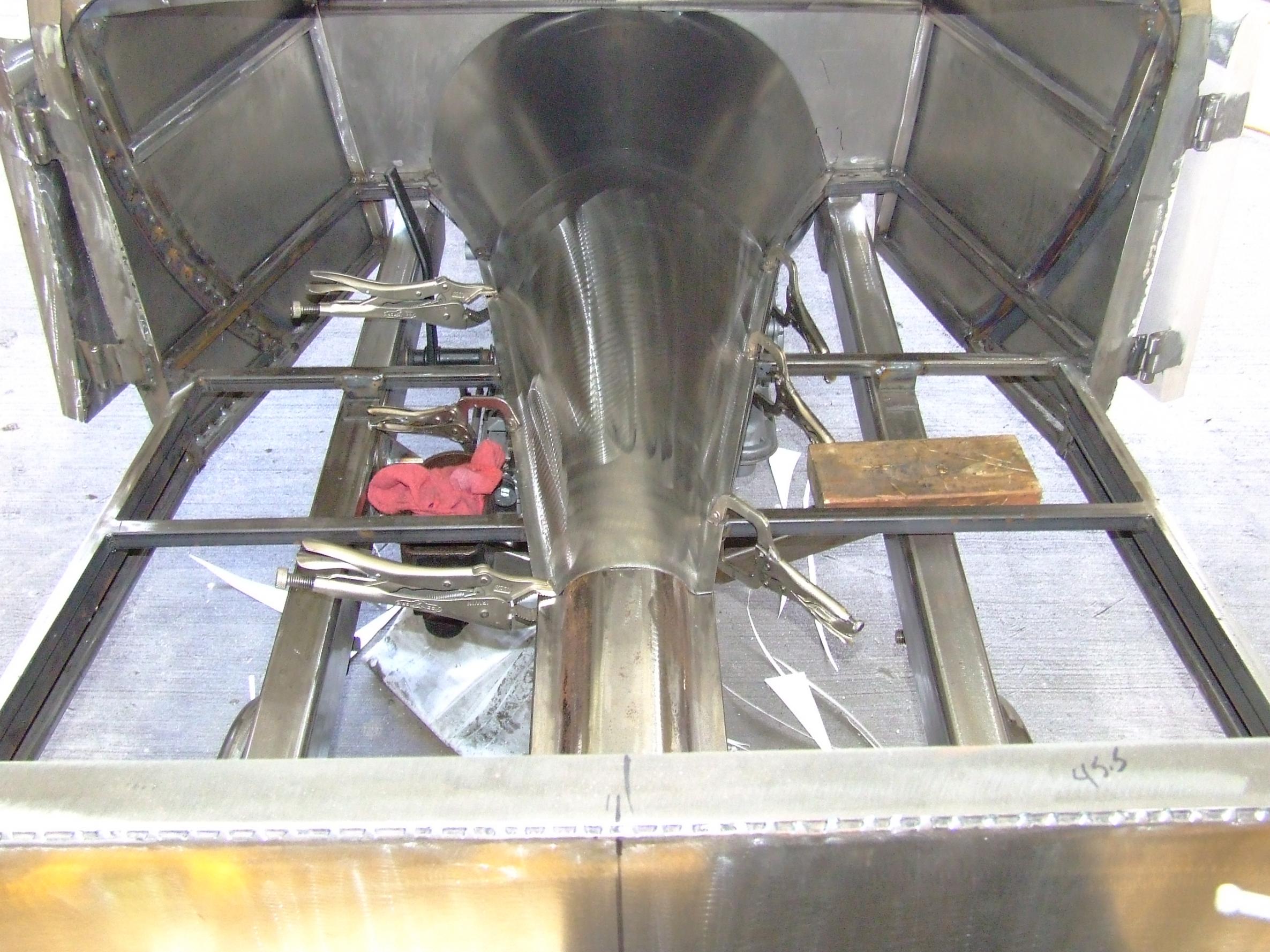

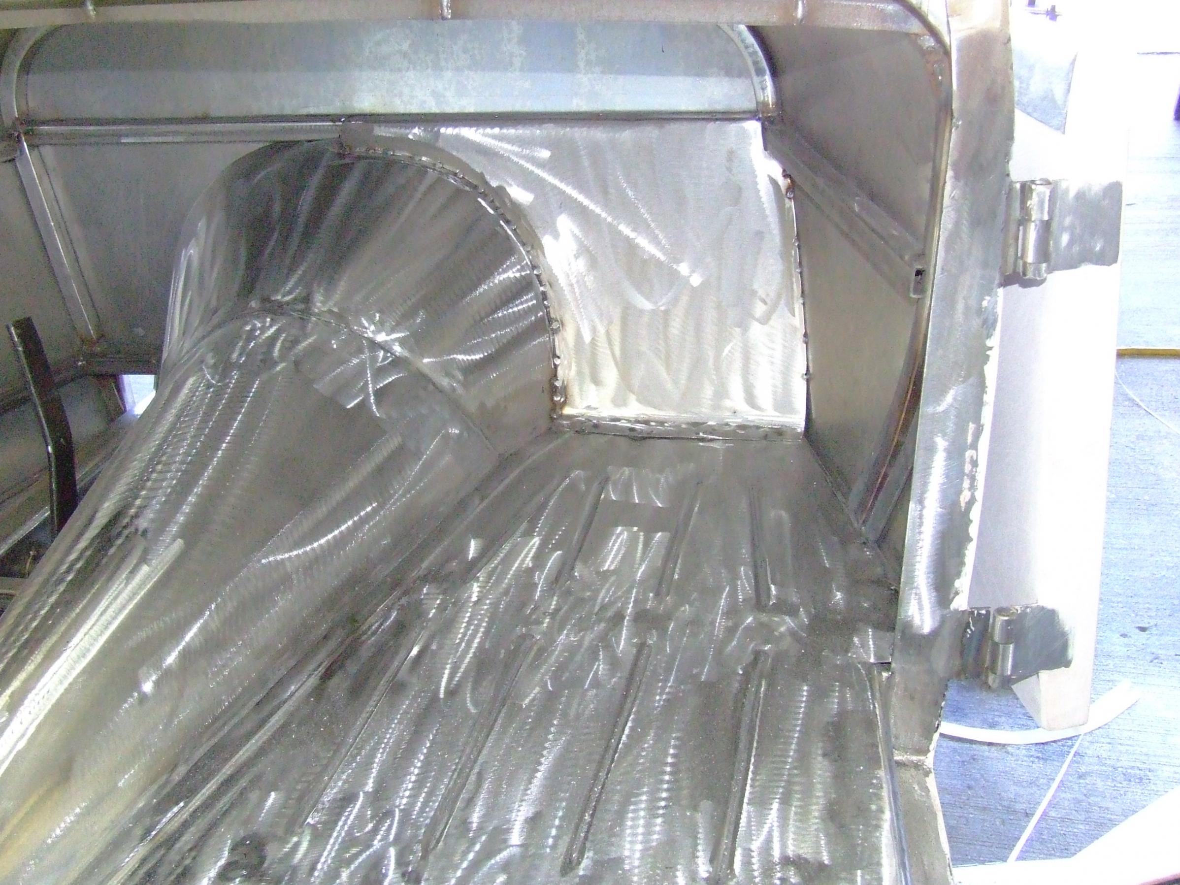

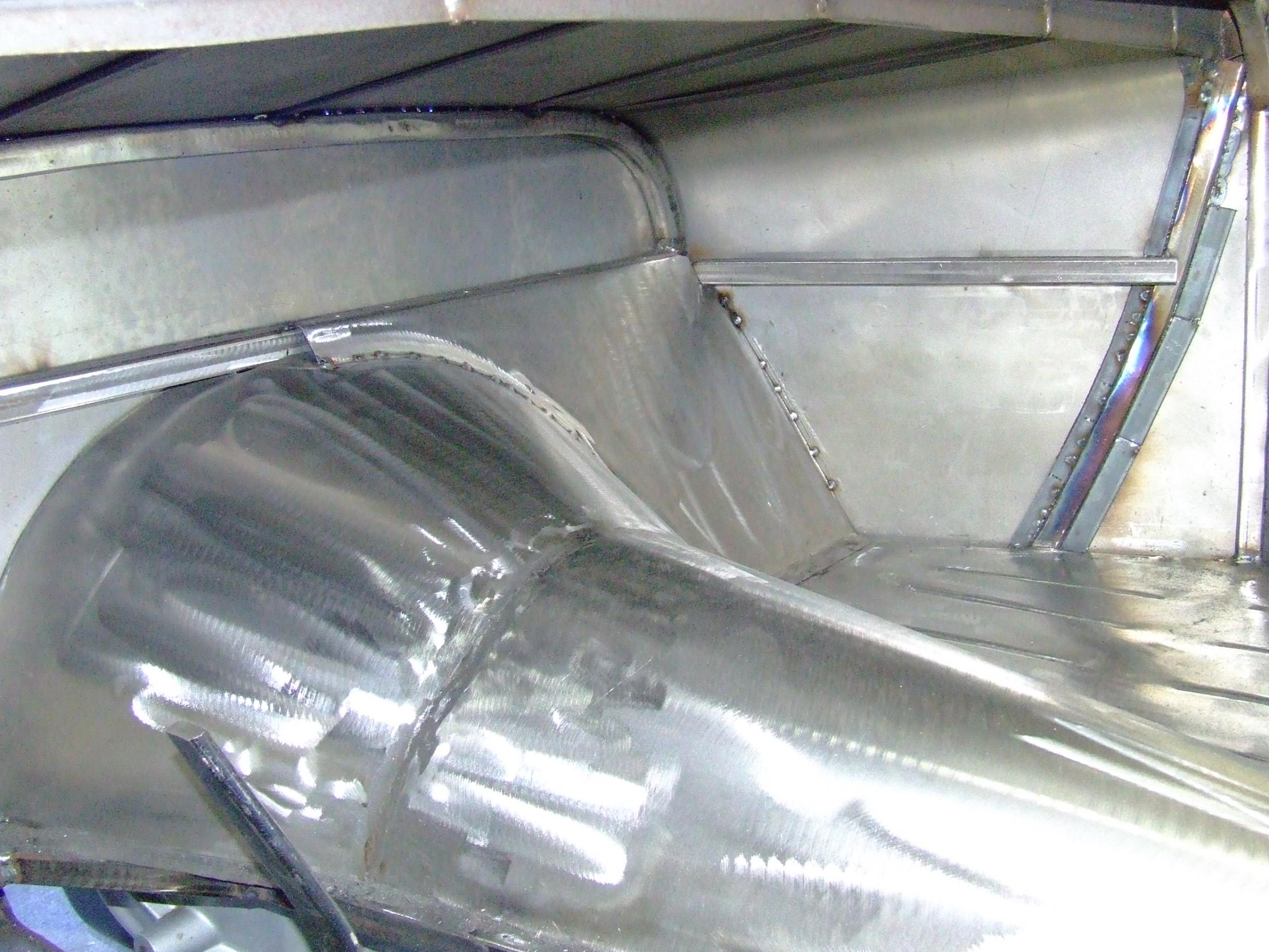

    Hey guy's spent Saturday cleaning the garage and setting up my bead roller and brake. I modified both since they are cheapo's from HF. I built a stand and a stifner and replaced the crank with a homemade wheel which works so much better. I also anchored it to the floor. With the brake I built a simple stand and anchored it also, used both of them today and they work just fine I did the complete trans tunnel. Here are some pic's.

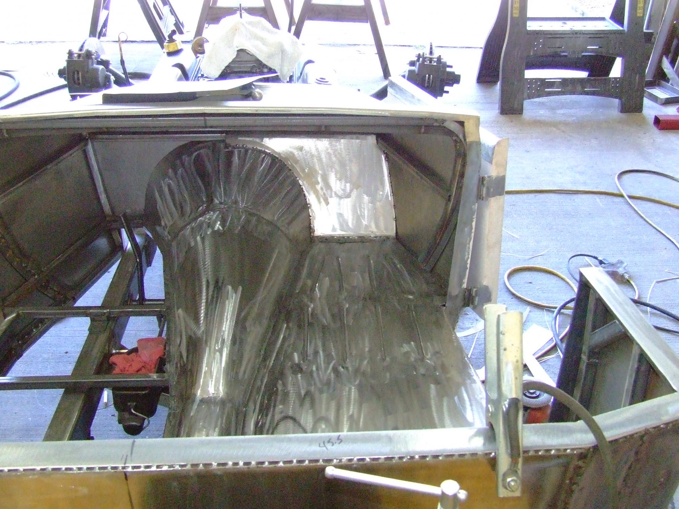

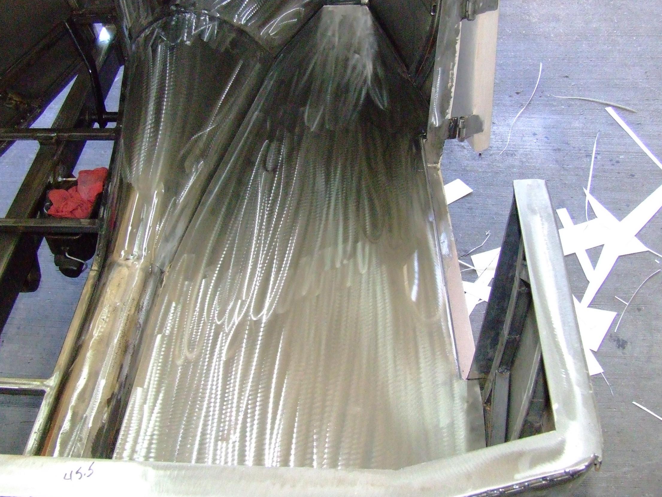

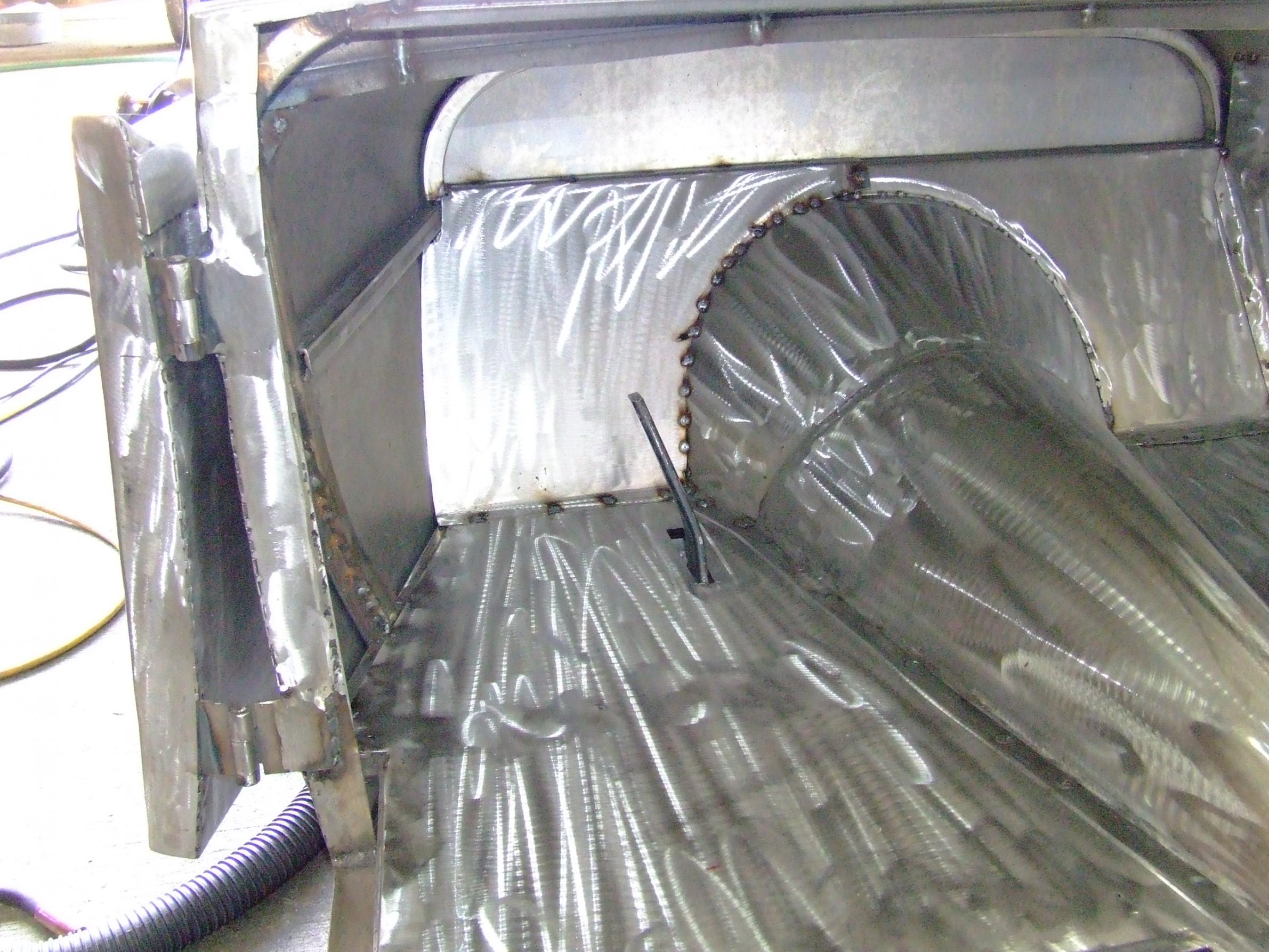

    Worked on the rod a little today and played with my new toys! Made the passenger floor and fabed the foot box and added the inner panel on the side to tie in the floor and firewall as well as the side inner panel. So here are some pic,s.

    Hey guy's, well previously I told you guy's that I purchased a bead roller from HF, used it and wasn't satisfied with how it worked it has a lot of flex and is real stiff. I first made a wheel for it and that helped turn the rollers easier. but it flexed at the roller so bad it was hard to do a straight bead. so I dismantled it and cut the top and bottom of the plate on an angle and then added two gussets lenght wise along the slot to stiffen the plate. I also added zerk fittings at the drive shafts front and rear. these improvements cured the flexing and the drag at the wheel. So today I intend to finish the floor on the driver side. The interior of the body is taking a little longer than expected. I didn't know what to do with the inside of the doors and theirs the dash! Will post soon.

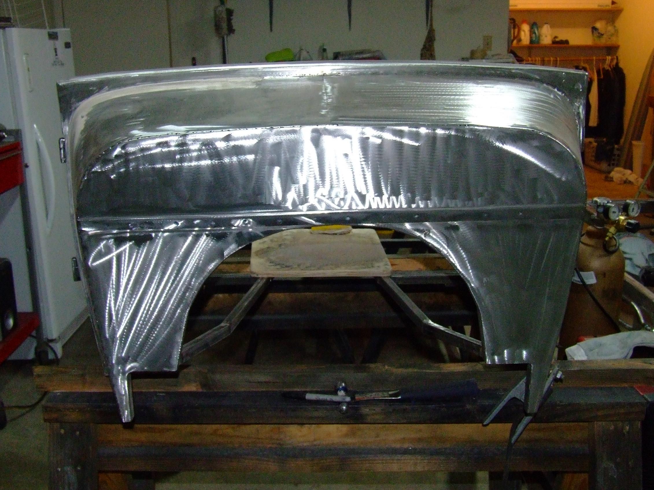

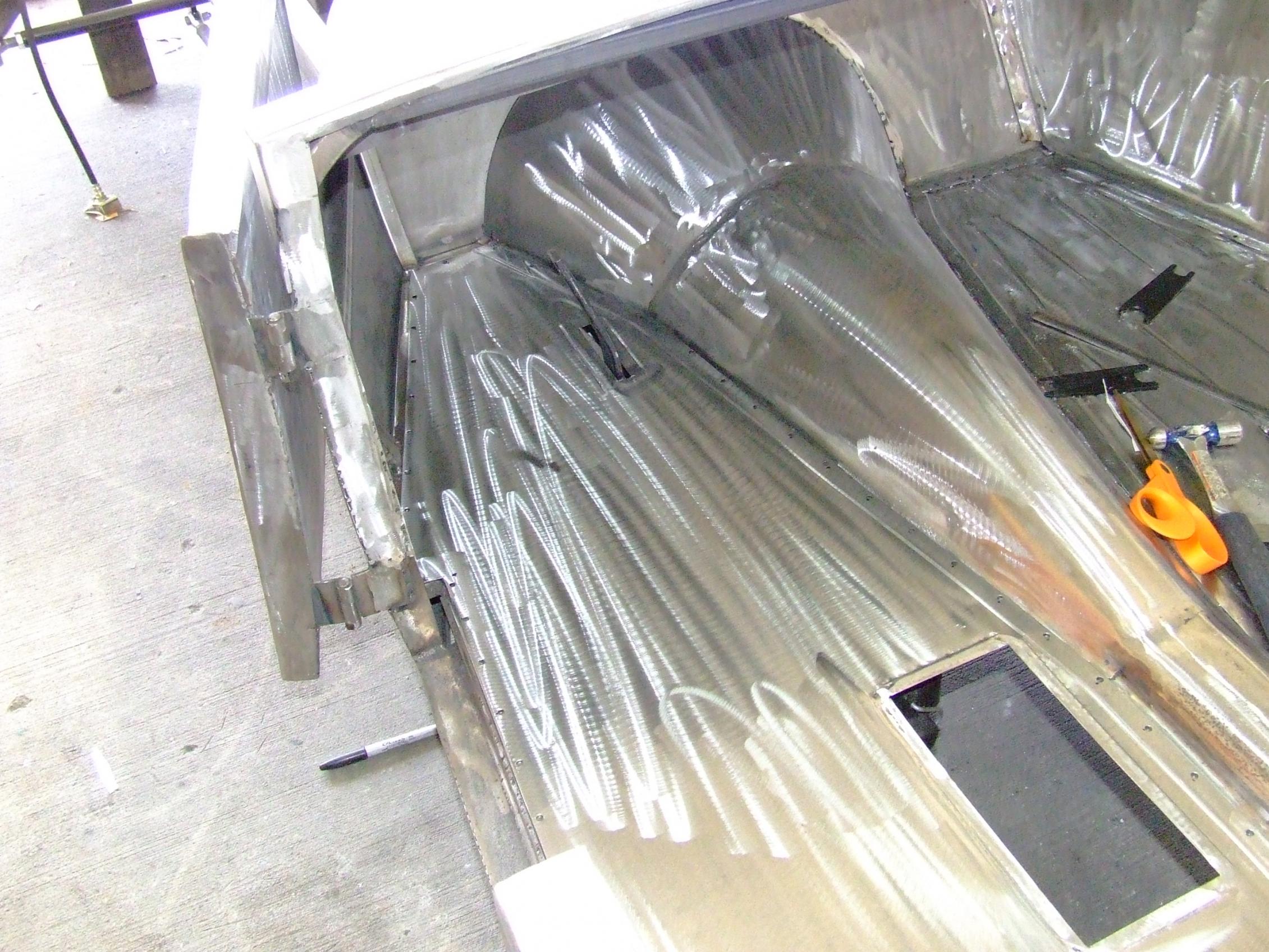

    Hey guys, have been working a lot of hours at the job so not a lot of progress has been made. I manage to do some work on the rod, I finished the floor on the driver side as well as the driver foot box. So next is the dash and inner door panels. Here are some pic's.
