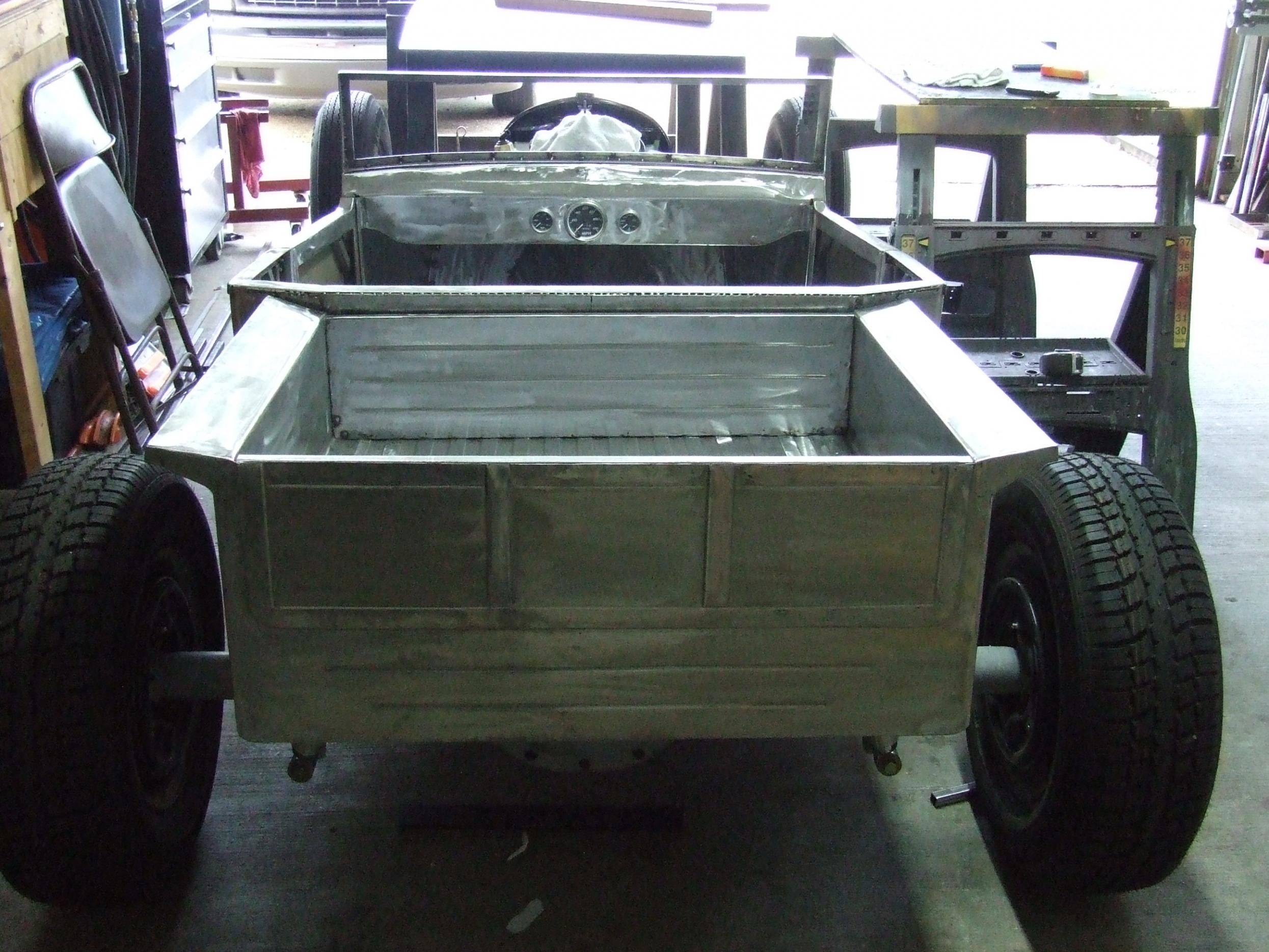

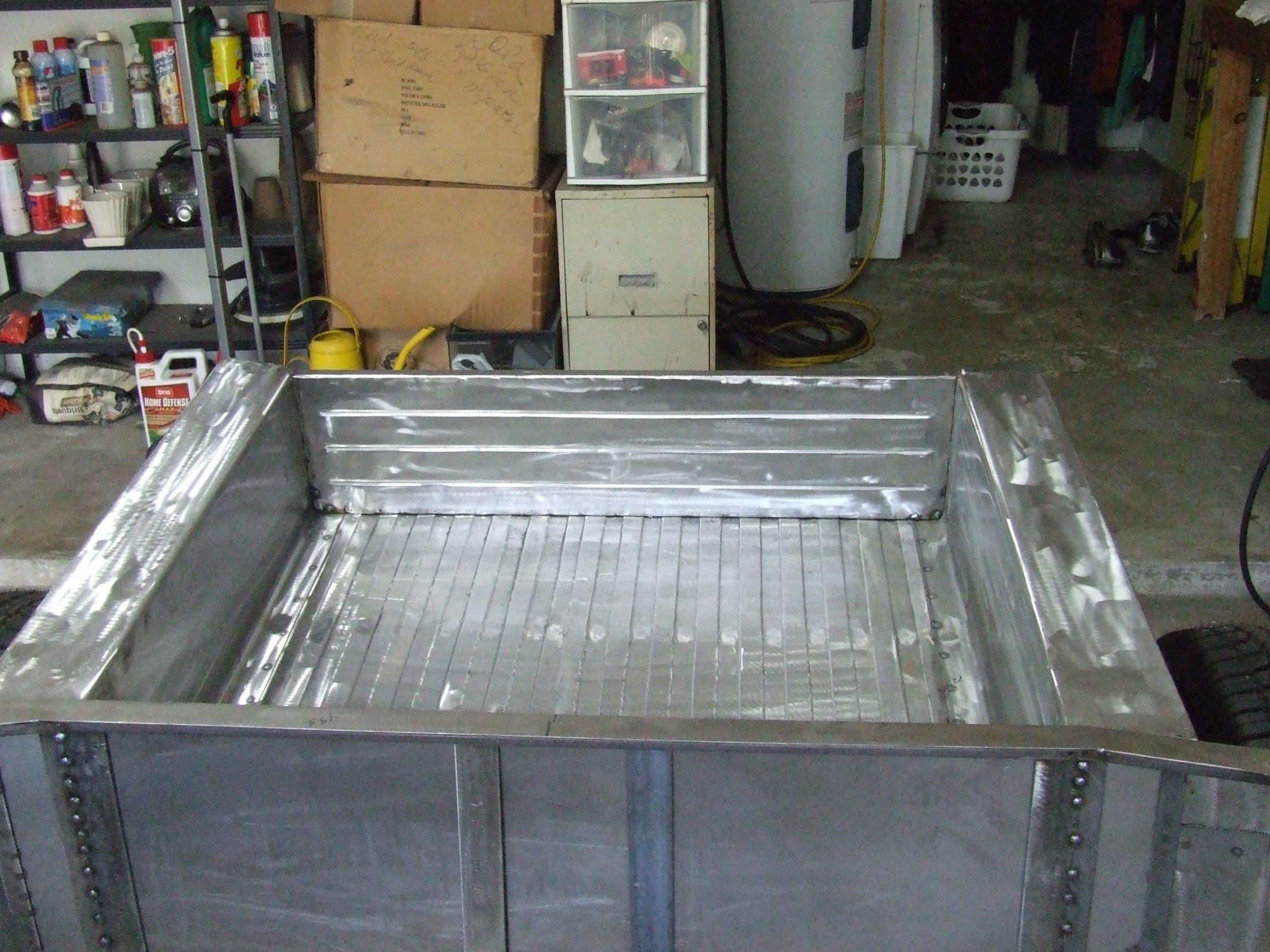

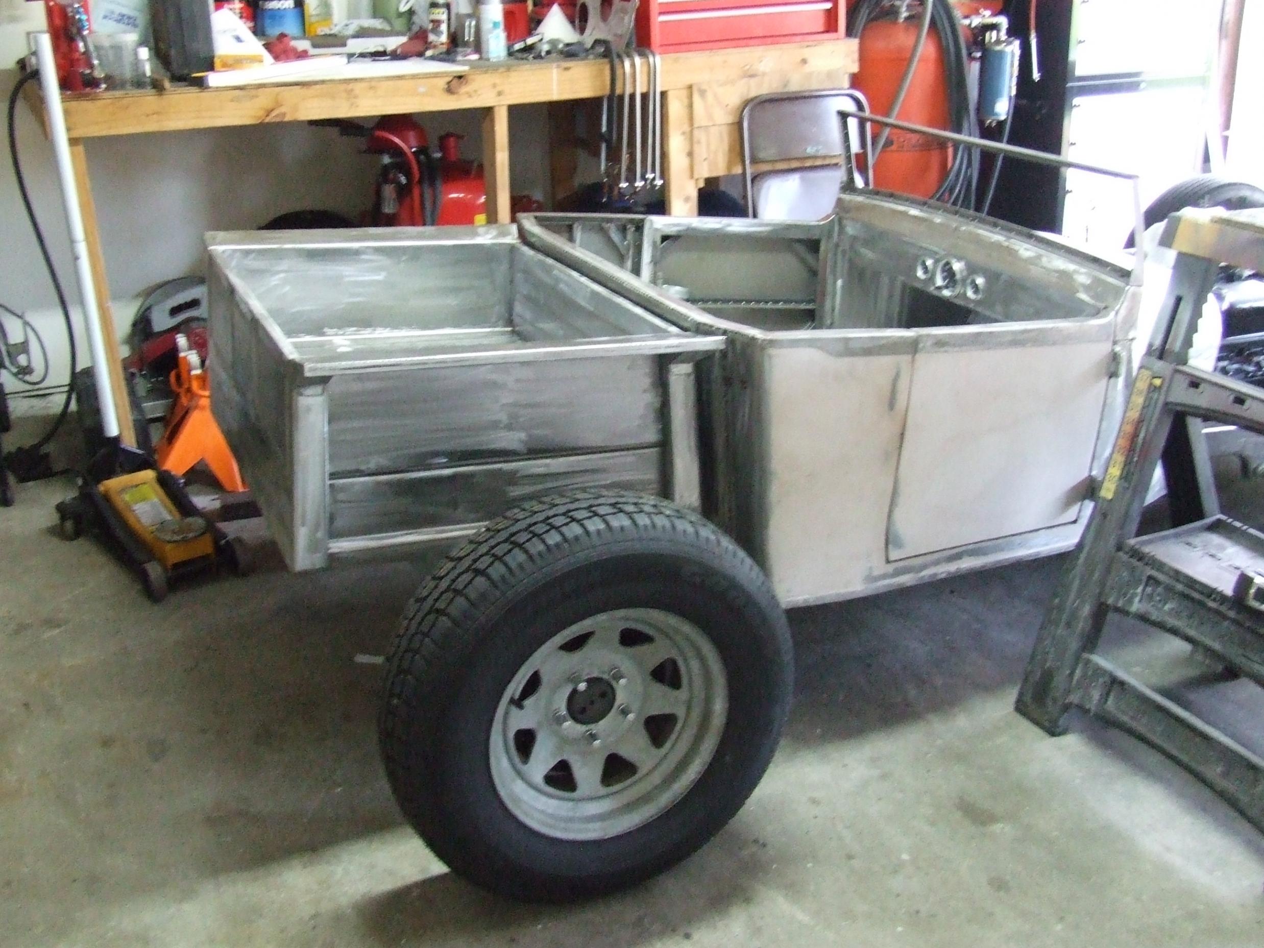

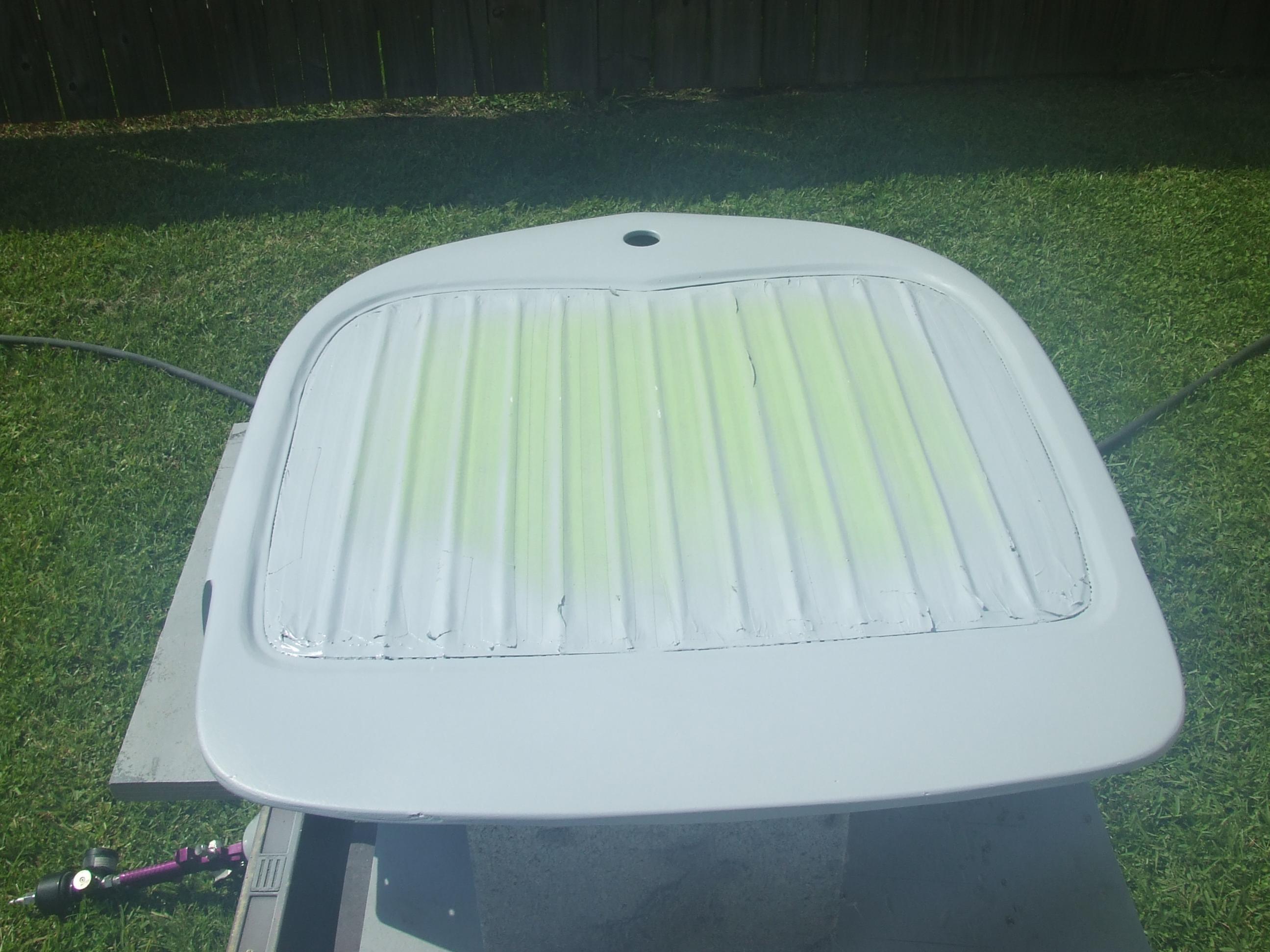

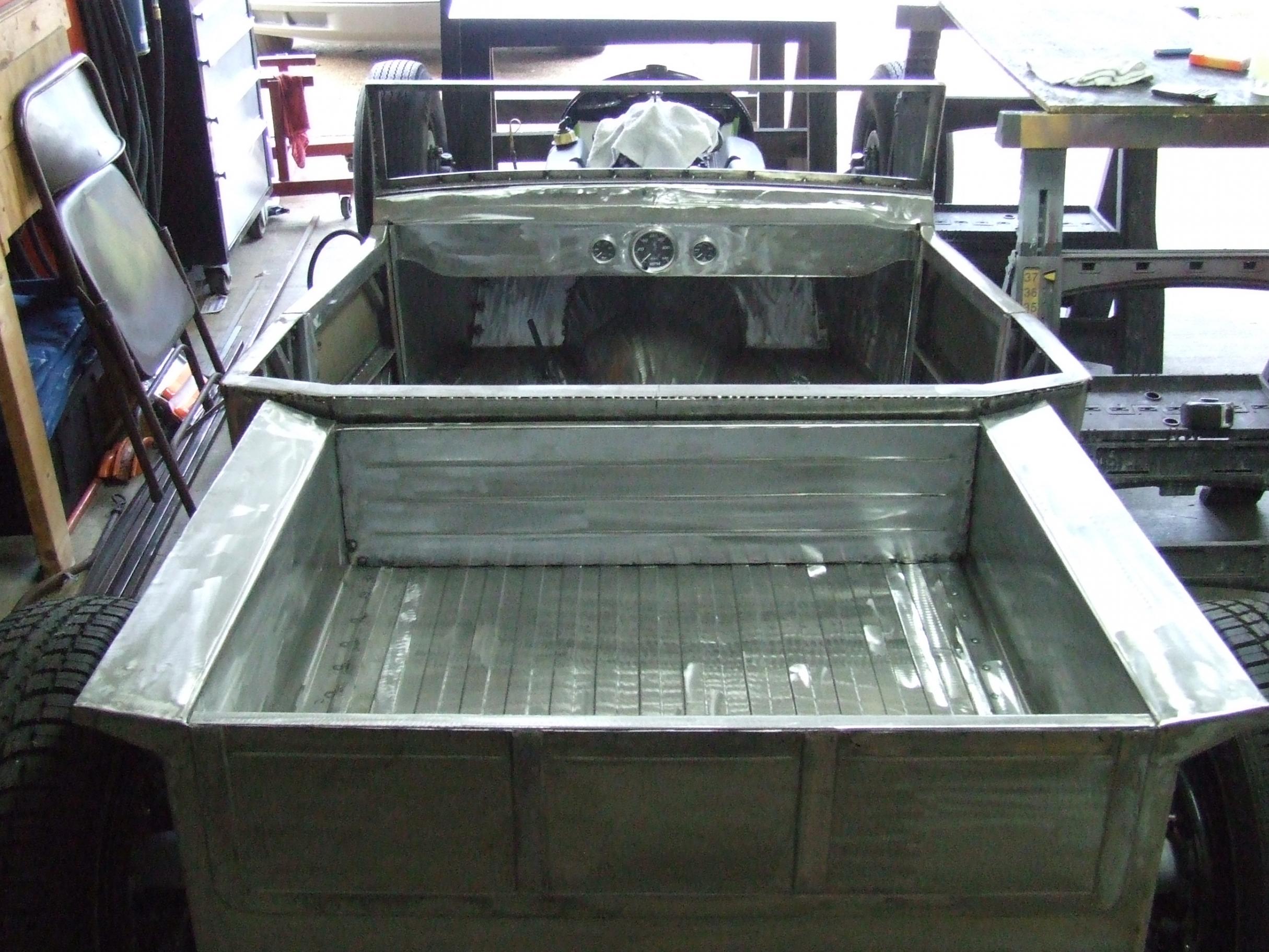

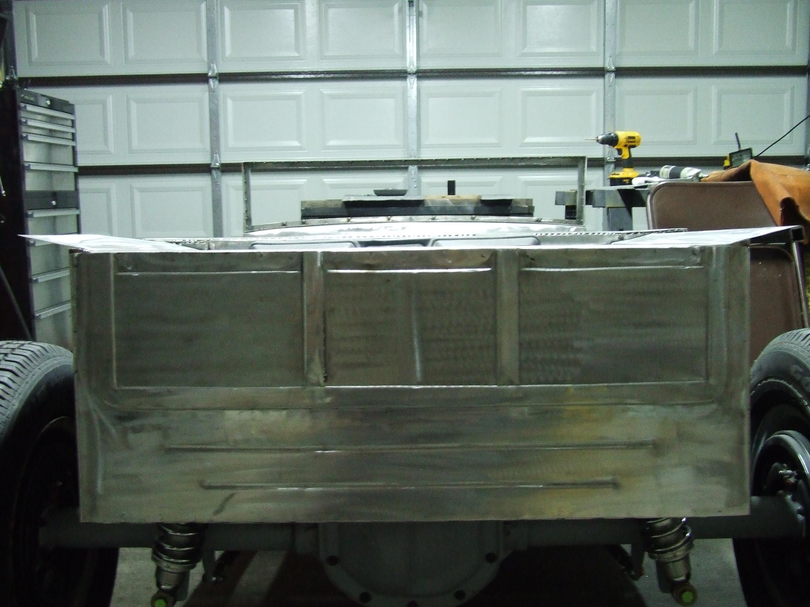

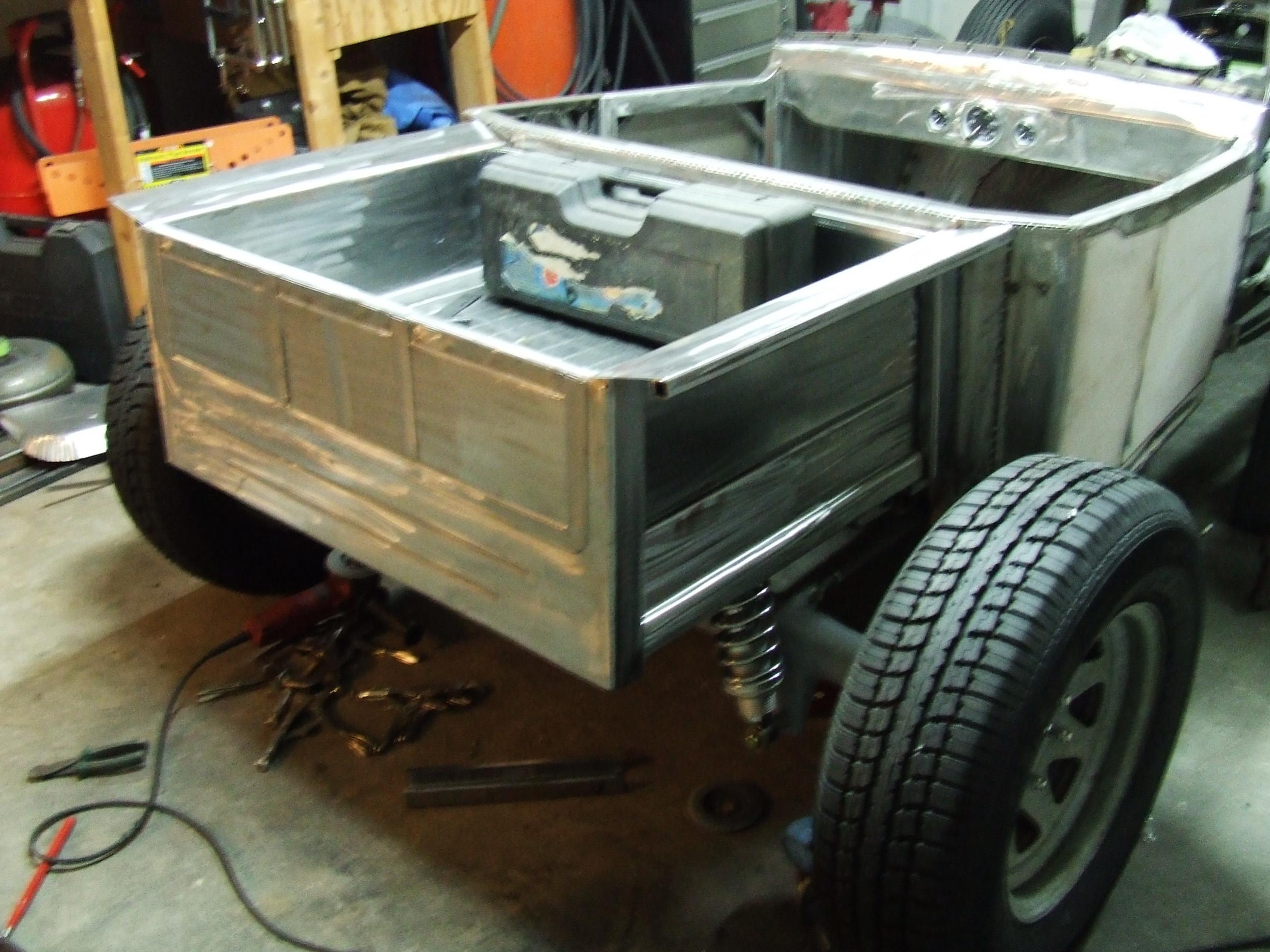

    Hey guy's I had a couple of hours to work on the bed today. I had previously told ya'll I wanted the tailgate non functioning but to look like it opened. Well I think I succeeded let me know what you guys think. I still have a few things to do to complete it so it is not complete. Here are some pic's!

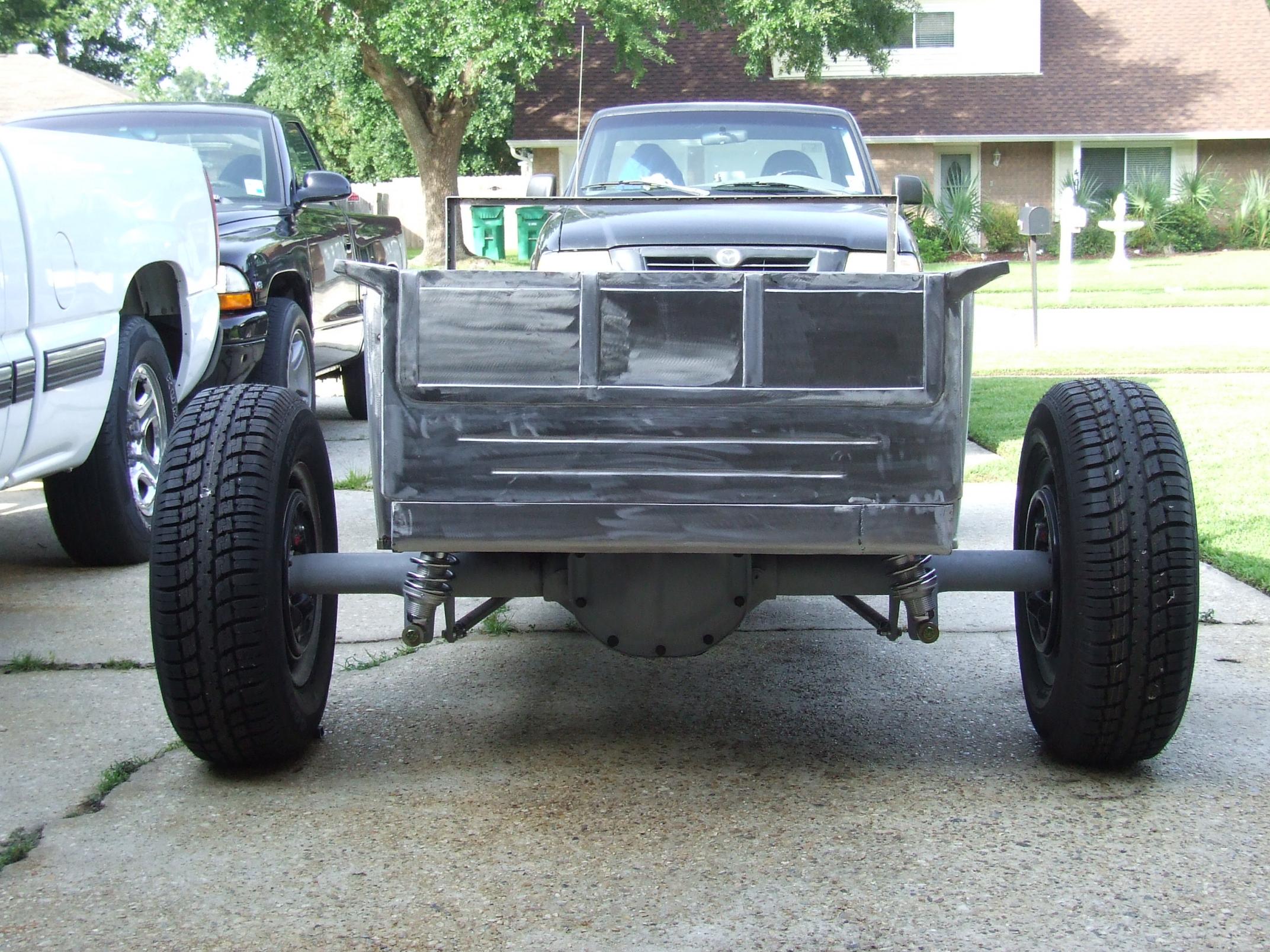

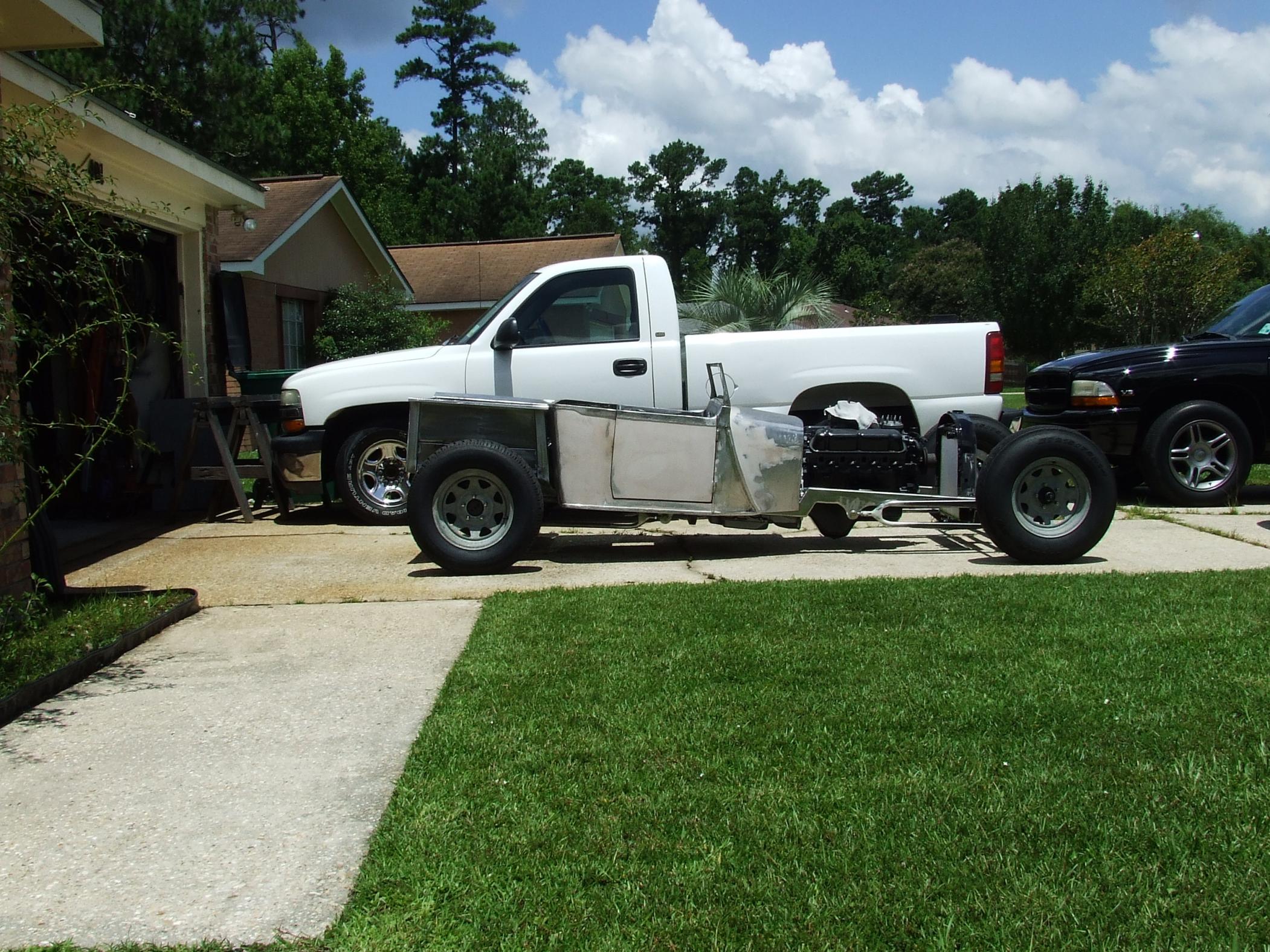

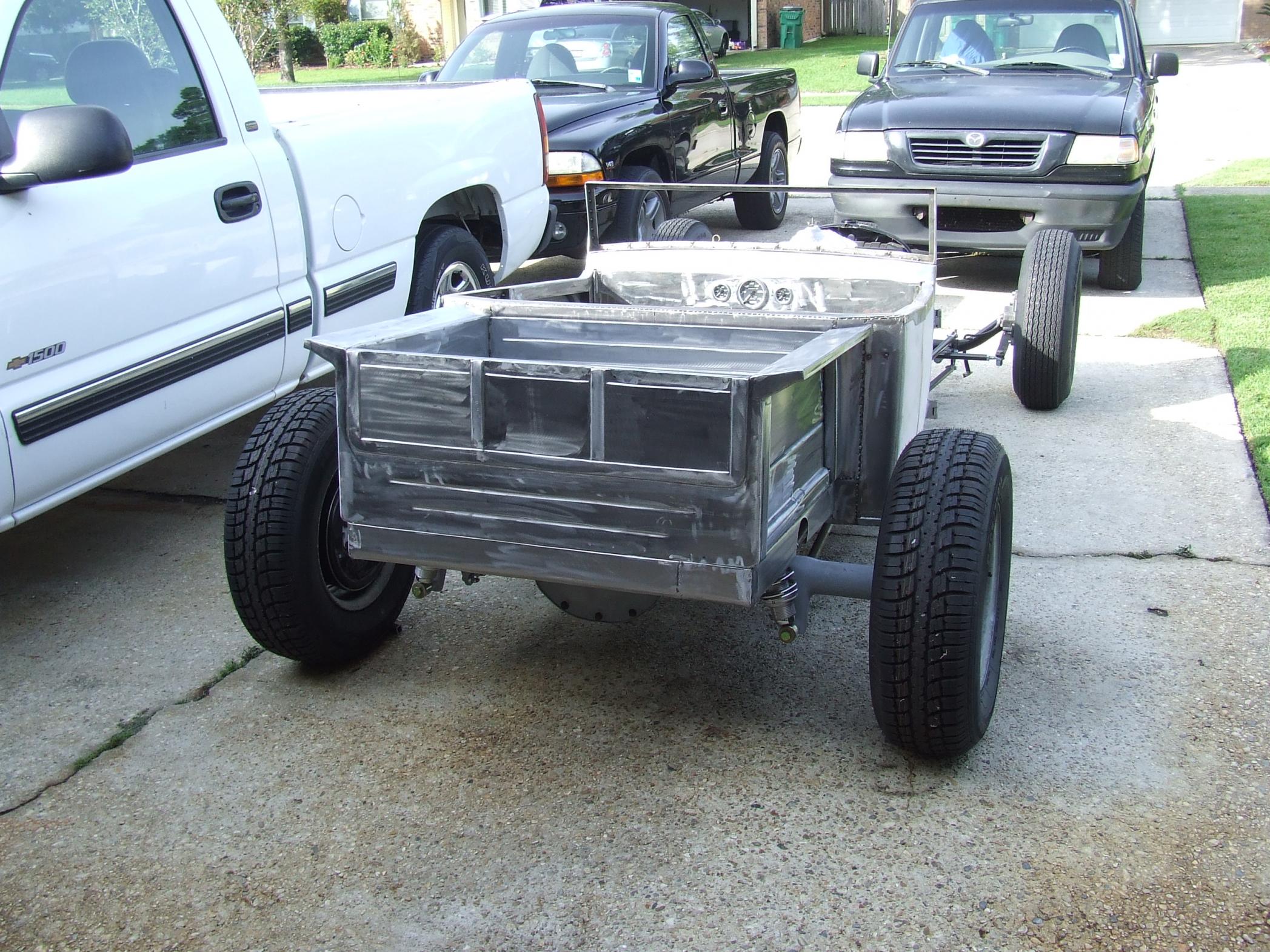

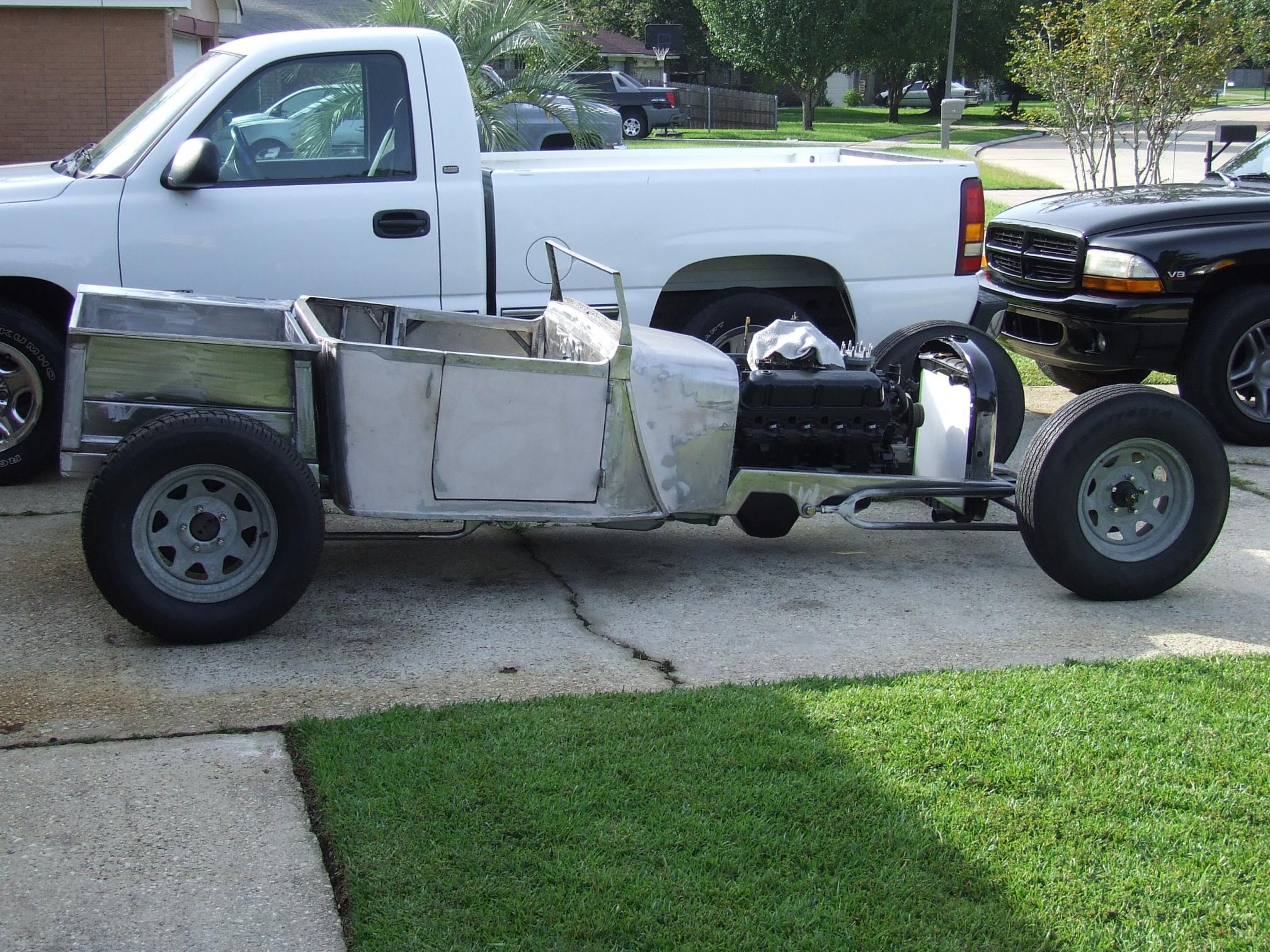

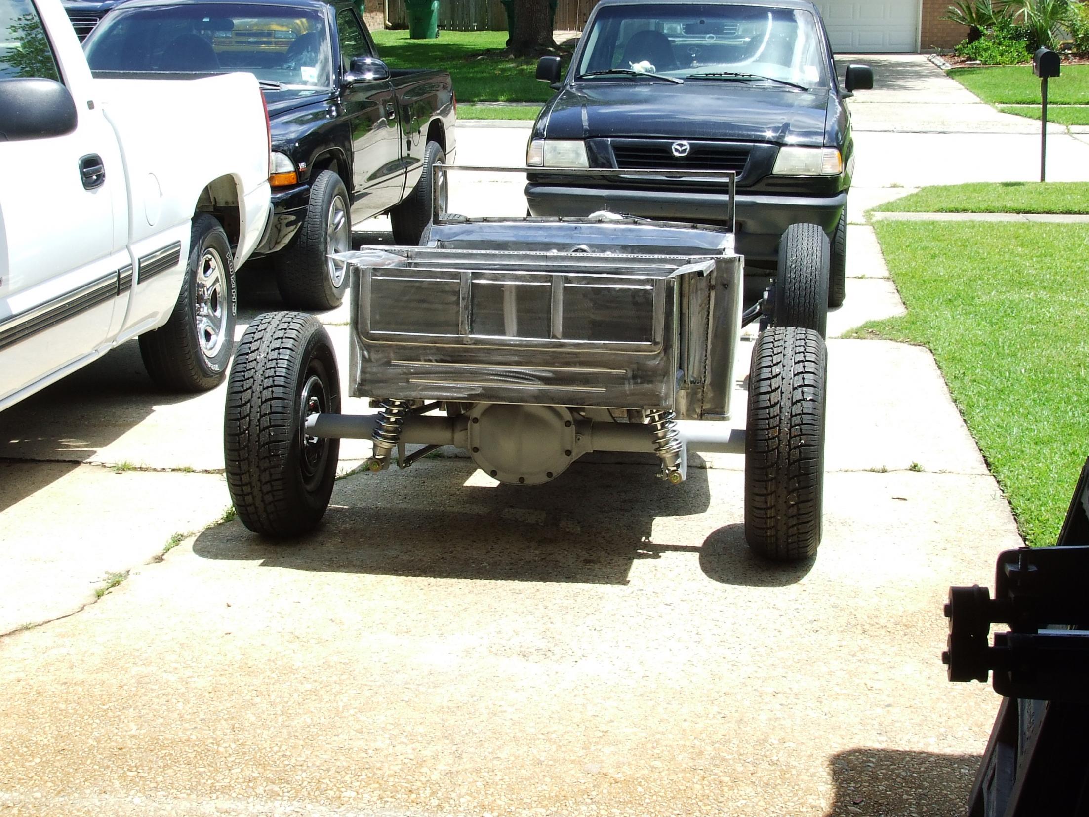

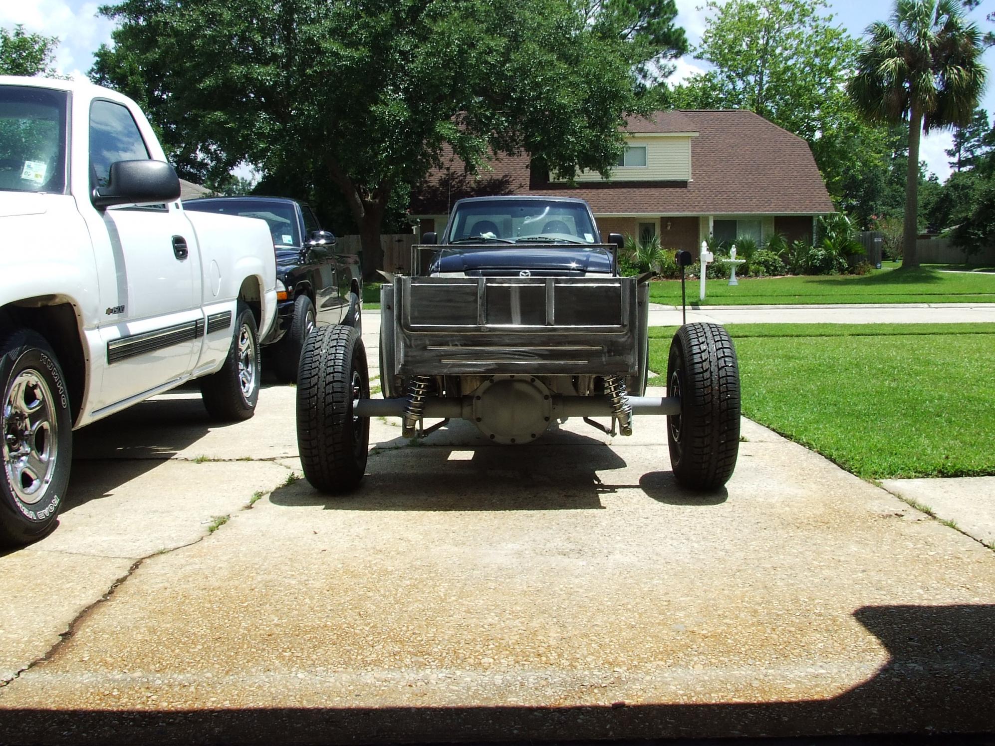

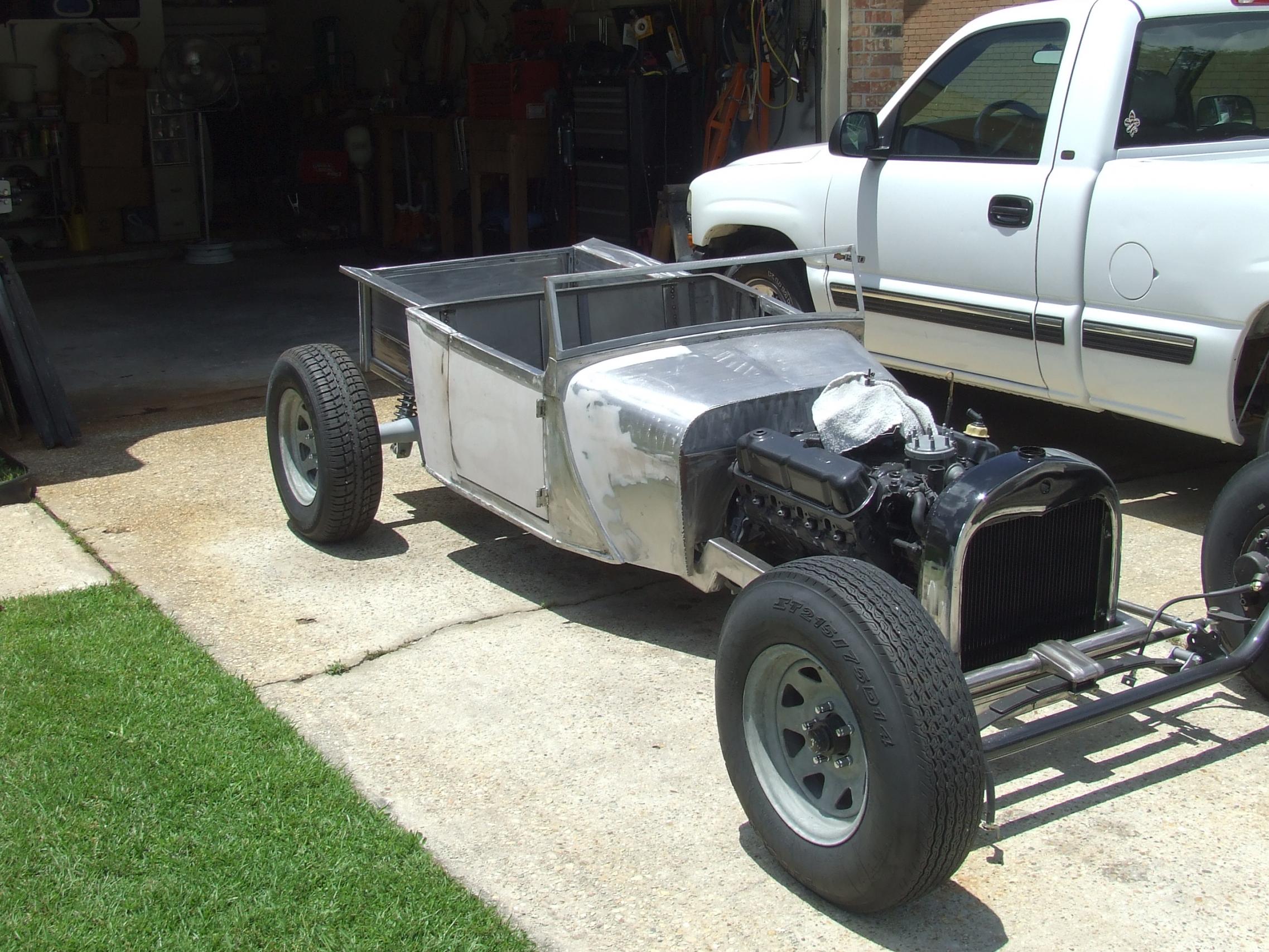

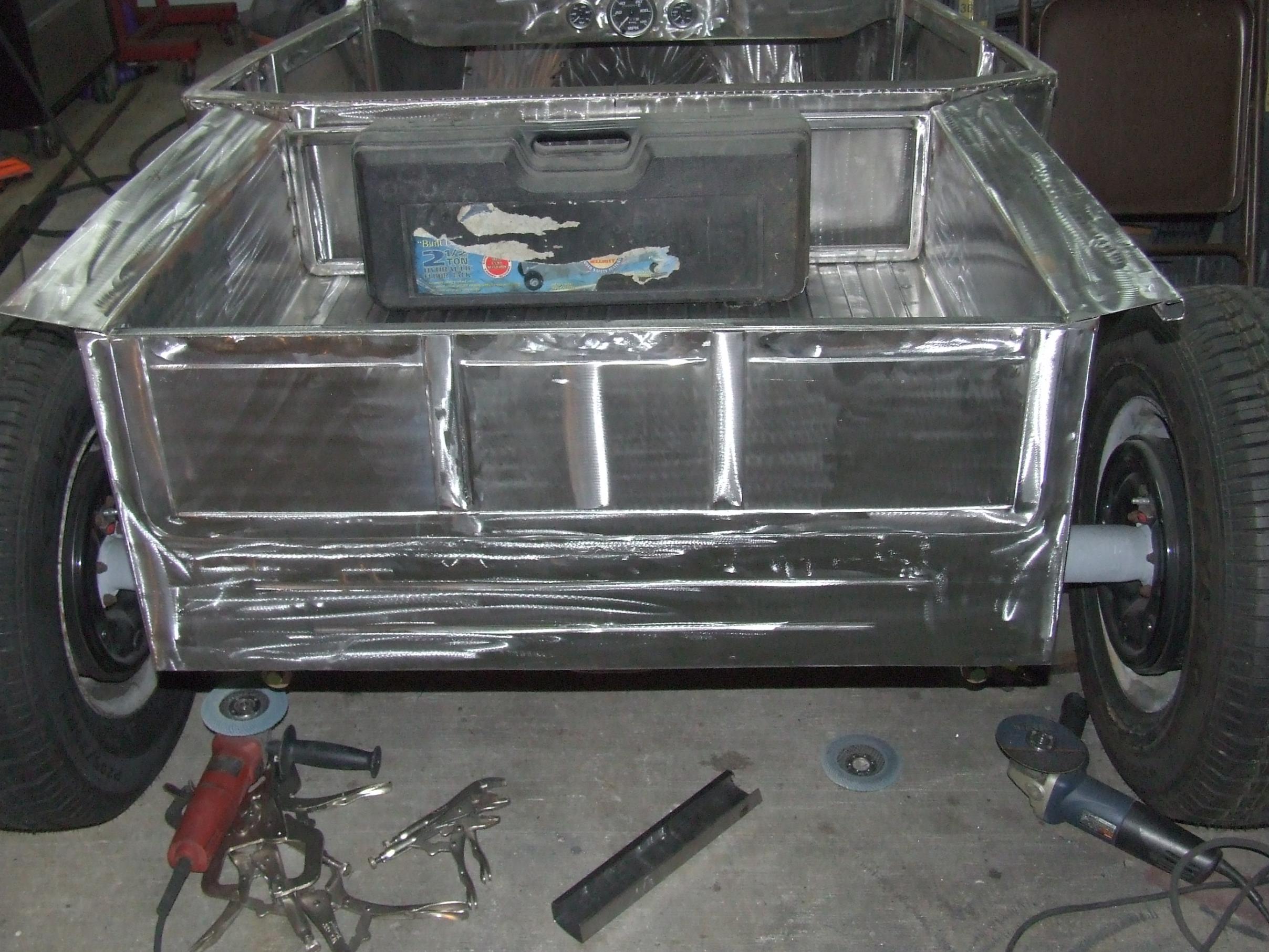

    Hey guy's had to roll the rod outside to clean the garage, had a lot grinding dust and small shards of metal on the floor. Couldn't lay on the shop floor without getting filthy so 4hours later it's fairly clean. while the rod was outside I took a few photos to kinda get a look at it's profile, what do ya'll think nothing is bolted in place so it still will need lining up! Here are some pic's.

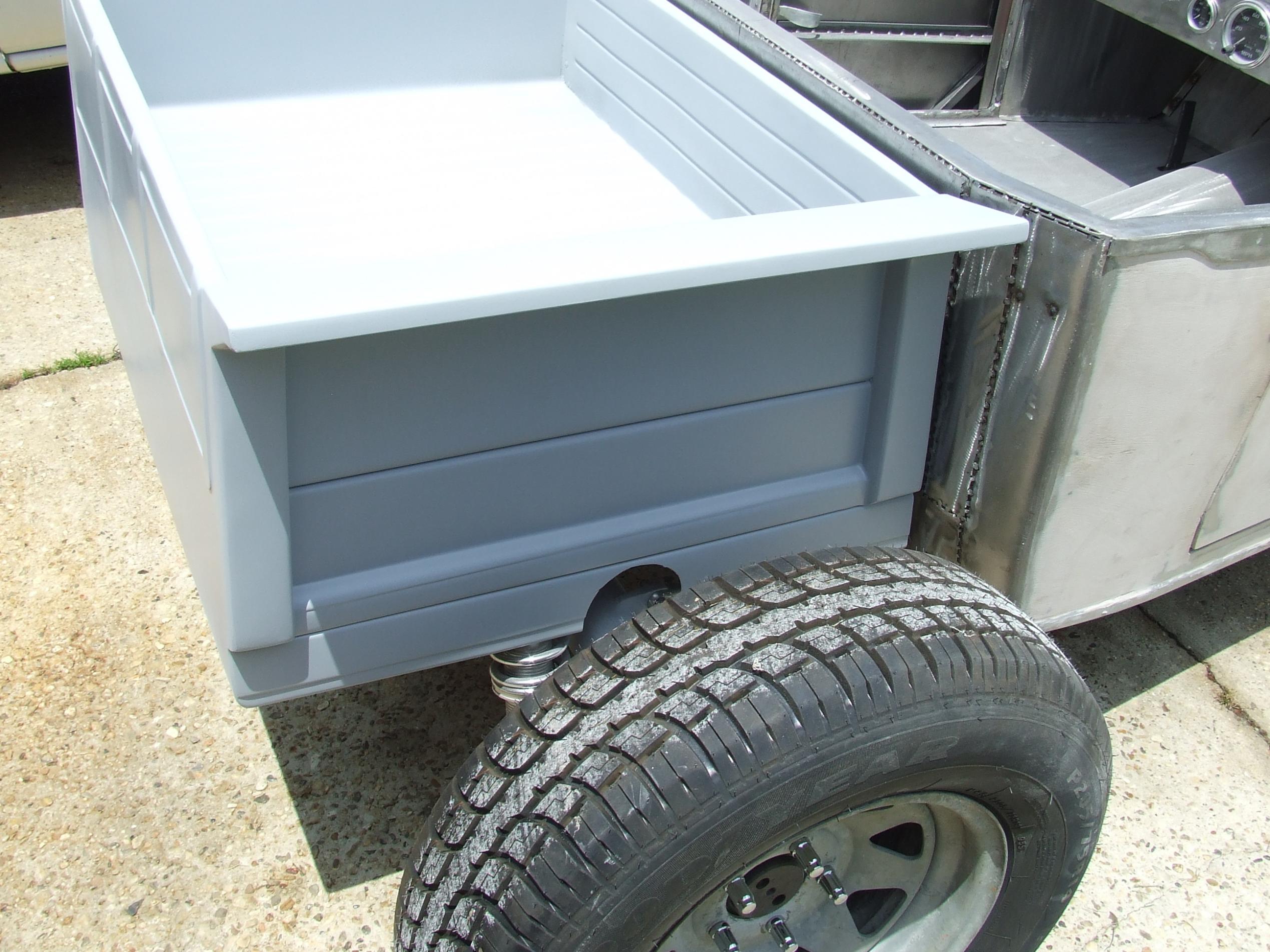

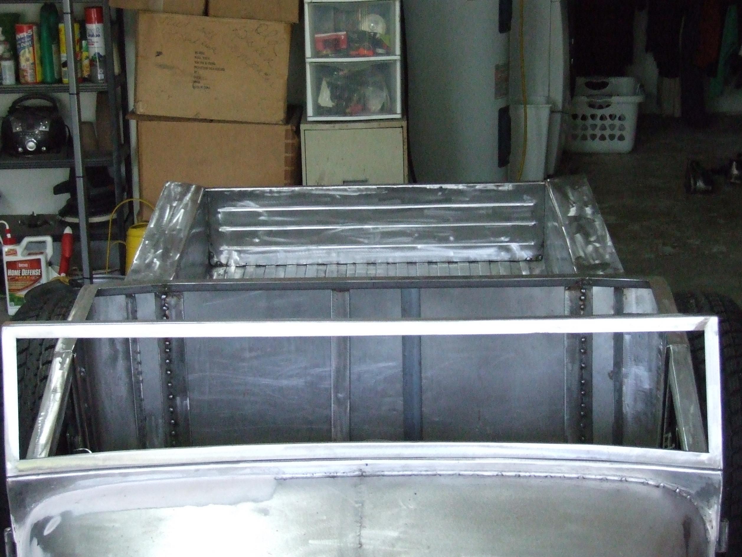

    Hey guy's, you will see that the bed is not totally finished still need to do some tidying up and may build an additional piece of splash apron on both sides in front of the rear wheel. I think there is to much frame and suspension showing. Also I think it needs to taper to the finished bottom of the rear body where the bed meets the cab. The back looks to boxed so I think I will round the rear bottom corners. I intend to install small reverse lights at the bottom edge left and right under or next to the beads I rolled into the body. Have to be careful not to let the lights protrude to far inward so as not to interfere with the fuel tank. I purchased some 1/2" round bar to fab some swan necks to mount the taillights which will be 29 ford pickup lights.

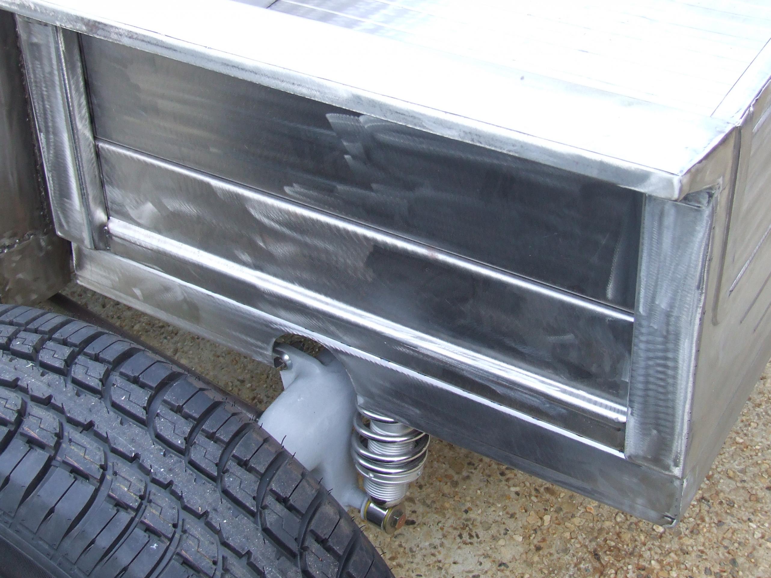

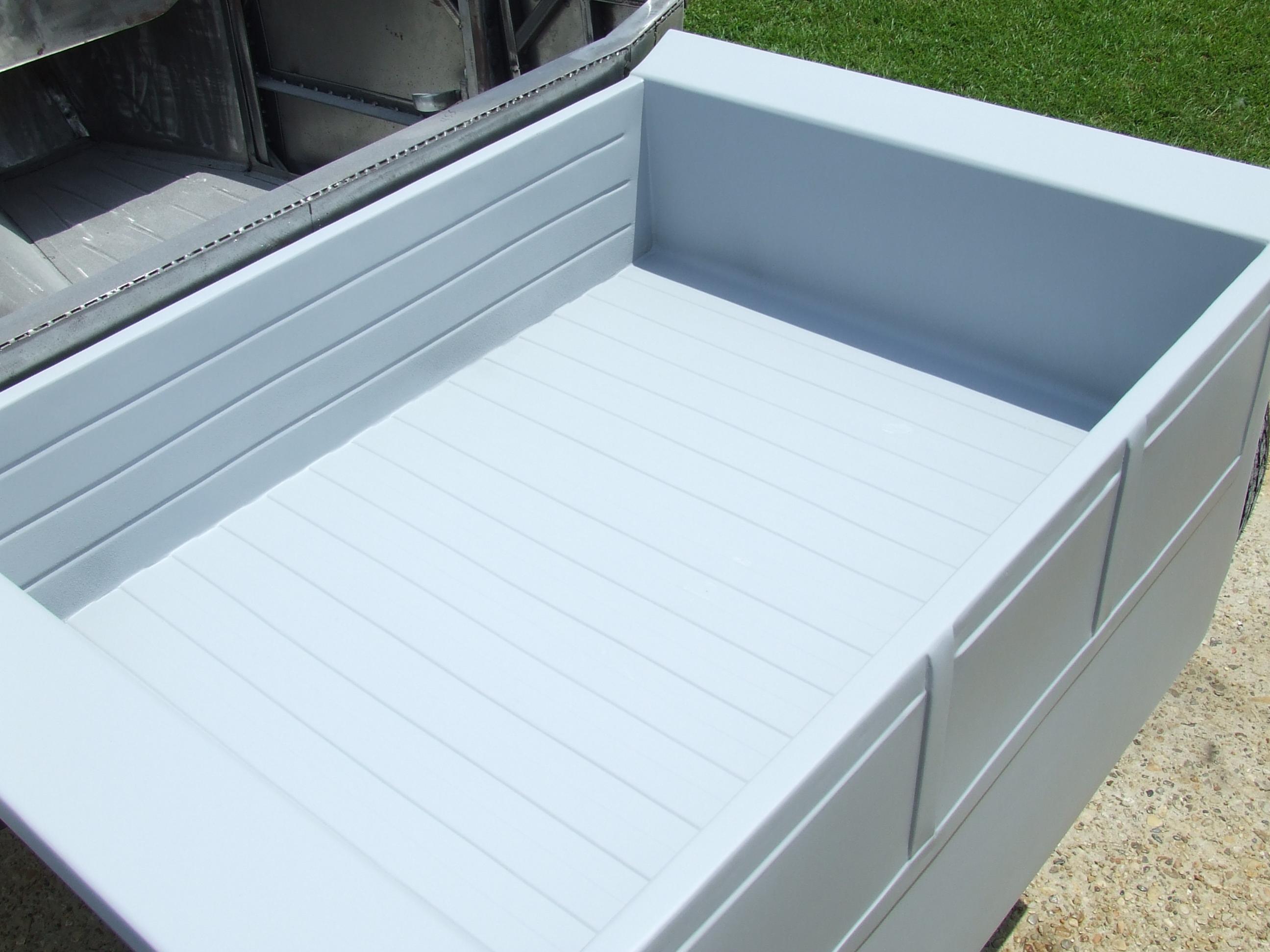

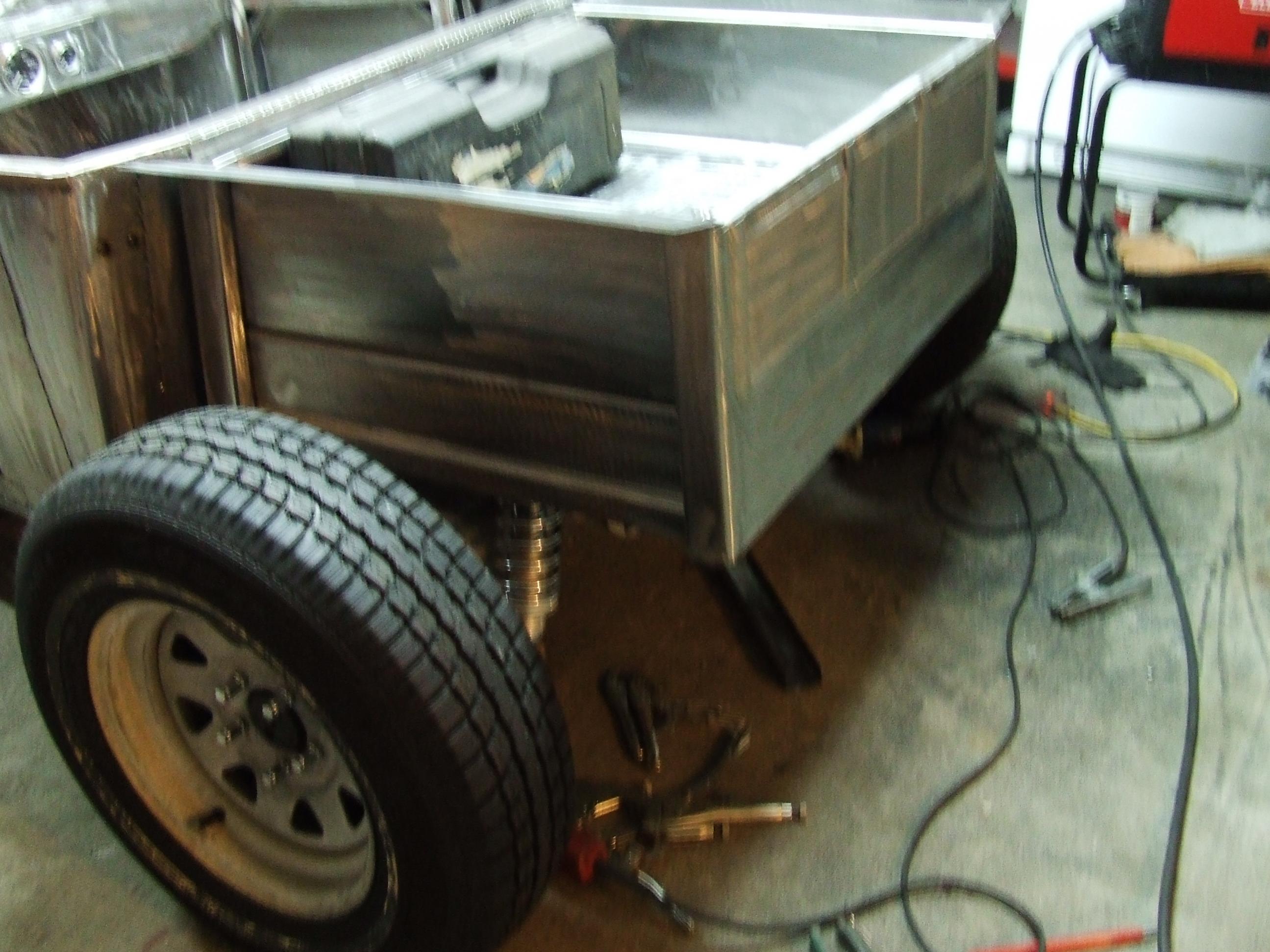

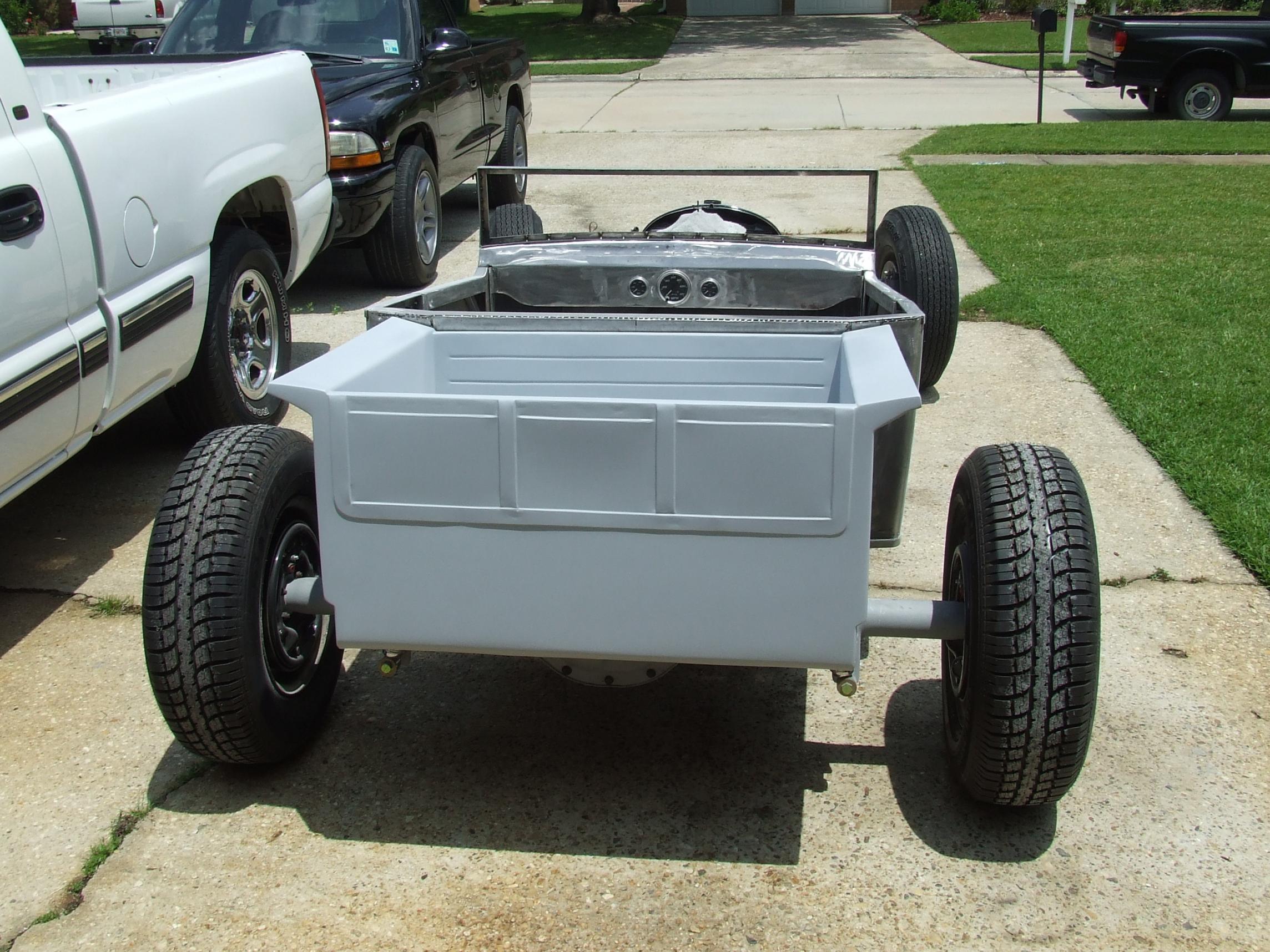

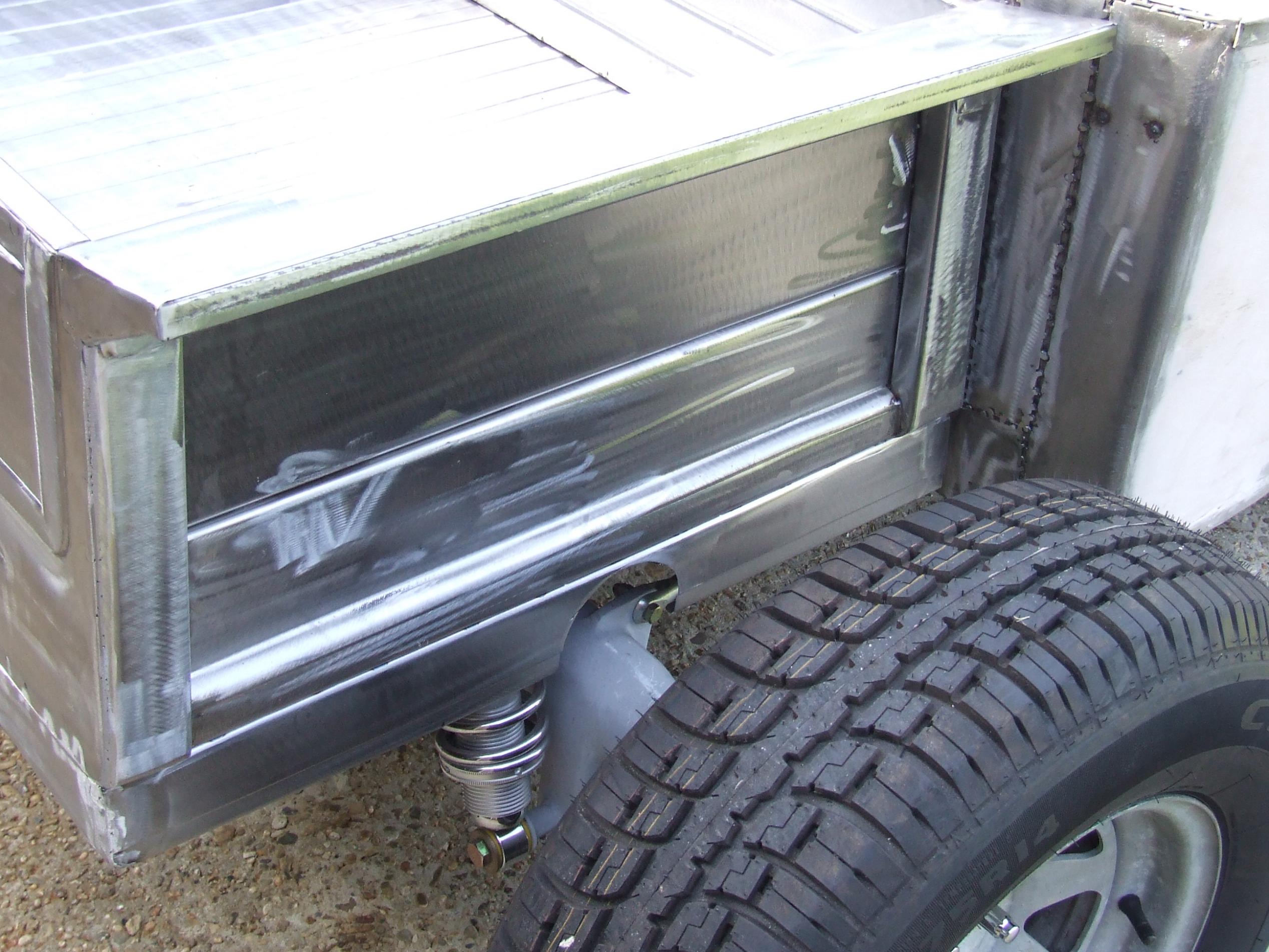

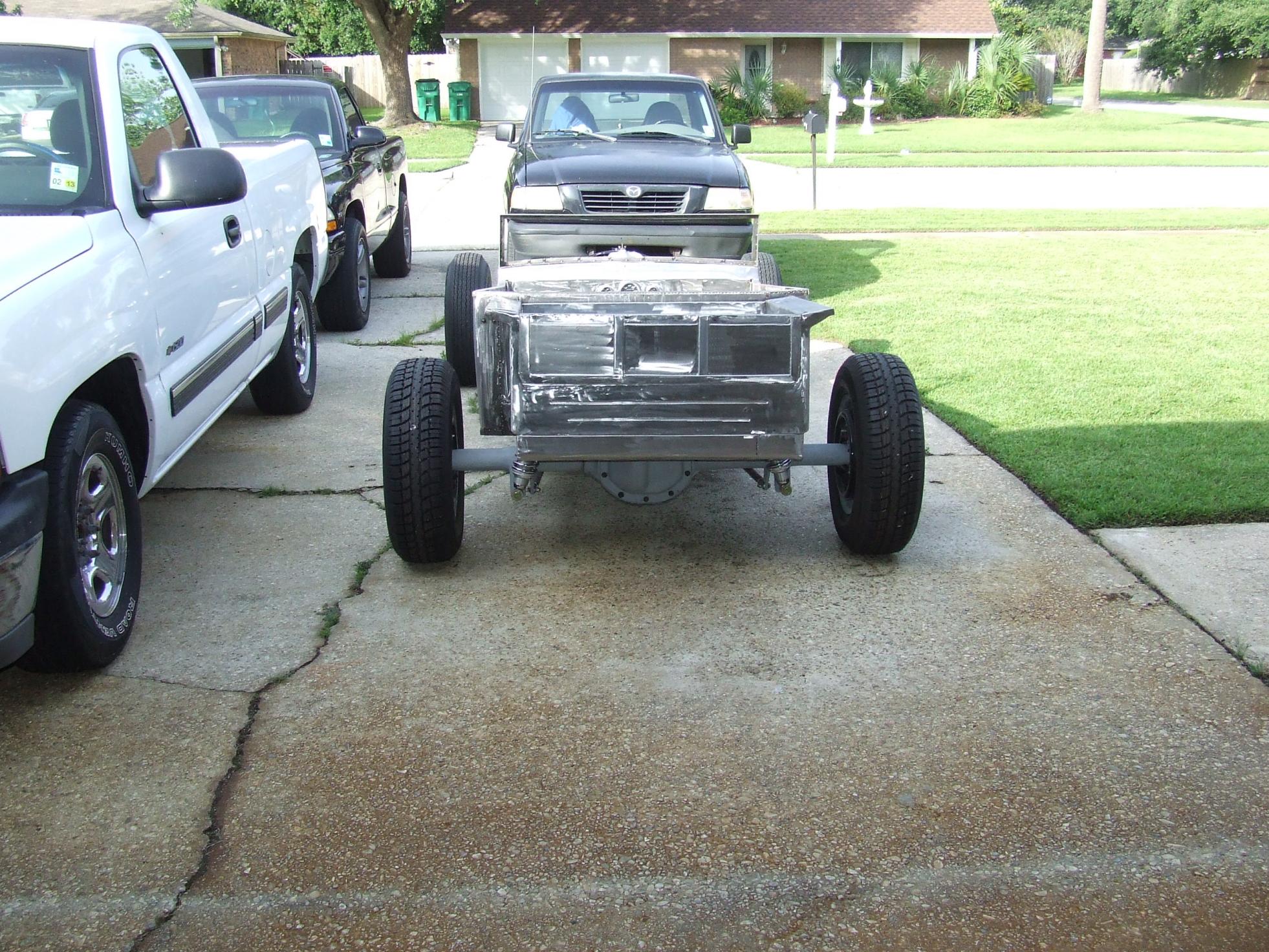

    Hey guy's had time to work on the rod. I finished the bed, I bent the extensions for the side splash left and right. will weld them on monday night. So here are some pic's.

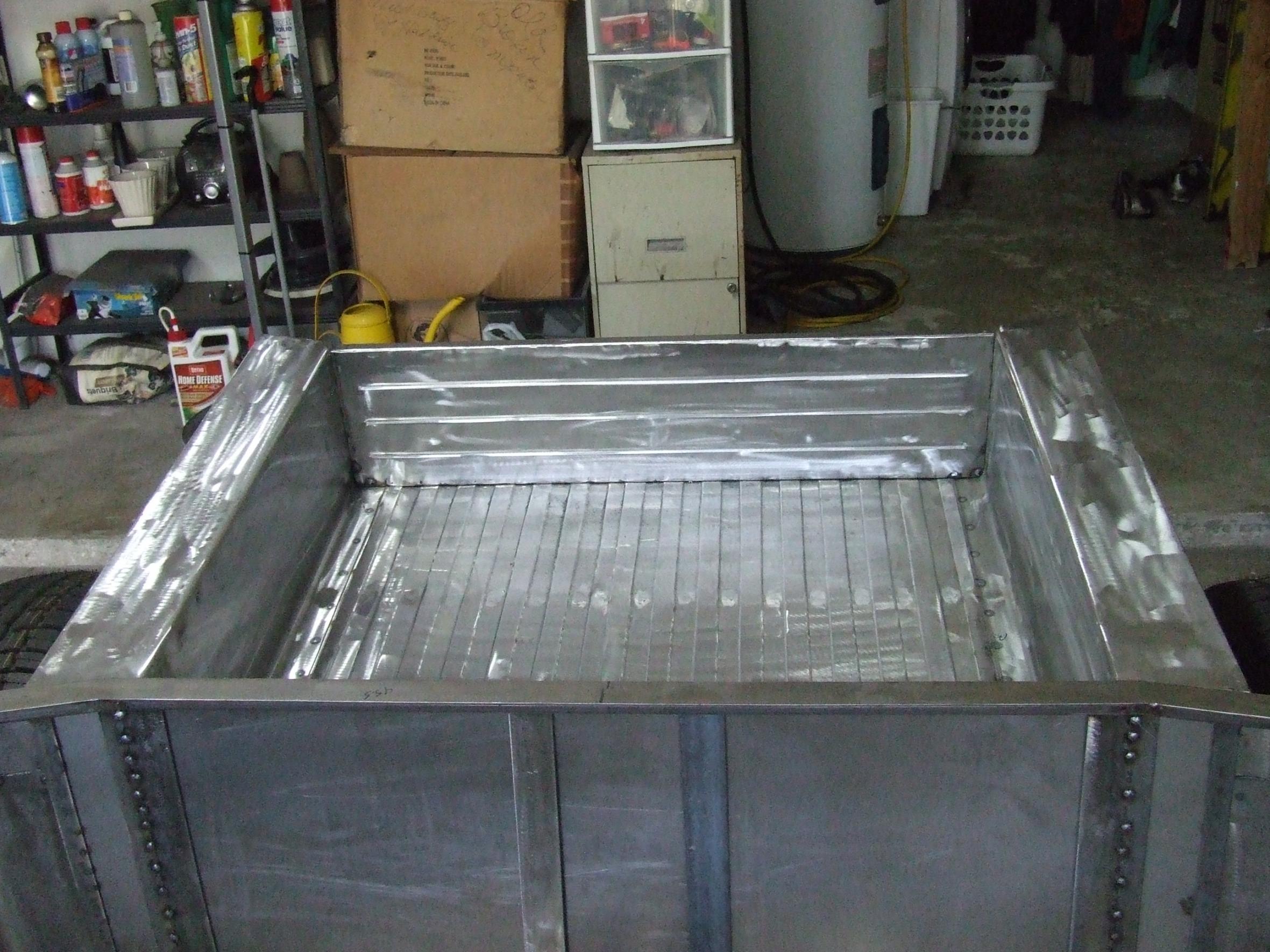

    Okay! Got the bed completed with the splash aprons and cutouts for rearend travel. Now its time to take the cab and bed as well as the grille shell off and do all the body work and then prime. Here are some pic's. Remember nothing is bolted down every thing was bolted and aligned. I should have taken pic's but didn't think about it while it was all bolted up. Guess I need to start thinking about what color or colors I want to paint it.

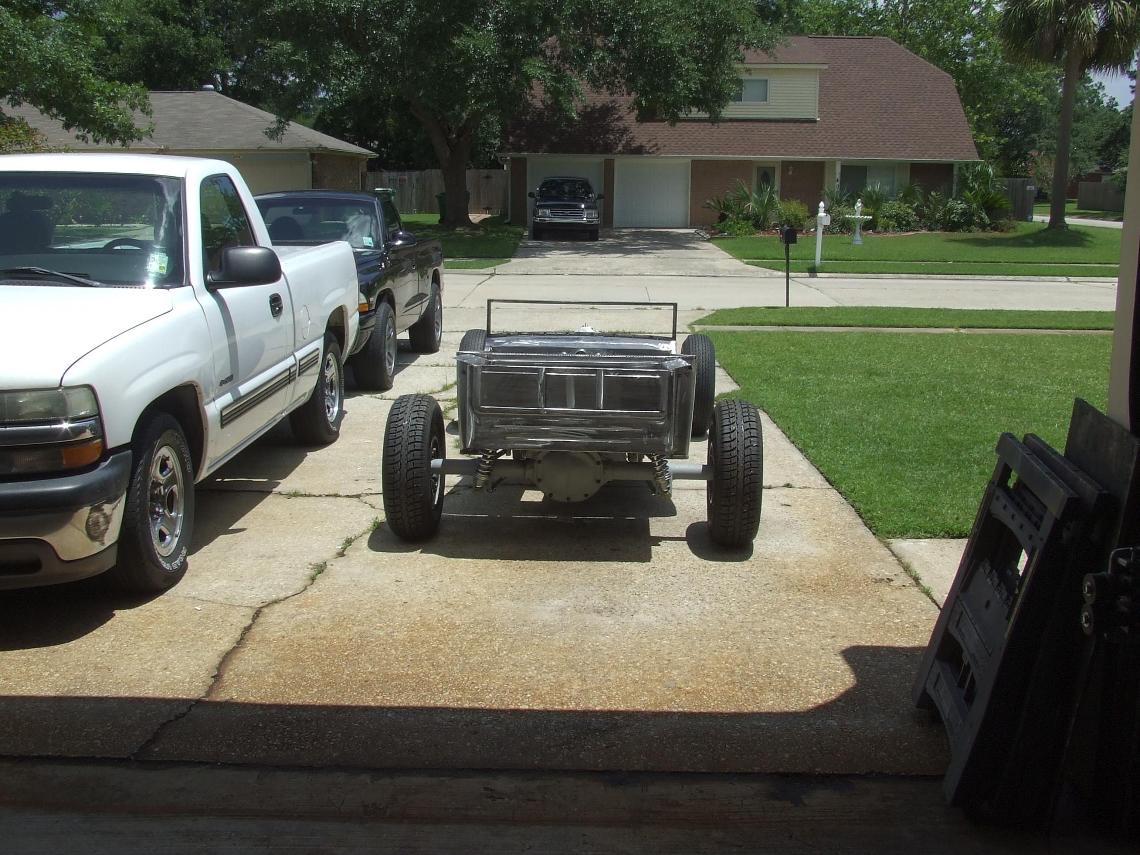

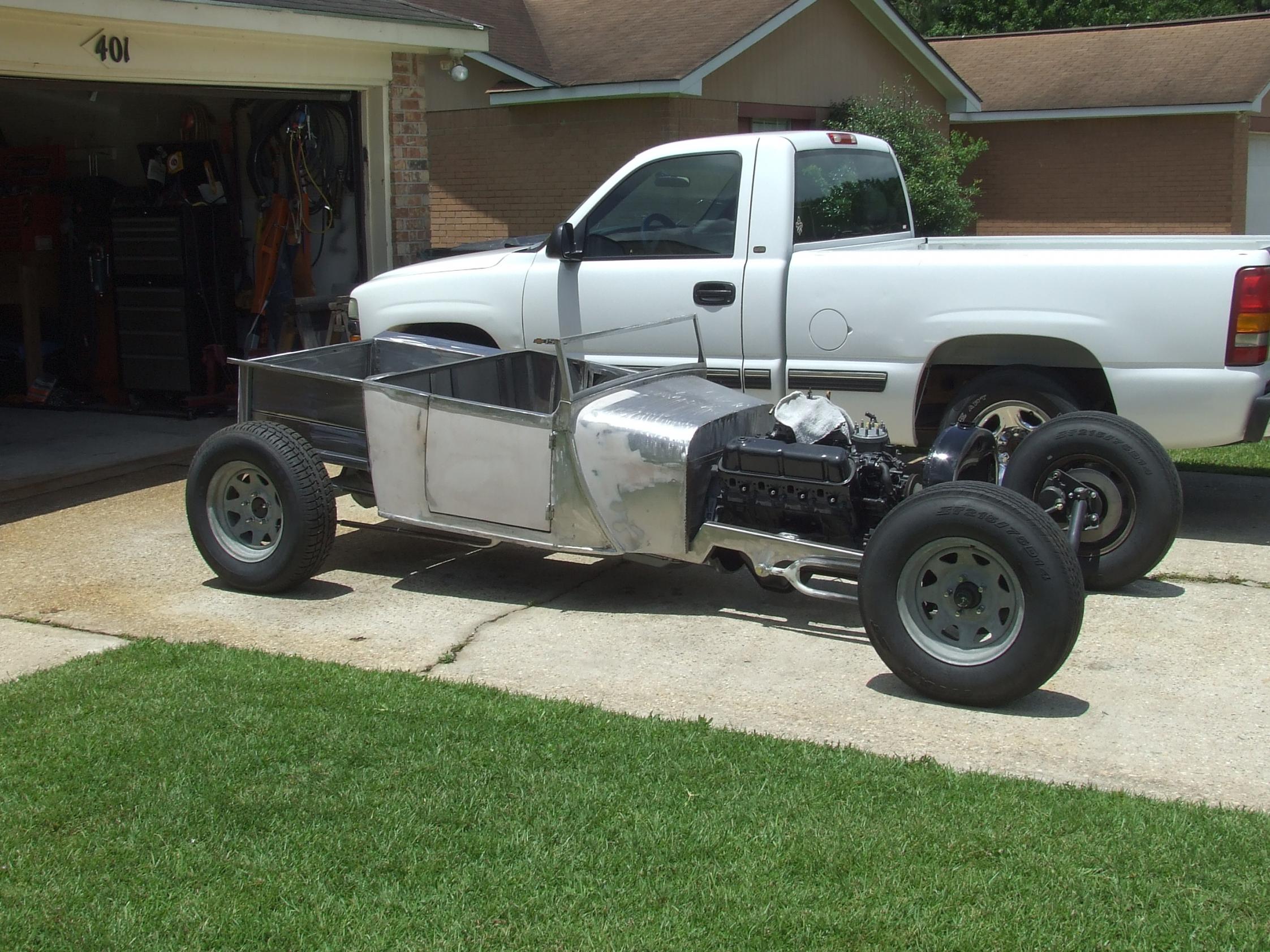

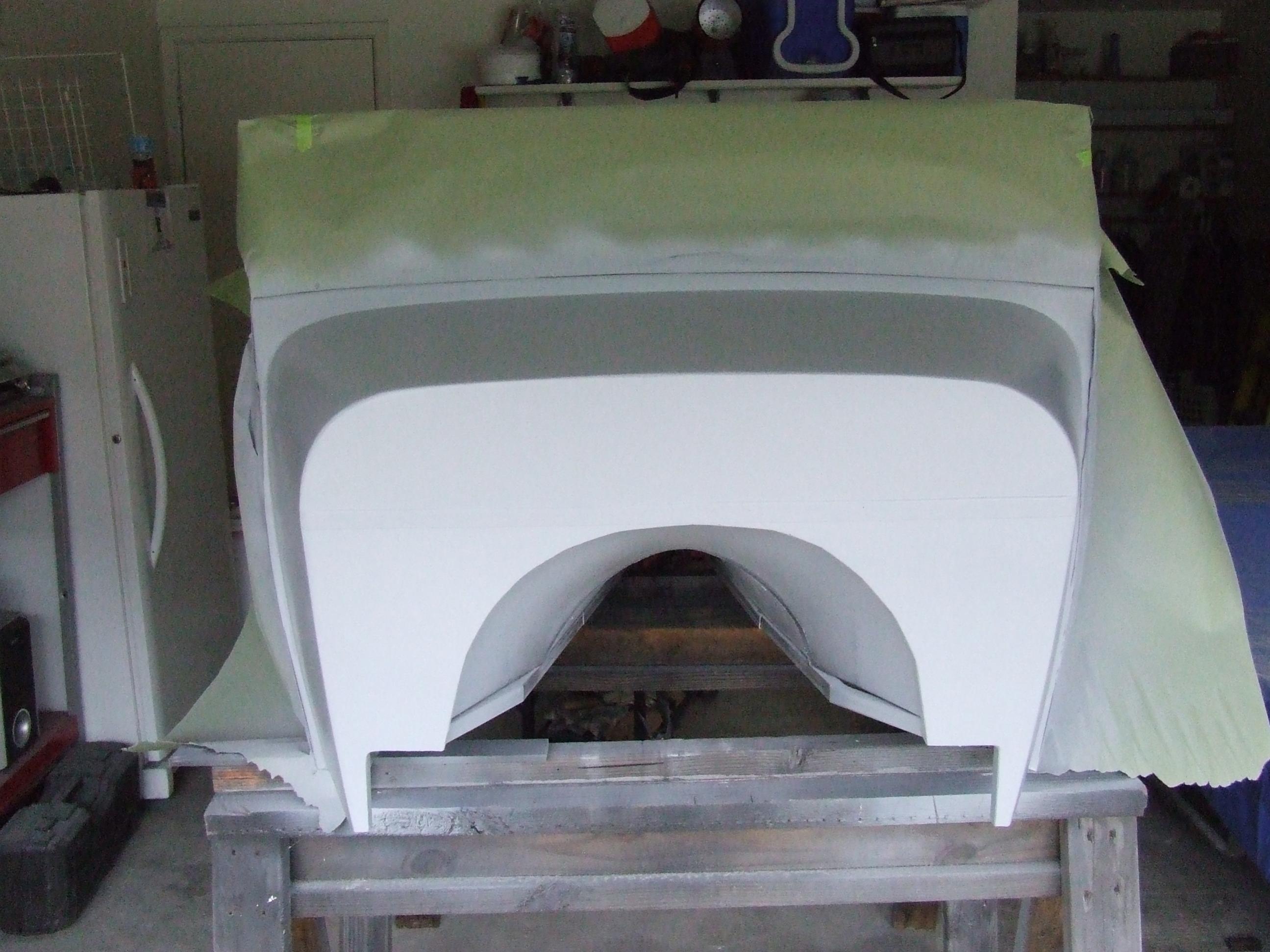

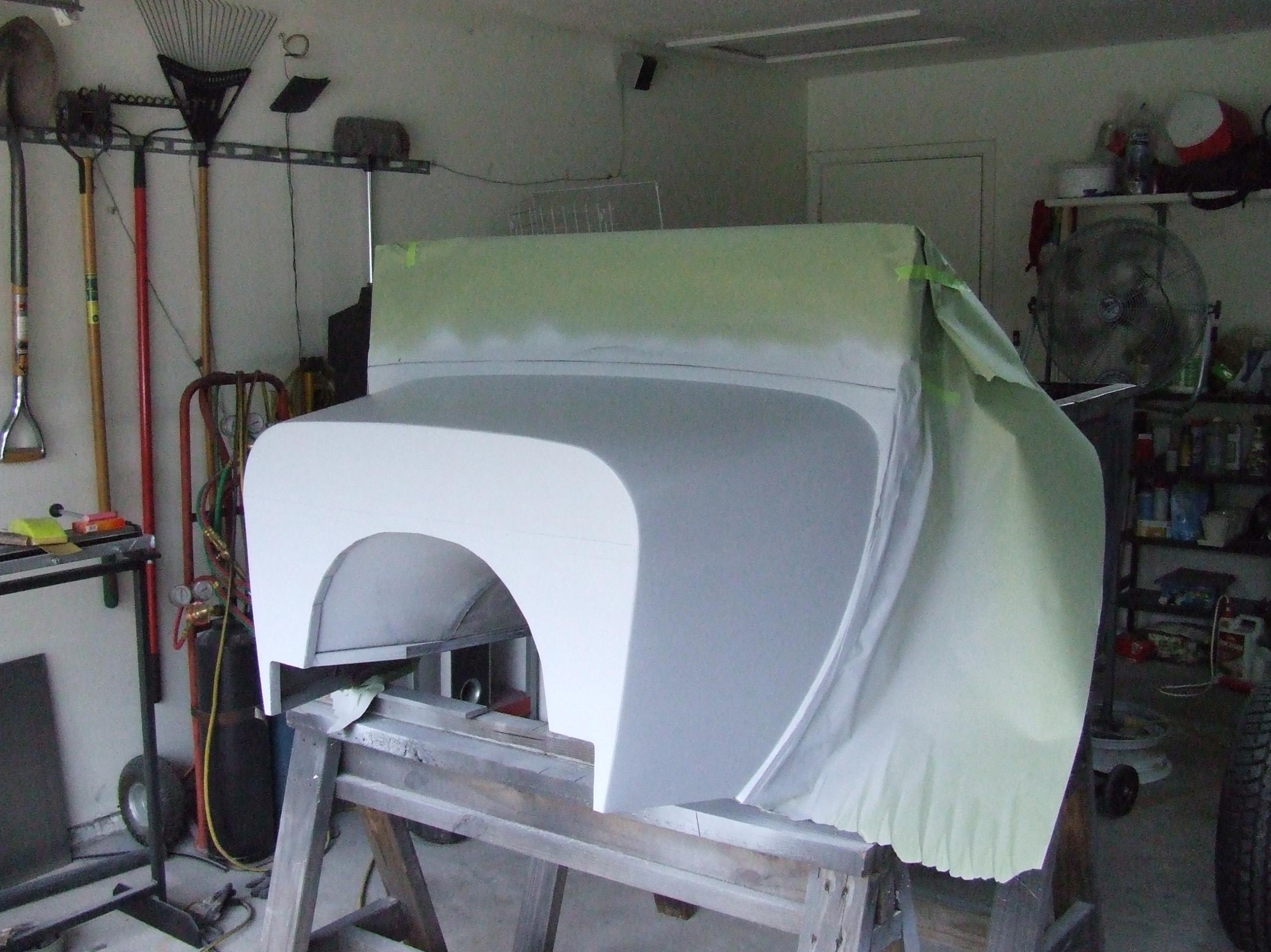

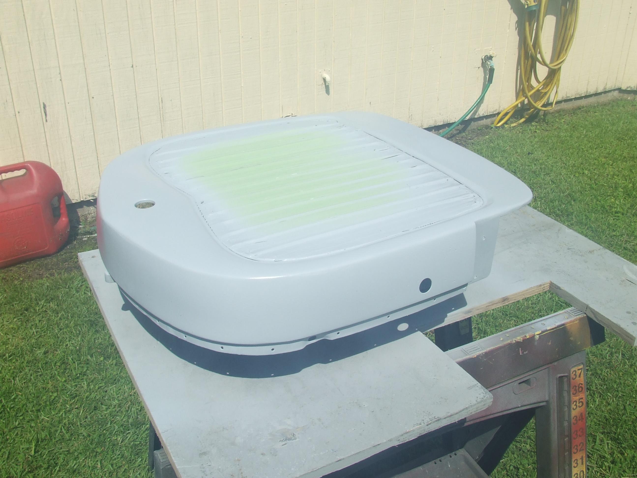

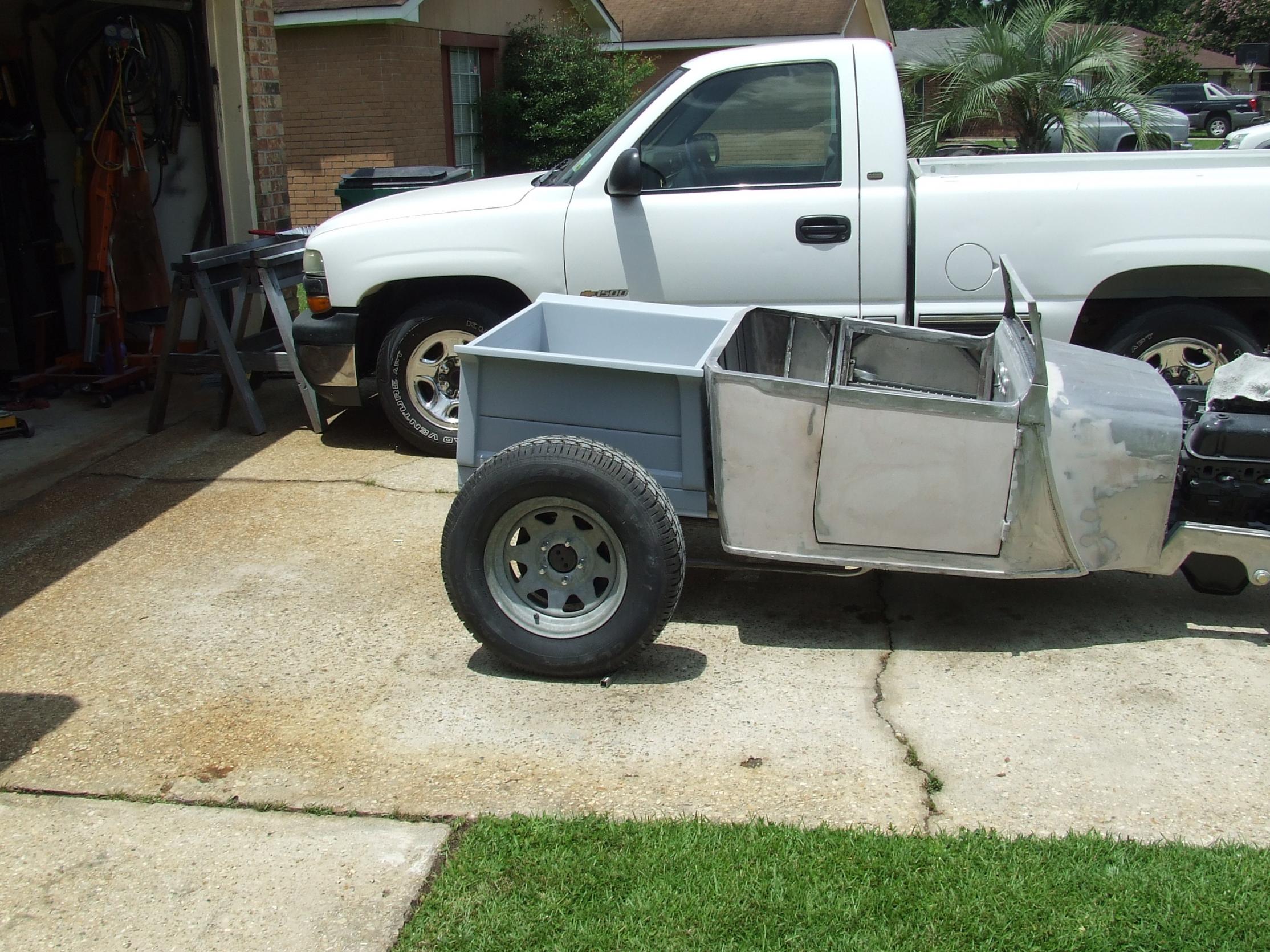

    Okay, charged batteries and moved the rod outside to clean the garage! So while it was outside I blew it off as it was very dusty from doing the body work on the bed. I have limited space and was to dumb to cover the rod. Well while the rod was outside I took some pic's here they are. Will start work on the cab and grille next.

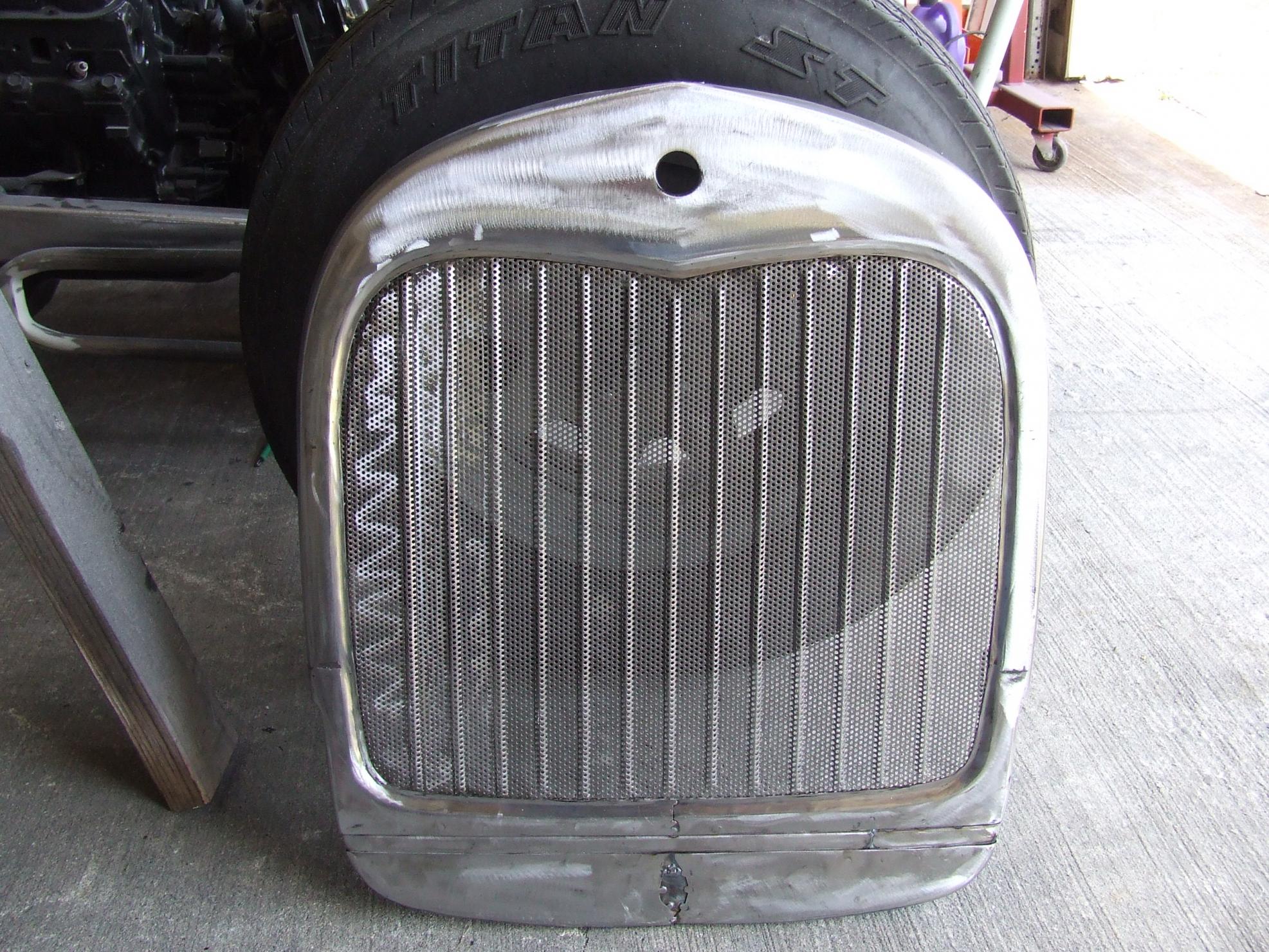

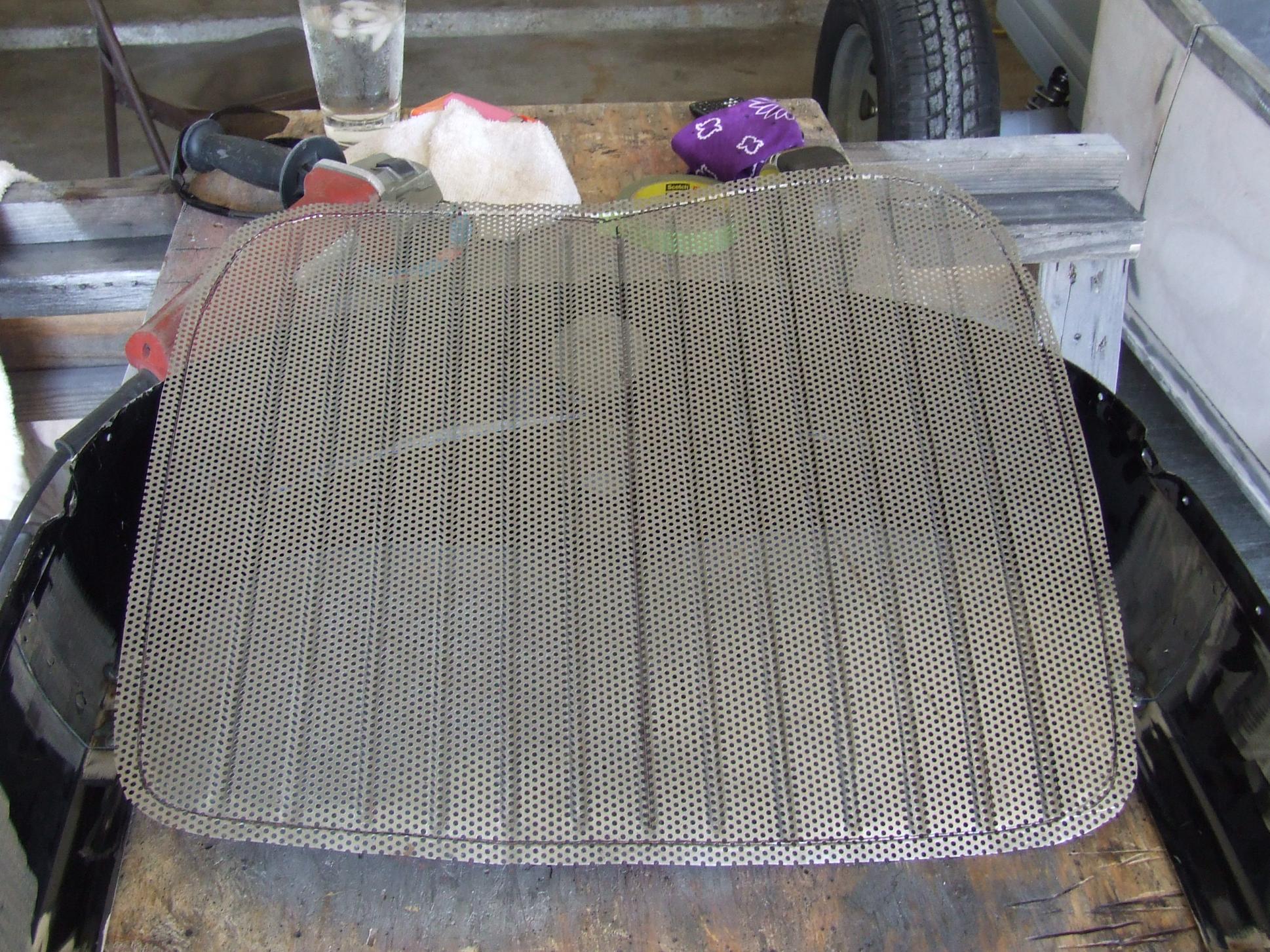

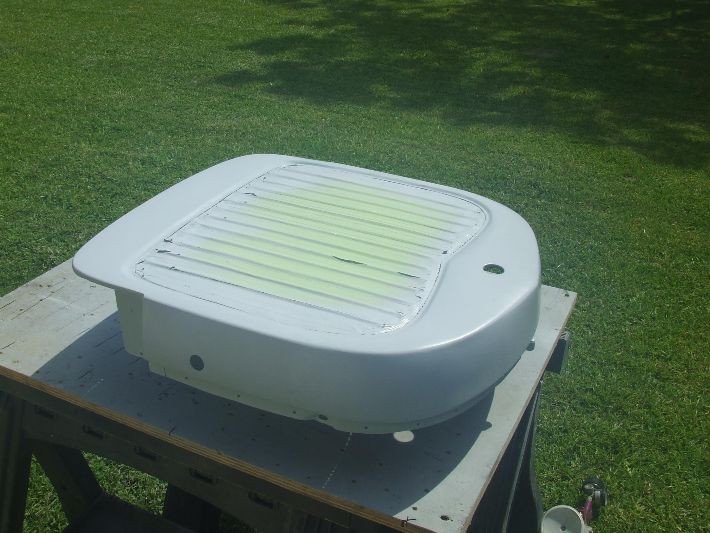

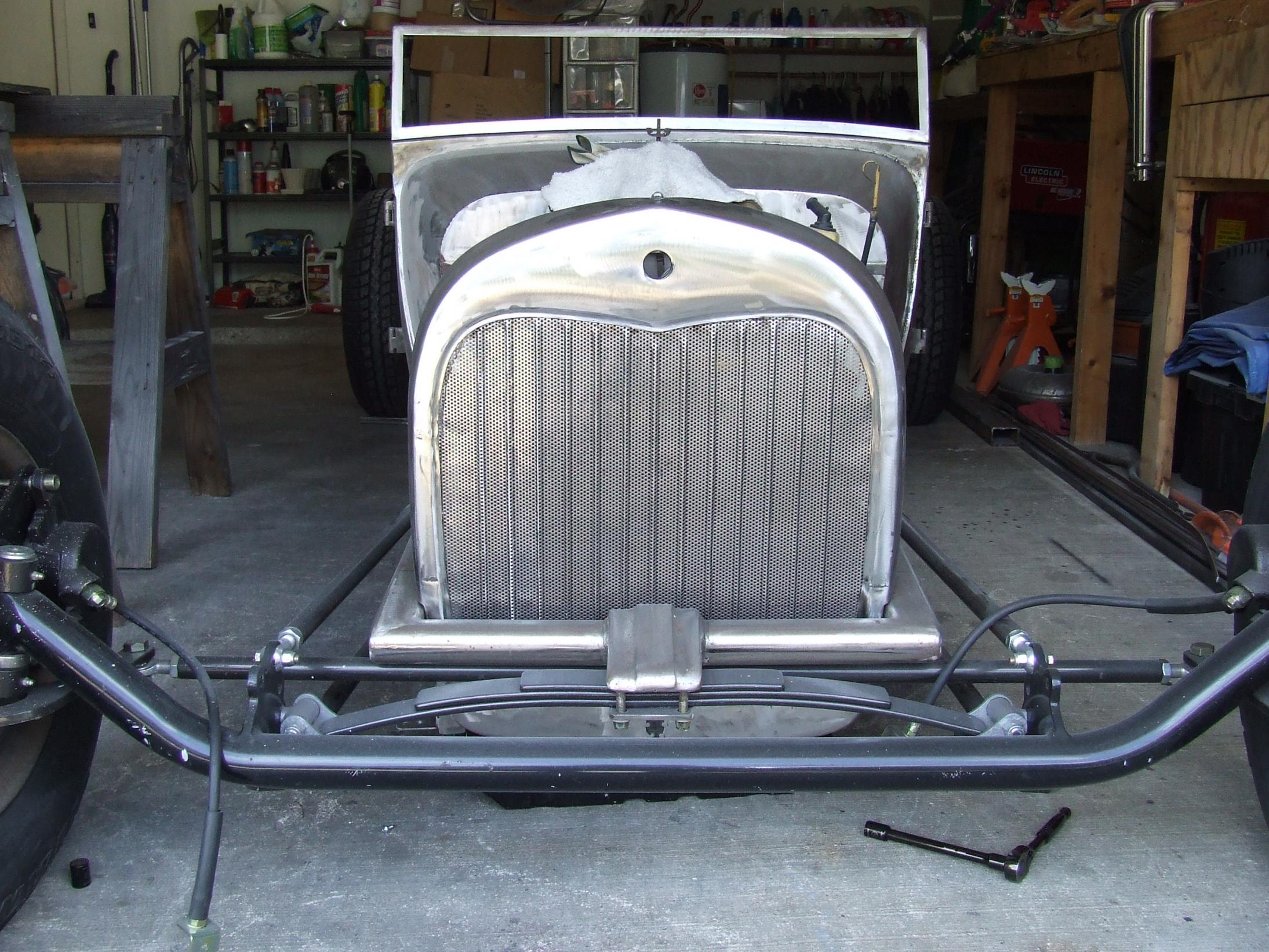

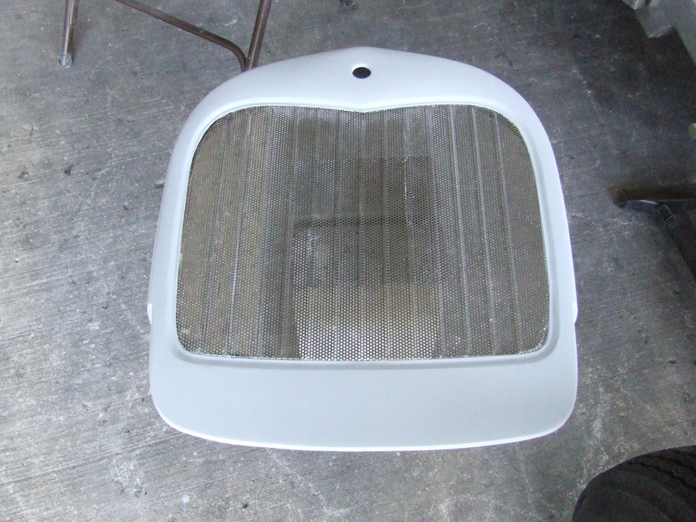

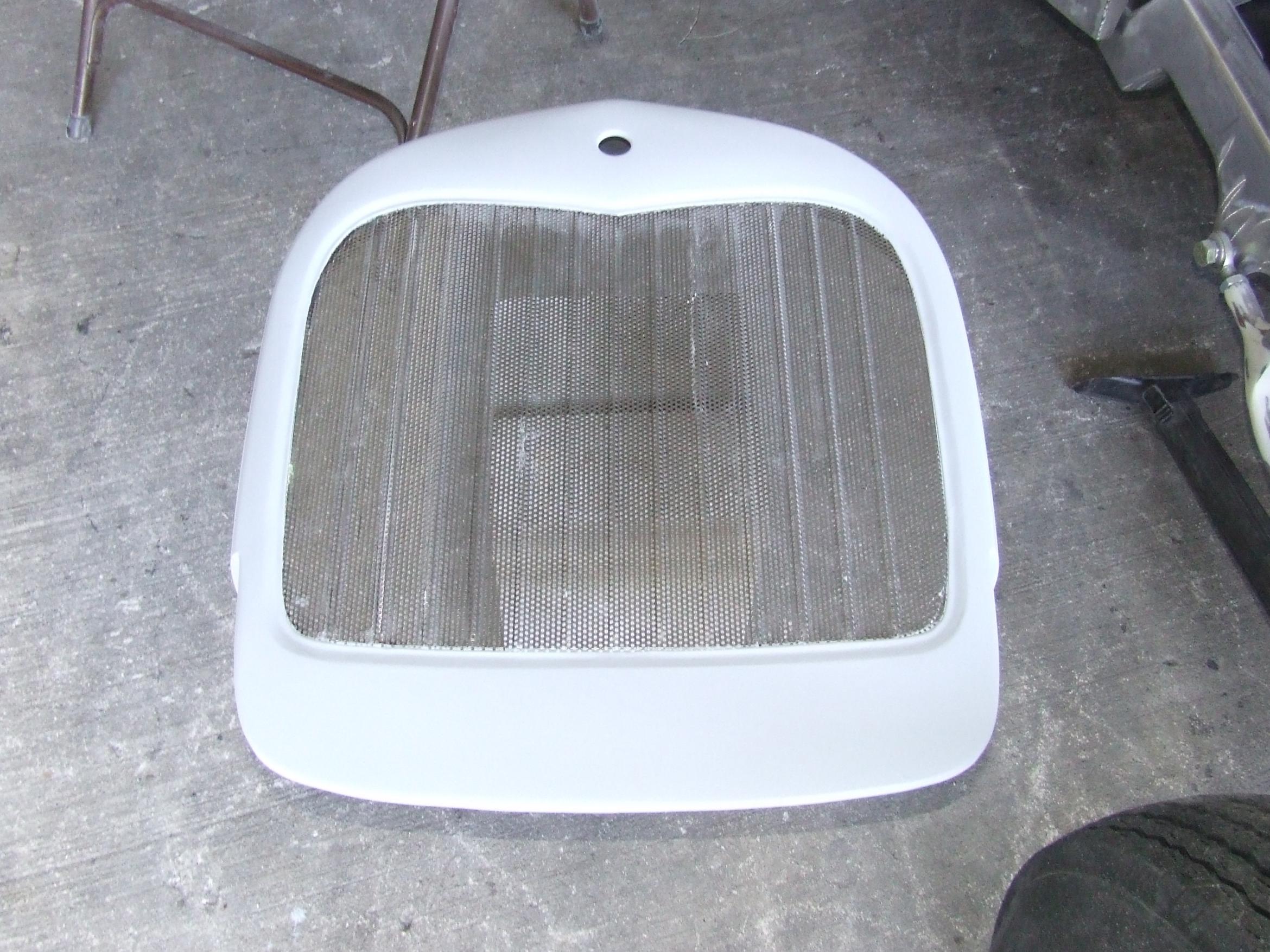

    Hey guys, today I worked on the grille shell and grille insert. I made the grille insert yesterday and welded it in today then did all the body work and primed it. Here are the pic's. I don't know what happened pic's didn't load so I reloaded them below.

    Did you make the grill shell too? I missed that part if you talked about it.
  21. cryptkepper
    Joined: Feb 29, 2012
    Posts: 155
    cryptkepper
    from louisanna
    No it's a speedway item it was cheaper than me taking the time to make it. I did have to section and chop it to make it fit and flow with the rest of the body. I did the body work and primed and blocked it and did the final prime today.

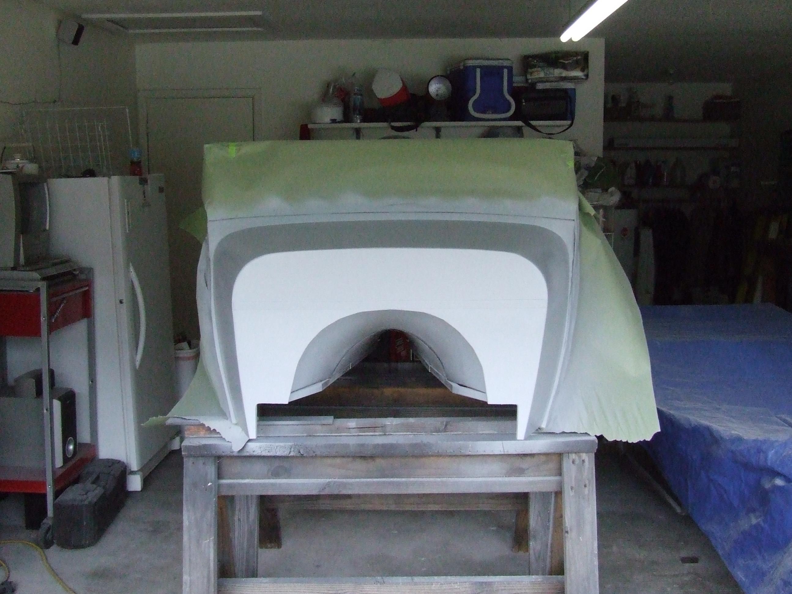

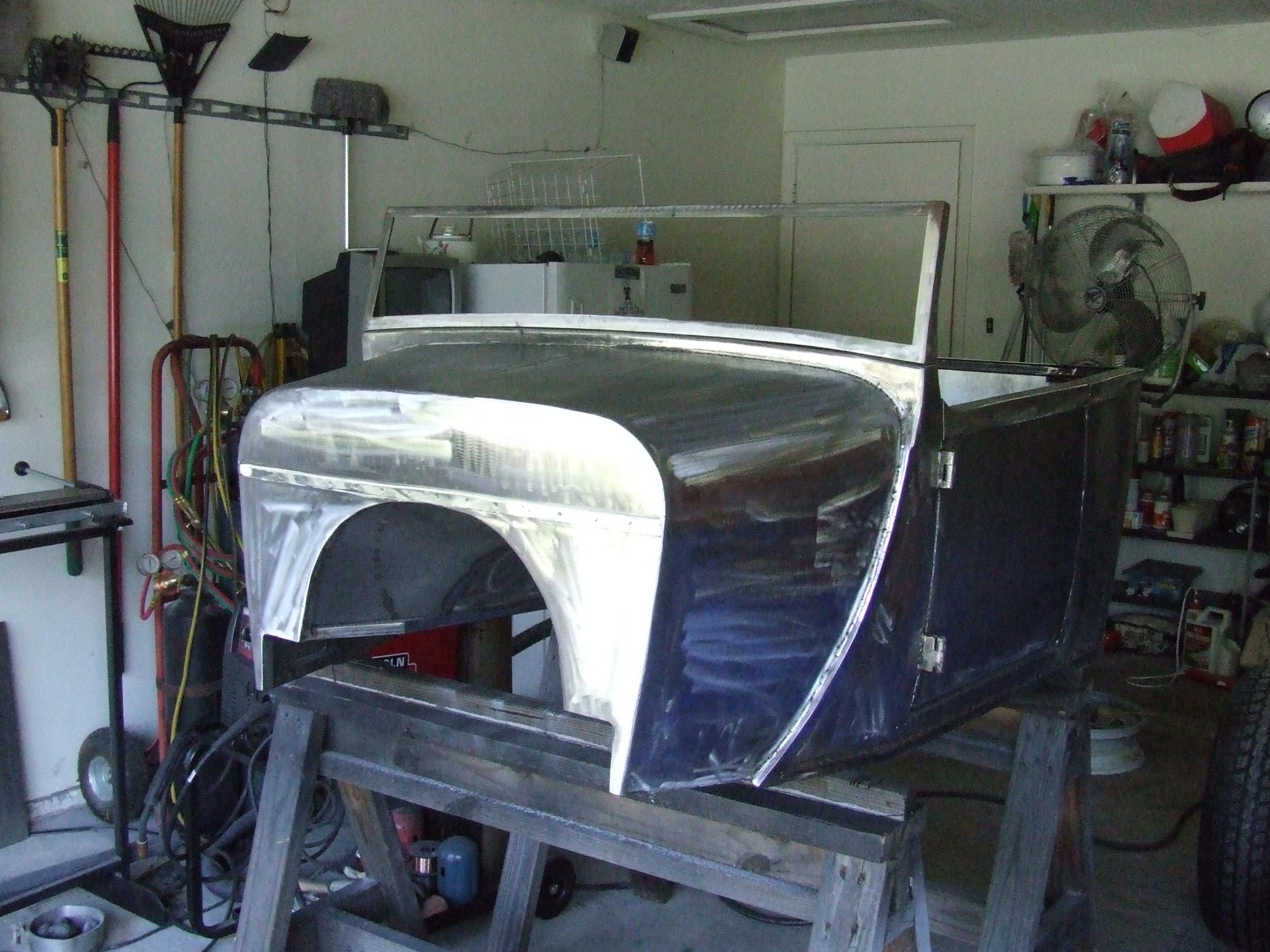

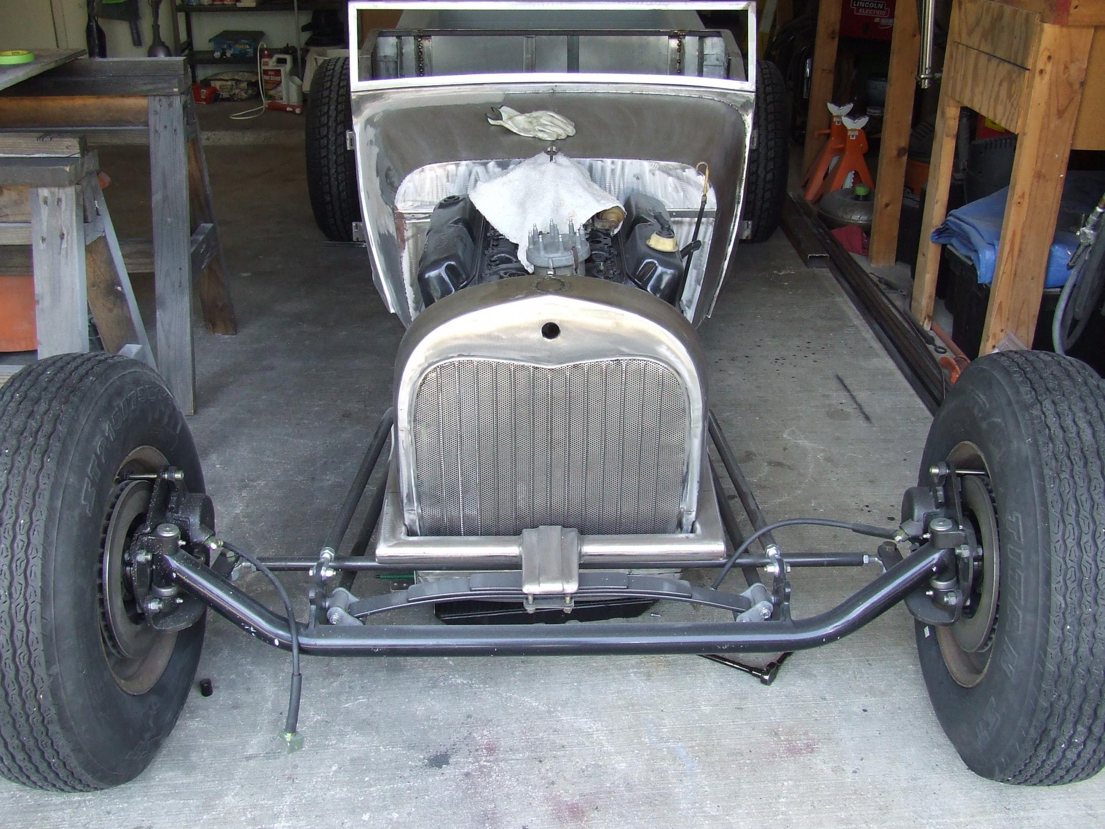

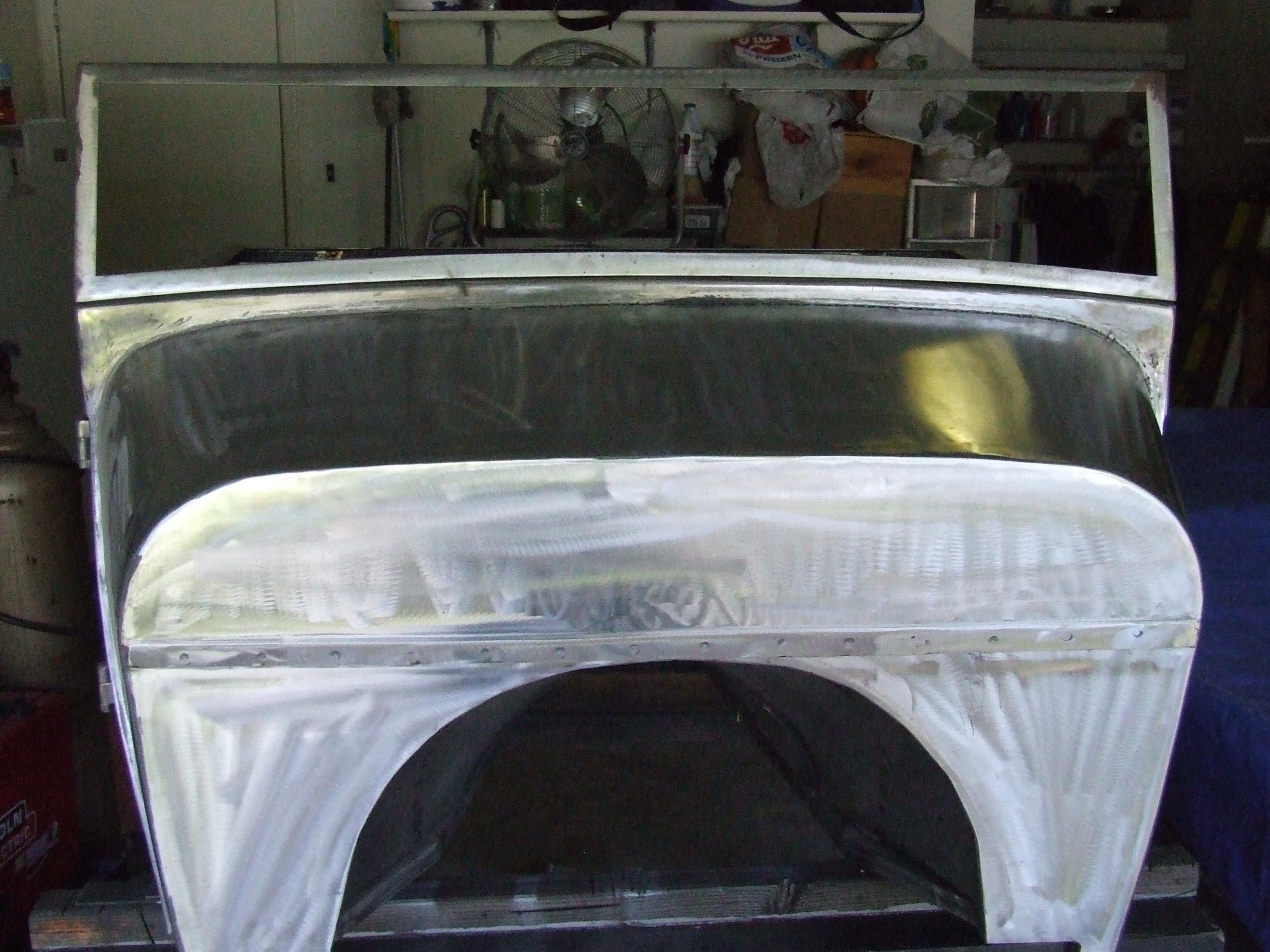

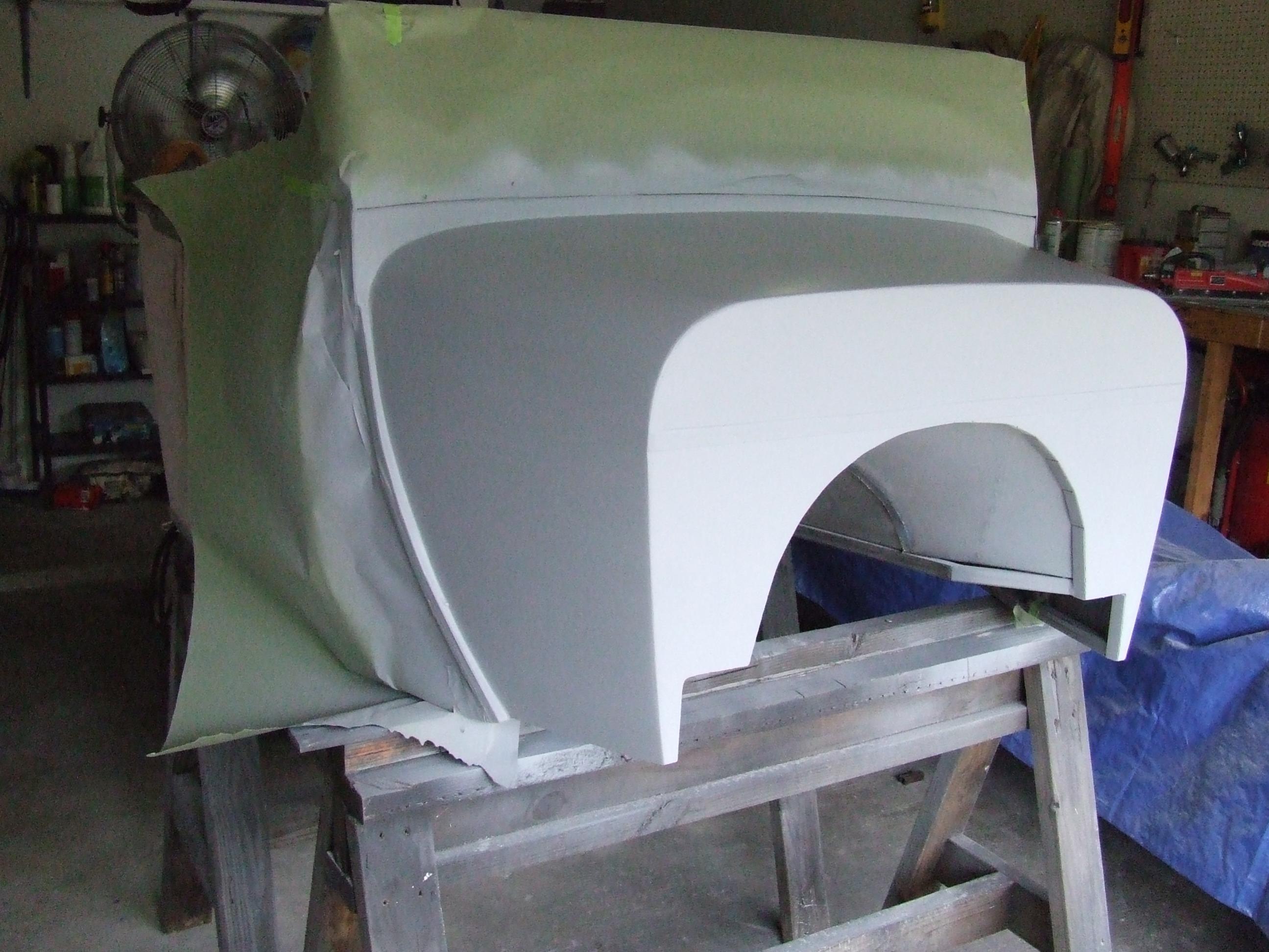

    This afternoon I was able to remove the cab and weld the edge where the cowl meets the fire wall with that complete I ground down the weld to blend from fire wall to cowl. Here are some pic's.

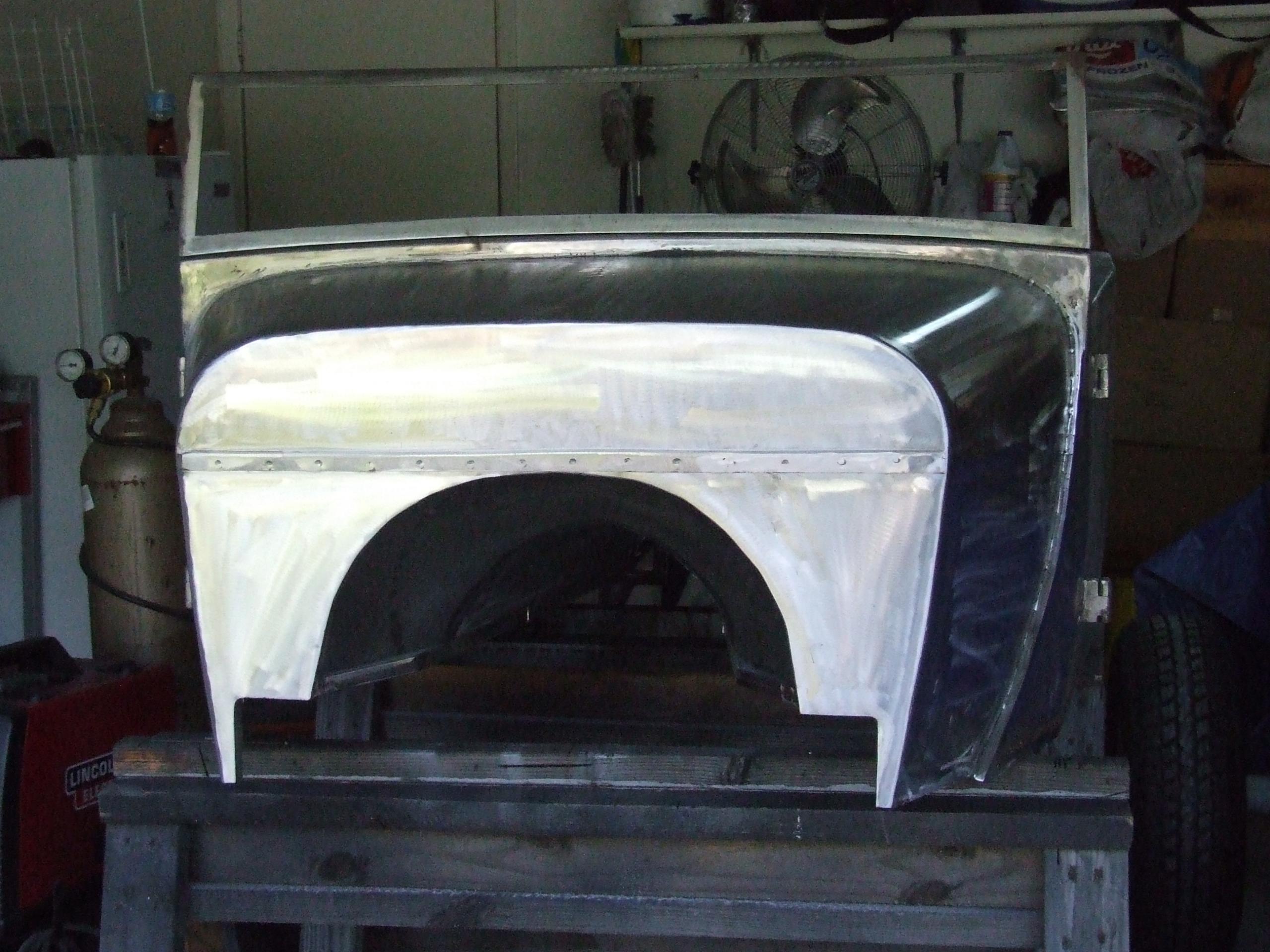

    Hey guy's had time to work on the rod this afternoon and started doing the body work on the cowl went pretty quick didn't need much filler. After I was satisfied with the body work I went ahead and primed it. I primed it because I sweat a lot and didn't want to contaminate the body work while working on the rest of the body. Here a few pic's.

    Looks good man really good. Make sure to put some paint on it soon primer will make stuff rust just as fast.

    thanks, I won't have a problem with rust I don't use rattle can primer. I use PPG products and have never had a problem with it. The body has been metal prepped prior to any filler and or paint as well as seam sealed. The body and frame will all be final blocked and sealed with DP90 an epoxy sealer. When I do paint it I will final water sand it and then spray it with color and clear.
