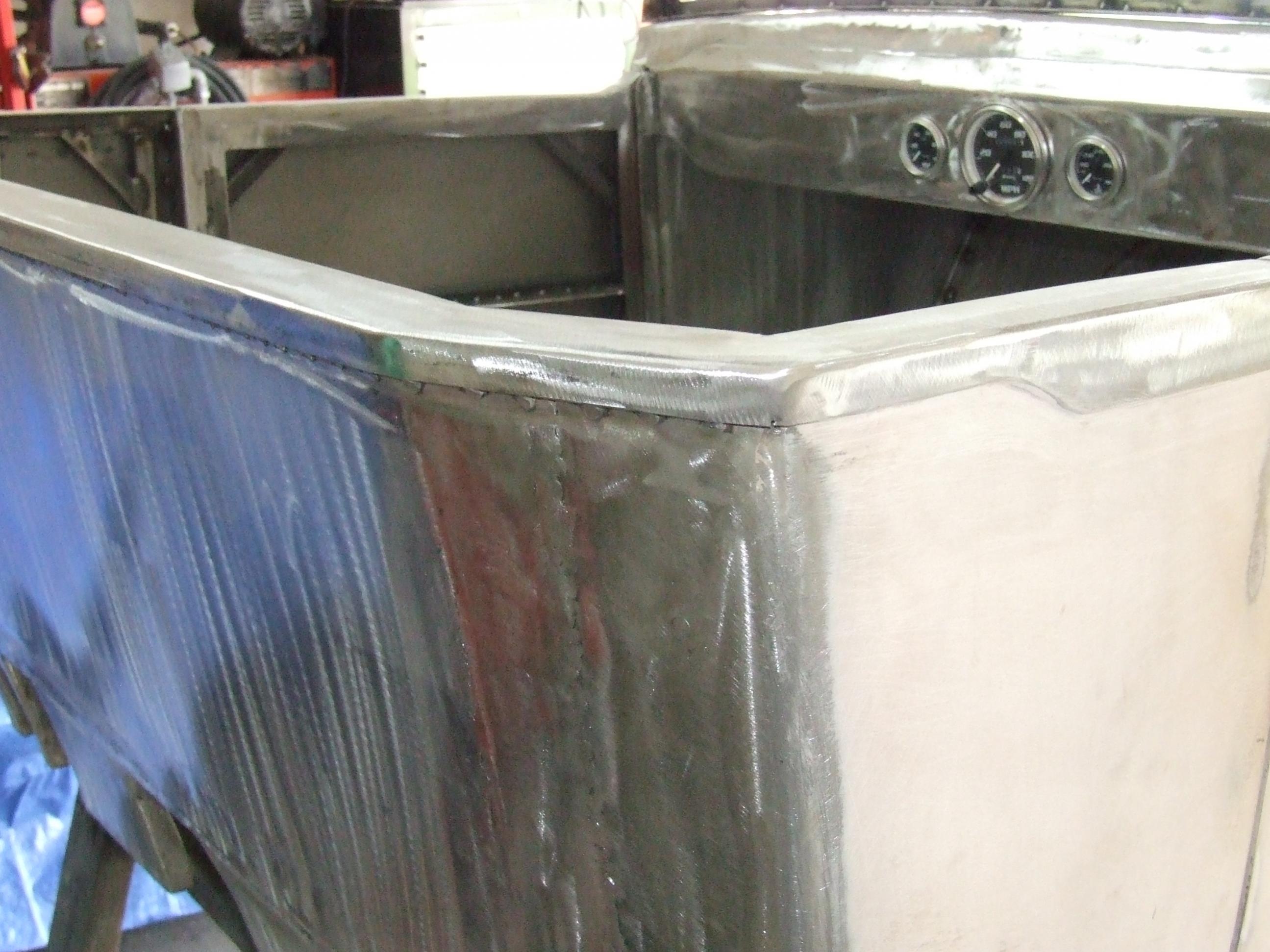

    Hello, had some time to work on the rod today. I added the upper molding to the rear of the body and welded out the seams. so here are some pic's.

    My only concern would be that the bare metal surfaces in places like behind the toe boards will start rusting back where you can't see it happening. I would have shot some weld thru primer all over any of the enclosed areas like that and maybe even a little bit of cheap paint just to seal the metal a bit. Best way all around would be to have the body dipped and e-coated before the bondo started, that way, all the little hidden area would be protected.

    Hey, understand your concern the toe boards have been sealed and undercoated inside already, the interior as well as inside the doors and under the dash and under the body and bed will also be sealed. lizard skin will be sprayed as a heat barrier as well as sound deadening. I think that should work just fine. Thanks for responding!

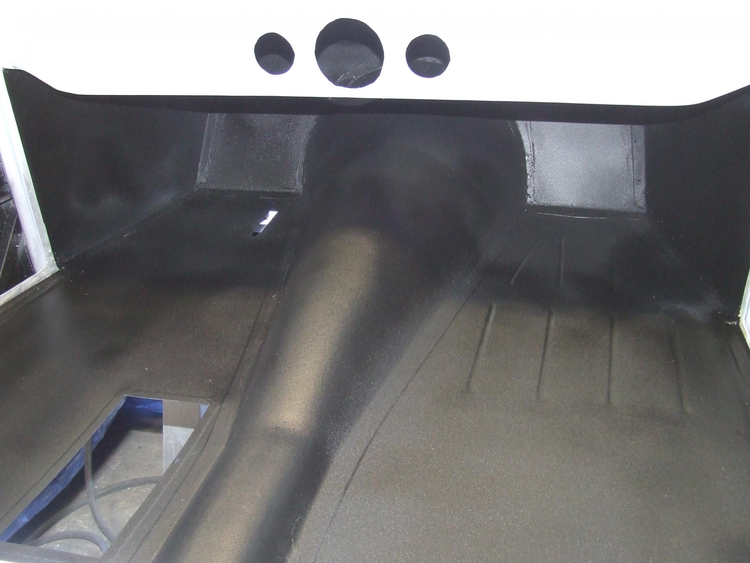

    Sprays a lot like PPG's old rock guard! If you are not familiar with rock guard it has a heavy orange peel finish it dries hard but flexible and can be painted to color match. Used it before on my Dakota R/T and I love it. It will be exposed under the body and bed but will be painted the color of the body, the interior will have carpet to hide it.

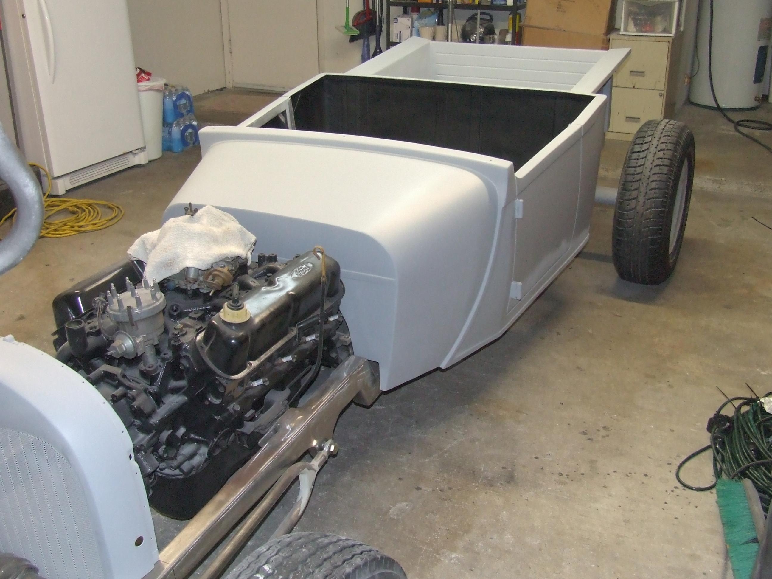

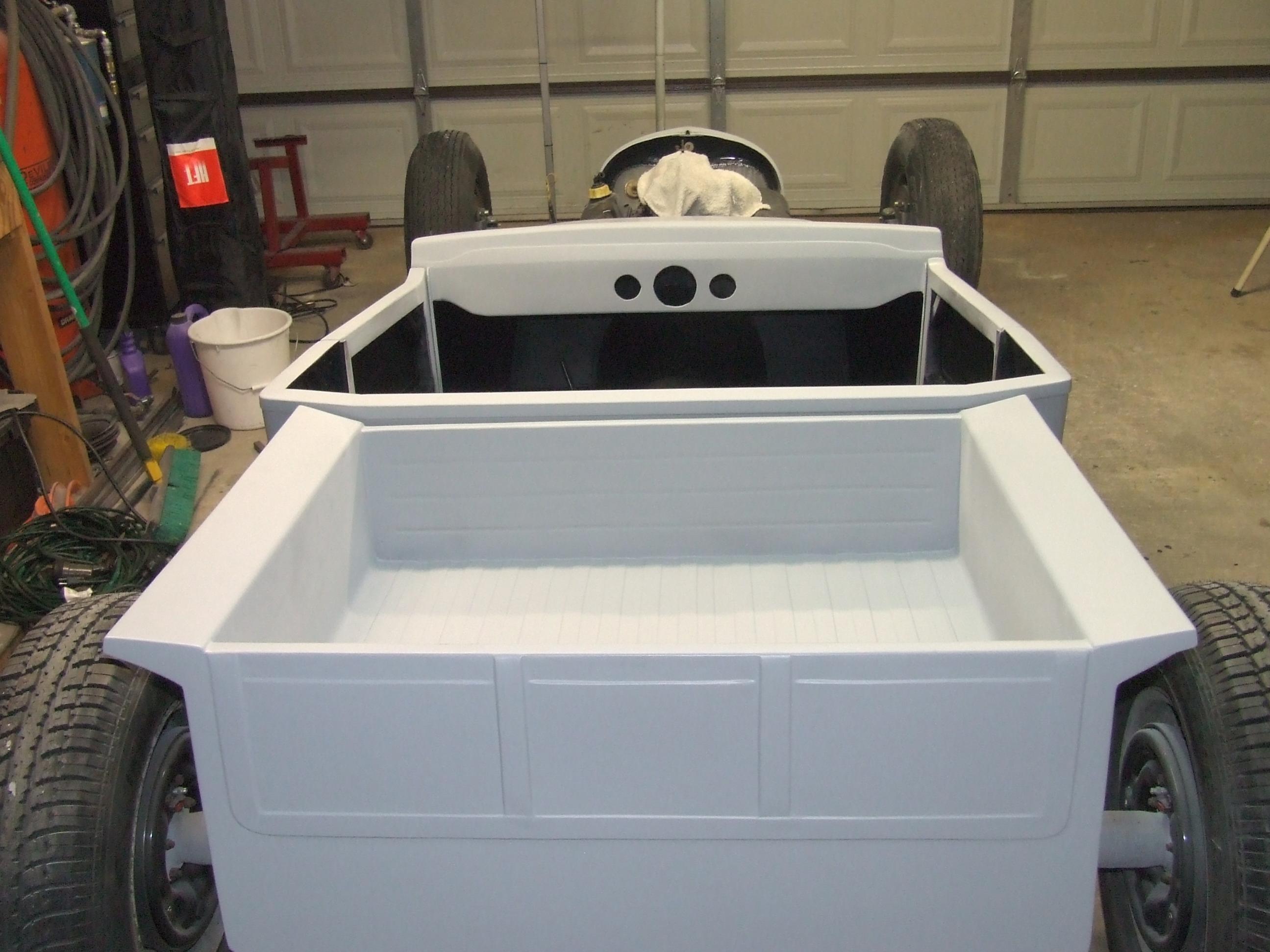

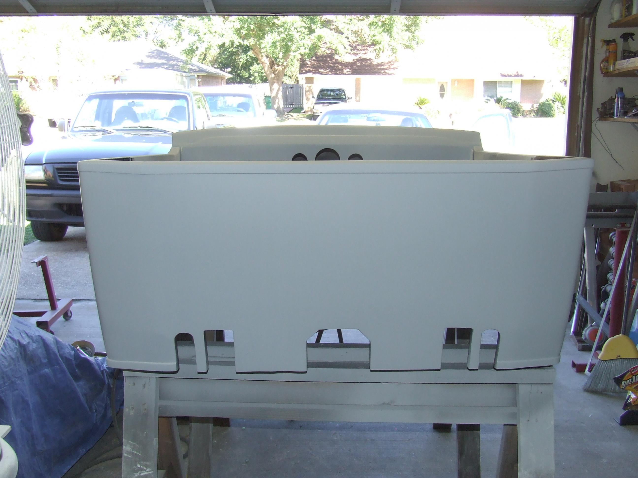

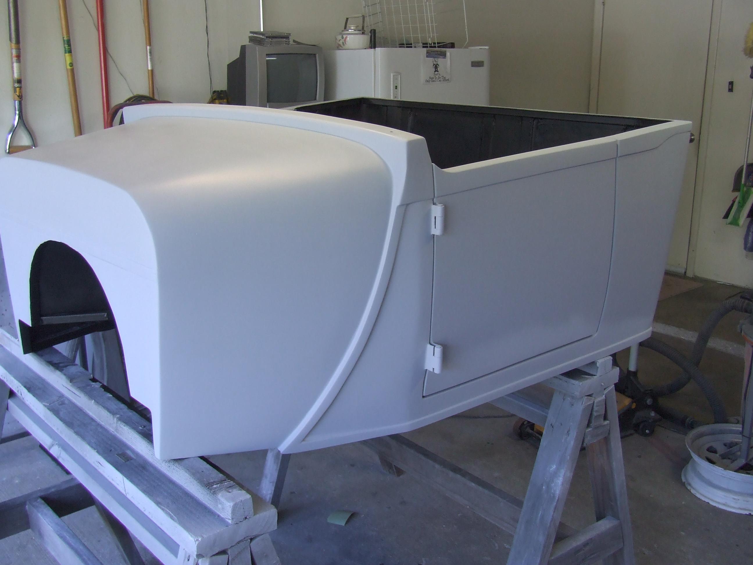

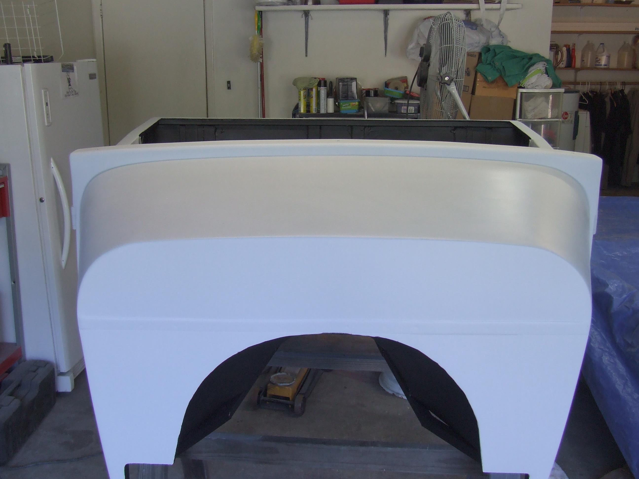

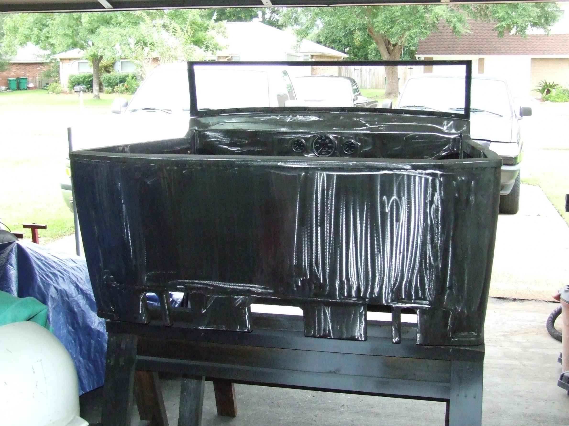

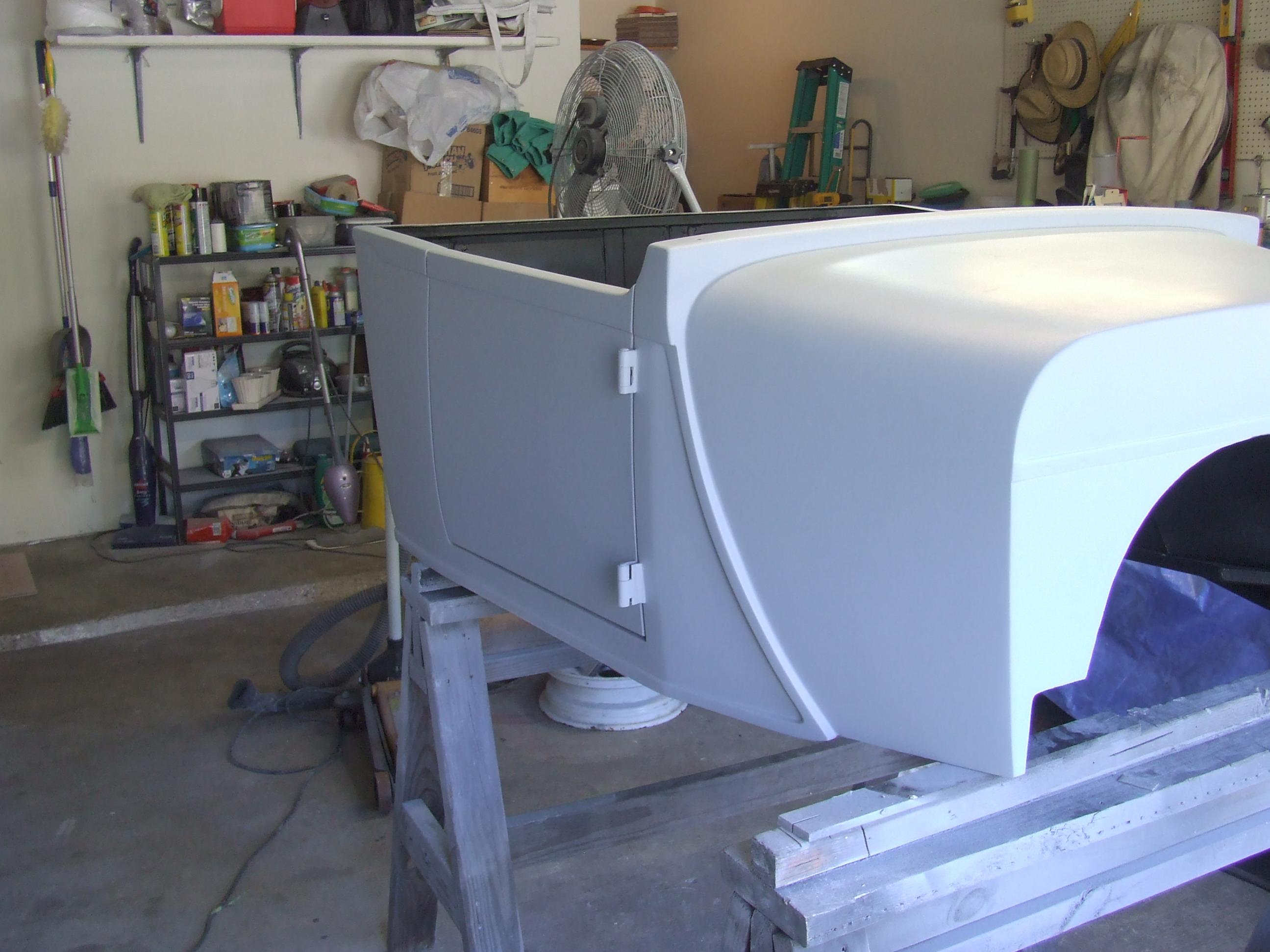

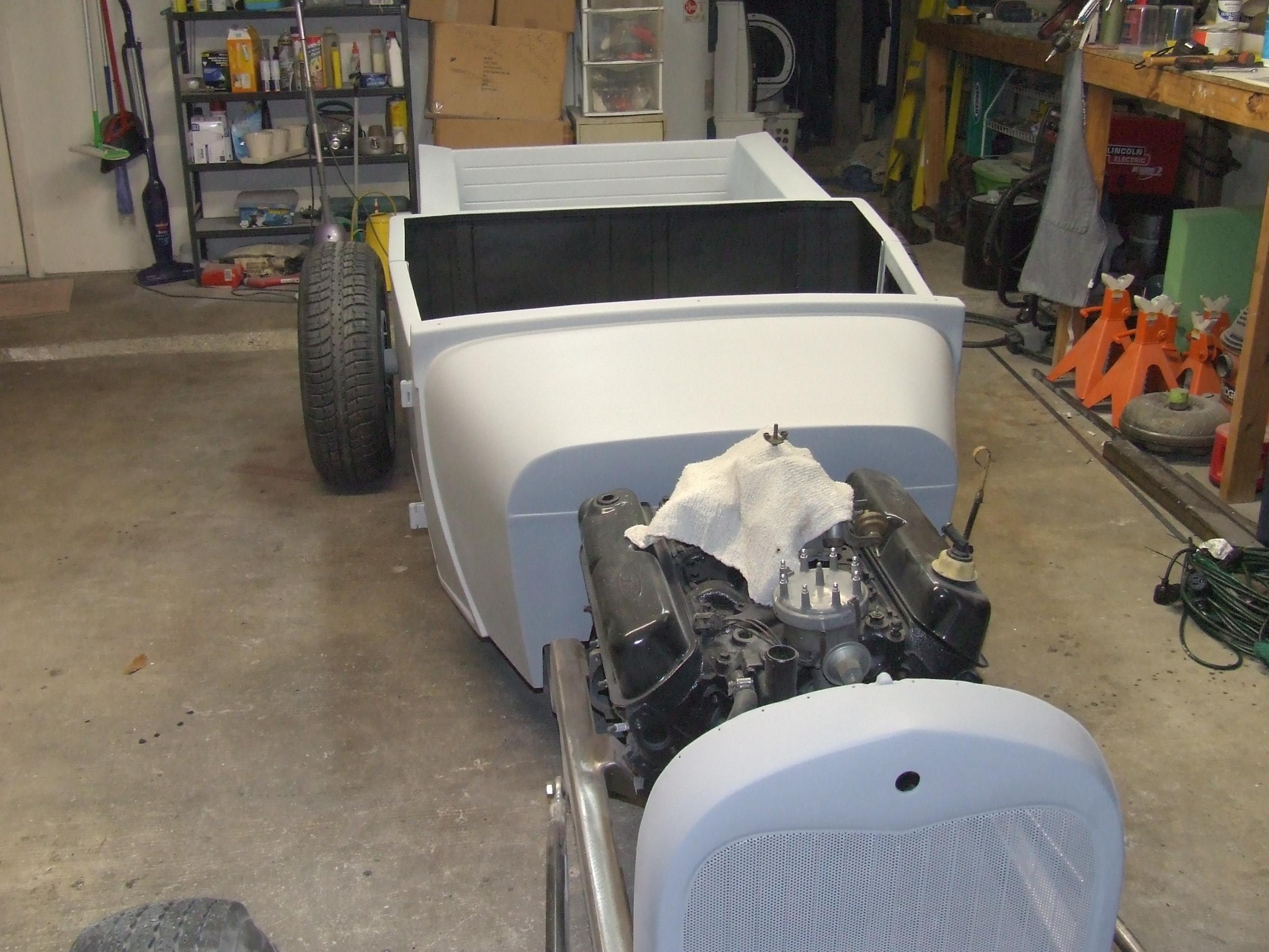

    Hey guy's I finally had some time to work on the rod. After finish welding the body complete I then did the lead work and body work. I primed it with several coats of epoxy primer and then block sanded it. After I was satisfied with the body I then final primed it and taped it off and sprayed the underside with lizard skin. I seam sealed the interior and primed and shot lizard skin in the interior which will be painted at a later date. I plan to mount the body one more time take some picks and begin to paint the final color which I haven't picked yet. Pic to follow.

    That is just awesome! It looks really good. What colors do you have in mind? I keep doing the color switch every time I see a new rod I like lol.
    Keep us posted and that ride is awesome!

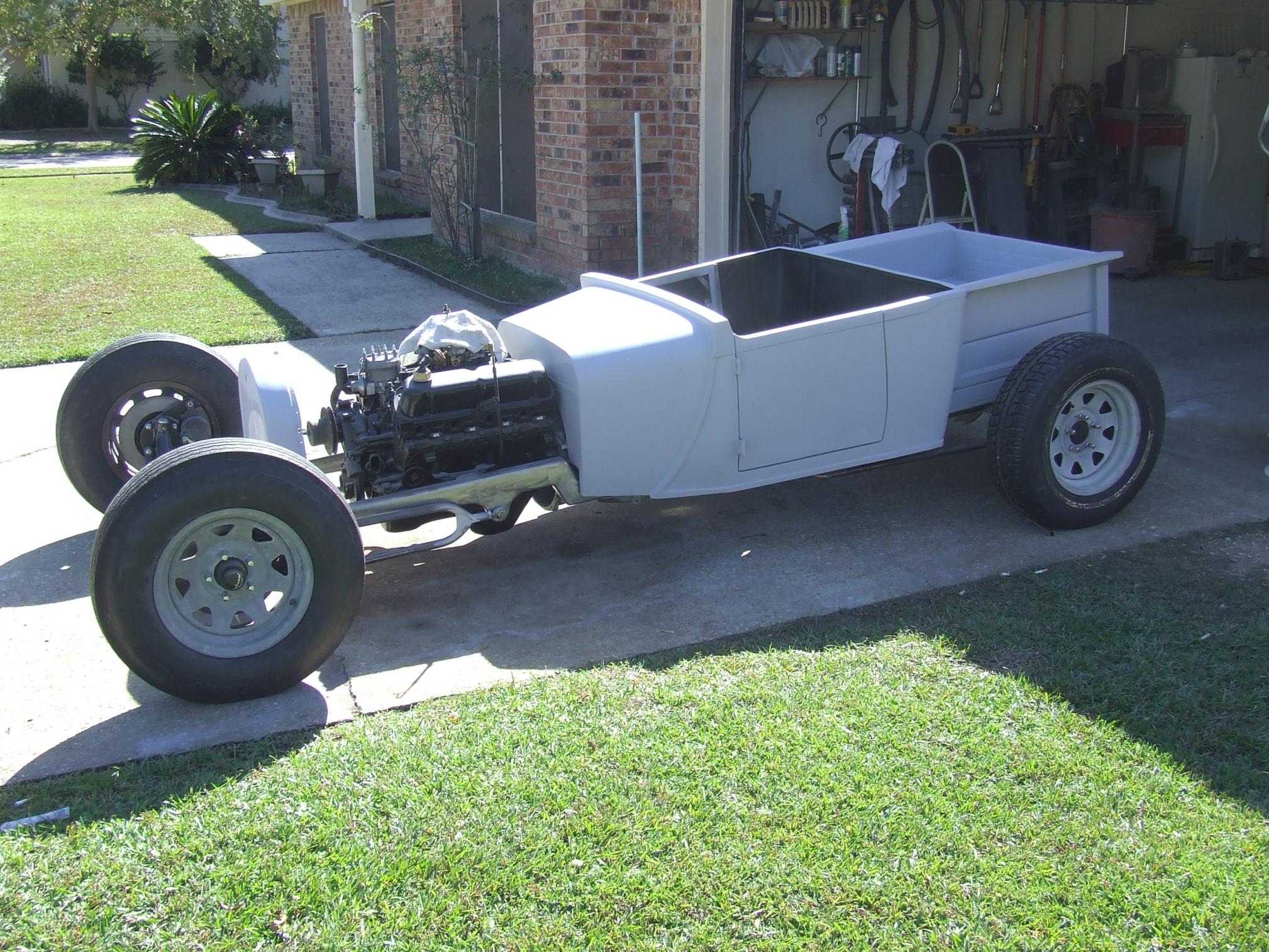

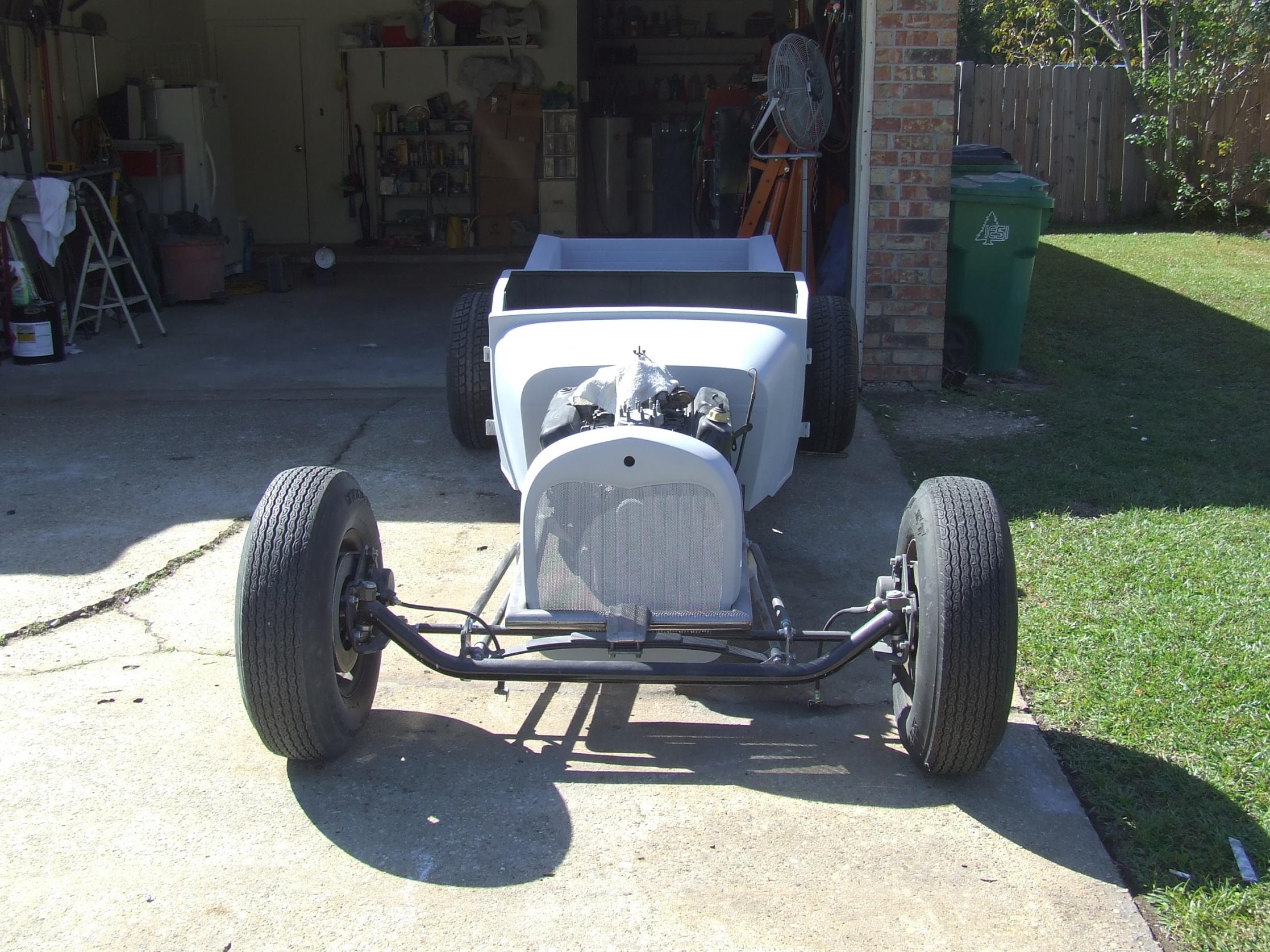

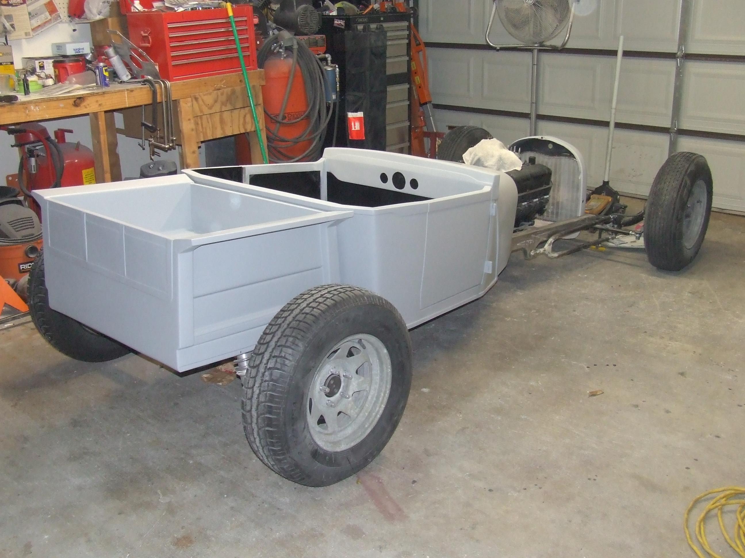

    Hey folks had some time to align the body and bolt it in place! I think it looks good, what do you guy's think.

    Looks really good! Sign me up! You should look at building these as a kit one at a time. Great body work and I can't wait to see it after paint and on the road.

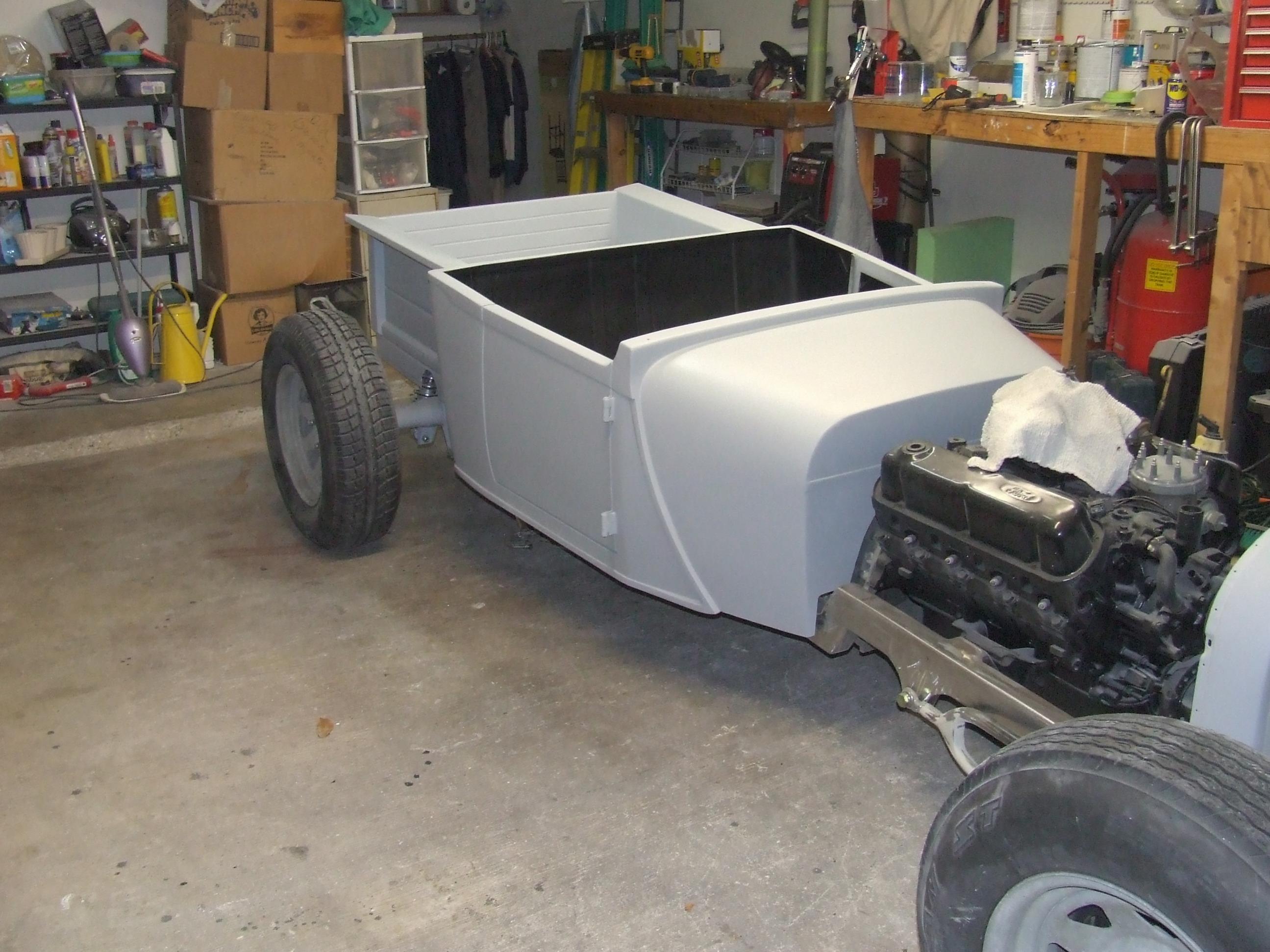

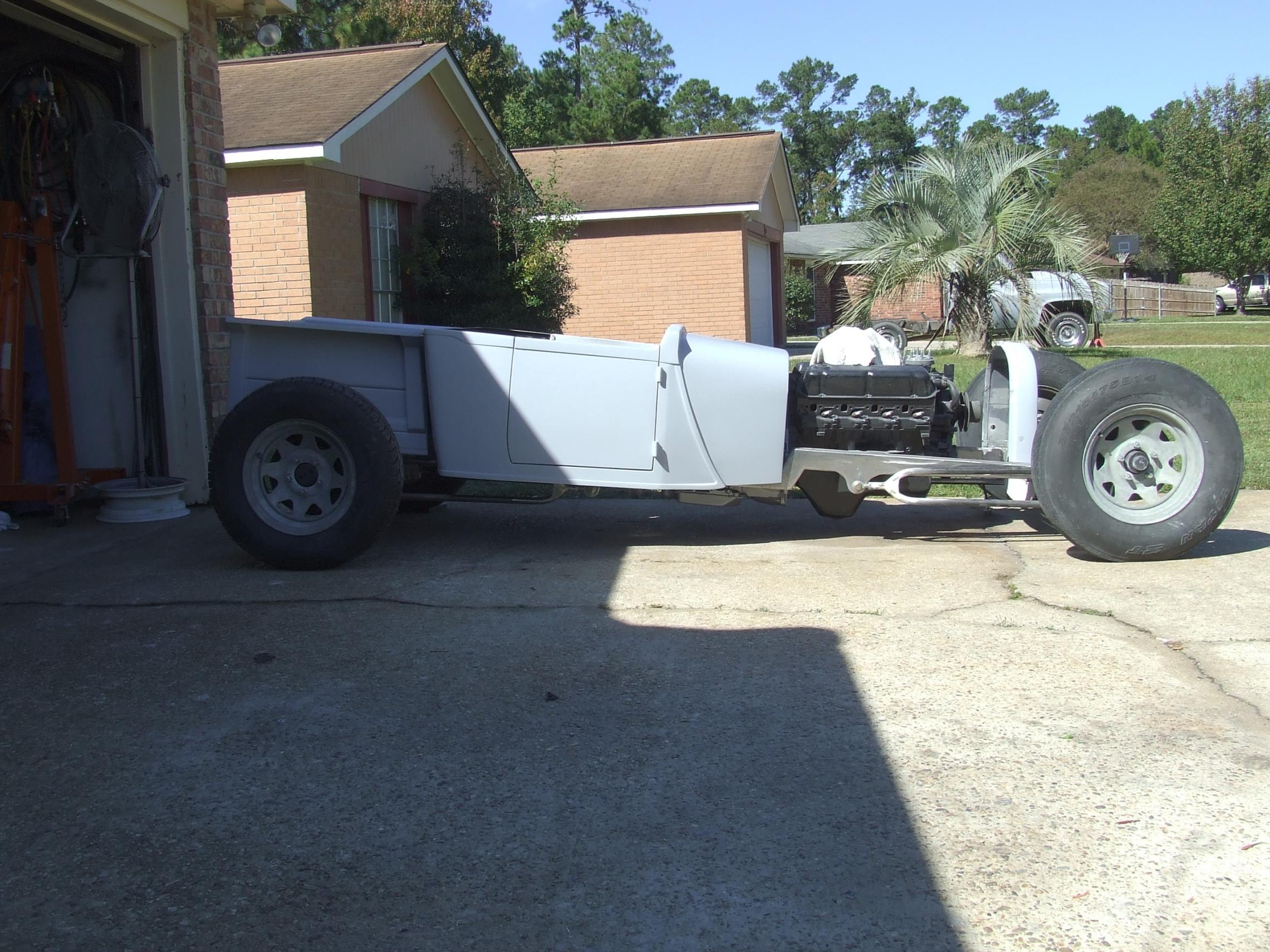

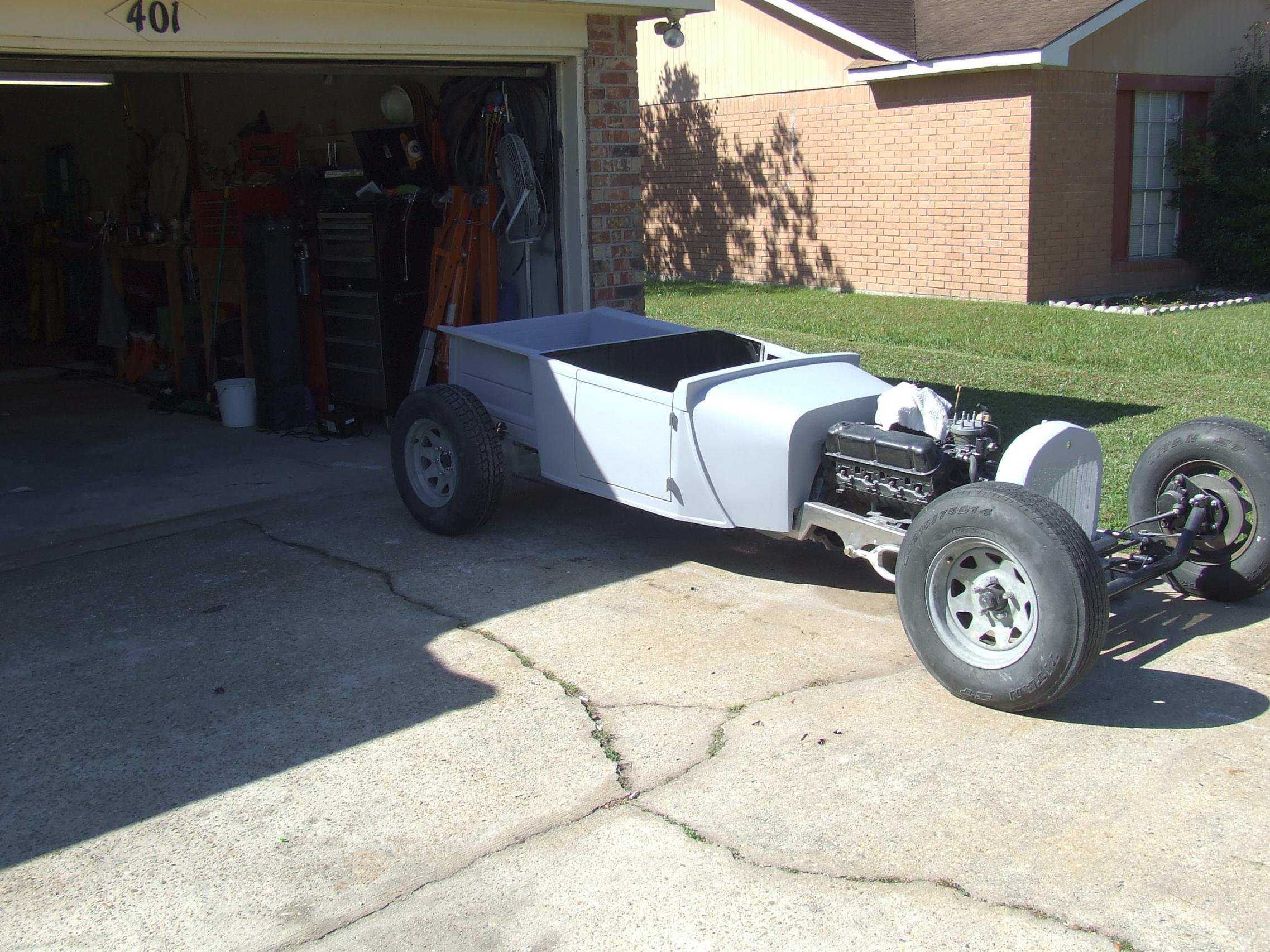

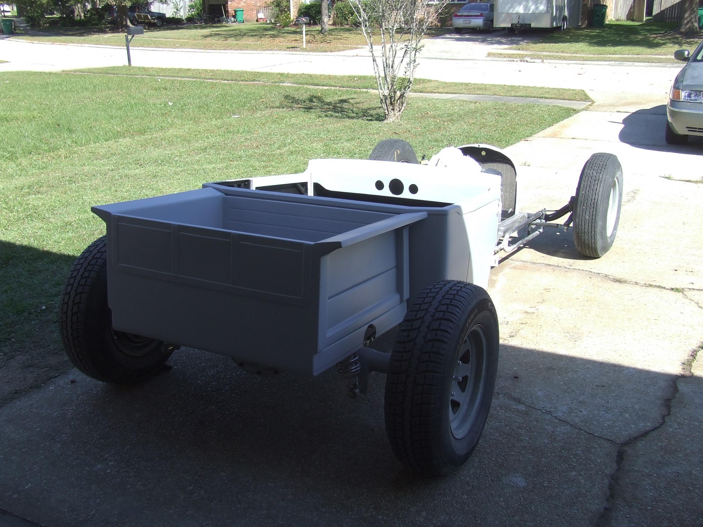

    Hey guy's move the rod outside to clean my garage so I can paint my wife's car. While it was outside I took a few pic's here they are.

    Looks great!! Can't wait to see it done.
